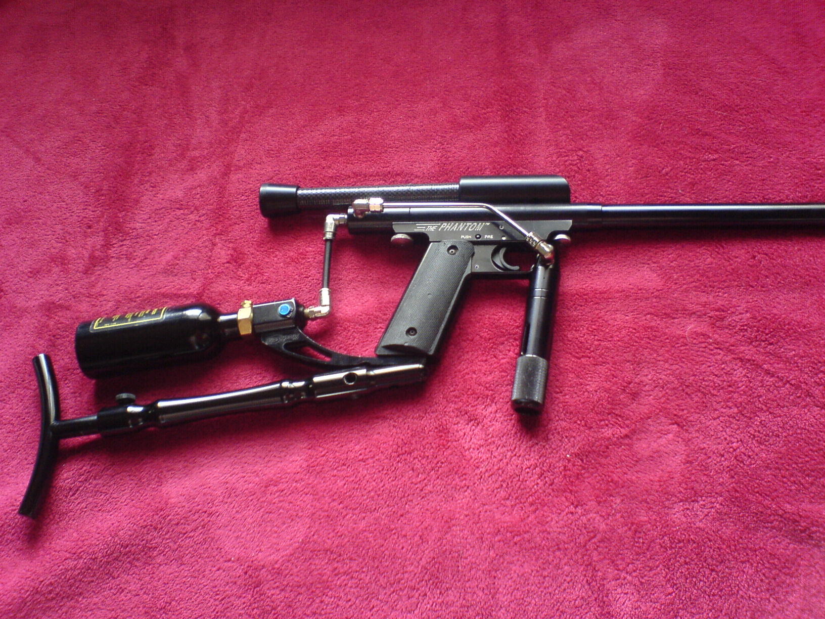

      That said, I have a gauge on mine because I used to use that port as the inlet. May as well add a gauge when I went back to the side inlet. The setup below allowed me to run the 4oz tank as my primary with a backup for 12g in case I ran out.

        That is sick
      MCB member
      • 3511
      • Montreal, Qc, Canada
      Good use of an unwanted drop forward
      I like the look
