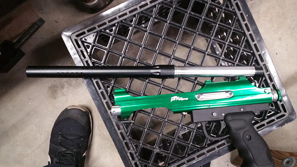

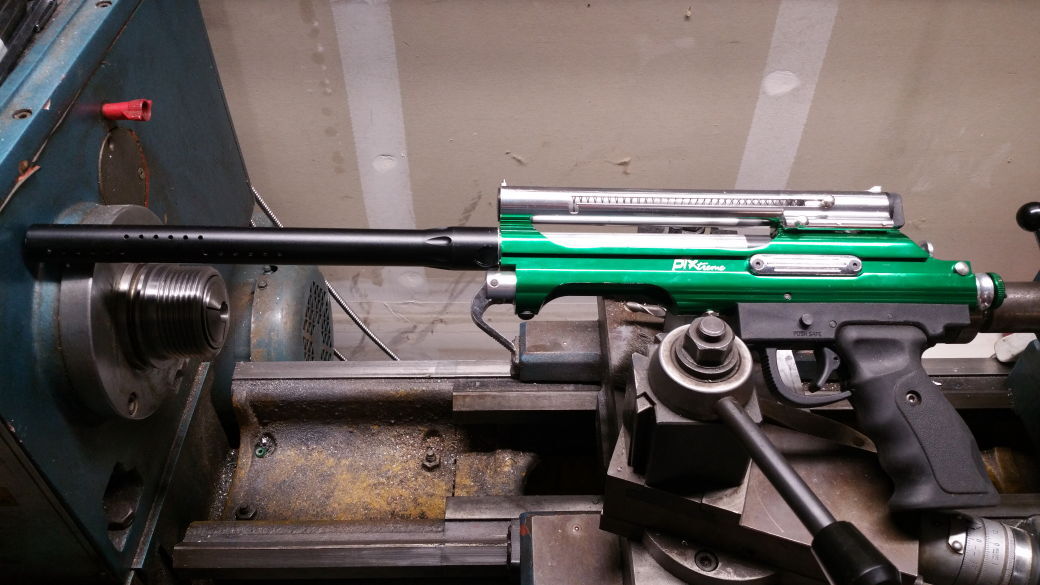

          I made a freak bore barrel for this one. The 12 gram seal crumbled and fell apart so i never got it shooting. If i remember correctly, the bolt enters the barrel. I cut a snub off the stock barrel to prevent the bolt from getting stuck and pulling the inser.

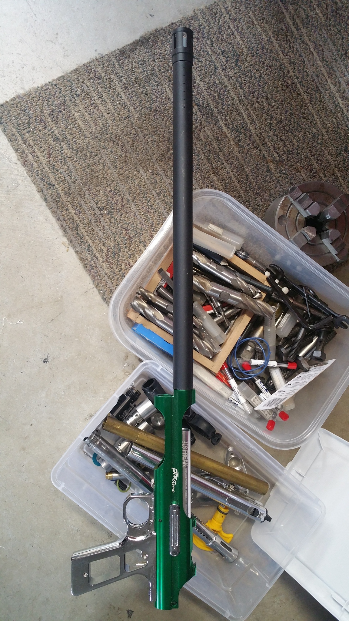

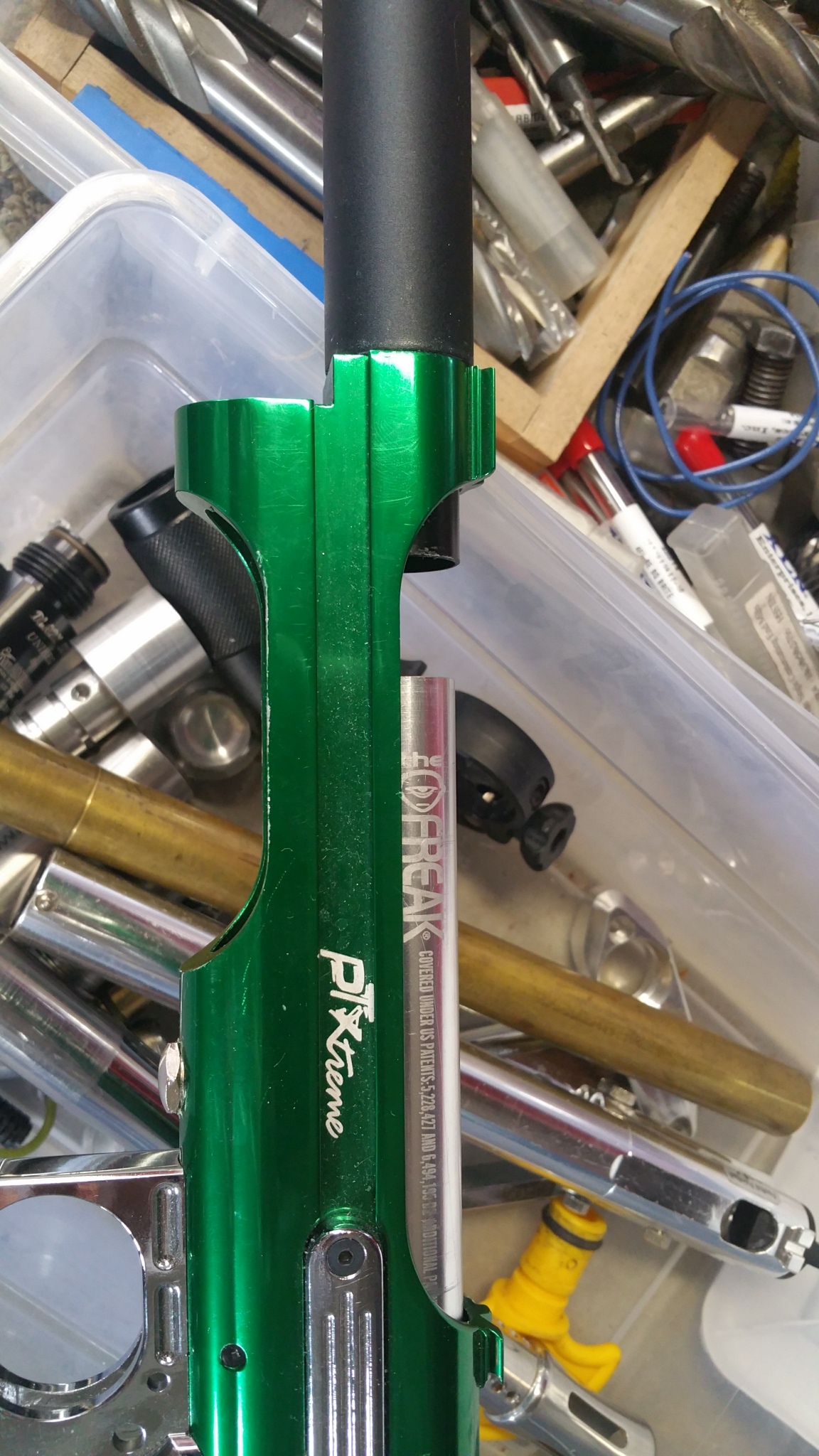

          What about boring a Spyder barrel so that the freak insert makes up the rest of the barrel? I mean just partially boring the barrel so the insert only goes partway in.

              Would be doable with the XL length.

                That's the way it worked out when I was testing the idea with the Flash barrel. Only 2" of the Freak XL insert were in the barrel, the rest of the insert WAS the barrel.
                It will need a 3D printed breech with an O-ring to secure the other end of the insert.
