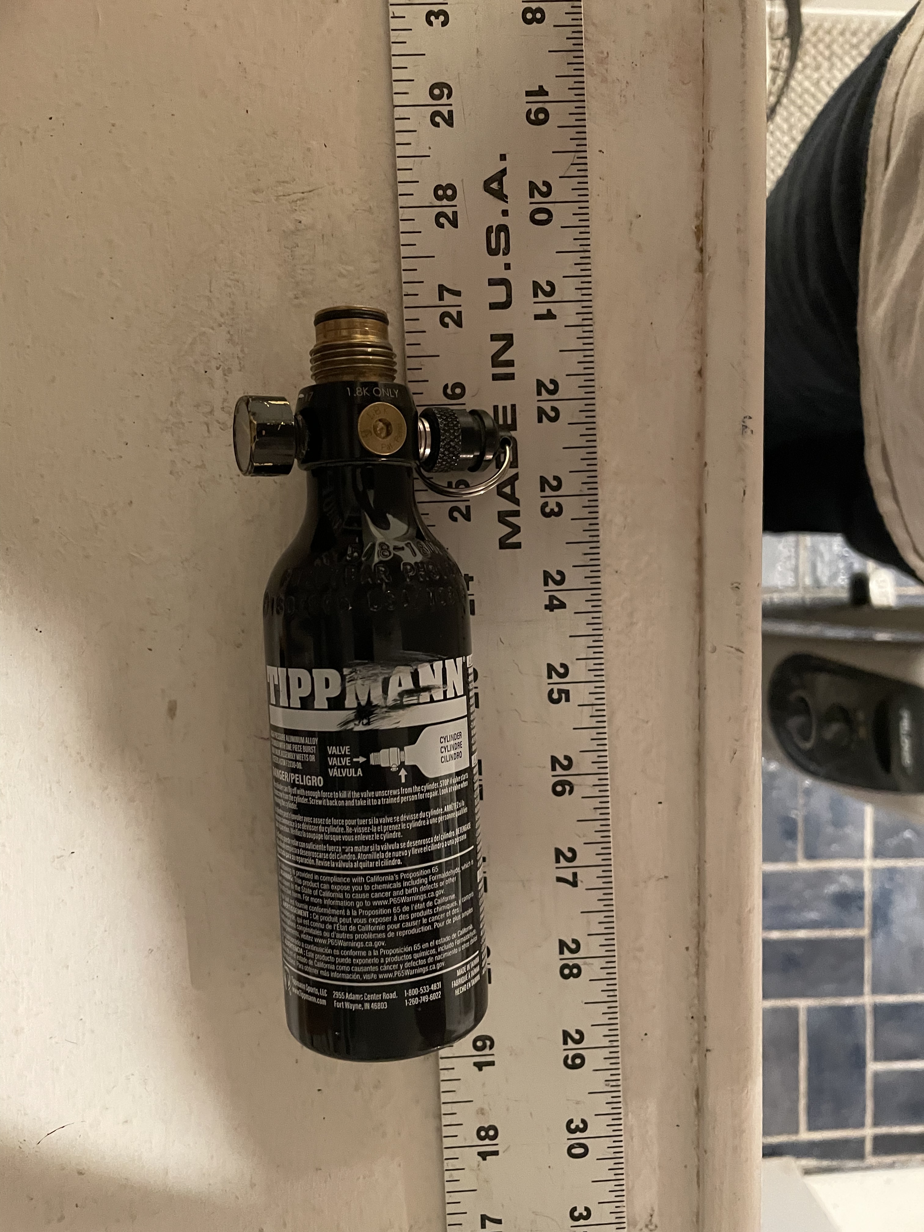

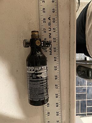

      If you can get your hands on a First Strike reg it will shorten your tank by about an inch, might fit even better.
      I can take measurements if my 9ci with the short reg for you when I get home if you need me to.

        I have a Guerilla Reg (didn’t they become First Strike?).
        Either way, I’m at 6.75 inches for a Tippman 9ci with short Reg.

      South Paw
      • 1896
      Pic is deceiving because of the angles. But it’s 6.75”
