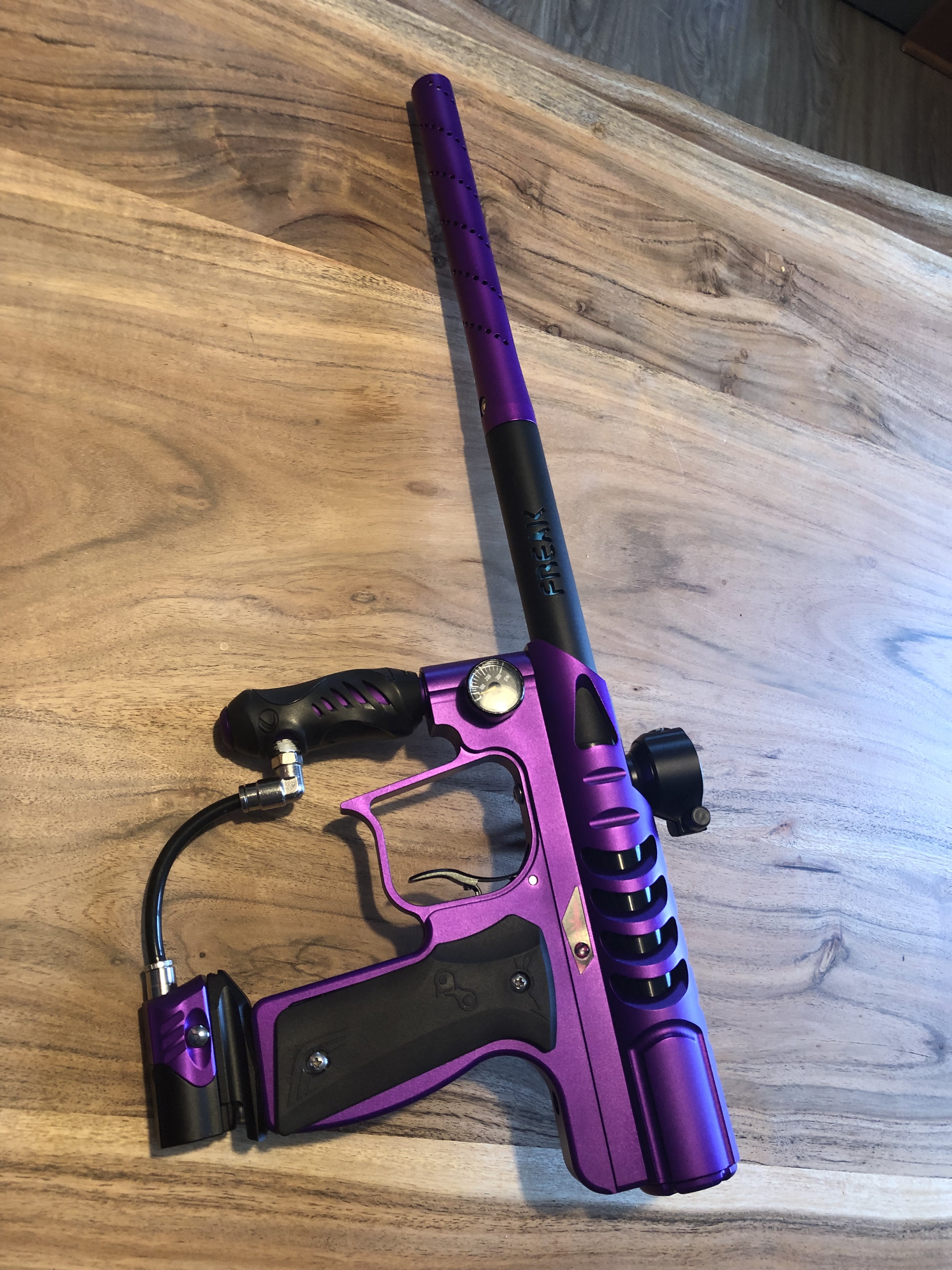

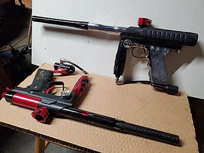

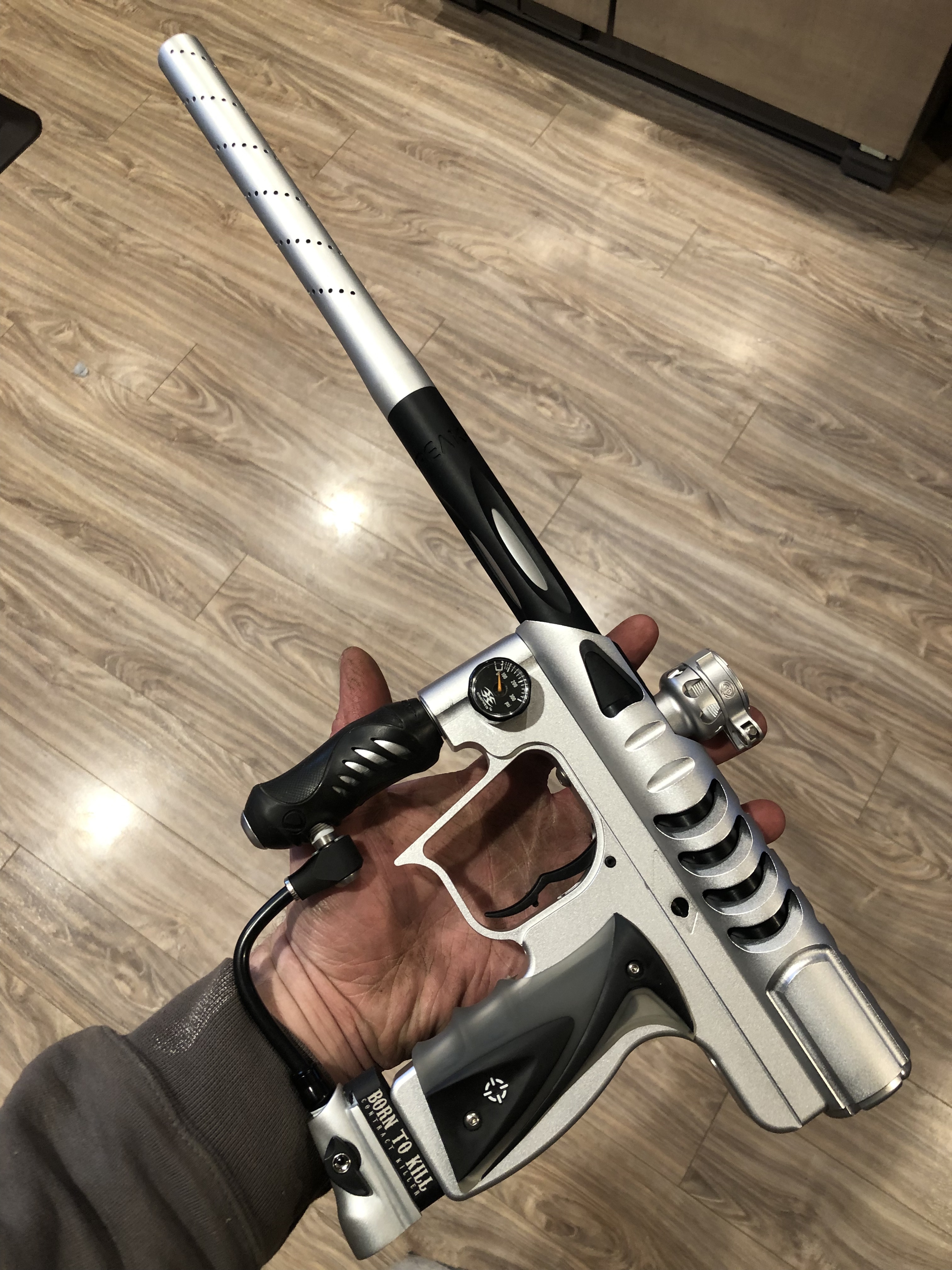

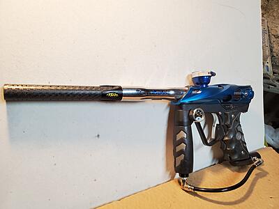

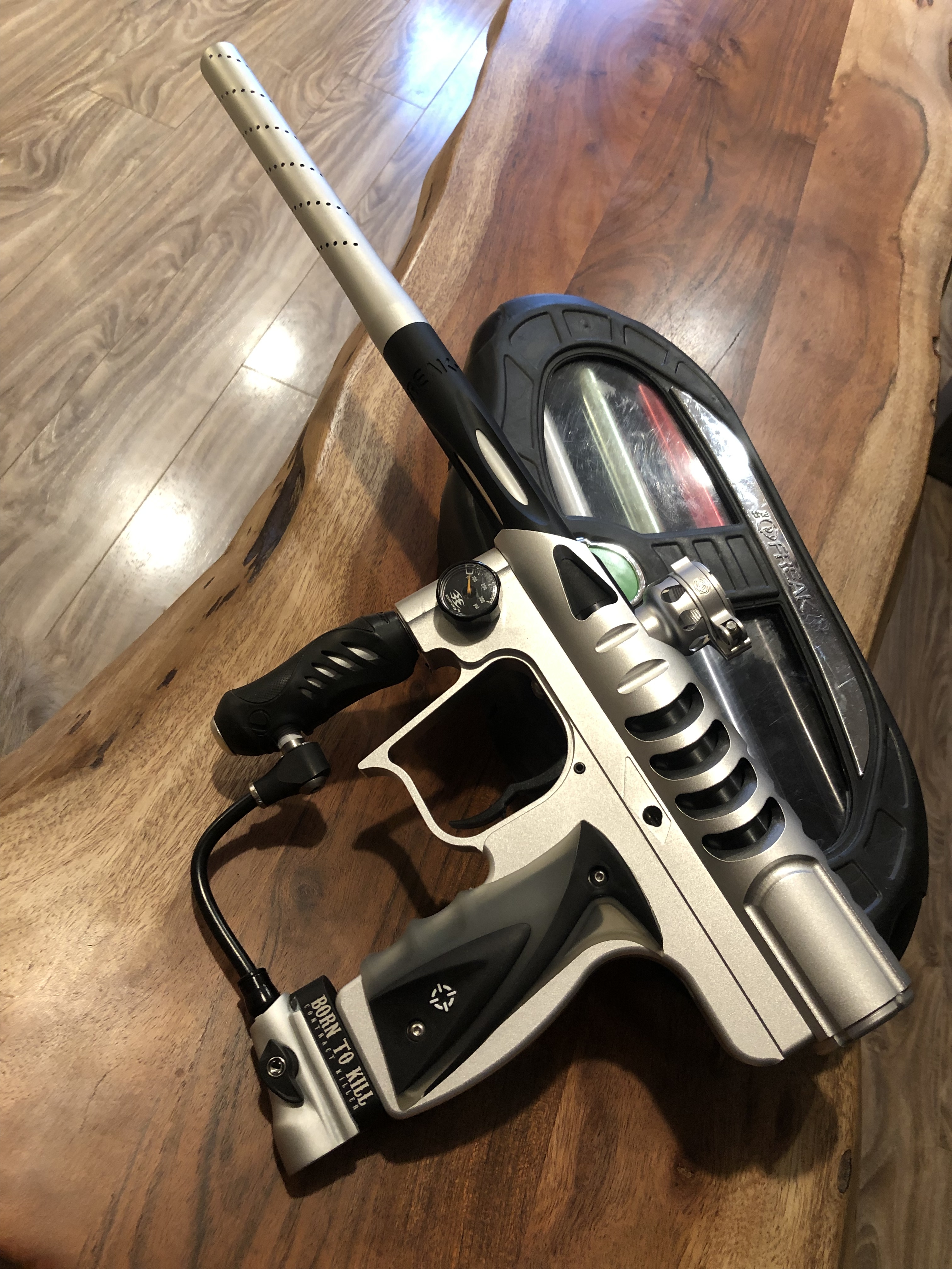

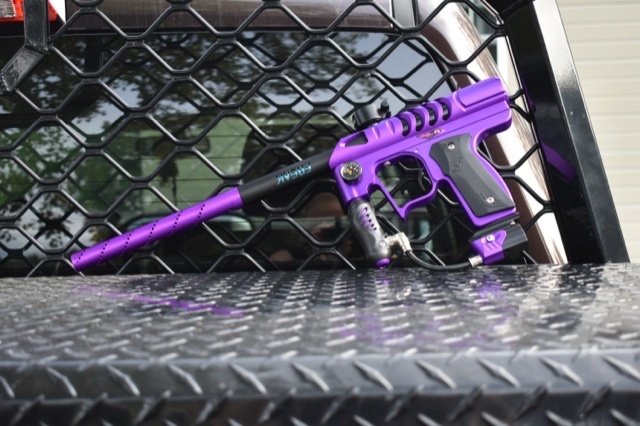

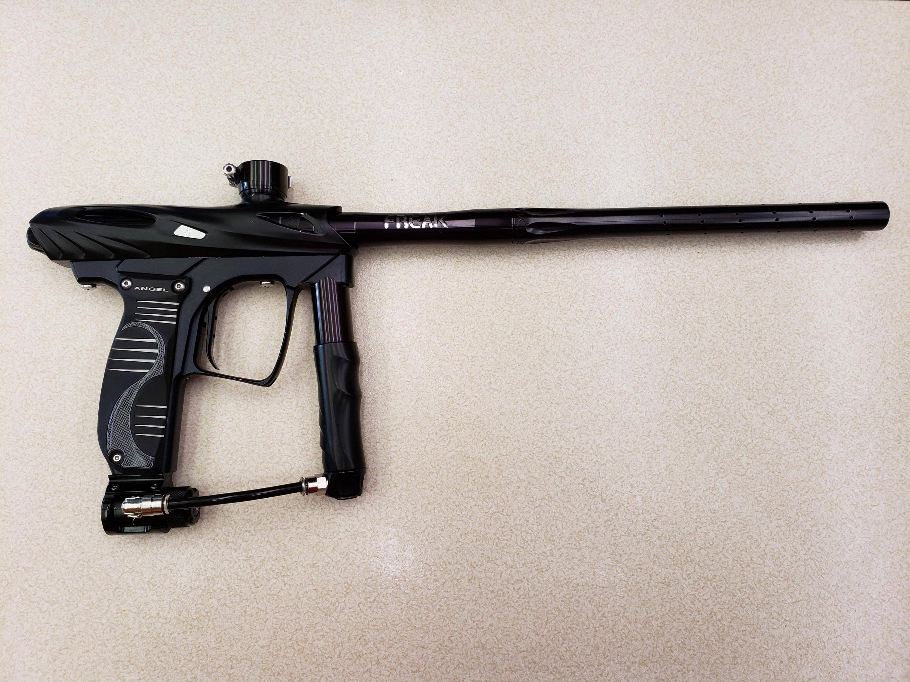

    For some reason over the past ten years no matter how streamline of markers I buy and shoot I always come back to building up off an ion Breech. I decided to go mech on the silver one it’s fun to shoot. The purple one was a virtued electro unfortunately it’s gone somebody on here has it..
    Like to see other people’s builds. Thanks!

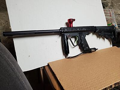

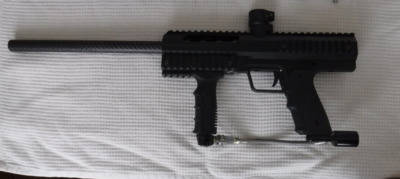

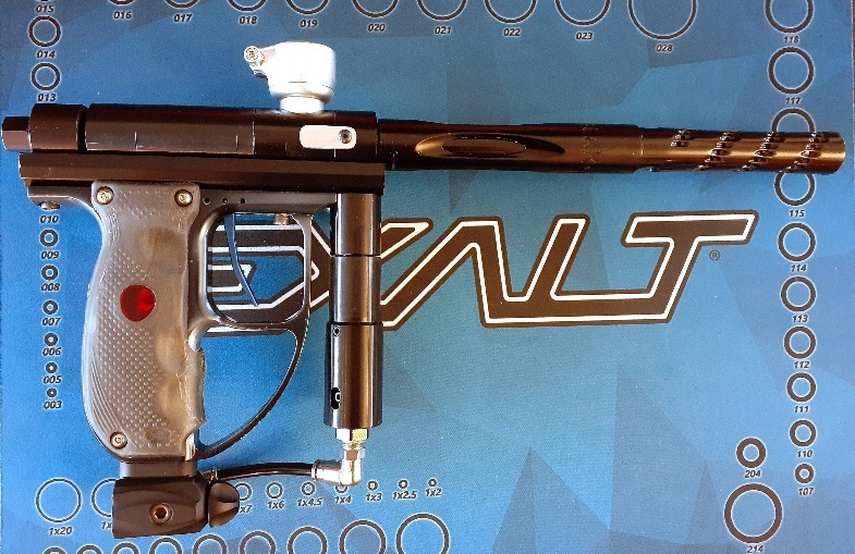

    Its not technically an ion (started out as an eos) but the parts are interchangeable enough that its close enough. The mech ion is also alot of fun to use.

      What frame is that?
    • Darknite667
      Darknite667 commented
      Element v1 frame.

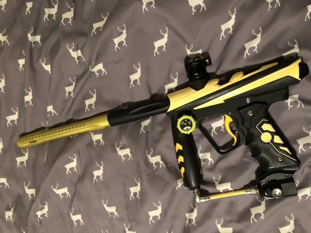

        Blue: SSC mech kit, superfly bolt, shockteck semi bob body, CP Scythe trigger, Qlock, Clippad qev
        Tactical: SSC kit with bolt, J&J barrel, ST high rise feedneck. This thing always just works
        Dye single frame: SSC kit, some unknown bolt that weighs less than the L6, Clippard qev, FBM Sith body, Dye stickies, Q lock
        Ion/ Epiphany: Epiphany chamber and board, body delete from ChoSanJuan , NDZ no rise feedneck, planet eclipse qev, ANS trigger, talon snatch grip. Shoots ropes bruh.

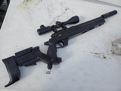

        Ion XE, inside a Well MB04 airsoft stock. SSC kit, Superfly bolt, breech opened up for first strike (hand loaded one at a time), added a sight rail and a scope. This thing shoots lazers.

        • NONOBLITUS
          NONOBLITUS commented
          This thing is a legit FSR knock out punch shooter.

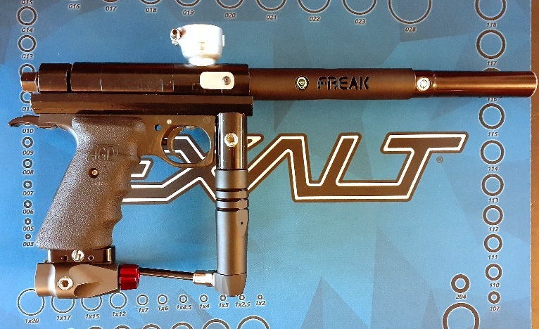

          Found another picture...
          Enmey firing can, modified Epiphany body (cut down into a tray), Shocktech bolt, Rainmaker's Phantom SC breech modified to fit properly, female Stabilizer with ring mount, gas thru stock with BE 12gram changer, Freak barrel, QEV, Ed Peterson pump frame.
          • JeeperCreeper
            JeeperCreeper commented
            This makes me want to make my rifle a bolt action with a stock class feed and a 12g changer. How do you make it pump? Is it closed bolt?
            Jordan commented
            It's open bolt. The SMAV is located in the frame and a custom trigger installed. Ed Peterson (on Facebook) used to build the frames, and did the last run ever (his words) January of '21, I was lucky enough to get in on the last run.

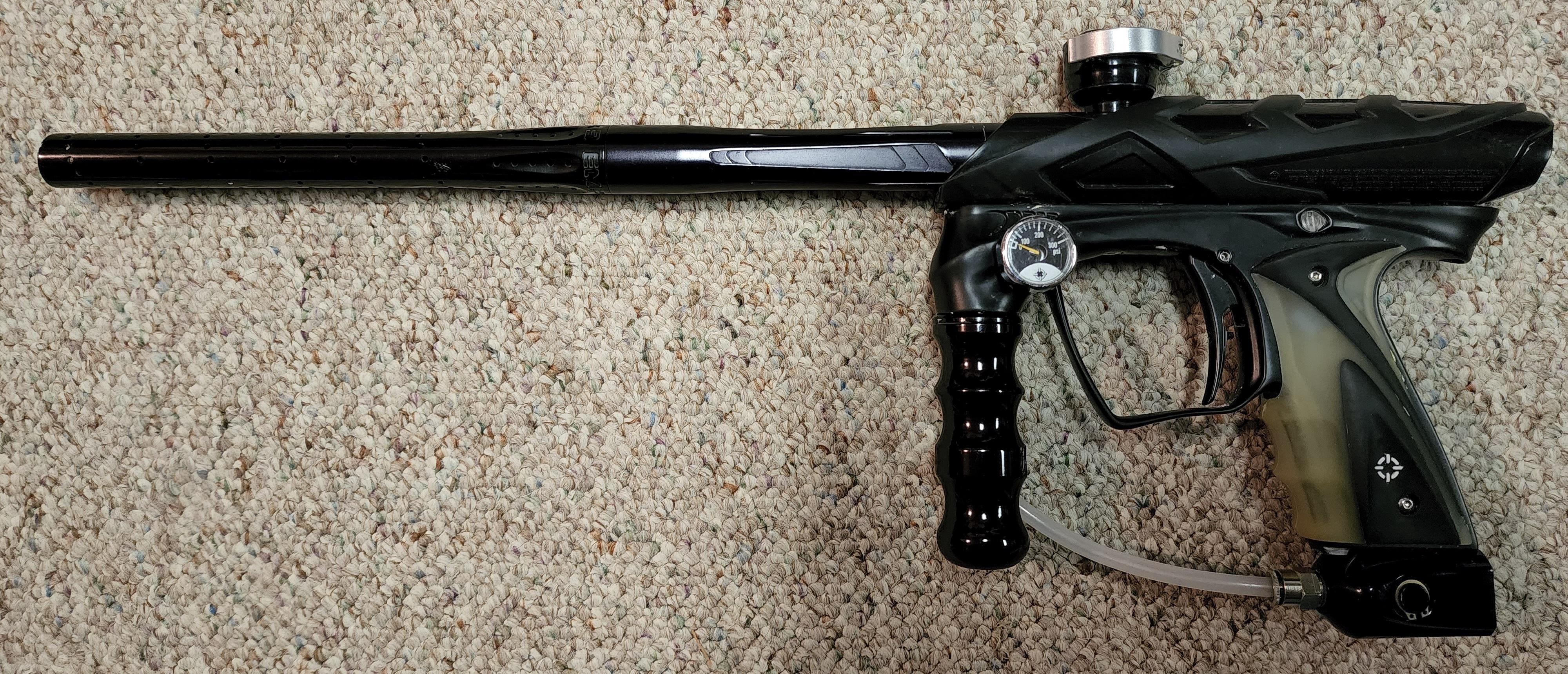

              akpaintballer98 I was eyeballing that body and frame set, how you like them?
              Also, this thread is making me want to do crazy thing to my Ions, thank god I have 6 of them! Never knew there was so many things that could be done!
              • akpaintballer98
                akpaintballer98 commented
                They’re a cool look and the finish is pretty nice.
                They are kind of a pain if you want to build a mech because they don’t have metal in the right place for the mount so you had to drill holes. Also find some thin grips because that frame with stock ion grips feels like a Glock wrapped in hockey tape. Also don’t go super low rise feedneck or it hits the body. Overall though I think it’s a really good looking gun for fairly cheap
