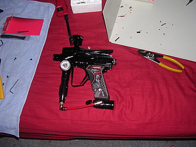

    Alright ladies and gentlemen and everyone in between, the goal here is to attempt to take a B2K4 and get it as close to the old T2 Trayless mod as possible. I have a pic of my old T2'd B2K4 that I no longer have. The plan is to utilize an existing frame, which will likely lead to a custom tray and I may even explore a custom manifold to drop the height further. Currently plan on using a Morlock MK3 as the brains.
    Potential frames:
    - Dangerous Power F7
    - EGO (earlier the better)
    - ETEK (STAR preferred, though the OG composite may be okay)
    - Macdev Cyborg or Droid or Clone(?)
    - OG Timmy
    - Older Dye matrix frames (they were beefy!)

    Angel LCD frames have good potential too. Since they use a wide grip pattern the inside of the frame is totally open.
    • zinger565
      zinger565 commented
      Oh, good call. I'd really prefer a Cyborg frame since they used the same noid in almost the same spot, but an angel frame might be easier to find.

        The original tray less kit also moved the solenoid
