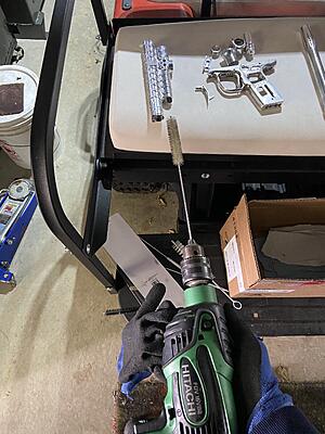

      Prepping parts for anodizing, found that a pipe cleaner in a high speed drill works great for the inside bores.
      • Siress
        Siress commented
        you should definitely get a burr hone (FlexHone [tm] )if you don't already have one.
      • Roger7pball
        Roger7pball commented
        Thanks for the recommendation. I looked in to an abrasive bore brush and similar bits if this didn’t work out. But a little polishing rouge on the bristles really left the inside clean and smooth.

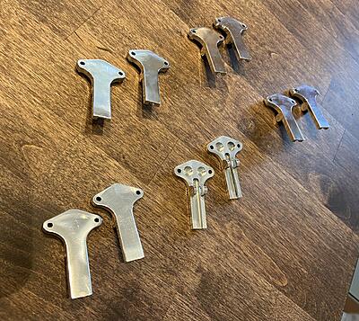

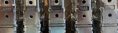

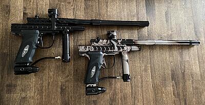

      Got the eye covers machined and serial numbers done. Don’t mind the polishing compound, still some more to do.

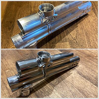

        Unfortunately the anno on the first test body has to be redone and I need to mess with dwell/pressures…but it cycles without leaks. It feels really comfortable with tank and loader etc.

          Beautiful. What happened with the ano. From just that she looks good.
          FredMnkyDad10 Feedback
          • Roger7pball
            What we think happened is the hot bath, soap, and deox didn’t quite get all the polishing compound off in the crevices. So those areas the aluminum didn’t take the anno dye.
            A bummer but the positive is most of the parts have never been stripped before (they were raw). So should be okay for a re-anno with tolerances in mind.

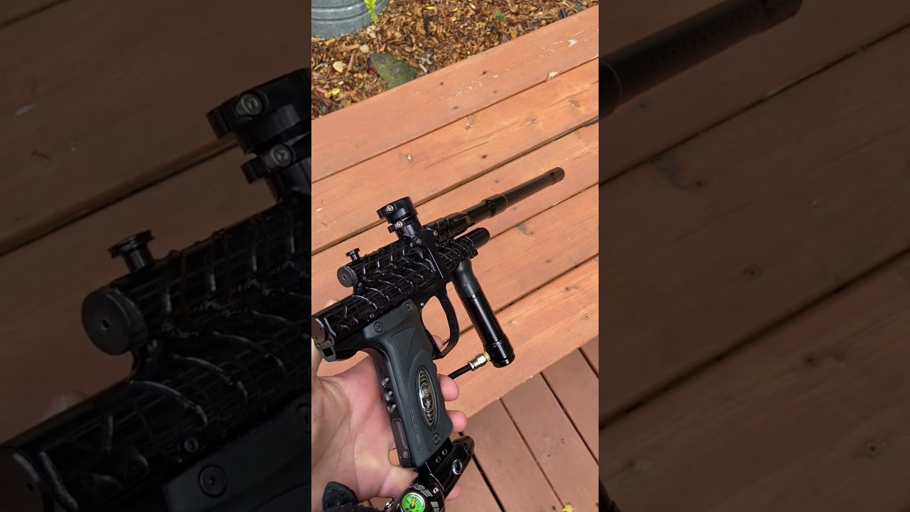

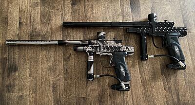

          It’s alive! Need to modify the eye wiring tomorrow at work but it’s close.

              Looking great. I do like how that black and raw combo came out.
              • Roger7pball
                Thanks, yeah I’m happy how everything turned out. I just need to trim the bolts and make some new bolt pins.

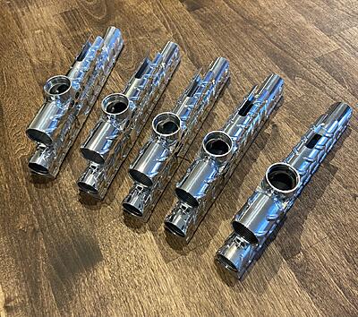

                      Ran a smooth version, I think it will look clean anodized & assembled.
                      Polishing is not my favorite activity.
