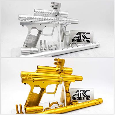

              Hey Roger, thanks again for the body and frame. Those complete and anodized builds look awesome.
              When you get a chance. Could you do a full build list for either one of those Ehms, for us to reference from? Thanks

                #52
                Yeah for sure. It was something in the back of my mind to do, I just need to sit down and do it. I’ll post a bill of materials.

                    #54
                    • Ehm blank (AKA paintball)
                    • Milling & eye covers (local machinist)
                    • Feedneck stub (Nummech)
                    • Locking feedneck (Sconi)
                    • VASA (Autocockerparts taken down on lathe, 113 oring)
                    • Frame (modified Ego or new from scratch)
                    • Grips (depend on frame)
                    • Board (depend on frame)
                    • Eyes (AKA paintball or home made)
                    • Barrel (any Autococker barrel)
                    • HPR (any but prefer AKA paintball)
                    • LPR (AKA paintball)
                    • Detents (AKA paintball)
                    • Solenoid (AKA paintball)
                    • Ram Cartridge (AKA paintball or 04 Viking)
                    • 11/16” Valve (AKA paintball or CCM or Dye)
                    • Bolt (04 Viking or Morue from the group for proper detent slots)
                    • Fasteners (described in the attached images)
                    • Loctite 545 pneumatic sealant (Amazon)
                    If I think of anything more I’ll update this list but hopefully this helps you get going.

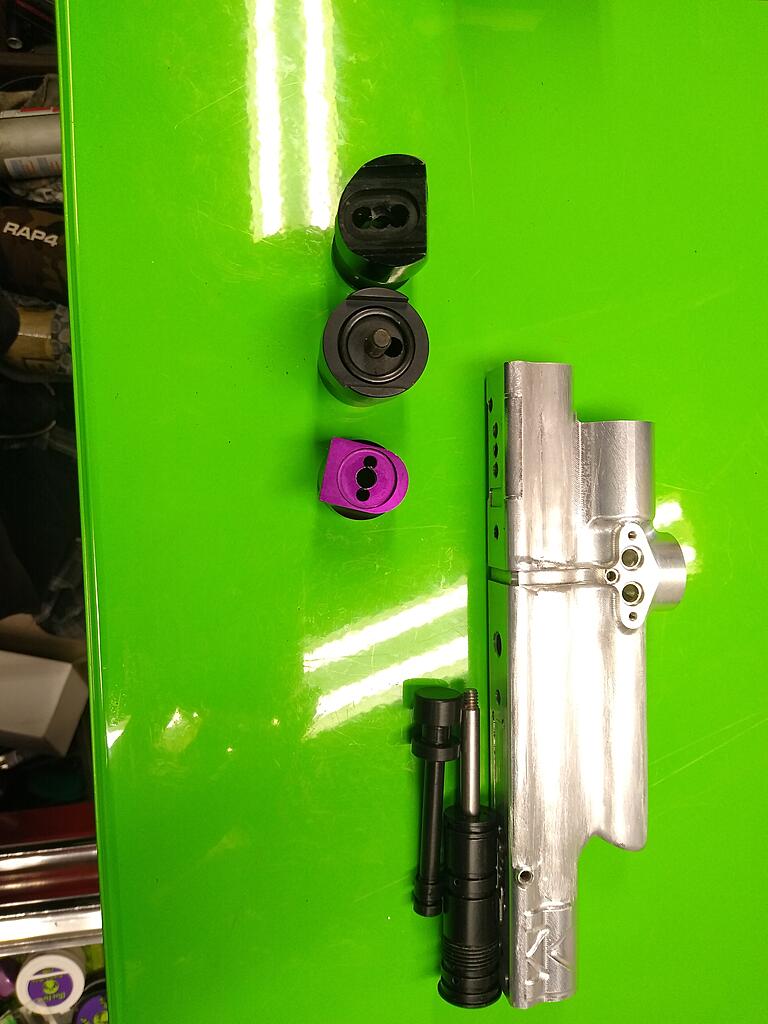

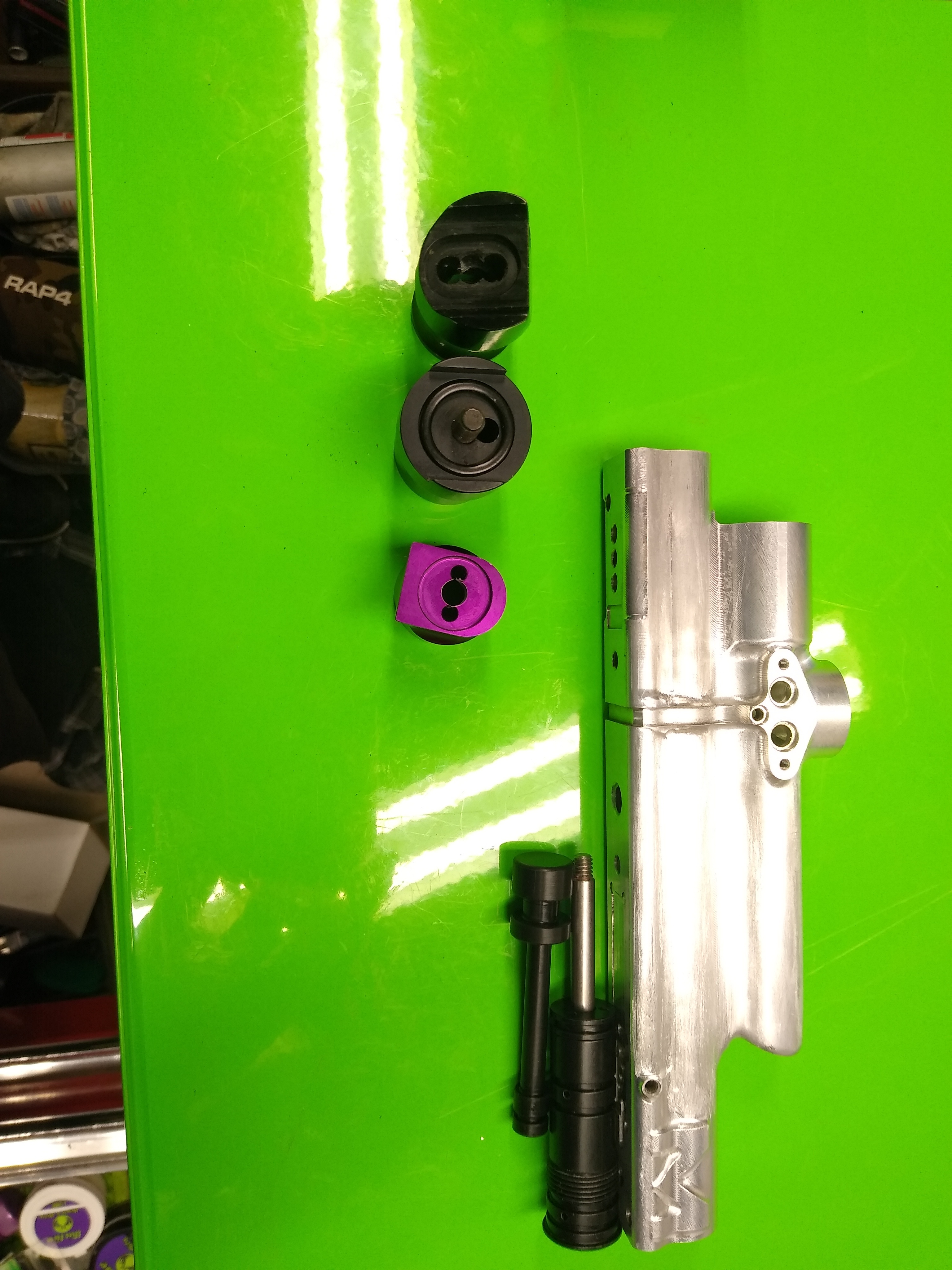

                      #55
                      What style cocker asa does it take? The wings on the pre 2k and 2k autococker does not match up to the body.
                      IMG_20240206_224332014.jpg ​​​​​​
                      • Roger7pball
                        • 572
                        • Arizona Bay
                        #56
                        I use these, no 3 way rod hole, then turn them down on the lathe to match the OD of my regulators.
                        https://autocockerparts.com/autocock...ical-vasa-raw/
