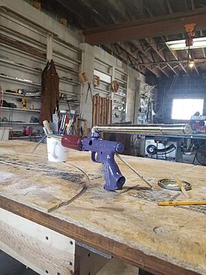

    Cooler weather has motivated me to dive back into paintball and paintball projects! This is a custom tippmann sl-68 I'm working on. Right feed cut off and welded on a diy center feed feed neck. Made a 14 inch brass barrel that accepts freak inserts, and removed sight rail. This thing shoots great! I love the pump and the ergonomics of the sl68, but hate right feed and the stock barrel. After the modifications I'm pretty sure I like it more than my phantom. Still on the to do list is: polish the barrel, make a black walnut pump handle, clean up the welds and powder coat the body.

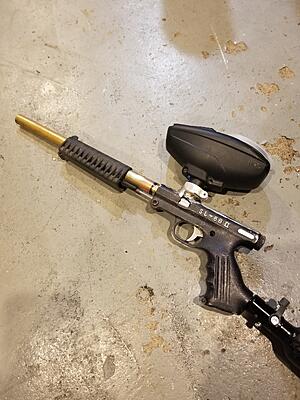

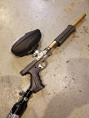

    Awesome!! I had a centerfeed SL68 many years ago. I got it in a trade here on MCB. It originally used a direct feed adapter for a PT Xtreme or some other STBB pistol. I converted it to stock class. I sold it to another member here, who last i heard still had it.

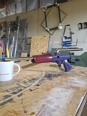

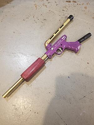

    Made a pump handle out of some purple rain forest wood. I decided to spray paint the body instead of paying 30 bucks for some powder I'd only use once. But I'm not really happy with the color. Still gotta get a 12g changer and make a speed feed for the tube feed, but in the mean time a 50 cal case works well as a plug.

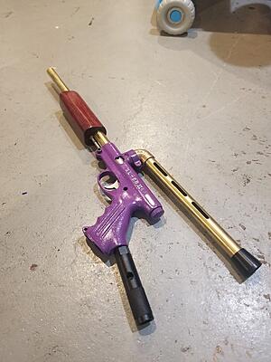

      Final pictures of the build. Went with a different purple. May still anodize the changer to match, but for now it's done. I love that you can so easily change from stock class to open class!
