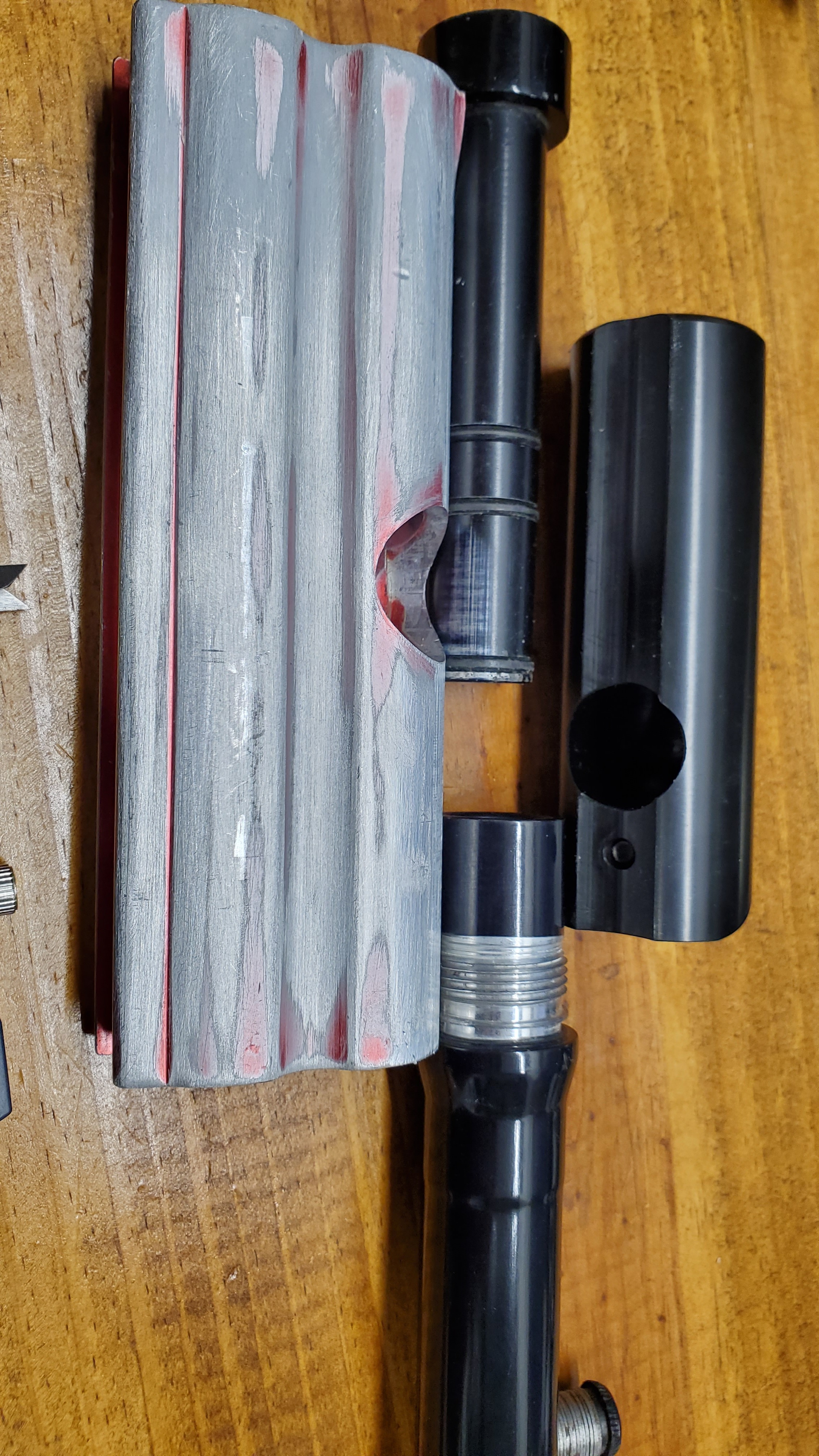

    I'm "fixing" this old Sterling, and one of the things that needs fixed is the space between the bolt face and barrel. So I'm moving the feedneck forward 0.8".
    Anyone have special "tricks" for a job like this? I'm going to plug the old feed, drill the top tube to trim the feedneck (thinking of wrapping the drill in paper or tape to protect the bore), ream the top tube to size, flex hone the top tube, then drill for a CCI feed.
    One challenge is that the CCI feed screw lines up over the barrel, of course... and there's not much meat there. I've never been a rock- back guy, but I guess I might need to learn... unless anyone has cool suggestions. I'm only measuring about 0.080" from the outside to the barrel.

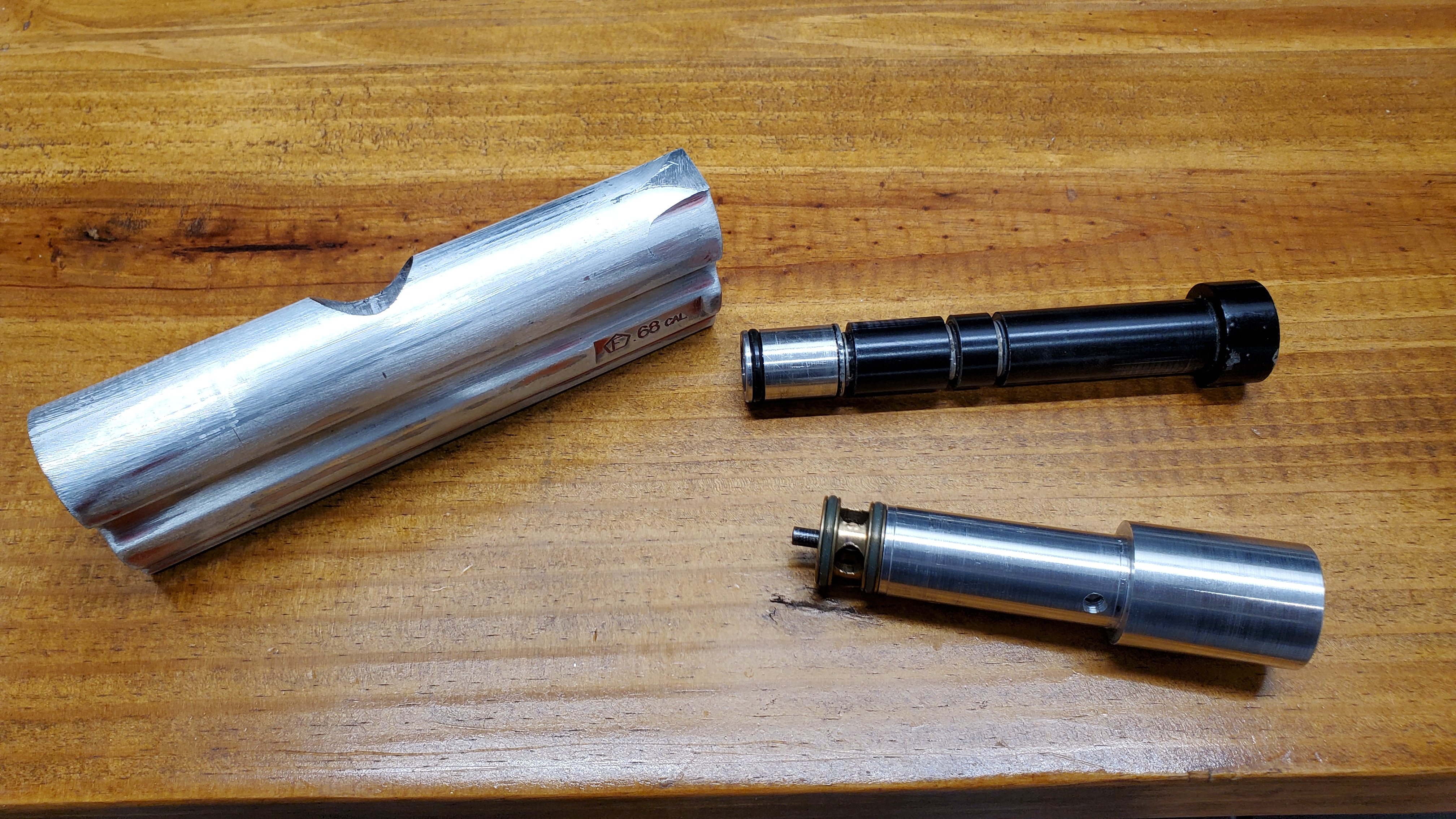

      I'd thread the original hole for something fine, generally either old SP feed neck, or old Angel feed neck. I'd turn a plug to match it, thread it appropriately, and then slather it with red Loctite and screw it tightly into place.
      Once the adhesive has cured, I'd bore and ream the bore back to size, and then spot, measure and rebore the new feed port- which, if you're using the Phantom feed, could be straight up/vertical.
      The plug will never be invisible, but with care can be filed and smoothed to the body profile, and then when reanodized or Cerakoted, will be almost unnoticeable.

        I can't "bore" the body - my little 3-in-1 only has a 3-jaw with lots of runout - but I'm curious about threading the plug, now. And yeah, Loctite and Cerakote will be happening.

              What about just cutting back the top tube and rethreading for the barrel of choice based on the existing bolt length and feed location. Now this should be done with machine tools but without having the body to make measurements and check clearances.
              • flyweightnate
                flyweightnate commented
                This was my first choice; the way the old Sterlings are made, there's not enough web bergen the tubes. A typical barrel would have to be cut into the tube where the hammer goes. Not like a Merlin, where they're almost 0.25" between tubes.

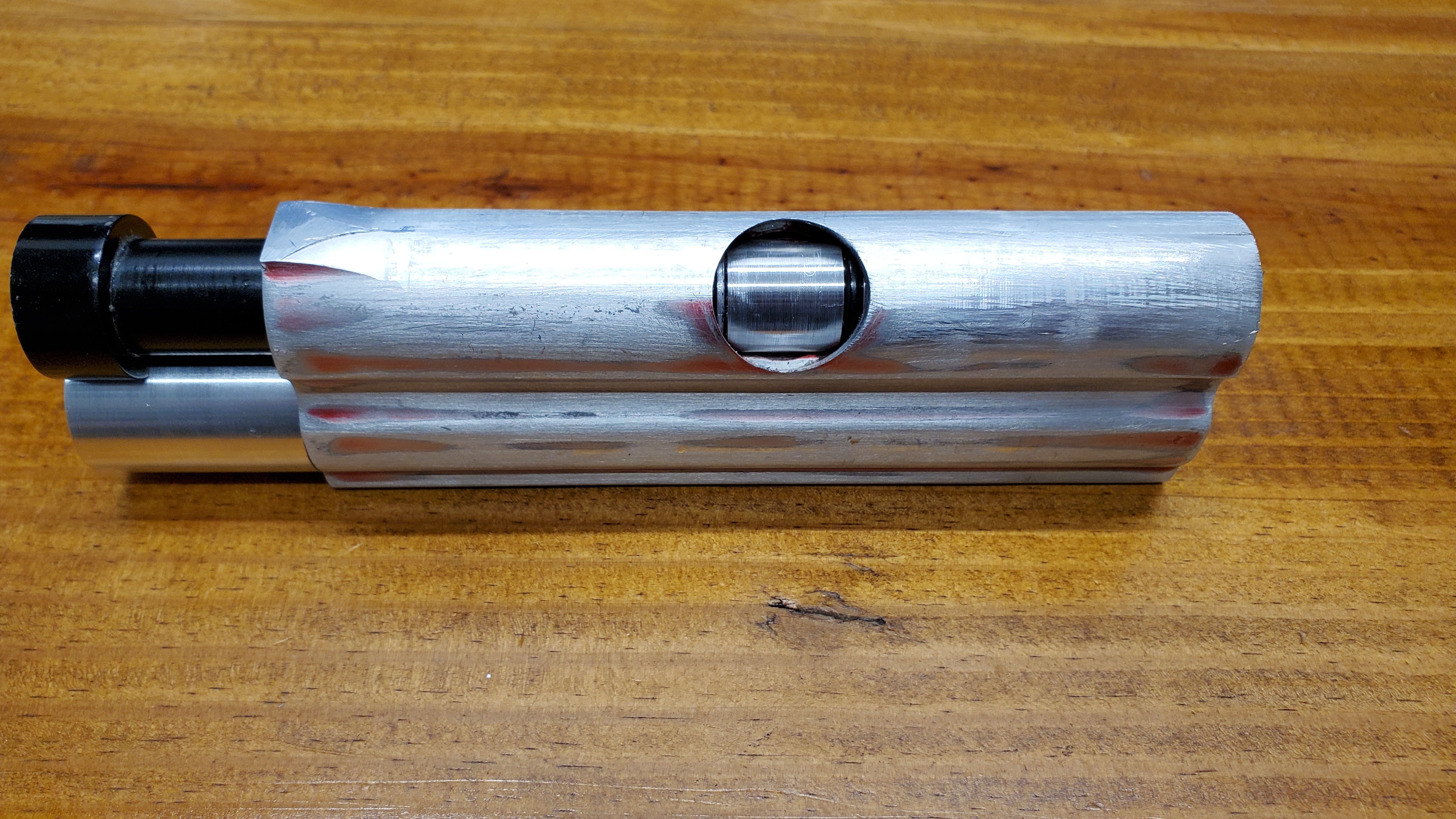

                I'm almost through the woods on this one, just waiting on the reamer to arrive. I'm shocked at how soft the base metal is - lots of deformation when I pressed in a plug with only 0.004" interference. So I might be taking a crack at a new body a bit later... but I think this one will still work as intended.
