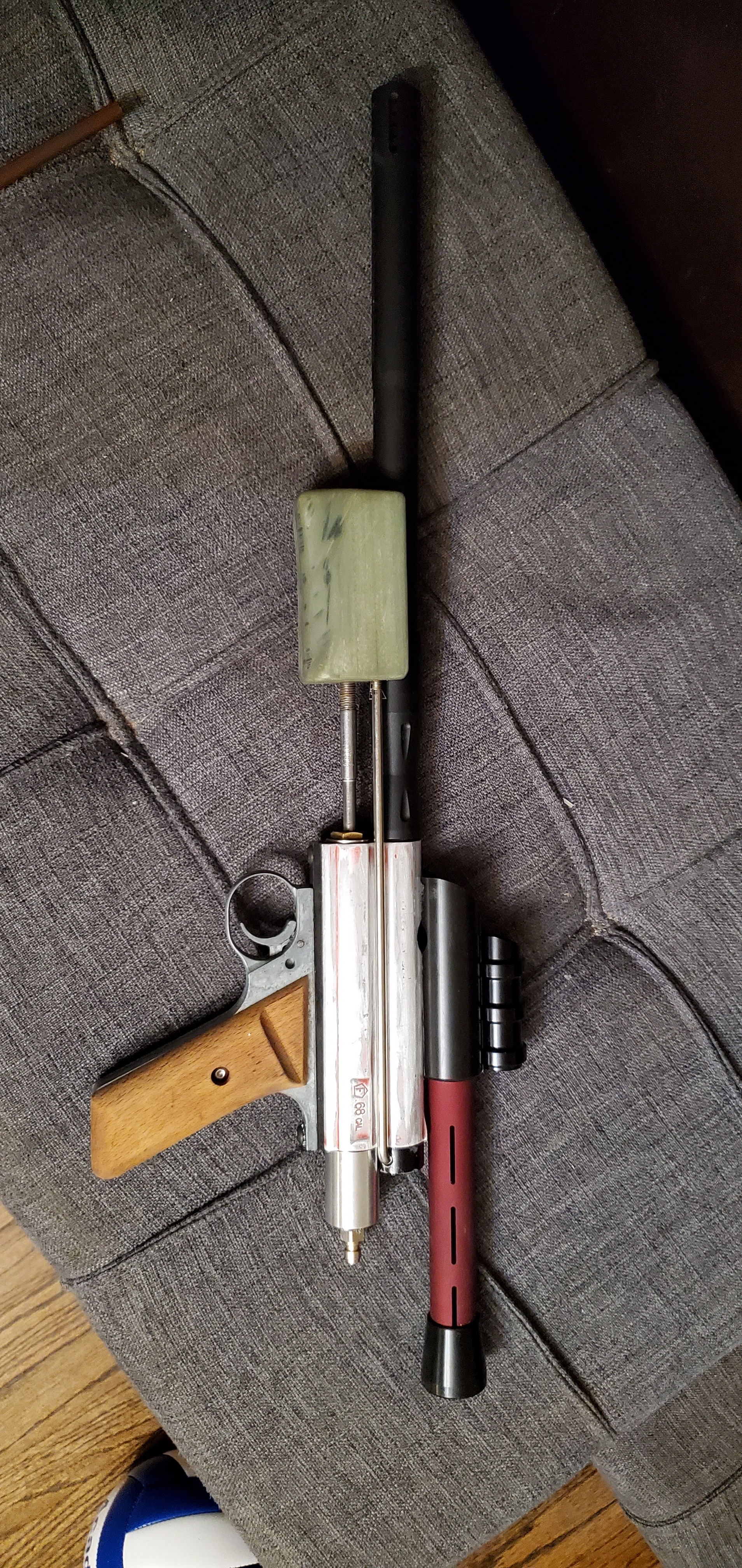

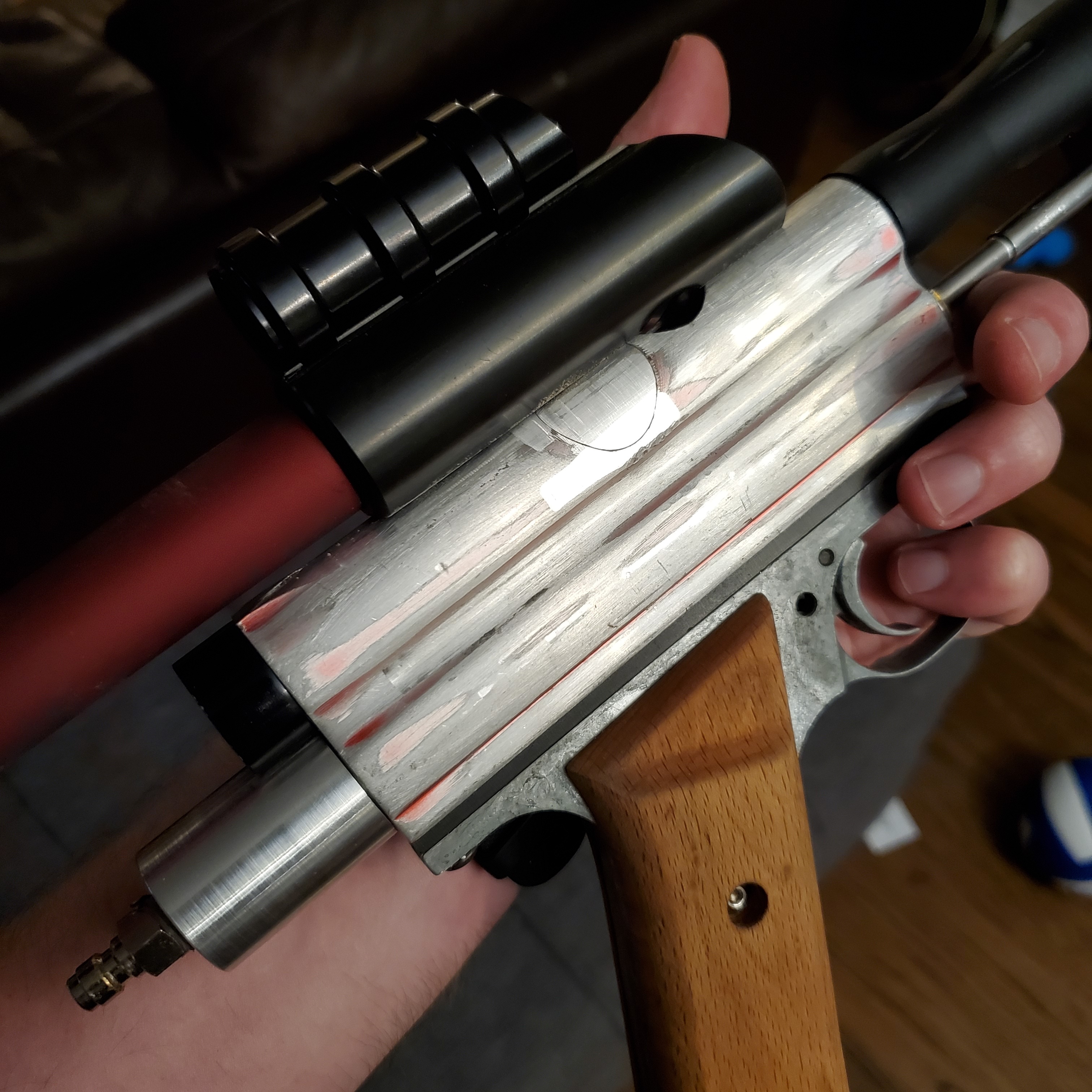

        Finally got around to finishing this. Or at least this part of it.
        Idiot marks here and there - climb milling on a mill/ lathe with backlash will do that - but functionally, it does what I want. It actually feeds the ball into the barrel, which is a bit of a novelty on a Sterling, and shot 277 with a .685 on HPA. (The .691 was 260.)
        Now for a detent, an extended aluminum rail (botched the first one since it's longer than the travel on my cross slide), and some plumbing.

          Looks good.. a little bondo and a duracoat and the world will be none the wiser. I’m guessing you made that valve housing?
          • flyweightnate
            flyweightnate commented
            Thanks - certainly needs the filler! The valve housing was easy; the 3-in-1 is lots more lathe than mill. 1/2-20 threads, IIRC, which was far more convenient than if it were metric.
