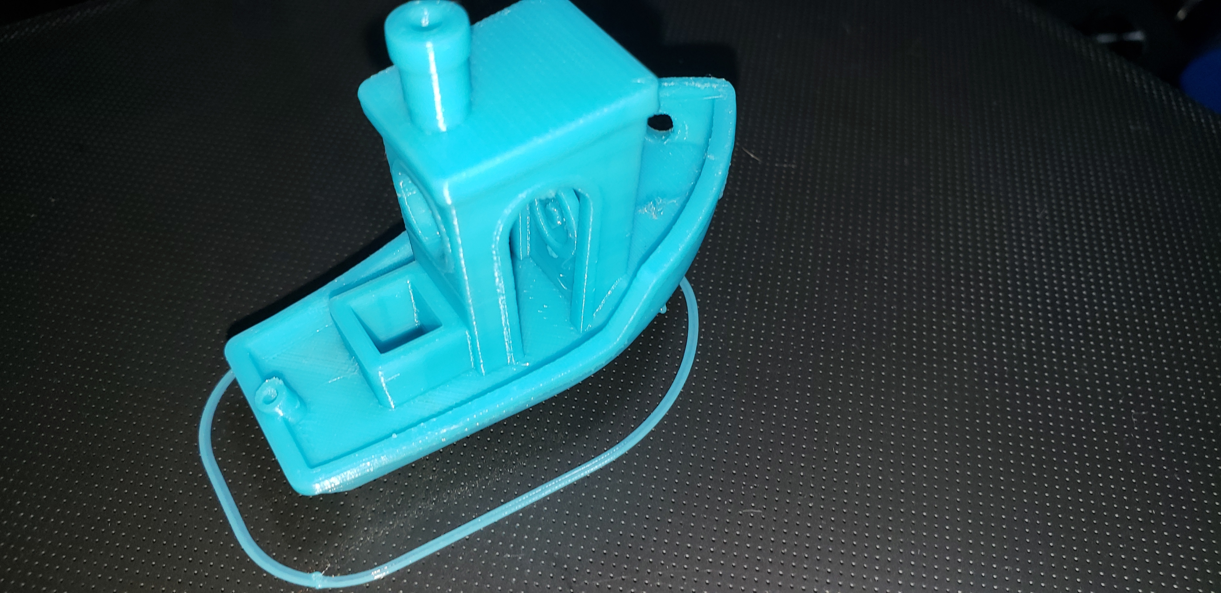

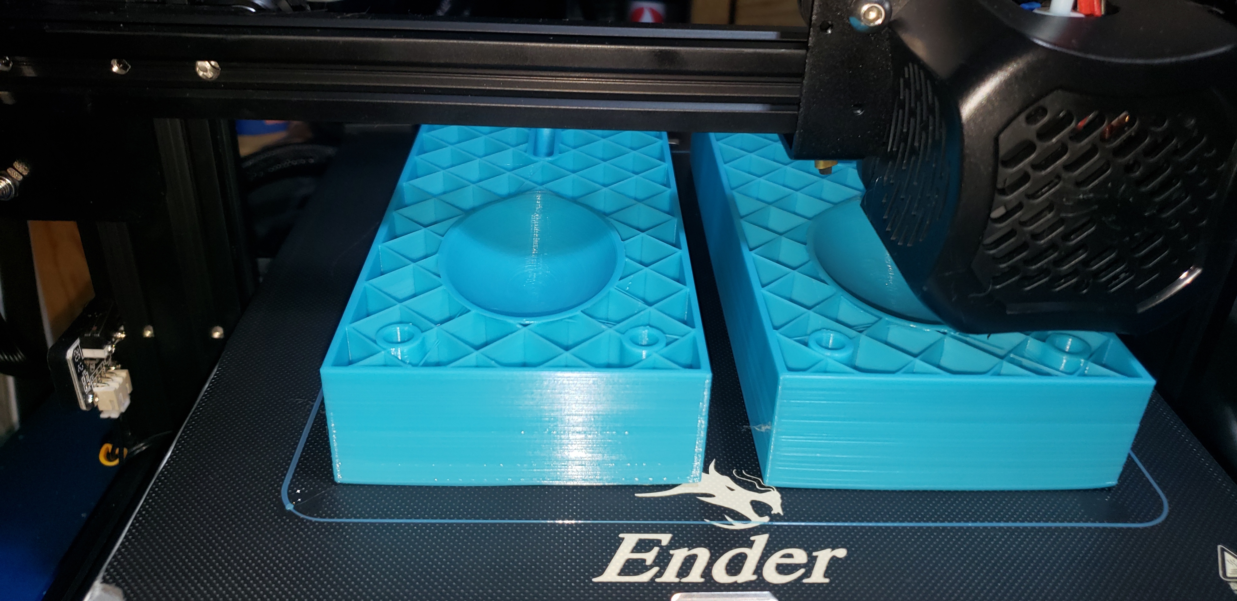

      Update! Its not perfect, but I got it printing well enough to move forward.
      Benchy looked great except lumps on my over hangs showing I likely need to tone my wall flows down a bit, but for making a mold that should be fine.
      Seeing a smidge of curling on the mold after 14 hours. But Iam hoping thats it. Ill keep messing with bed and cooling temps.
      I mqy print off a new cooling duct and extrusion housing to help with my print quality.

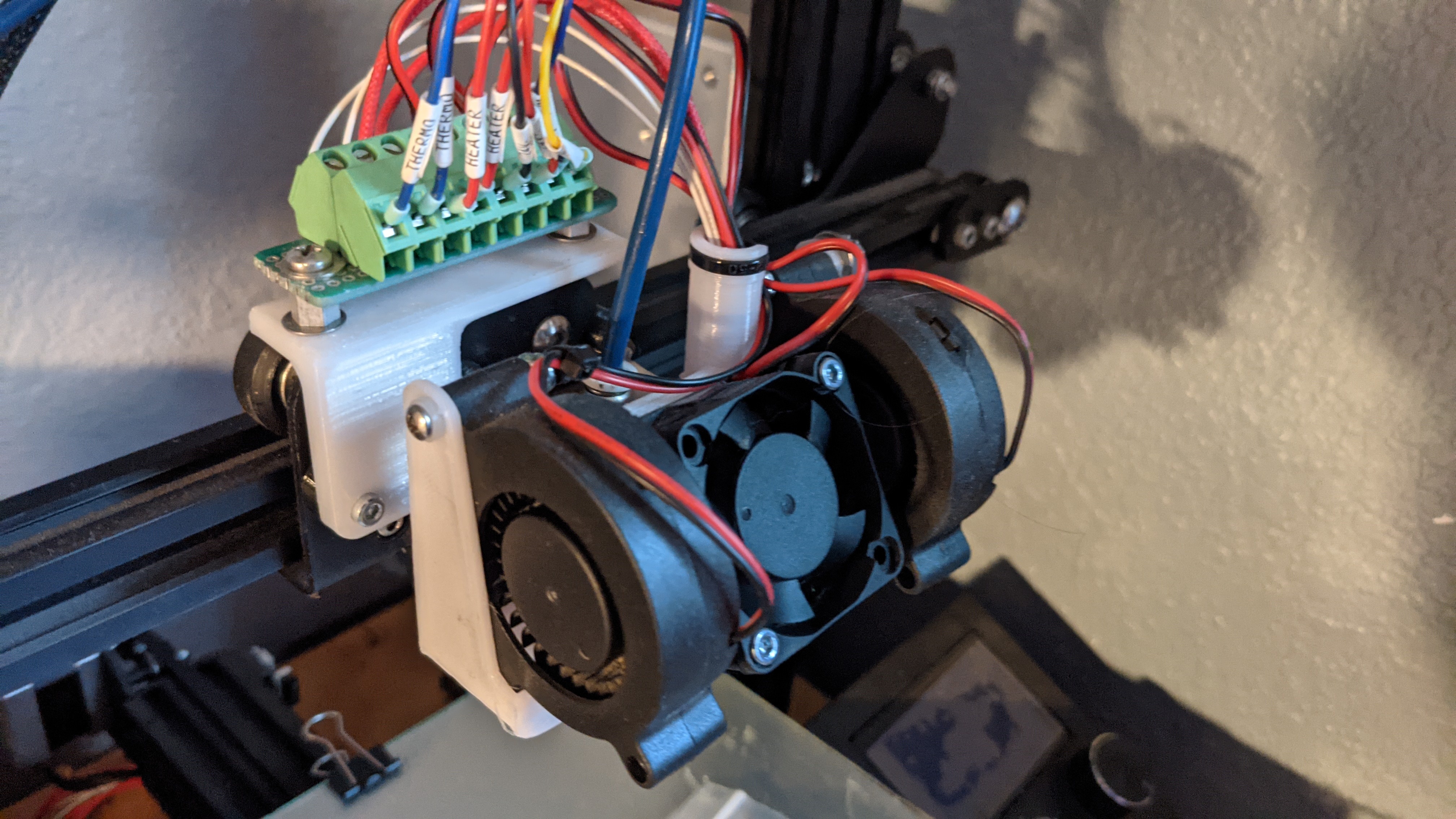

        After having some heat creep problem, I went ahead and printed a "hero me" (I think) with the biggest fans I could find ...
        also added a silicone sock to the hot end and upgraded to a titanium heat break.
        It made a world of difference in the control of the hot end.

          I went for the Hero Me Gen5
          The dual part cooling fan and room in front of the cold end fan was a must for me.
          I had issue with un-even part cooling, but mot importantly, i had pretty bad heat creep after 20-30 minutes print in the summer.
          So, i went with 2 5015 part cooling fans and I upgraded to a 4020 cold end fan; also replaced the stainless heat break with a titanium one.

          I went the cheap stuff, it is working great for me ...
          I also added a breakout board for all teh wiring to the hot end, this allows me to replace components without having to re-wire all the way to the board.
          I dont understand why no one does it ... it makes working on the hot end so much easier ...
