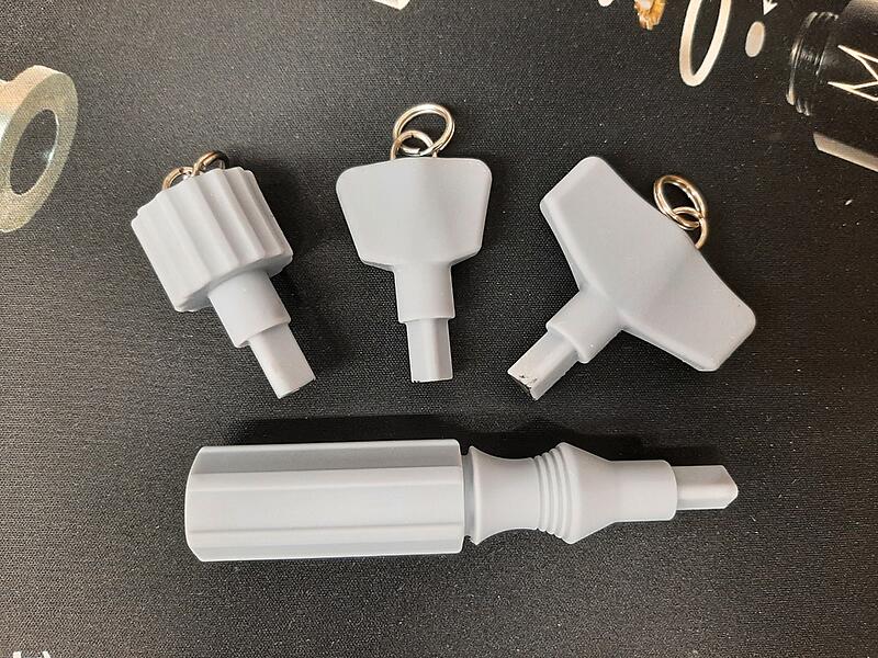

Q-Tools for Q-Loader pods. More info in my Q-Loader thread: https://www.mcarterbrown.com/forum/c...-actually-work
[ATTACH]n467145[/ATTACH]

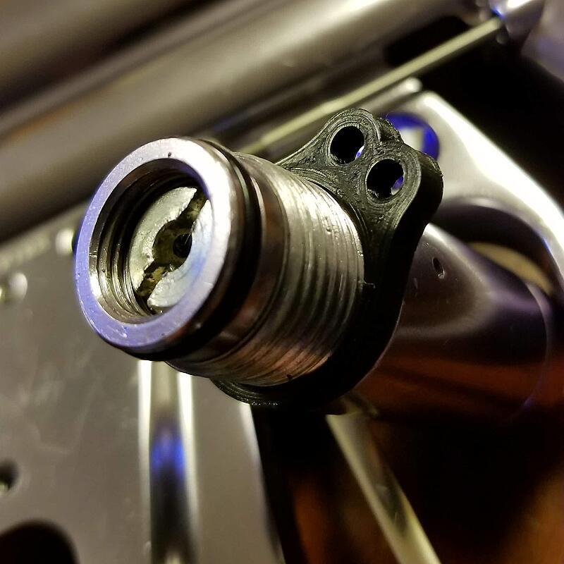

The version I printed worked for me. The main issue I've seen with some people trying to print this mostly comes down to print tolerances and post processing. What works well for my printer may be slightly different for yours if it's not dialed in the same way (see the variances people get when printing calibration cubes). This is further compounded by the tight tolerances needed to accurately print Cocker threads. My suggestion would be to sand your inside diameter smooth and test fit your inserts. -
Hey this is a couple years late but I have a question to ask. I printed the 8 inch barrel you've made but unfortunately the insert bore is a tad too tight. I experimented around in cura and at 2% higher x and y size the insert fits freely (maybe even 1.5% would be fine and a bit more snug as now it is free moving). But the increased size makes it so that the threads are too big and they won't screw in the marker anymore. Currenty the inside bore is around 19mm and maybe something along the lines of 19.25mm should be good imo. Is there a chance you can adapt this so it fits?This thread is intended for the sharing of STL files created by the MCB community for use in paintball. Please note that this is not a B/S/T thread. All posted files should be free of charge and are not to be printed for profit.

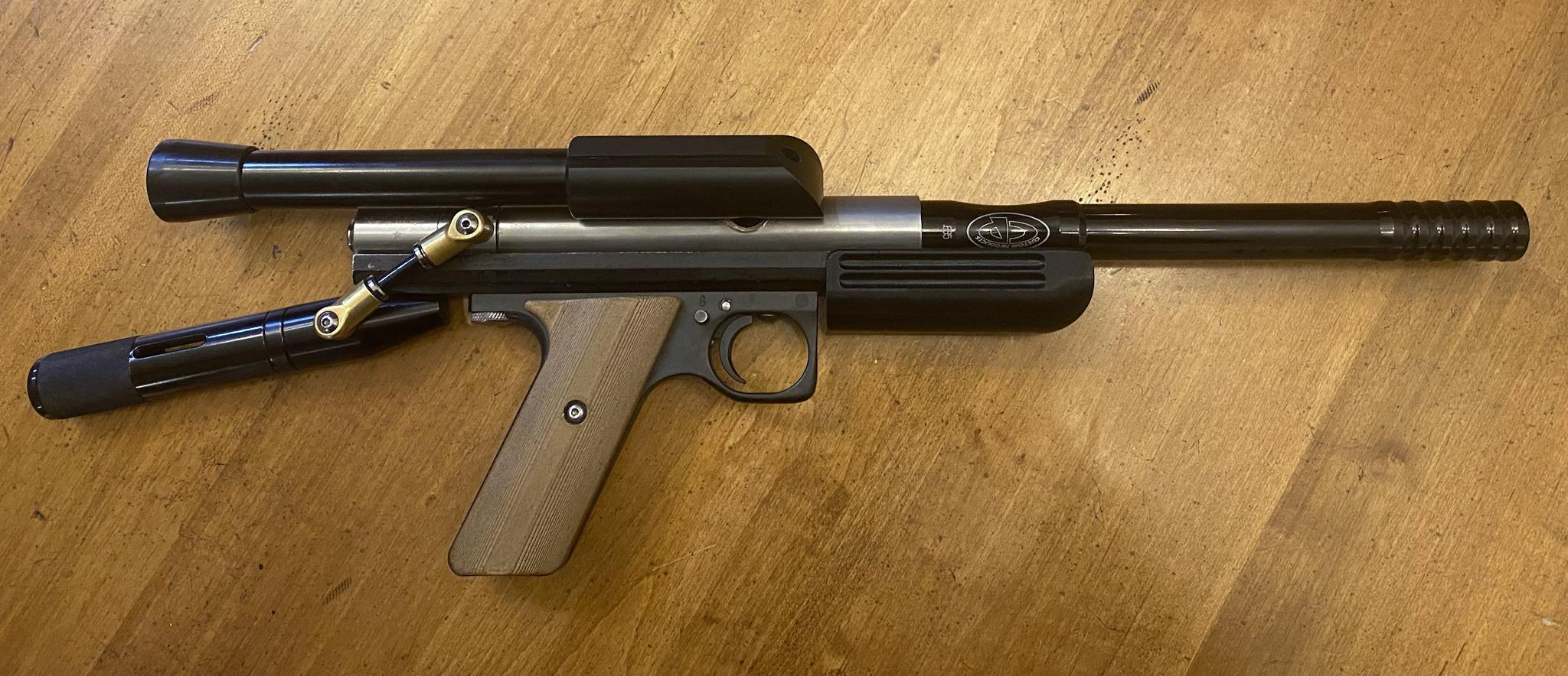

- Sheridan PGP Pump Handle (Printed Threads)
- Sheridan PGP Pump Handle (Threaded Brass Insert)
- Sheridan PGP2 Extended Feed Plug (Reinforced)
- Sheridan PGP2 Front Feed Cap & Sight
- Sheridan PGP2 Loudener / Ray Gun Tip
- Sheridan PGP2 Ported Barrel Tip
- Sheridan PGP2 Rear Sight

Edit: So I had my brother in law who knows more than me take a look and he made a version with a 19.25mm inner bore. I'll print it and test it and if it works I will post it as a remix to your file.Last edited by Tedi1997; 09-15-2023, 08:24 AM.Leave a comment:
