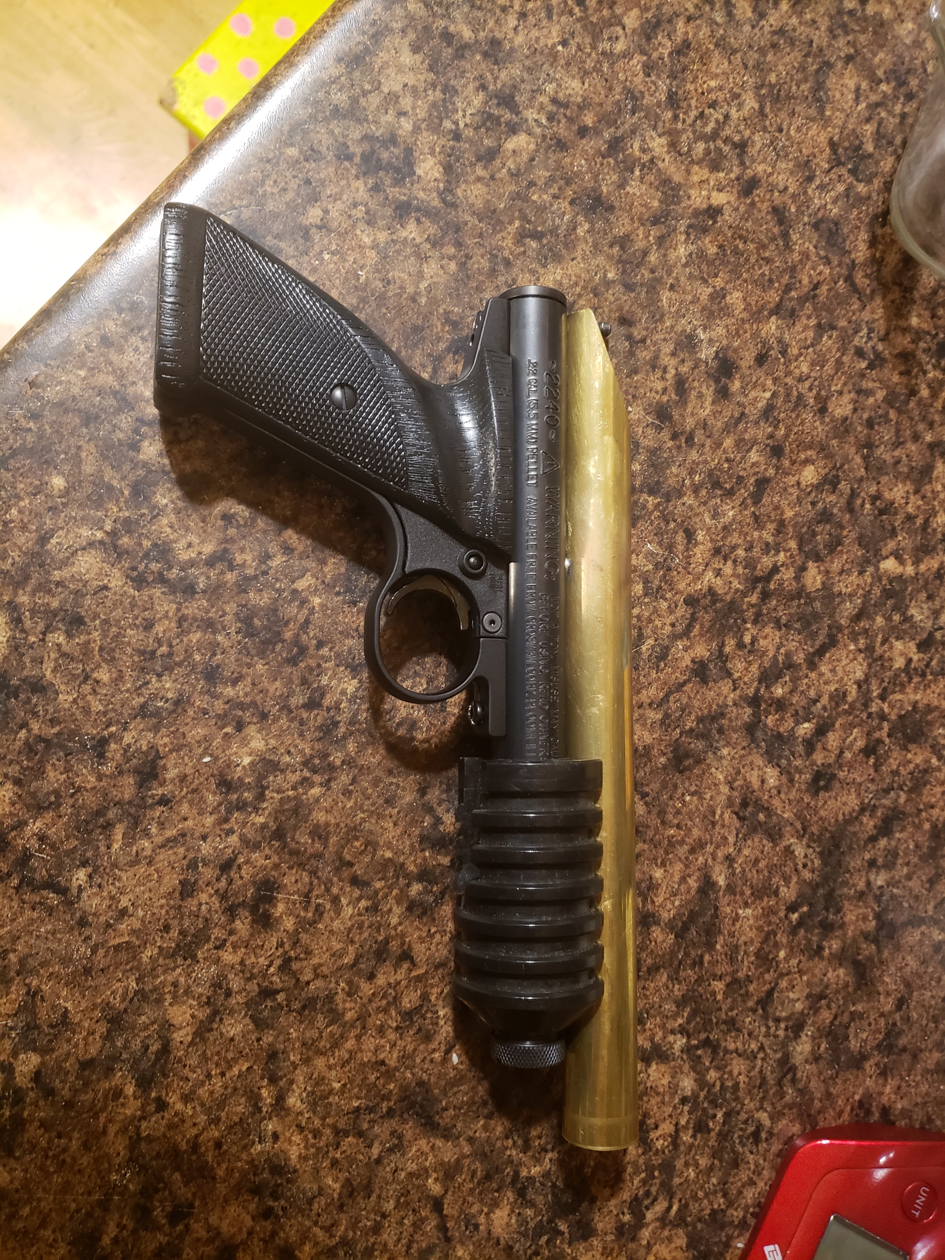

      It's for a project I'm working on, in case this sparks interest....
      I'm converting a Crosman 2240 series .22 cal pistol into a modular Sheridan clone.... everything will bolt together vs. being soldered.
      So far I'm at this:
      I started with a piece of .750 ID tubing and pressed a piece of barrel tube into place for the breech... it's going to accept Freak inserts as well, and likely have a bolt-on breech block so I can run 10rnd tubes or single shot.
      Still deciding on bolt-action or pump.
