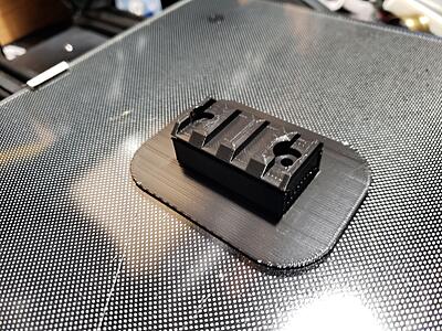

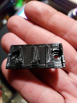

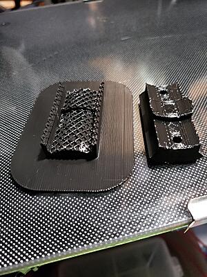

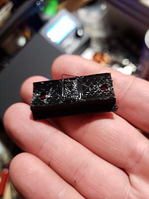

        Alright. Print is running. I put it inards down with support and a raft. The raft was just for funsies. I figure cleaning the part you dont see up with sand paper is best.
        My extruder has stipped a few times my last print, so Im running slow.. cura said about 2 hours to print. But the printer times always seem tp slide.
          • 3394

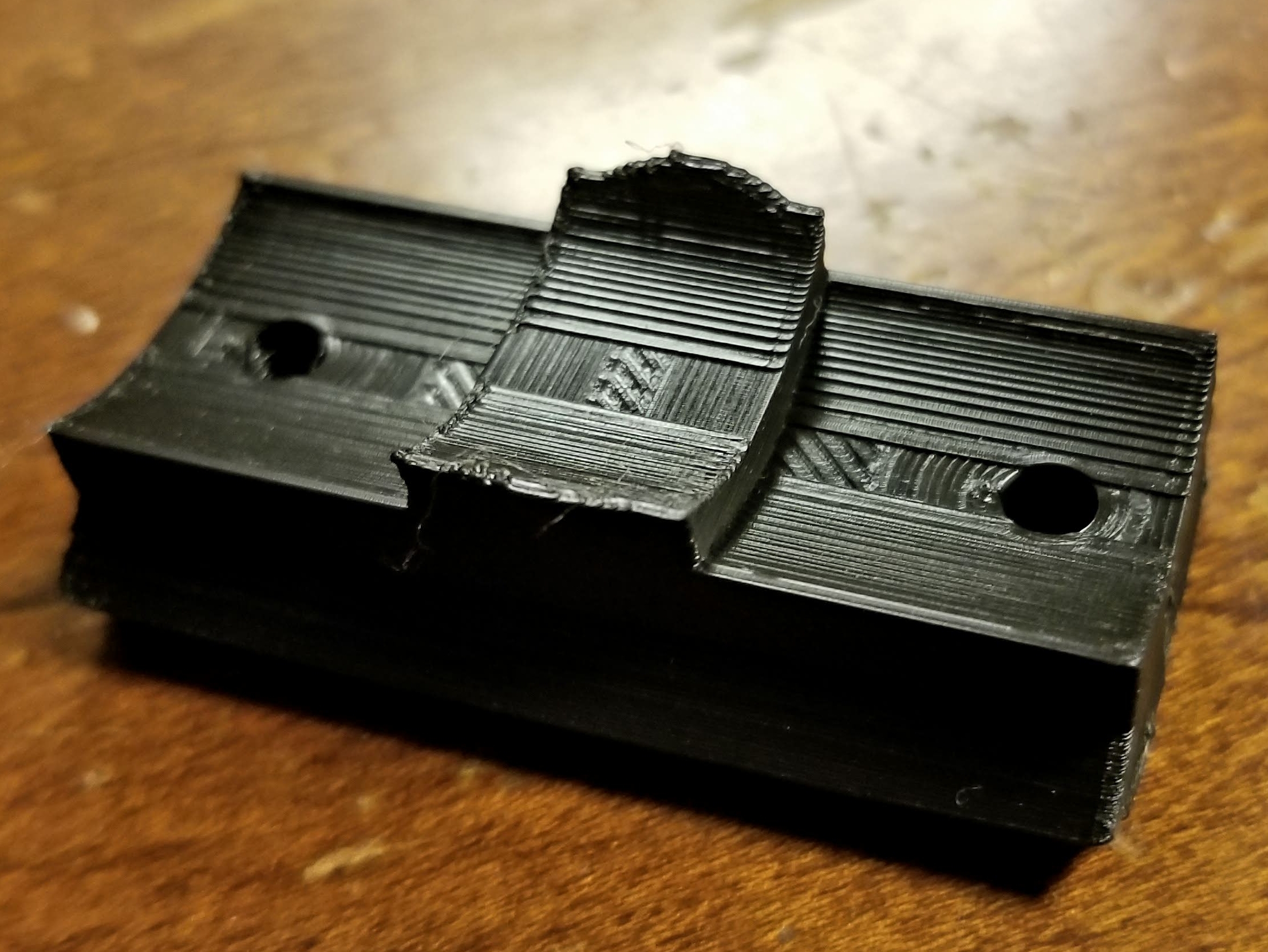

          First attempt was a failure it printed, but its not pretty. Got my black in the dryer. I loaded my natural in my nicer printer, and I'm trying the program again.

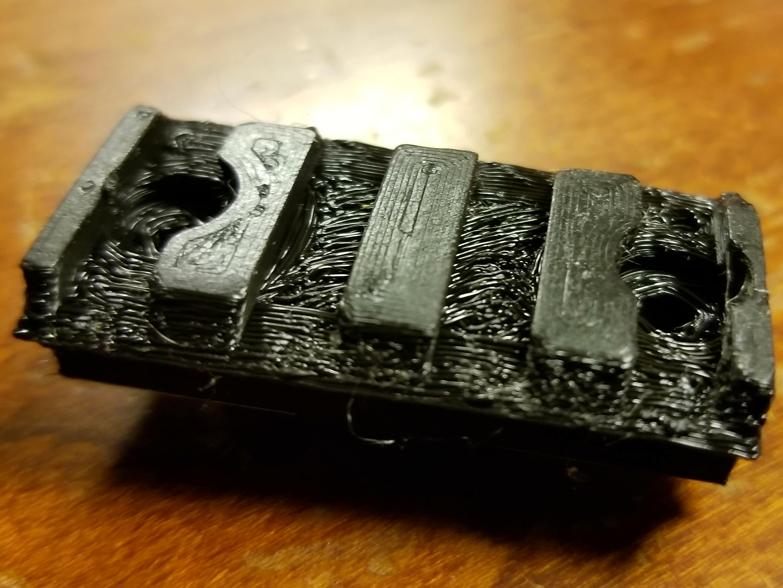

            I'll throw my hat in the ring. I have some black Overture PLA+ loaded. One cover should be about 3 hrs. If it works, I'll print a few extra for good measure.
            Velcor will save us...
              BrickHaus commented

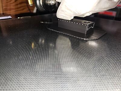

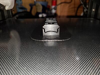

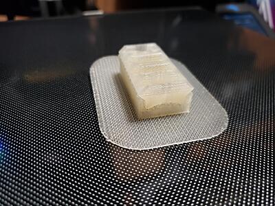

              Picatinny down? You going no support there? Maybe ill try mine different. But my natural one looks good so far, and maybe you can see the ball color through a natural one.
            • OpusX
              OpusX commented
              Going with tree support. Should allow for a smooth ball face
              BrickHaus commented
              I may flip mine and make another tomorrow.
              I figured make the visible parts nice, and sand the ball face, but we shall see. Its much past my bed time, but there's 10 minutes left on this print, and its better than prime time tv.
            • 3394

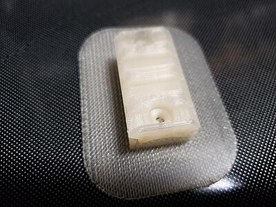

            Natural was a success, but I think it would look better like OpusX is printing his. I started another natural with this same file, and Im hitting the sack. Ill flip the part and make a new file tomorrow.

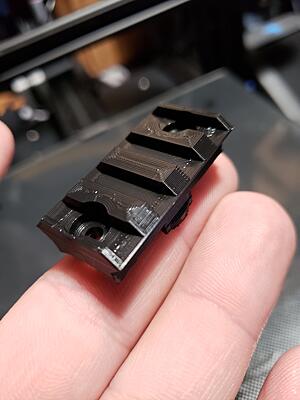

              Well shes done. The rail troughs look rough as expected due to the tree supports but the ball side is smooth.

                  I got a black one on the bed of my nicer printer. Ill be gone for work before its done, but the support material looks nice so I assume it'll print nice. Ill probably spit out a second black for good measure and send them all. Im tempted to toss the naturals in a rit dye bath just to see how natural filament looks dyed.
                    • 3394
                    She was done before I left. I didn't have time to inspect, but it looked nice.
                      • 3394
                      There is something really satisfying about getting a clean break from a raft and supports.
