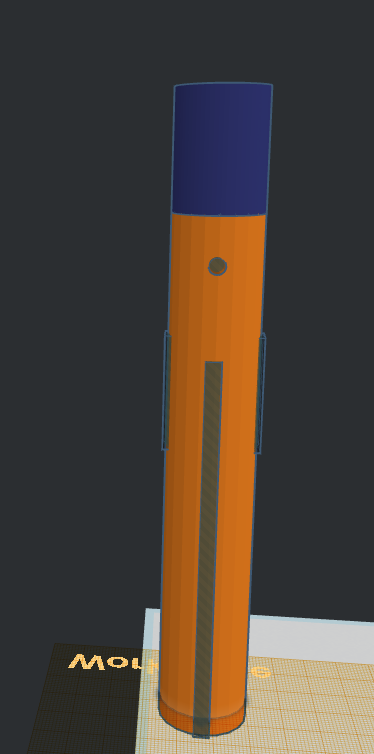

    So i'm real cheap, and I've always wanted a phantom. This thing is a work in progress. Have test printed, Hammer,bolt,and pump slots are spot on, Spyder threads because I couldn't find any other female threaded model.
    Thoughts, questions, idea's? Anyone have Autococker or Ion threads in a female pattern modeled?
    Future plans to add ASP style detent holes, or VL/spyder style detent alongside the feedneck.
    https://www.thingiverse.com/thing:6113800
    reuploaded to fix missing hole.

    The funny thing is for me and a lot of people, starting out on a Trracer meant Phantoms were a disappointment. If there were better barrel and feed options, you can’t beat how smooth a nice factory Trracer is.

      My frankenTrracer, (started life as an ACI hornet.), shot fine back in the day('11-'12?), this is for modern convenience. Center feed,better barrels and NO NAIL POLISH!

    There's a market for these with cocker threaded bodies. On MCB 2.0 there was a run of Trracer bodies with cocker threads. I'd be a customer with a centerfeed option screw hole like the Phantom.

      If I can find/ or someone can model the female autococker threads I'd be stoked to see a remix or model it in myself. I lack the capability to model threads.

      According to this thread https://www.pbnation.com/showthread.php?t=803907 autococker barrel threads are 15/16-20 and spyder threads are M22-1.5

        Yo.... how do people make threads or get the model for threads ??
          XEMON commented
          Your cad software should have a threads section where you can make a bunch of pre design ones, or you can always design your own profile and spiral cut/extrude it ...
