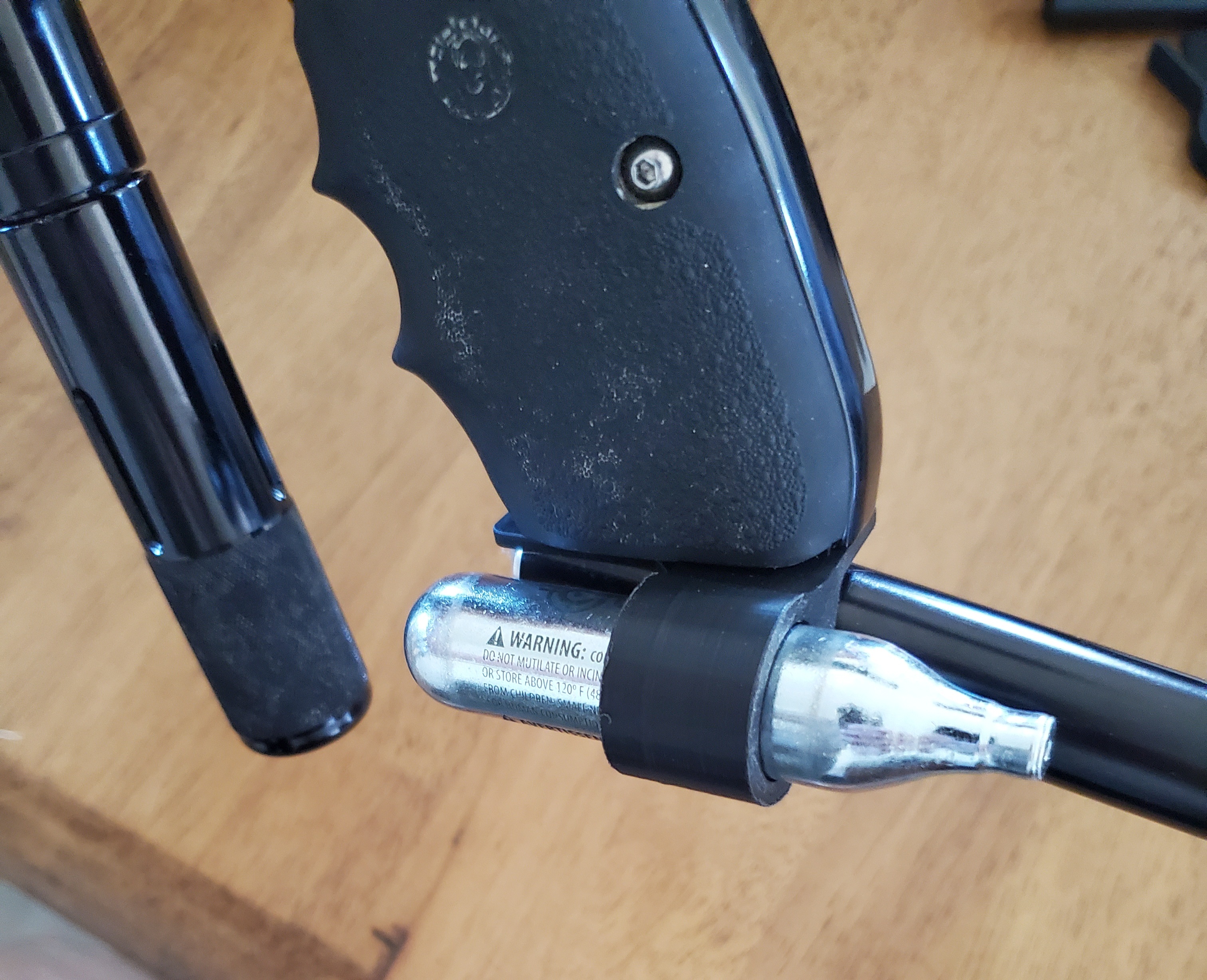

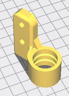

    olds a CO2 so I can use my thumb to bump a fresh cartridge into the changer bucket. Uses two size 020 o-rings to hold the cartridge in place. Even within the same brand, the cartridge diameter varies a lot, so I have to try two or three cartridges to get a good fit.
    0.20mm layer height
    100% infill
    Files for download:
    https://cults3d.com/en/3d-model/game...gle-12g-holder
    EDIT: I added a double holder as well.

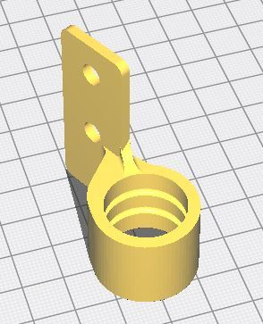

    EDIT AGAIN: Increased the single holder's plate from 0.100 to 0.300 inches thick. Printed at 100% infill, it's rather sturdy.

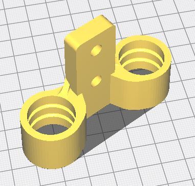

        Could you make this double sided?
        • cryogenic76
          Matt
          • Jun 2023
          • 21
          • Santa Maria, CA
          Yes, easily--just a copy and paste of the first side. Without a stock, it could hold a third underneath too. Only issue is that with my intended "use the thumb to press the CO2 into the changer bucket", the second holder would be hard to reach.
          EDIT: Updated to hold 2. I thickened the plate the ASA crews go through to give it some more strength. File is posted with the original design here:

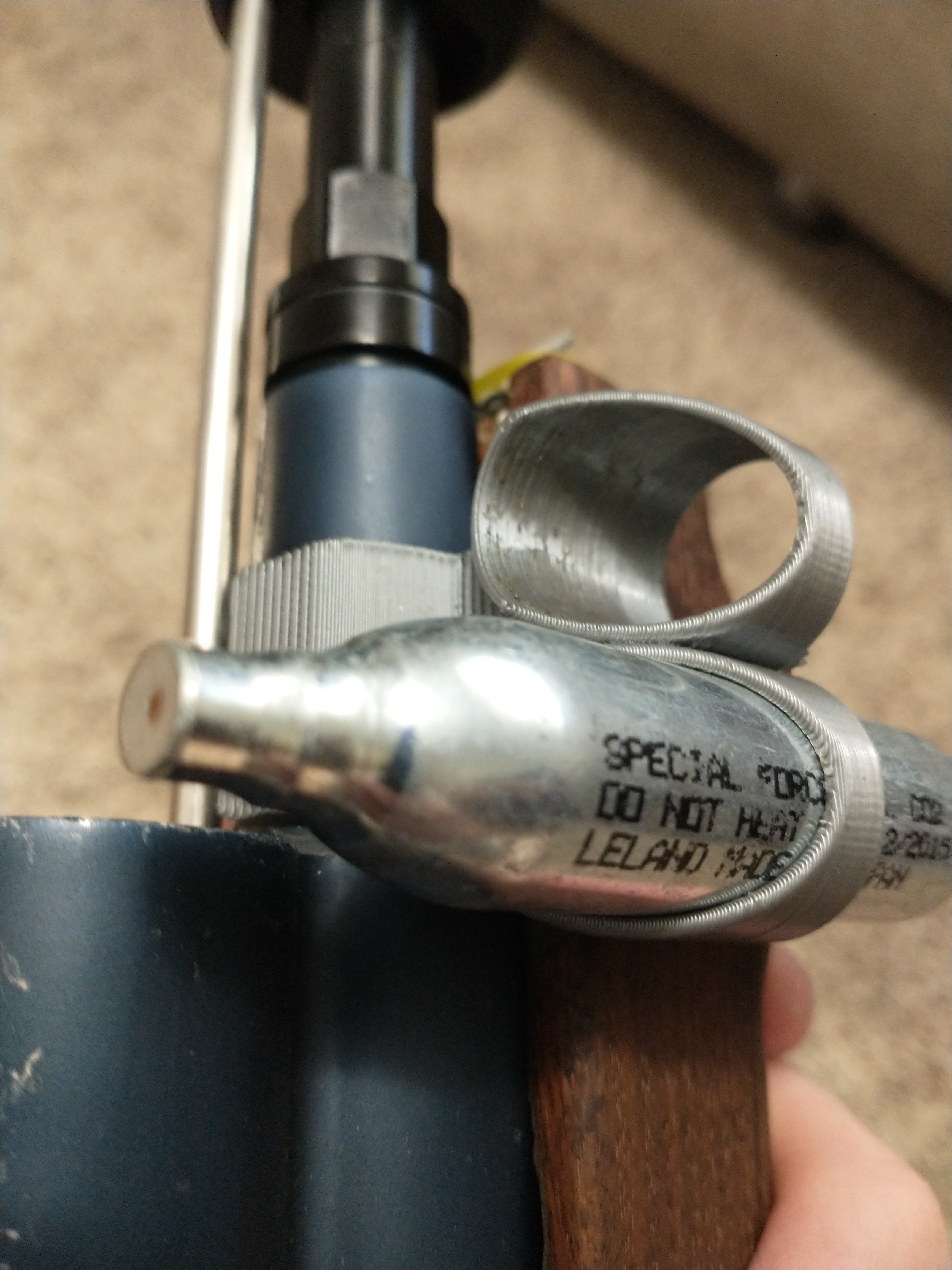

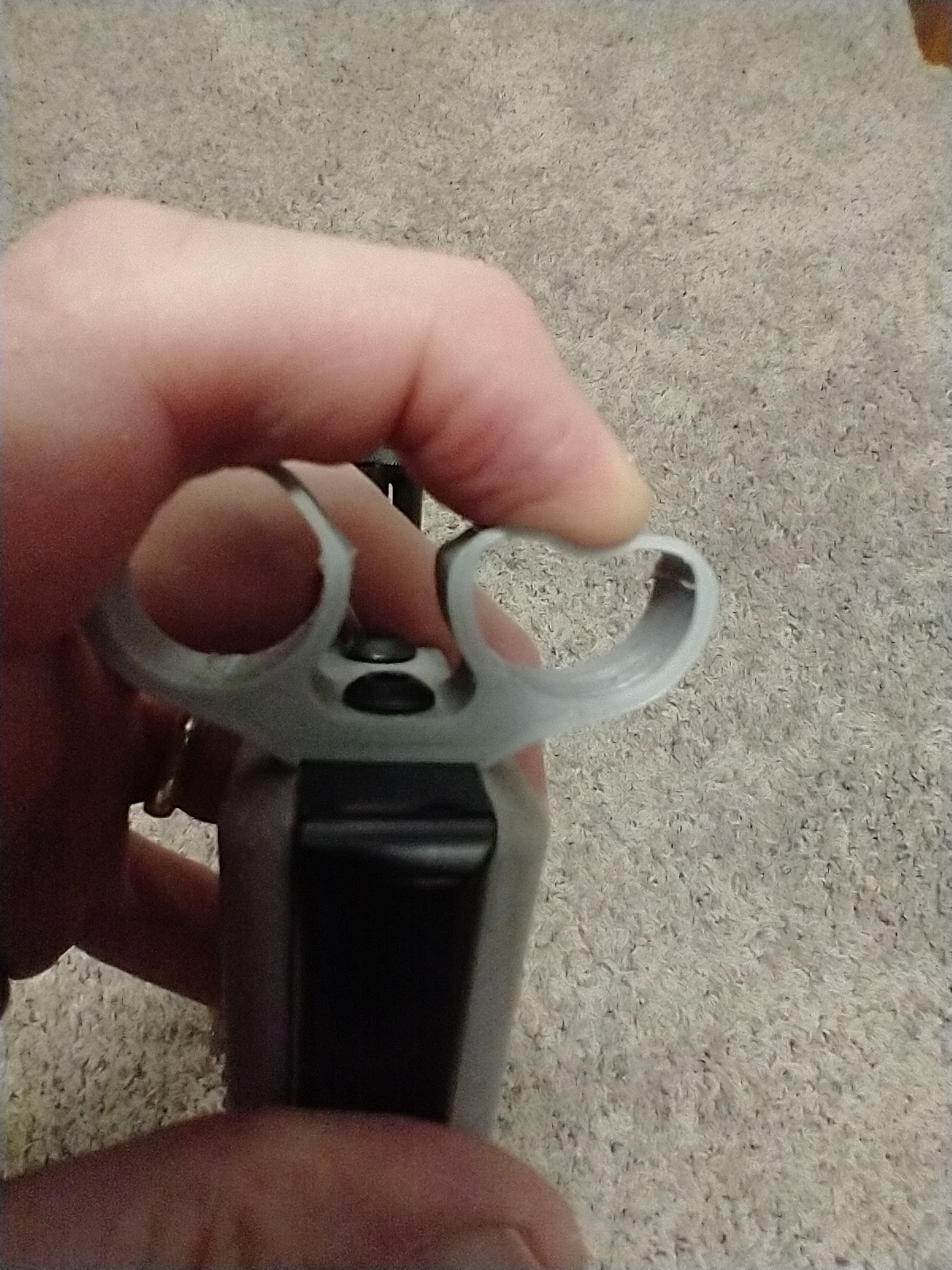

            Here is a pic of a side saddle mount. It is printed in something hard, with some rubber cement inside to give it better grab. It mounts in the 3-way screw holes of the trilogy body.
            This is a bottom line mount, designed to be printed entirely in TPU. I doubt it will work well in hard material as the rings are not round and flex to hold the cartridge. It is cheap, but tough.

            In offering my TPU holder to our group, it seems we only have one other marker that is a candidate. 🙄
            However, the spare cartridge desire is still there for a few others, so I dug this model out of my files a and fixed it up.
            https://www.printables.com/model/546...artridge-clips
