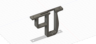

    Click image for larger version  Name:	thumb_69434.png Views:	0 Size:	74.9 KB ID:	505281
    $113 for this grip frame

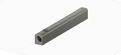

    Click image for larger version  Name:	thumb_69436.png Views:	0 Size:	73.6 KB ID:	505282
    $193 for this body

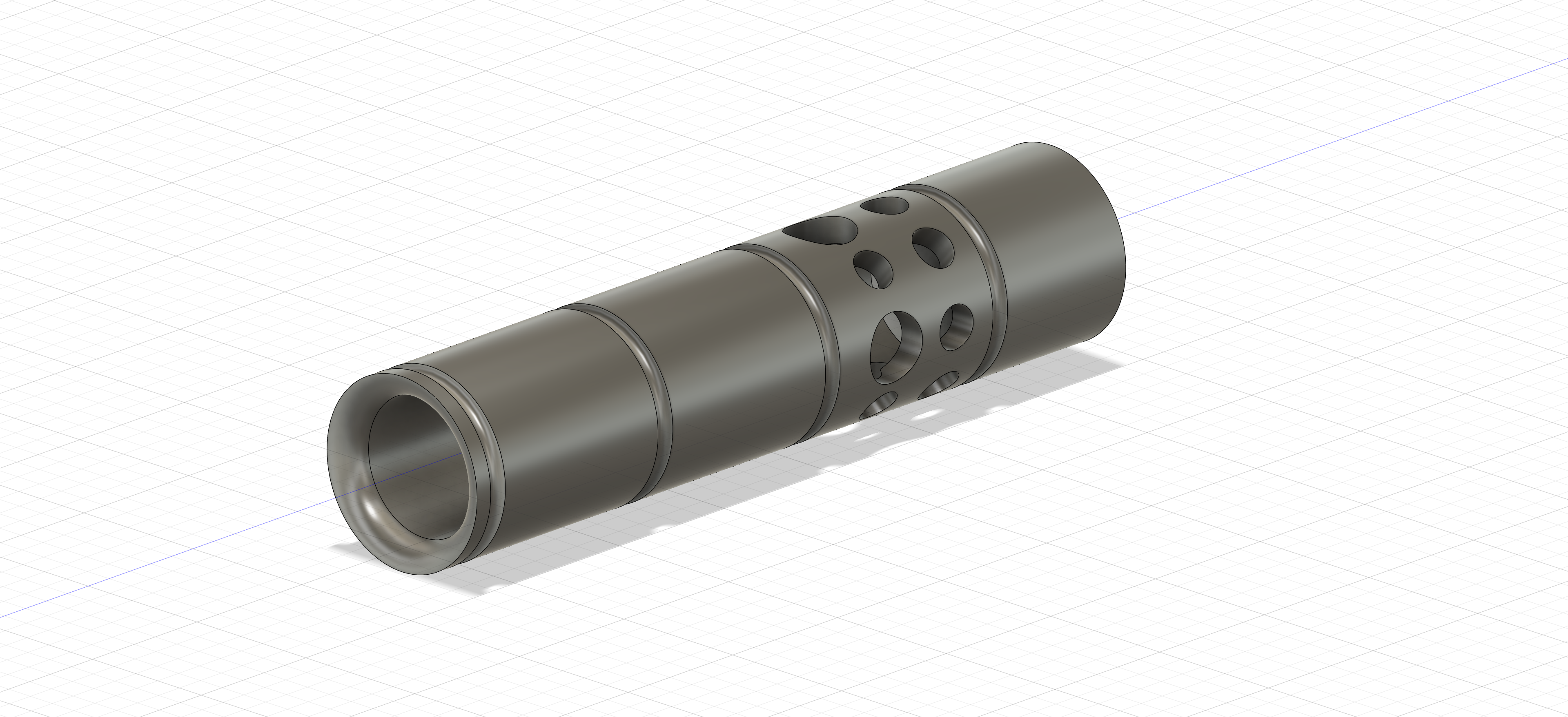

    Click image for larger version  Name:	thumb_69438.png Views:	0 Size:	60.8 KB ID:	505284
    $11 for this bolt.

    Grip frame $204 for one, $66 apiece if I buy 10 (which is way more than I would need for prototyping)
    Body $168 for one $57 apiece if I buy 10, and that is with all the threads tapped but without anodizing
    Bolt $128 for one $26.70 if I buy 10

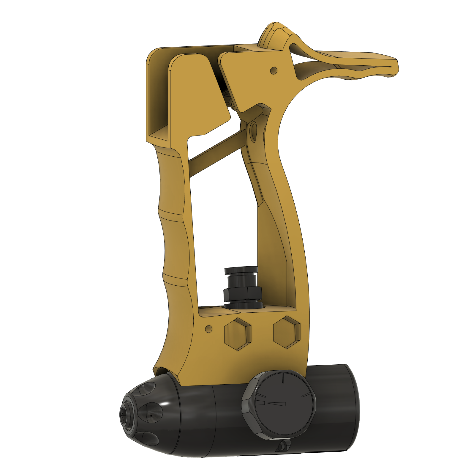

                  Hey just curious about this grip frame. A friend of mine is looking for an HPA grip for his airsoft gun, and this looks close. They take the AR style mounts but have space for the HPA line. Is this in a similar vein?
                • devilzcall
                  devilzcall commented
                  That's exactly it. not for airsoft in my case, but should be compatible. These empire ASAs are sometimes not easy to get ahold of, and you need the BT07/15 mounting pieces that came with the on/off originally. I'm happy to share my files if i deem this serviceable.
                  Other than this, i can highly recommend the MAD hpa grip system, it supports a lot of cheaper regs
