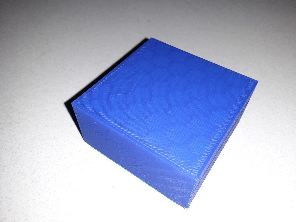

          Finished my first test.
          Click image for larger version  Name:	3zYX97zh.jpg Views:	0 Size:	156.2 KB ID:	10235Click image for larger version  Name:	xYsaKAeh.jpg Views:	0 Size:	76.8 KB ID:	10236
          No stringing, nothing seemed out of the ordinary aside from that 'preload line', the printer didn't make any dubstep noises.
          Need to find a trick to make it stick a bit less though. The stock blue cover is absolutely ridiculous. That thing was welded on there.

            Nice! Looks pretty good man! For test prints, there are several good ones on thingiverse to reveal a little more insight into your settings, with overhangs and bridges and towers and stuff.
            As far as sticking too well, something like that box that has a big flat bottom with 90deg corners is prone to be hard to get off the bed. If you fillet the corners on that it will help to be easier to remove.

              I've been drinking so I'll be a bit more critical than normal/
              Top is over-extruded (top / bottom solid layers)
              1 or 2 layers on the side are missing???? Not an easy issue to diagnose. Retraction / partial clog??
              You have a moire or some sort of texture... which is fine.. I love my moire... but speed / accel can alter this maybe.
              A positive is, a simple large cube like that, is possibly the hardest thing to print to be reviewed. After 4-5 years of printing, it's the 'primitives' that scare me the most to print lol. Complexity seems to iron out a lot of printer issues (or can magnify them haha)/

                This is just a preprogrammed test cube. Just select the file and hit 'print,' not even the slicer program involved.
                Heck, it's not even a cube. It's 40x40x20. But I figure they use that because it will make it very obvious if something's wonky.
                Anyway, nothing seems to be missing. That 'gap' is a trick of the flash and texture.The rest I
                There does seem to be a type of texture. It's really not that bad--the moire effect makes it look worse--but it is there. I'll be grabbing a file I can tinker with instead of the pure G code this is, and seeing if settings won't alleviate that.
                I'll have to test out settings for the big flat bits. The bottom especially is pretty rough.
