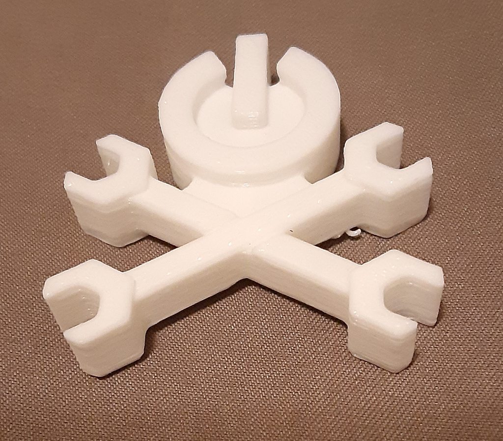

    Deus Machina Have you printed anything else so far?
    A test of an old model I made.
    It's hard to get a good picture of white. And I forgot it wasn't flat on the back so it spaghettified a little on the bottom where I should have put supports.
    I haven't played with it much because I work 12-hour night shifts, not counting prep times. So no seven-hour prints until my days off.
