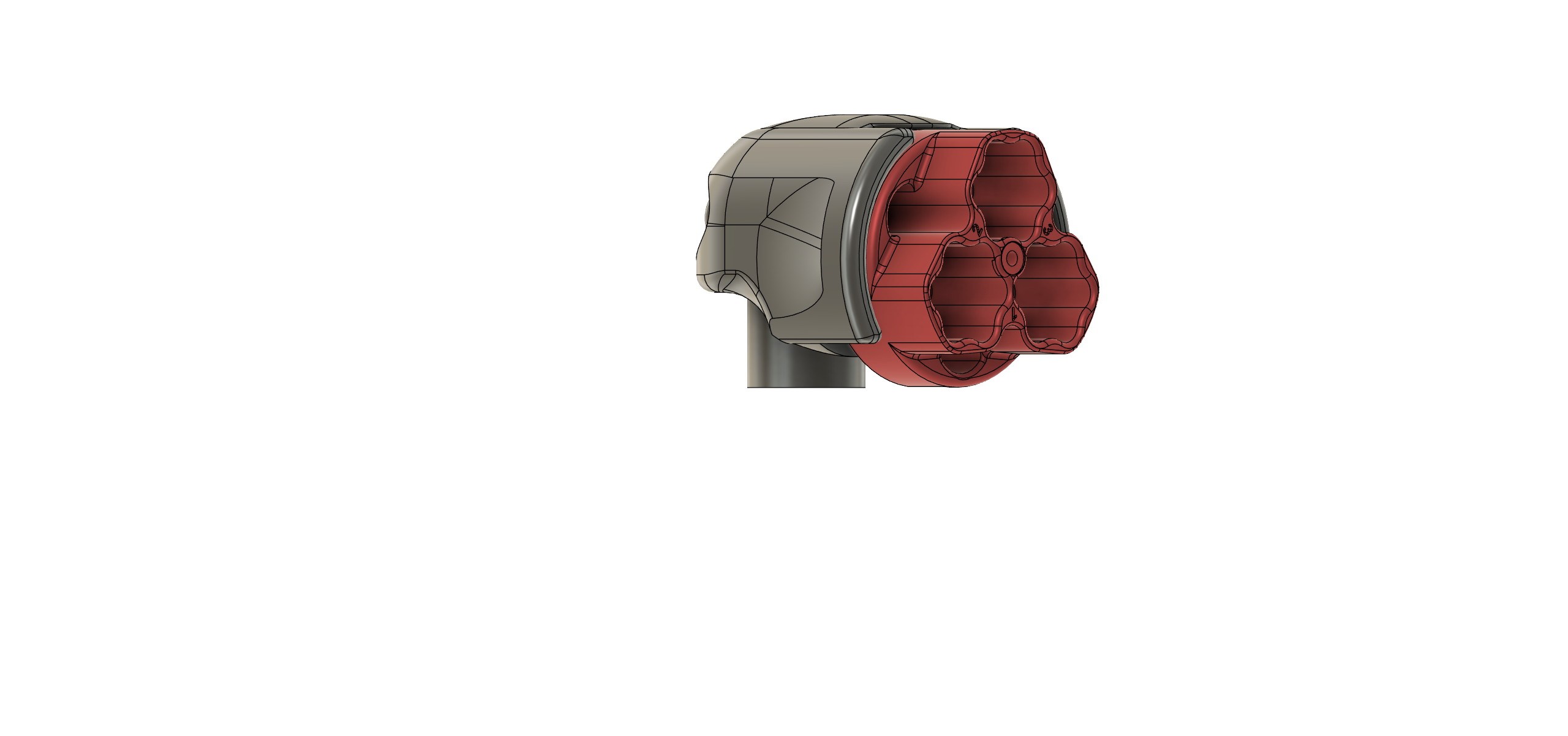

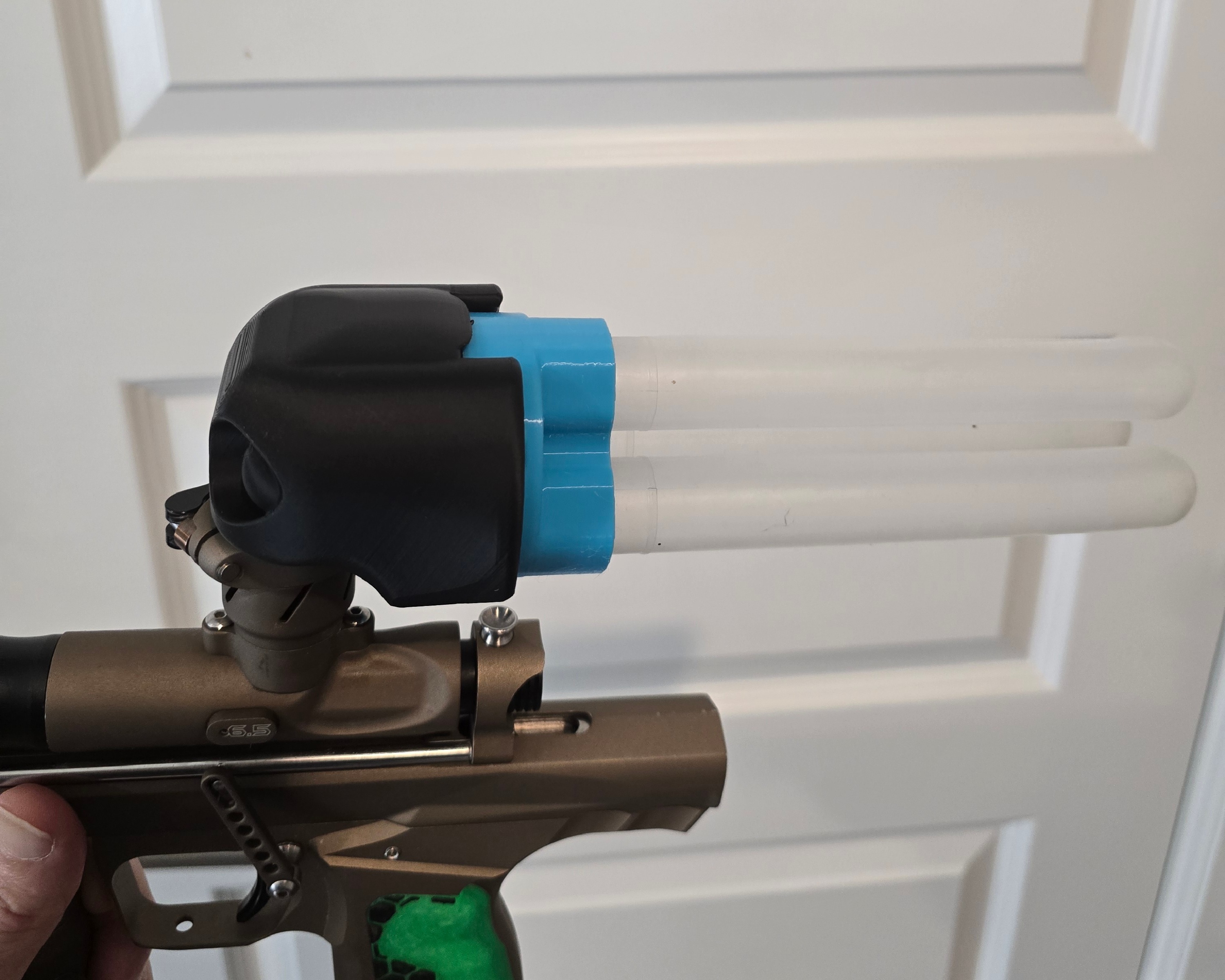

    Hey All,
    I turned a shower thought into a new design and was hoping to get some feedback.
    Thought:
    How can I add capacity if I want to run 10 round tubes?
    Concept:
    Revolver or Drum style feed system which accepts 10 round tubes
    I chose 3 tubes = 30 rounds or equivalent to a mag fed marker.
    Feed system allows for 1 tube to be loaded at a time with 2 additional tubes quickly accessible to load
    Does this meet Stock Class criteria?

    Is horizontally fed
    Tubes run parallel to the barrel and does not have a spring assist
    Is not a magazine system​
    Only allows 1 tube to be actively feeding at a time, the round capacity is 10 (plus whatever is in the feed neck if you preloaded)

    I think the only potential issue is even through you are only feeding one tube at a time you have 20 other rounds ready to rock so some purists may argue you have more paint than is allowed on the marker at one time. Personally I have no issue with it as I don't think it provides a major advantage vs. a standard feed tube or cram'n'jam. Also bonus points for the sillines. Someone needs to pair this with the War Machine/ACI turret so you can rotate ALL THE THINGS

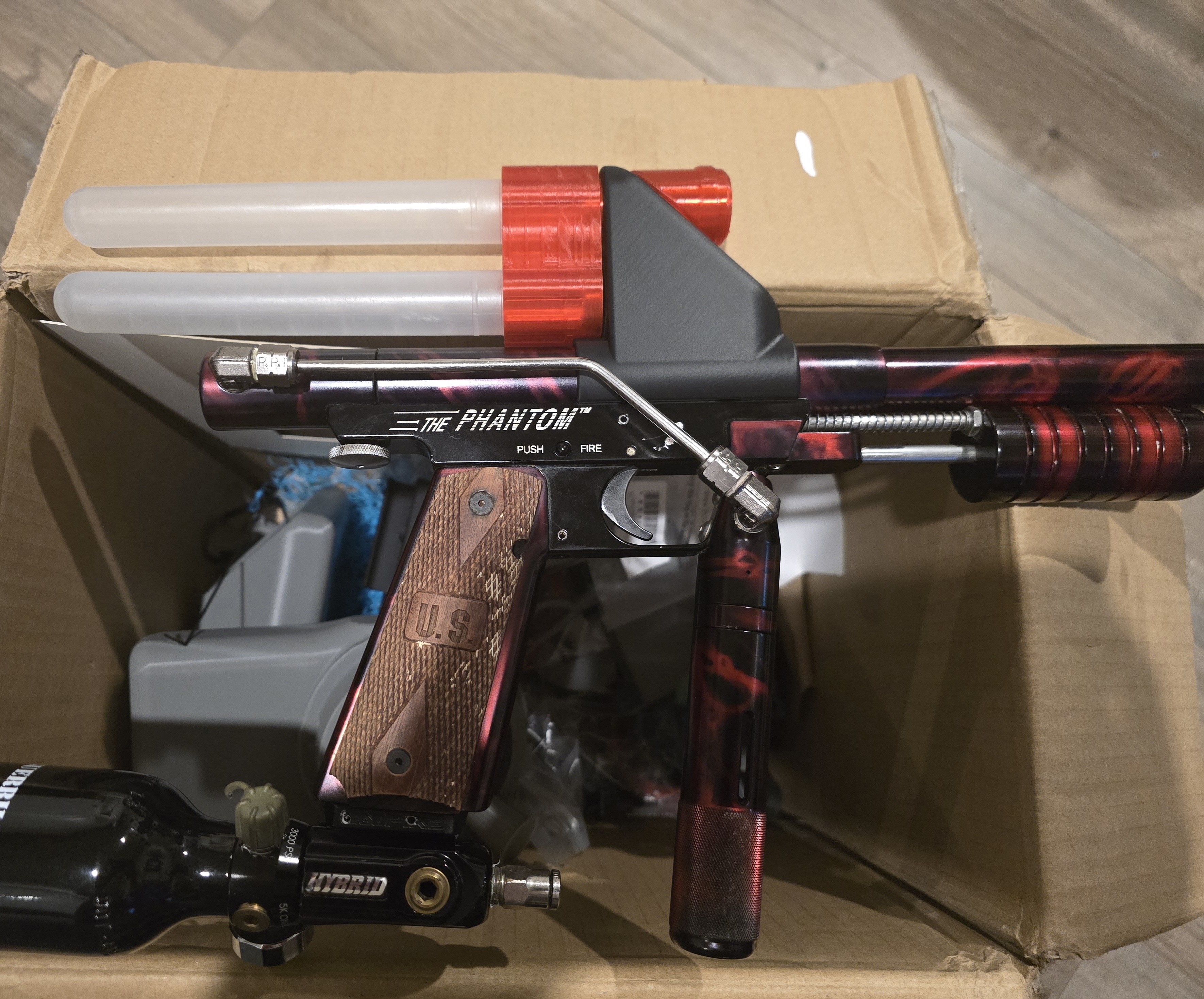

      I have something similar to this at home. It was 3D printed by someone. I'll have to take some pictures.

        "Any type of Mag-fed system"
        "Maximum 20 round feed tube"
        "... equipped with a 90° elbow attached directly to the nipple... (to prevent excessive "ball stacking")"
        ehhhhhhhhhhhhh
        I think the device is really neat, and it is a great way to up your capacity while using 10 round tubes. It also skirts the spirit of stock class play. Watching the feed video, it seems that you do get extra "ball stacking" compared to a more traditional feed. Is this system actually providing a meaningful gameplay advantage in an all stock class game (assuming you're lucky enough to actually experience such an event)? Maybe, maybe not. But if I were at such an event, I suspect the enthusiasts/snobs in attendance would not let this fly.
          • 6352
          Those are not Stock Class. Some event organizers might let it fly. Beantown made a 4 tube one a while ago. I don’t see this as an advantage but Stock Class rules are set by the event organizer. I know the West Coast games are very lax.

            ahh very interesting and similar concept I could argue this design being different as it looks like it feeds from all 4 tubes at once?
            Nope one at a time off the bottom tube. It’s got sprung ball bearings to index it between the rotating sections.

          Love the discussion! Its a shame there are not more stock class games to play but like the 12 slam chargers, there was no rule against them until someone came up with the idea. In this case, we are talking about how quickly you can reload or swap out a new tube.
          I think the closest analogy would be a magazine coupler and not a magazine. Coming from a state that has highly restrictive firearm laws, this device would not fit the definition of a magazine. Paint can only be fed from a single tube, once emptied, the tube would need to be manually cycled to a new ammunition (paint) feeding device. You can also reload a single tube so you can argue the device houses up to 3 'magazines'. There is now rule against additional paint being stored on the marker itself.
          This was a fun/silly project and I may make a direct addon for my phantom just to have an excuse to bring it out more often.
            It holds to many shots. Technically ported barrels, AT, and lever changers are not allowed in the original rules as well. Most organizers use the 2.0 rules that allow for single 12g lever changers and ported barrels. They allow markers with AT but you can’t use it. Really if it’s your game run it how you want. Some events allow HPA and call anything with a Stick feed Stock Class. Then there is the term modified Stock Class thrown around. To me there is Open class and Stock Class. This would be considered open class to me. Not that there is anything wrong with that it’s just a different format used to determine what type of game play to expect. Like mag fed, mech, semi, ramp, blowback, pump.

              Here is the one I have. Definitely not as nice of a design as the one you have made!

                    Cool design. Well executed. Unfortunately i would not call it stock class
                    The whole point of the rules is to keep the rate of fire down.

                      Thanks for the feedback. I will probably pursue cleaning up the design. I hadn't played stock class in years but out of curiosity looked up what the current standards were and then the "what ifs"
                      I think this would be a lot of fun to run with a 13ci tank and to dust off the bin of 10 round tubes sitting on the shelf. Oooo maybe I will add a camera mount to the front.

                        to me, playing against folks using rotating stick feeds like this usually results in the "unfair advantage" being nullified by the awkwardness/bulkiness of the setup.
                        train in your backyard all you want, unloading 3 tubes and getting 3 back in without spilling will suck in most in-game situations. its much easier to train your muscle memory for single tube reloads. instead of dumping a single tube into a fixed feed and shoving it into a drop sack, you are now handling 6 tubes everytime you need to reload. and if youre replacing single tubes as you need, you are self-defeating the purpose of this thing anyway.
                        if your plan is "everyone else will be so busy reloading 3x as often as me! ill be running up on folks left and right!", i think you are severely underestimating the speed at which the opposing players will be able to reload and maintain effective rates of fire.
                        the added weight and bulkiness of that setup significantly increases your silhouette and will slow your draw. you wont be able to reliably whip that thing around like you can a fixed feed gun. try it, i guarantee the neck will be twisting and tubes will be flying. in addition to making you a bigger target, these setups always feel unbalanced and top heavy too. anytime we have someone in our group using one of these things, they are constantly readjusting or scrambling to pick up thrown tubes after any spirited maneuvers. the whole thing usually flys off if they try to dive/slide
                        instead of getting stuck on seeing "10 round capacity" as a limitation, you should focus on getting your skill set and shot quality to the point where those 10 shots are more than enough.
                        personally, i would allow this thing at our games, unless anyone else had a problem with it.
                        the "getting away with it" gimmick is quickly exposed as more trouble than its worth. everytime someone trys these out, they switch back to single tube after a few games. if youre stepping into the world of stock class and looking for any loopholes you can exploit to get an unfair advantage over your fellow players, youre missing the point.

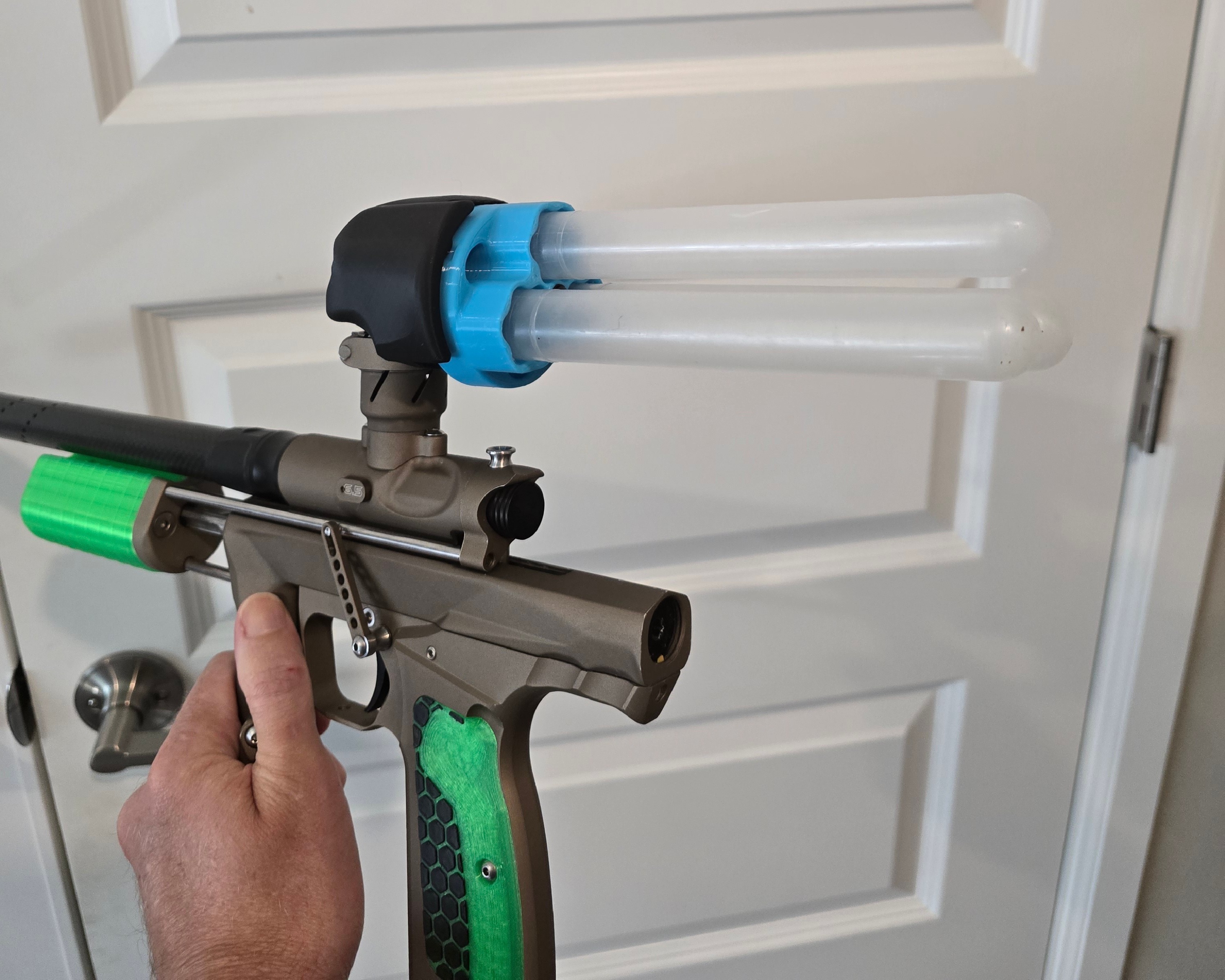

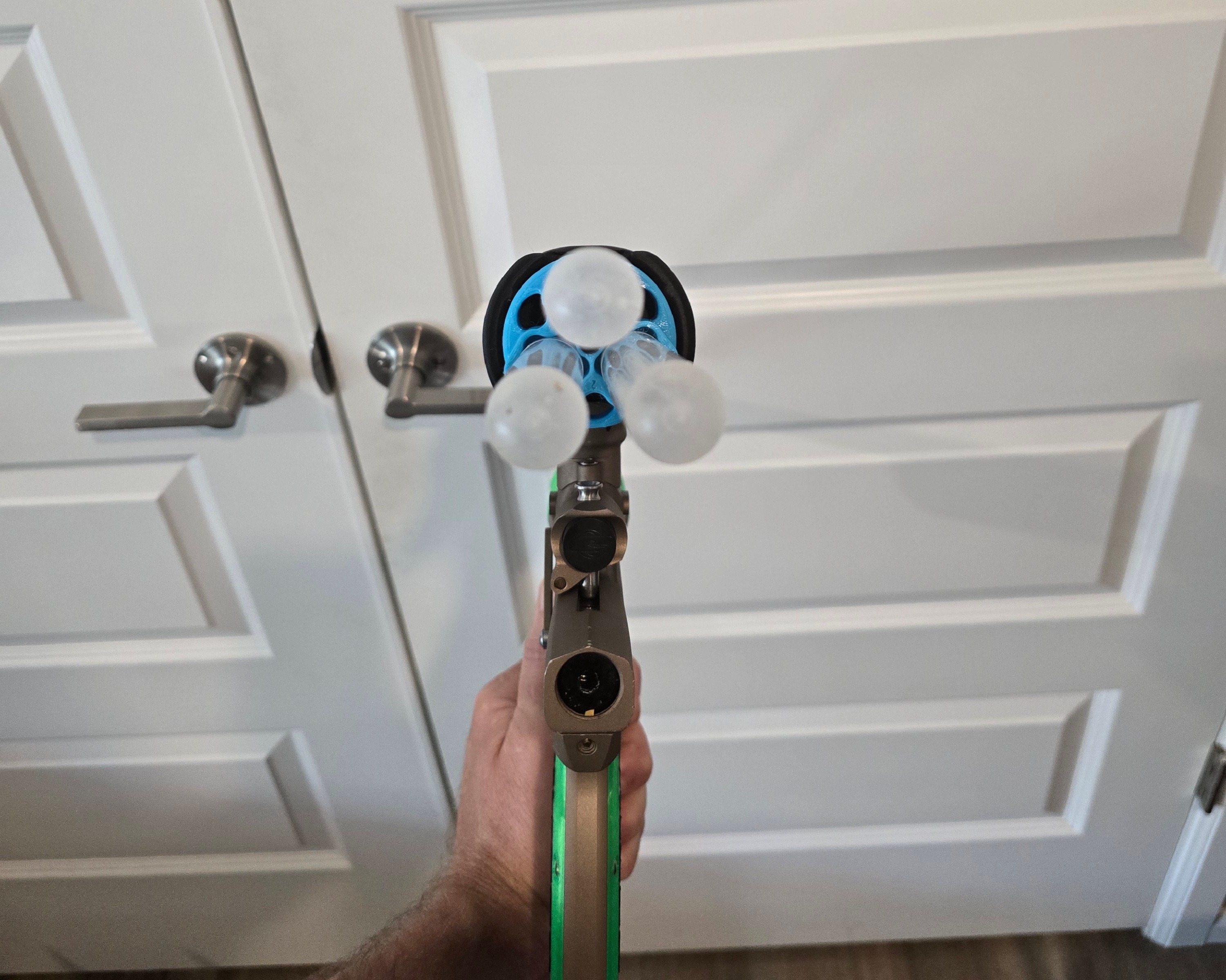

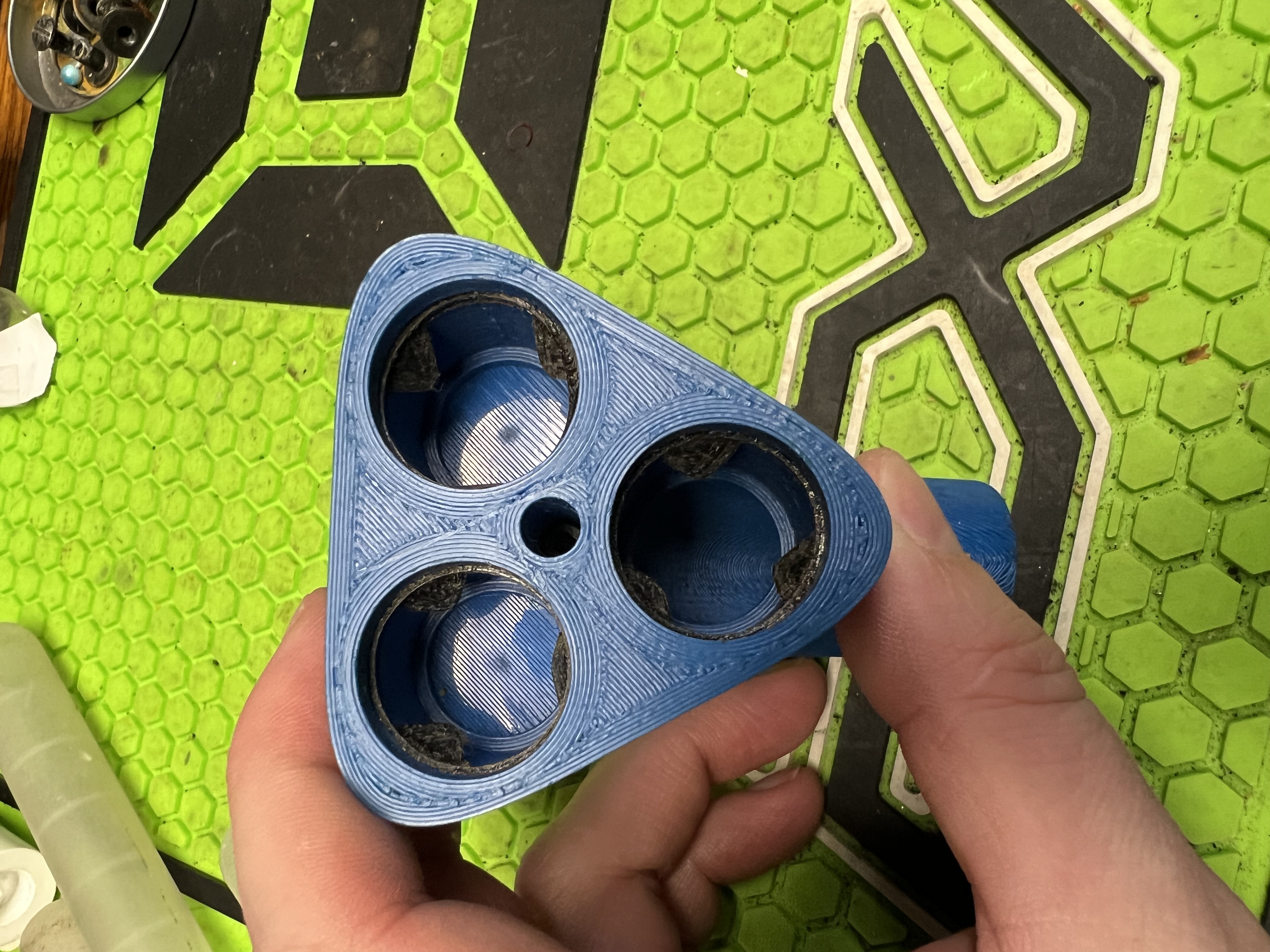

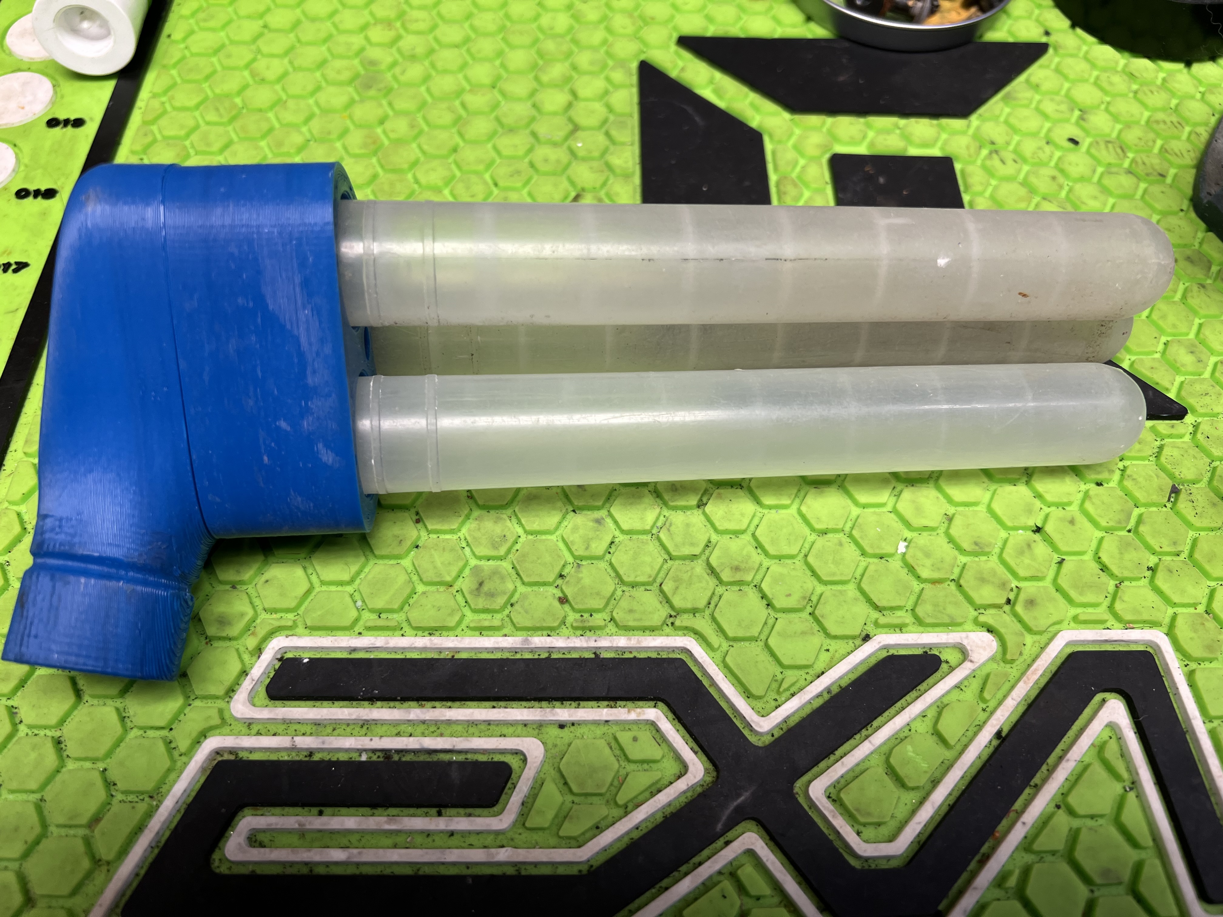

                        Some more horsing around. I made a phantom direct feed for the 3x rotary. Then made some changes and dropped down 2 tube's, added a small bearing to the shaft and reduced some of the friction points which did spread the tube's out a bit and makes it taller but it's very smooth. I'll try doing a video tomorrow.
