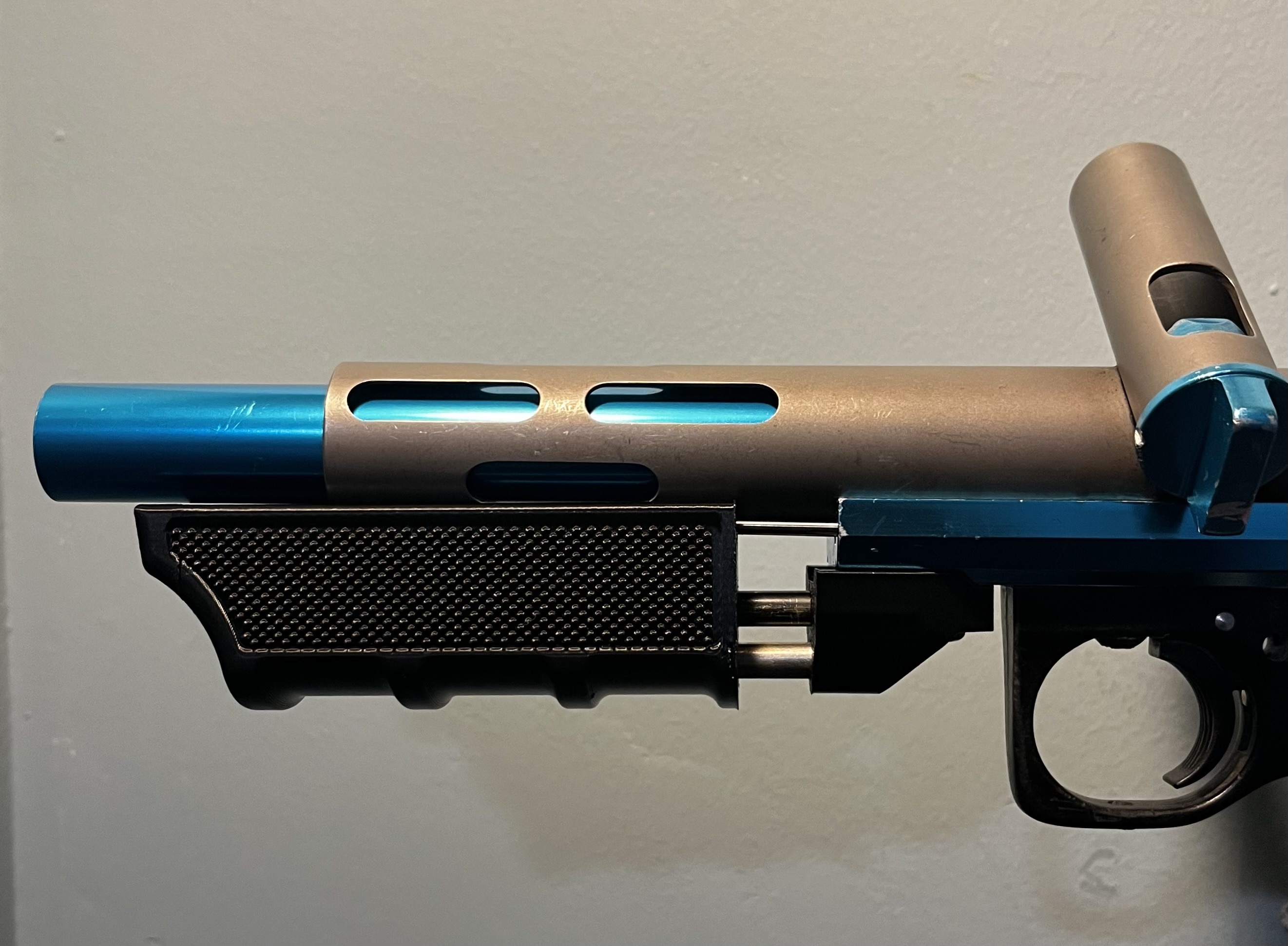

                  Cycling great now! The bend on the end of the pump rod was to dramatic, which was not letting the bolt cycle when the pump handle was in the forward position. I dry fired a whole 3.5 oz co2 without any more binding.
                  Now to print 2 more sets and make sure it's repeatable.

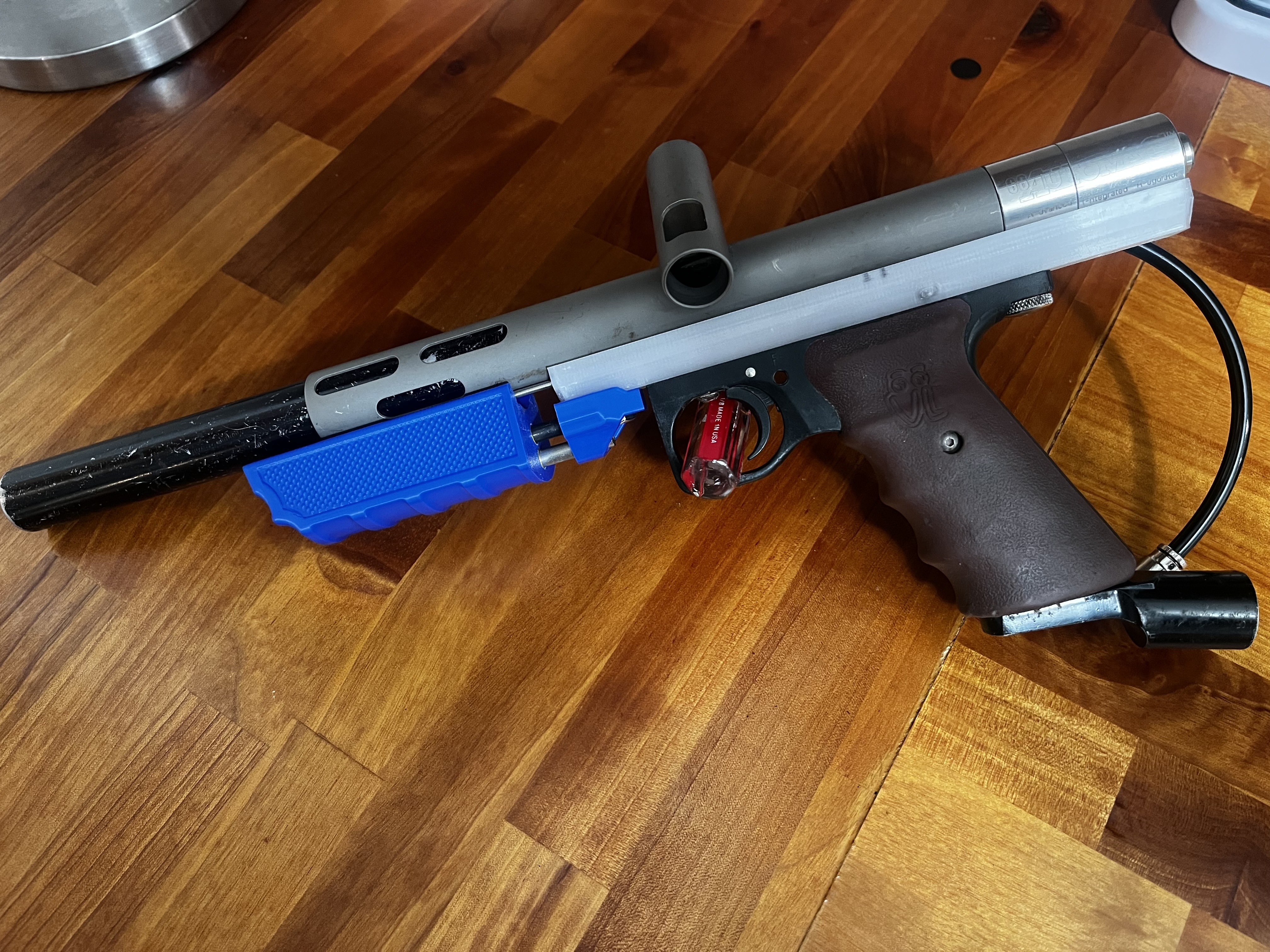

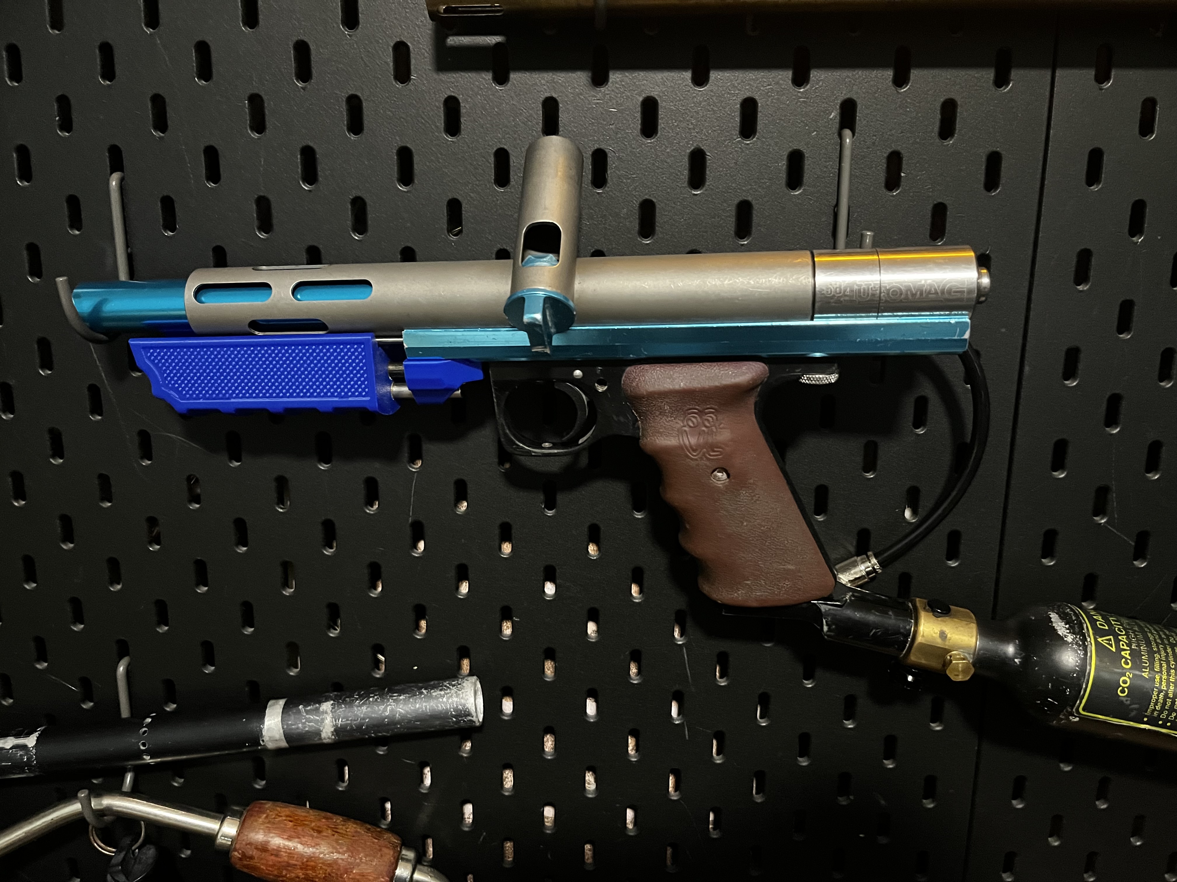

                  #27
                  IMG_3155.jpgFinally had a few minutes to pull this back apart and work a little more. I’ve now got two working pump kits! Fit and function checked! I need to replicate a couple more pump rods from one of the good ones, as that gas been the most finicky bit for me (the profile of the back end of the pump rod). I should be ready to send a couple beta tester kits out soon. I also re did a bit of the cad to make the grip more comfy, and add some beef to the mounting block.
