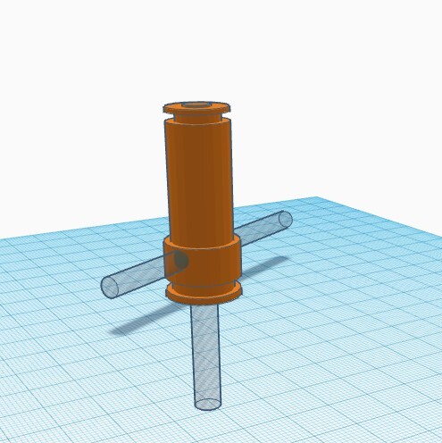

    So I decided I was going to try and model one, and I wasn't gonna let a simple thing like never having touched modeling software or drawn a CAD bit in my life stand in the way.
    I grabbed some veneer calipers, the BT bolt, and started stacking cylinders.
    After about an hour and 1 phone call to a buddy who sorta knew what he was doing and I had an okay looking protoype!
    Feedback!: https://www.mcarterbrown.com/forum/b...rough-feedback

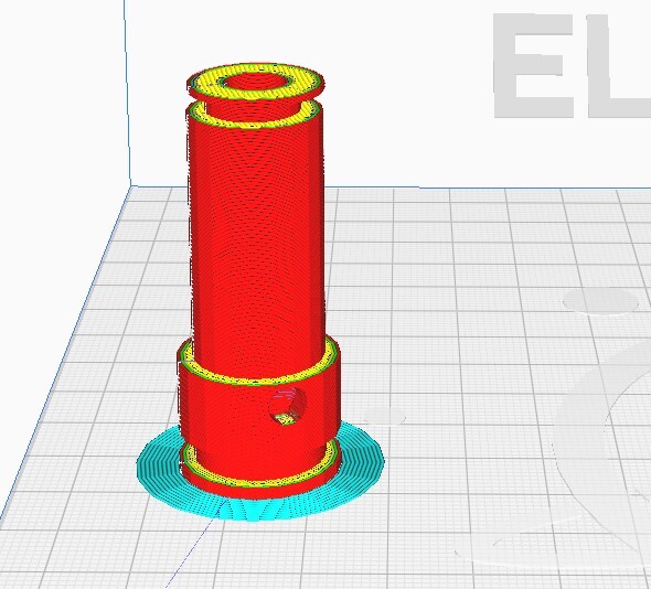

    ....30 seconds later I had it loaded into my slicer.
    ..and roughly 1 minute later it was being formed before my eyes.
    It will need some reiteration, currently it's designed to take a washer stack in the rear to raise velocity, and I am looking at making a metal rim "Sleeve" for it to act as the catch for the sear.
      • 4331
      It could delaminate in the long run with the stresses of the nelson system.
      • DieManInTheRough
        DieManInTheRough commented
        The catch lip is the weakest area, trying to bolster it in the files, if that fails, I'll be producing a metal catch lip to press fit or attach with grub screw.
      • Brokeass_baller
        Brokeass_baller commented
        DieManInTheRough you could probably find an off-the-shelf flange bushing for that. Won't be as durable as steel, but would last a good while and be cheap and easy to repair in the future. The lip on my brass Hammer bolt is still in nice shape.

      It looks spot on! Give it a try and see how it works. I'm with Ecapnation and think that when it mates together with the hammer you'll have issues there first.

        It’ll never last. A Cocker bolt? Sure, but not a Nelson. You should have just borrowed someone’s lathe for a day and skipped all the computer stuff.
        More unsolicited advice: a well done (ie: original, unmodified, not rusty) Trracer/Hornet will shoot 283 on CO2 and stock springs. Having an adjustable bolt isn’t absolutely required, neither is an extra large pump handle. If resources are low, it’s best to focus on the most basic needs first.

        For the sear catch, you could try a washer that is partially captured in the center by the print. Might be a weird washer size though. :/
        PETG might last a little while at the pump arm connection, since it's not a constant stress. You could press in a little piece of tubing there.
        With the Nelson power tube going through, i guess it doesn't have a lot firing stress (gas pressure).
        You need to test to failure before playing, to get some confidence that it won't be spitting parts out.
        • DieManInTheRough
          For sure! The power tube itself is bolstering the bolt alot, and as you said there is no firing stress on the bolt itself. I can press in heatserts for the pump arm,but I think there is enough meat there with the proper bolt screws there wont be much issue.
