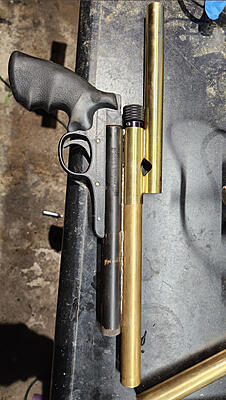

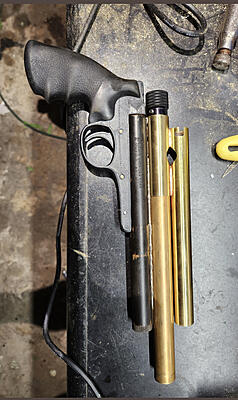

          I bet JeeperCreeper could make one from some brass. He makes them for his other custom builds.
          • FredMnkyDad10
            • 2244
            This, would be freaking awesome.
            FredMnkyDad10 Feedback
              Check out his build thread he made a few clip on ones.

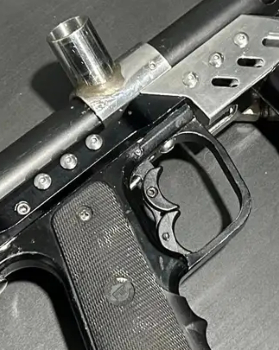

            Saw this on FB. Does not look like it fits over the body like the sight rail.
              • 6282
              JC’s brass thread in the Sheridan section. He could probably make you one to fit the mag Im sure.

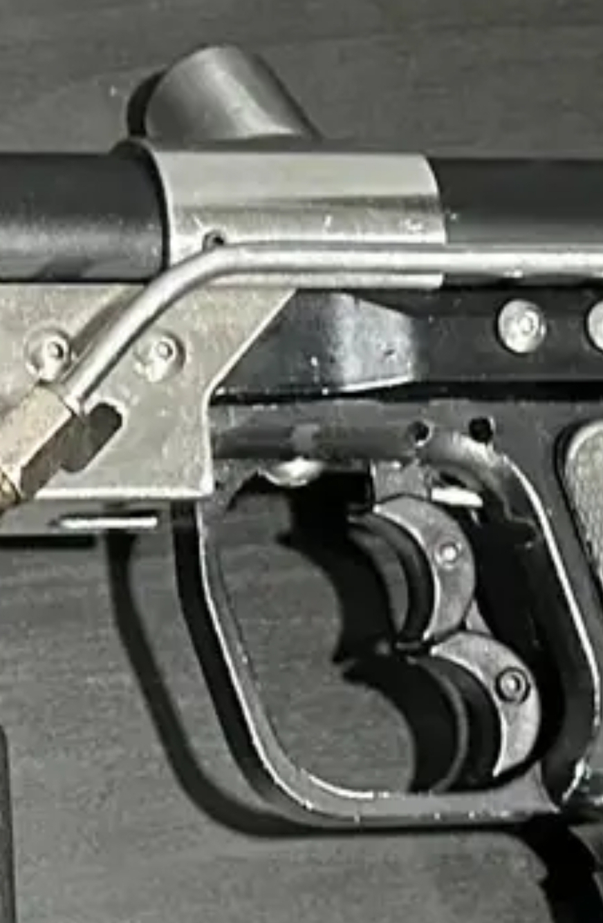

                This so would work. And if it slips over the body like the sight rail, using 4 set screws to help secure it. You would not need to drill all the way through the body. Just cut groves/indentations where the set screws sit.
