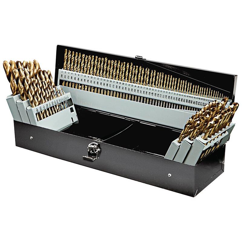

    This is a must have for drill and tapping. And for $50 its hard to pass ... well worth the investment.
    here is the link (im not affiliated with them at all):

              The $50 set shown is probably fine for most stuff. And you can get better pieces on an individual basis to replace the cheap ones, as needed.

                HSS with titanium oxide coating (yellow) is a good bet
                like the 50$ set have that have all size

                    The Harbor Freight stuff is good for most light work but I found they wore out pretty fast and snapped relatively easily when using a cordless. I bought a set a long, long time ago and primarily used them on aluminum with a drill press - they tended to dull faster than more expensive bits. More recently, I used several of them for a home project that involved drilling pilot holes in wood and broke 3 of them. This was over a few hundred holes but still. I ended up getting some nicer bits at HD (don't recall brand) and didn't break any.
                    I'm a big HF fan, but there are limitations.

                      I like the big set because of the selection of sizes for the price.
                      this allows me to have a small high end set.
                      I make all my pre-dril wit the good bits and finish to the proper size with the cheapo.
                      And if it break/I'm using it a lot I source individual bit of good quality.
                      Great way to get most sizes without breaking the bank all at once
