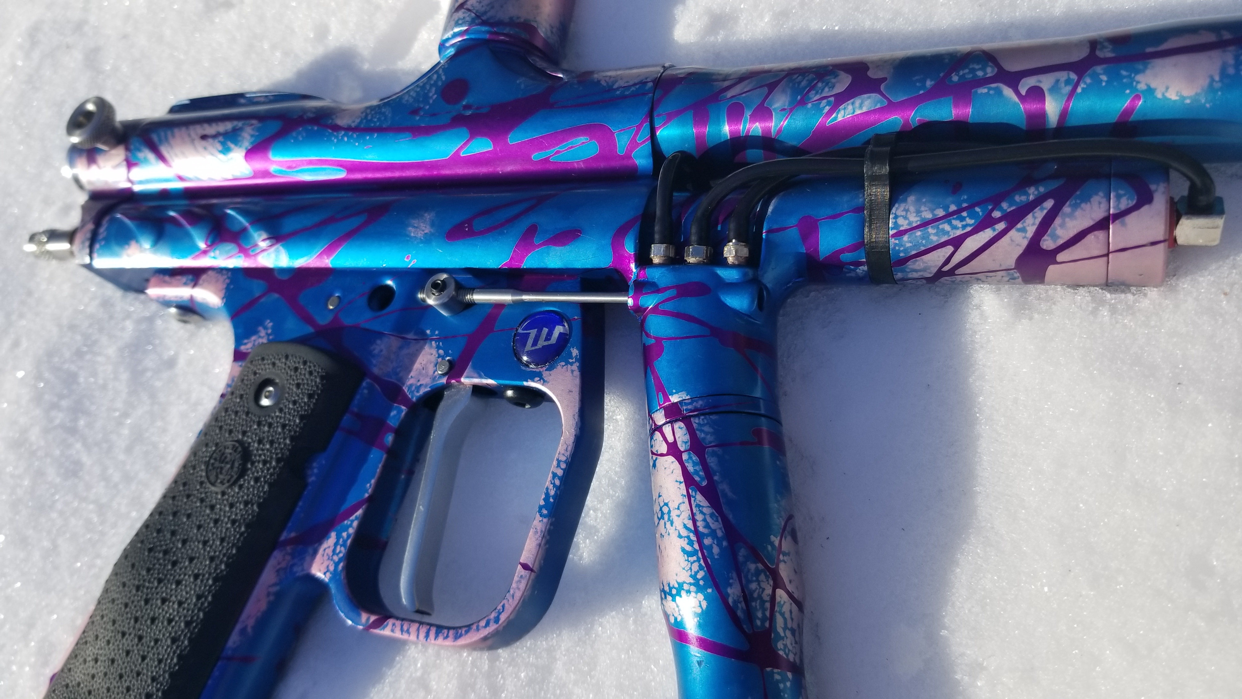

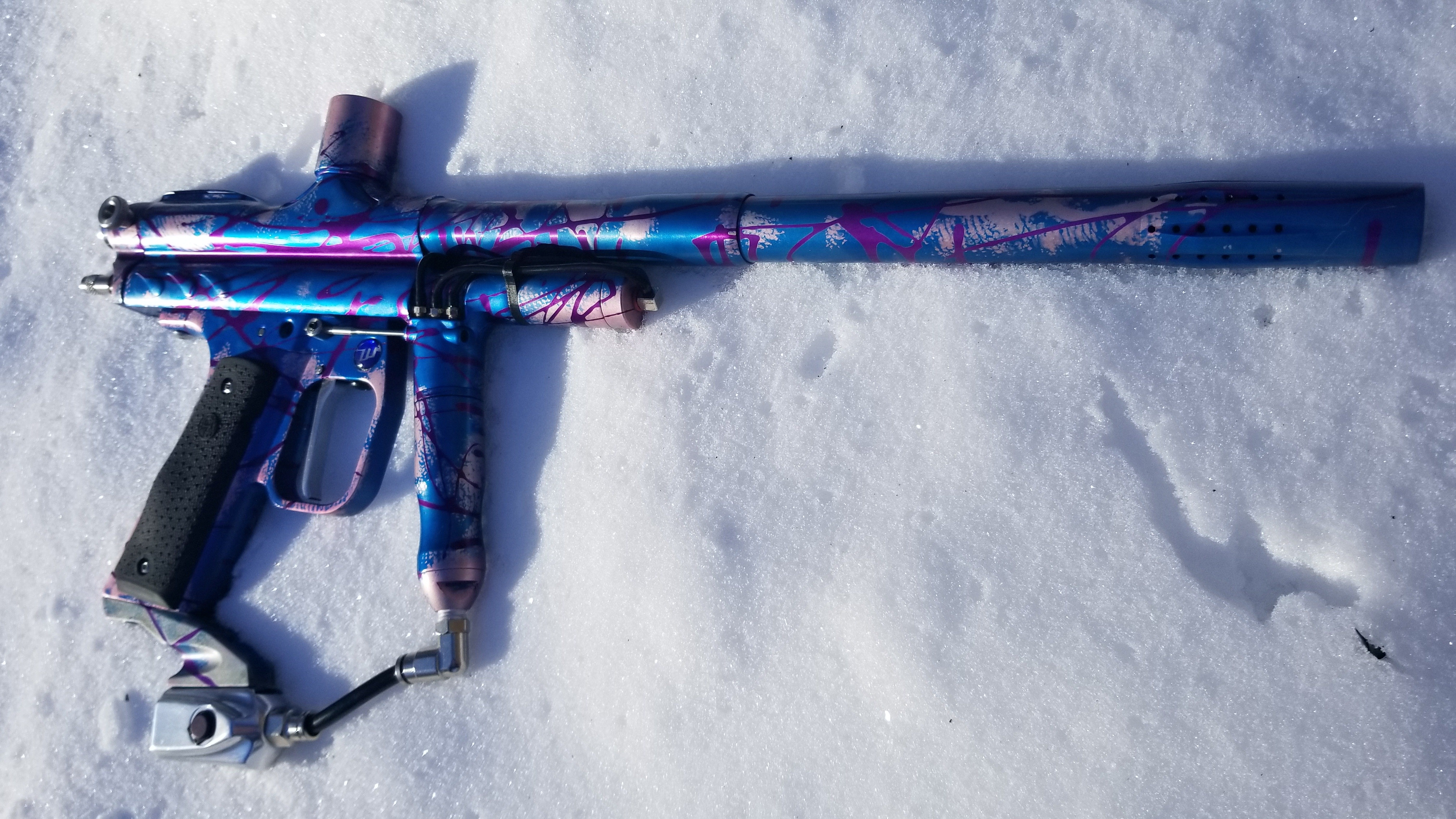

                      A few glamour shots of this one. Love how the splash aligns on the parts.
                      Velcor will save us...
                      • The Hobbit
                        The Hobbit commented
                        That Trilly turned out sick.

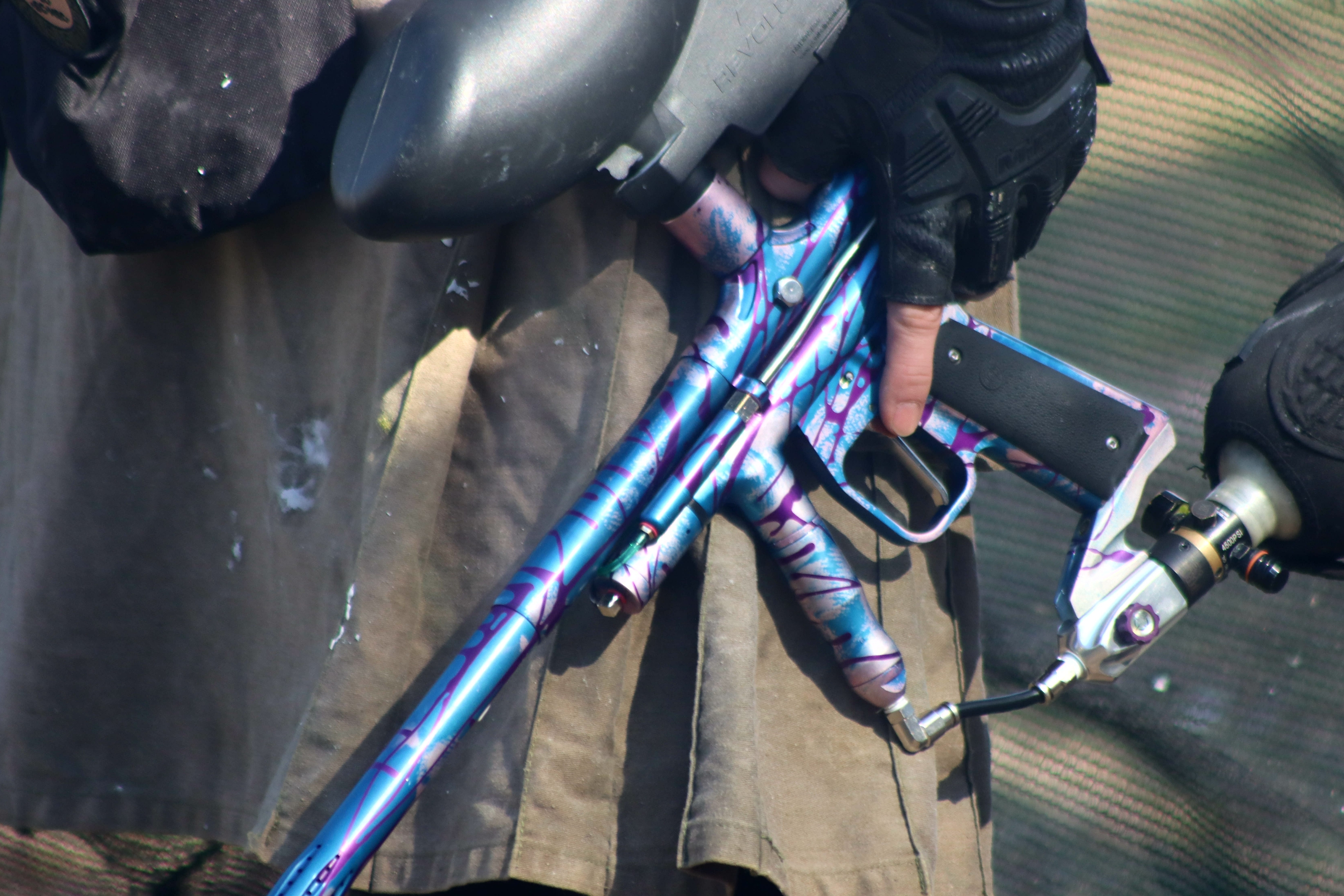

                        First time playing out at the field with this sexy beast, and it ripped!
                        • KMDPB
                          KMDPB commented
                          Yasss
                        • 6174
                        #28
                        First photo looks like it was taken in the early 2000s
                        Very cool
                        • OpusX
                          OpusX commented
                          I strive to keep my game on point 😎

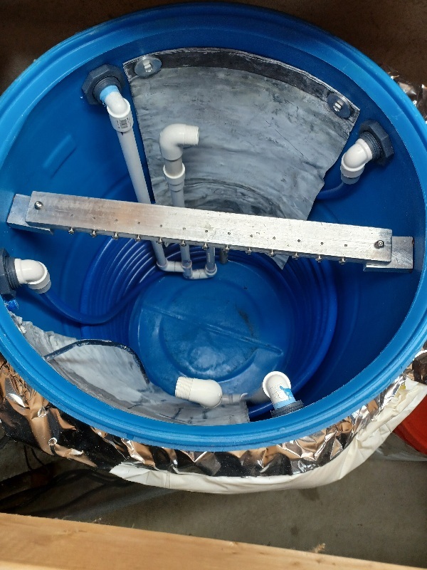

                        Couldnt find Kleen-out anywhere. Called up the distributor in california to see what was up. The company that produced it vaporized like 3 years ago! I tried Liquid Lightning but its got a pink dye, so thats no good. I have a 30 gallon tank to fill! Help?
                        • KMDPB
                          KMDPB commented
                          Yeah they recently stopped carrying kleen out in Walmart. Another guy in my group said they stopped making it all together. The other brands have a pink or purple dye. Which technically works but parts come out predyed purple lol. You can use battery acid but its going to cost you a small fortune to fill that tank. Its a sad day for us home anodizers😭
                        • markdem
                          markdem commented
                          KMDPB damn. Looks like im gonna have to grab some lab grade stuff from online suppliers. A cool $250
                      • markdem
                        G'day mate 🇦🇺
                        • Nov 2022
                        • 415
                        • Rhode Island
                        #30
                        Tried going with battery acid from napa etc. Cannot get 5 gal buckets any more. Called the manufacturer to see whats up. They discontinued bulk products around the covid years.
                        So yeah, im gonna HAVE to go with an online supplier
