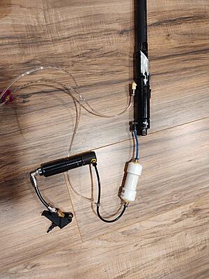

    I'm working on an ION project and wanted to increase the firing can volume to decrease the op pressure. I built a second chamber (1.5ci) and connected to the original chamber using 4mm hoses. Nothing happened with regards to velocity.
    stock 10 shot average was 280.9
    modded 10 shot average was 281
    airflow path is; Tank - reg- 2nd cham- stock chamber
    what went wrong?

      You are probably hitting choked flow conditions - the first chamber rapidly depressurizes, and your flow ends up limited by the 4mm orifice diameters.
        MCB member
        • 3536
        • Montreal, Qc, Canada
        Can you share picture of the mod?
        where did you install the port?
        any idea whats your current air pressure?

          I'll take a picture and upload when I get a chance. I don't have a pressure gauge on the setup. North of 160. In testing 160 only achieved 250fps

            any ideas what size I should up the hoses to? 6mm or 1/4"?

              You haven't increased the dump chamber size, you've just added a large reserve of air behind it that still needs to flow through a relatively small hole and past the bolt tail. And, if you're running a dual tail oring bolt, the extra volume isn't getting into the dump anyways.
              You would need to drill into the side of the body and add a large tube between your extra volume and the actual dump to get the effect you're looking for.

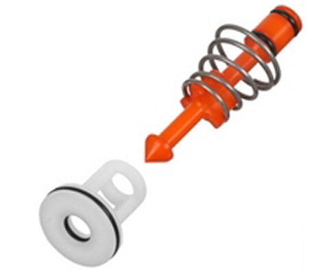

                        For the record. I've seen a plug mod where a lvl 7 would work on a mech, but I cant recall who, where, or when, but it was at the time I meched my ion and was told I needed a new bolt. Months after I boughta new bolt, and sold my lvl7, I saw someone post about successfully making it work.

                          ANS made one, and I believe one of Oranges systems used one as well.
                        Here's the Orange "Nano" bolt plug thing. Maybe ANS didn't make one, because I can't find it anywhere.
