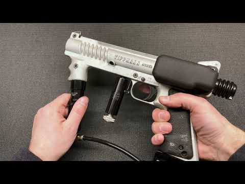

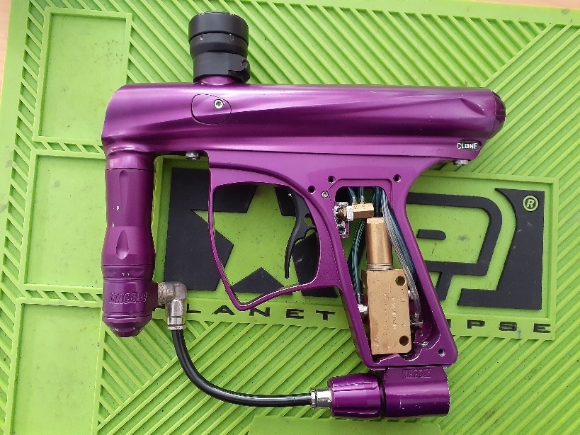

      Macdev Clone (Mechdev)
      made by Jordan
      Manifold made by Kit
      SMAV3 activating a MPA3 on a MAV4
      https://www.mcarterbrown.com/forum/p...ech-conversion
      The same component could be used to mech a DM3 Matrix

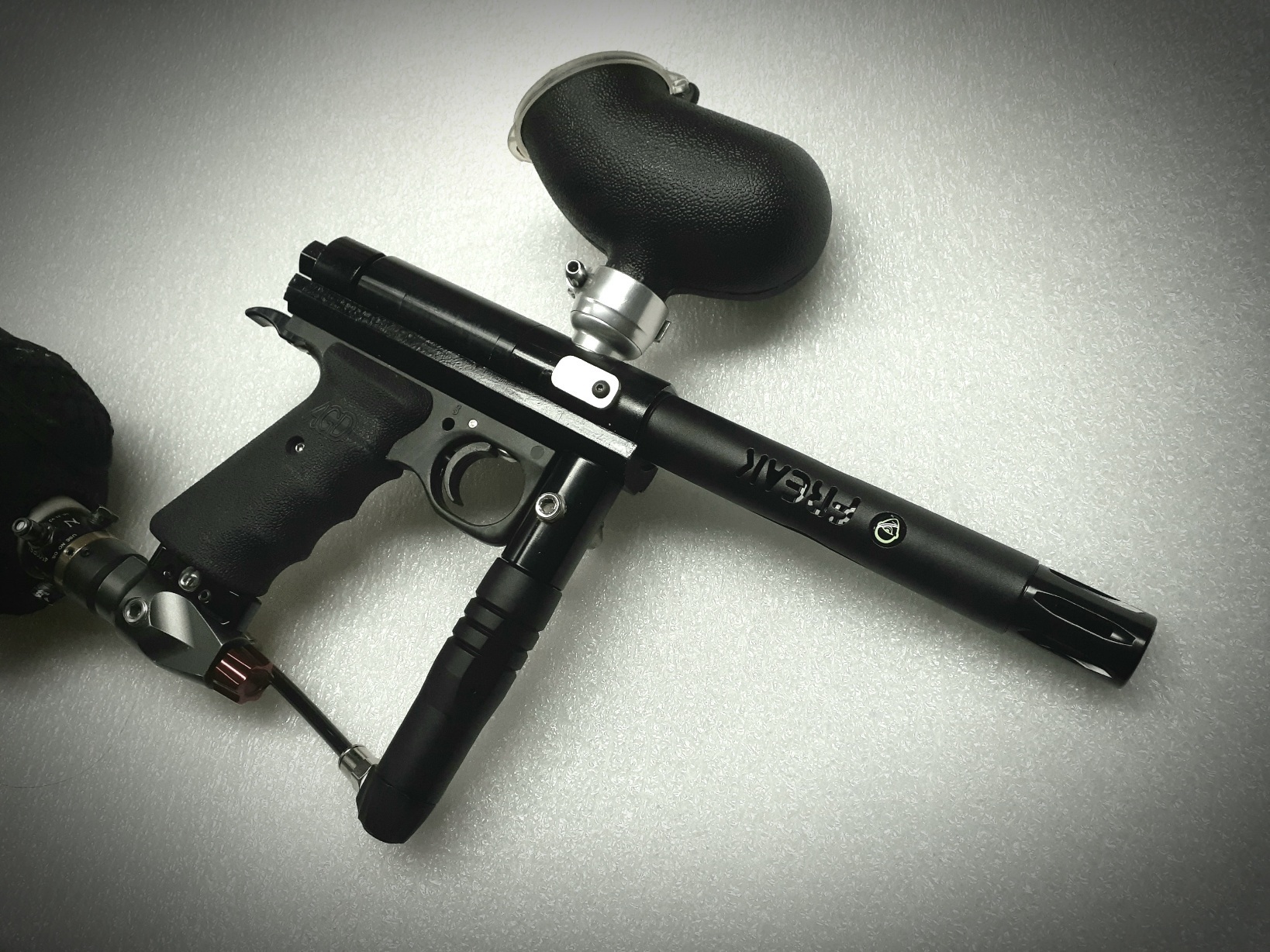

      Mech Ion made by Jordan
      Ion firing can
      Automag rail and frame
      SMAV3 in the CF automag frame
      πŸ’€Team RagnastockπŸ’€
        Jordan commented
        My favorite mech Ion I've built. πŸ™‚ I really need to build another for myself at some point.

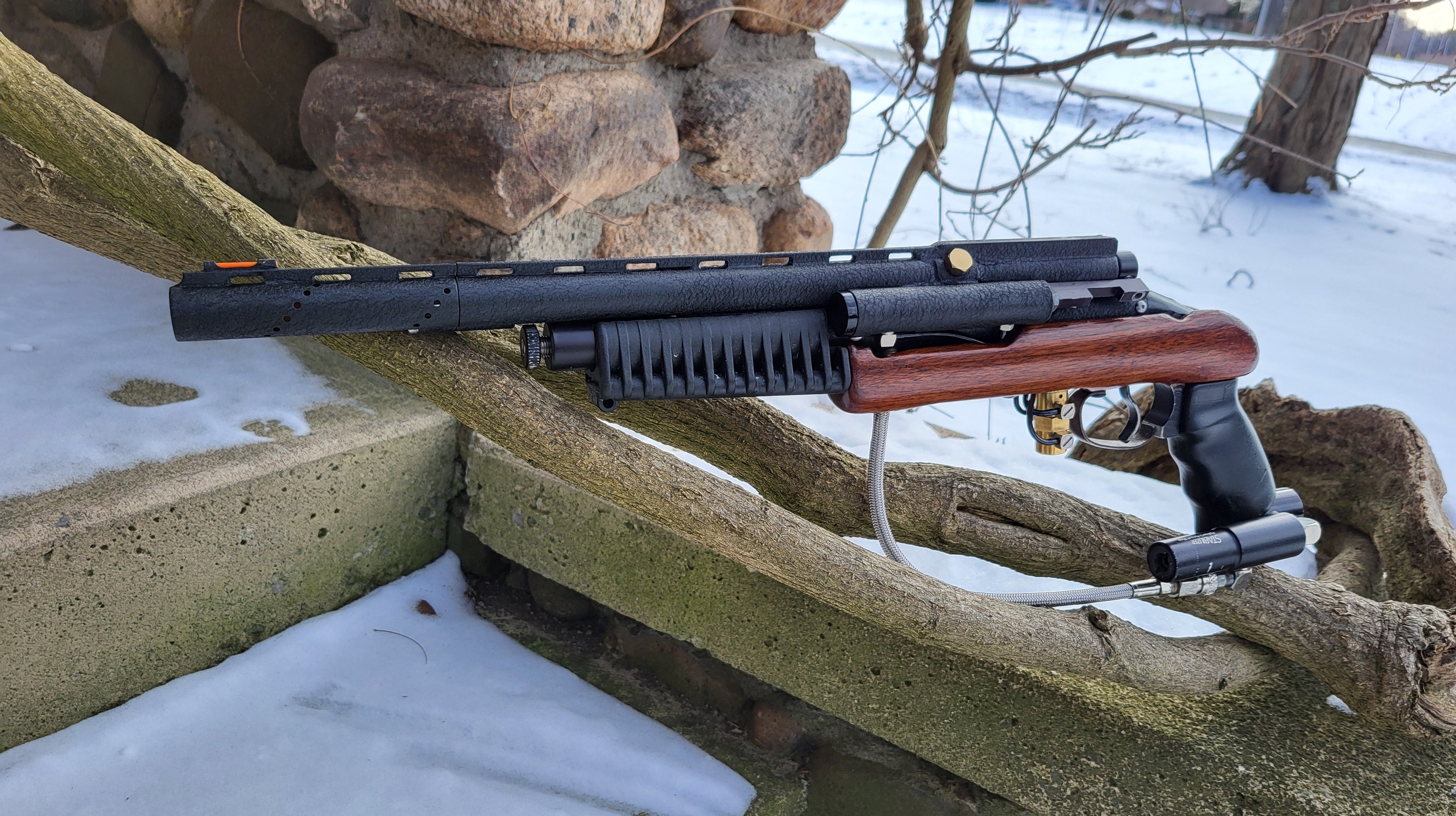

              I have meched an evil omen. Used an F4 illustrator frame with a custom spacer and re-drilled holes in the frame for attachment. I wish I had pics of the final project, it felt a lot like shooting a clunky Spyder, haha.
              I also made a mech double ion. SMAV-3 valve with a t-joint to fire both at once. One valve was fed through the ion frame gage port and other through standard hose. Used an SP1 body with the second gun mounted in a scope mount on one of the rear rails at 45* to be fed with an elbow and hopper. I used a lucky air fitting on the back to get higher air flow for the trigger valve.
              I plumbed a DM3 up for mech use, but never went beyond the concept phase of making it fire by triggering the valve by hand.

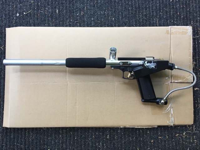

                    Here's a Hammer that I made mech.
