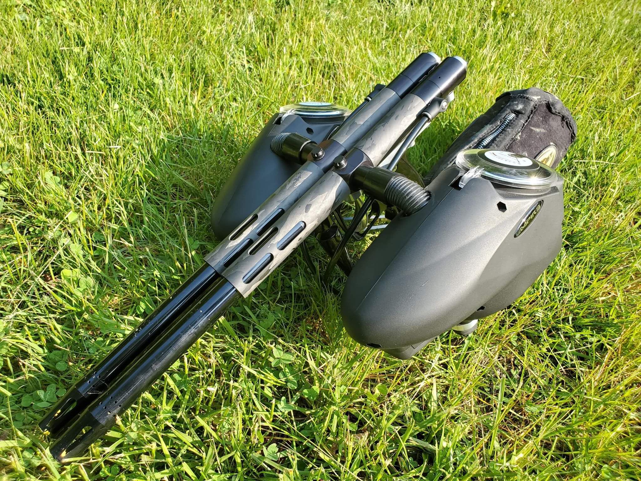

      Yup the dual rails I designed and made were compatible with both ule and stainless bodies.
      8 of the KAM Designs Dually rails are ule/stainless compatible
      2 of the KAM Designs Dually rails are ule only
      The final production rails are aluminum. The prototypes were 3d printed
      this is the only picture i can find on my phone of the gun. I have been reasonably careful not to show pictures of the rails as I don't want them copied. But will look to see if i have something on the computer that shows more.
      Also AGD built one many years ago with similar layout for minimag bodies.

        I know who currently has the AGD dual. Its a awesome gun but as you said a beast. My design concept was to make it as light as possible so its heavily cut underneath and inside. My personal one was always planned for carbon bodies as well which is why it is one of the ULE only rails.
        I have no plans to reproduce these. They are one of the small run "super custom" projects I've been doing. Not to mention anything short of a 10 part run is extremely expensive. and even at that they are still expensive.

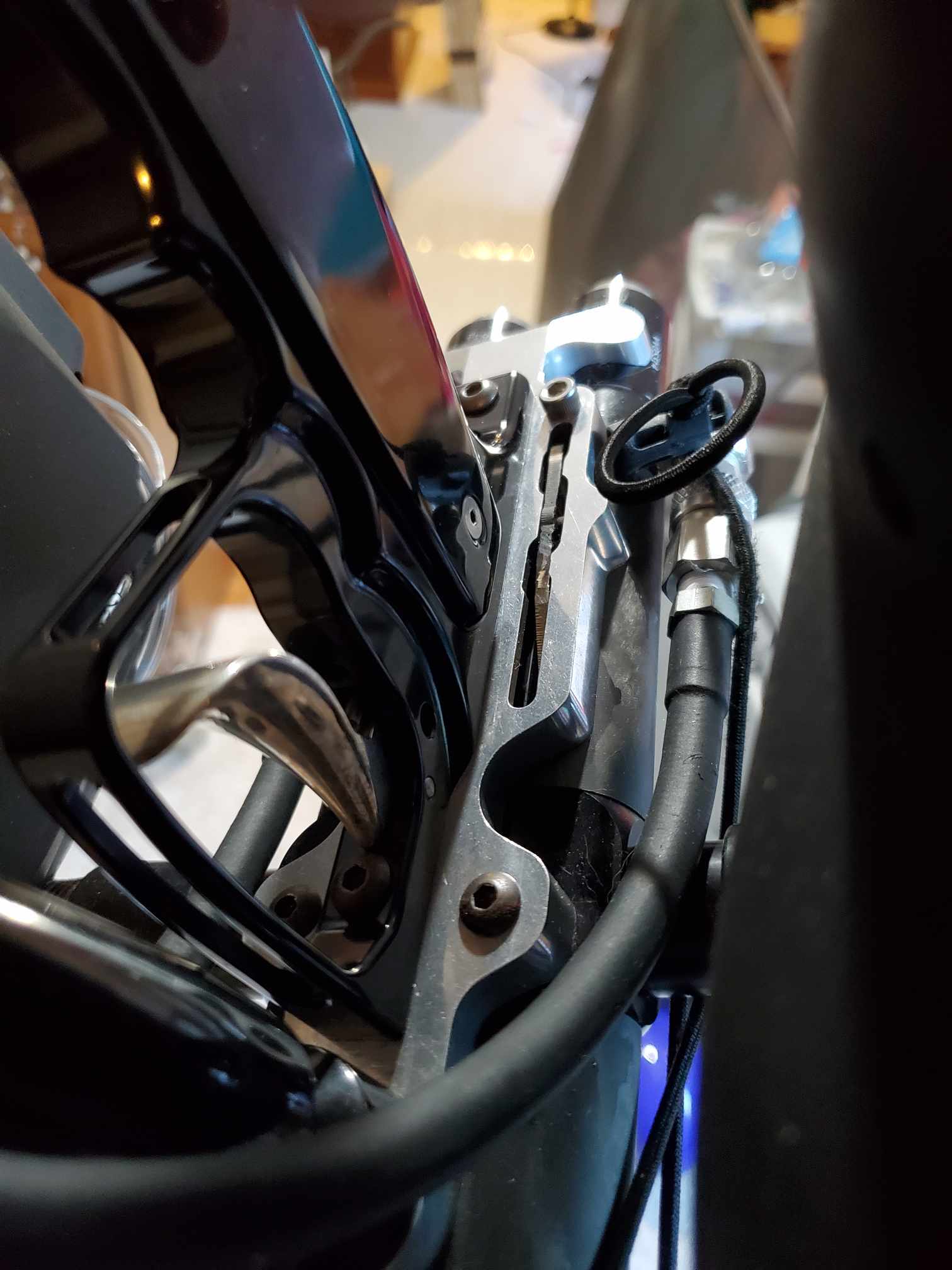

        Quickly snapped this before getting the kid on the bus and then heading to the office. (yes I know I need to get better screws for the valves.)
        The ones I did that accept both ULE and Stainless have more material to allow for the barrel detent pin.

            My issues with "production" printed rail for automags lies in the zlock slot. The ones I have had printed are not strong enough in that area to stop the valve back half from turning. The rails splinter there when the adjuster is turned because the back halve of the valve turn with the adjuster. That coupled with having watched someone who had a cut agd rail spin off the back half while the gun was aired leads me to dislike it. Thus I will not make and sell printed rail or rails without the zlock slot. It not worth the risk for me in a sue happy society.
            If you were to design a an print a rail yourself for yourself then it's all up to you as far as risk. And yes the rail will likely work except the zlock as long as it was designed right.
            I don't like but am ok with printed triggerframes as they dont hold any parts that have the risk of injury if treat poorly.
