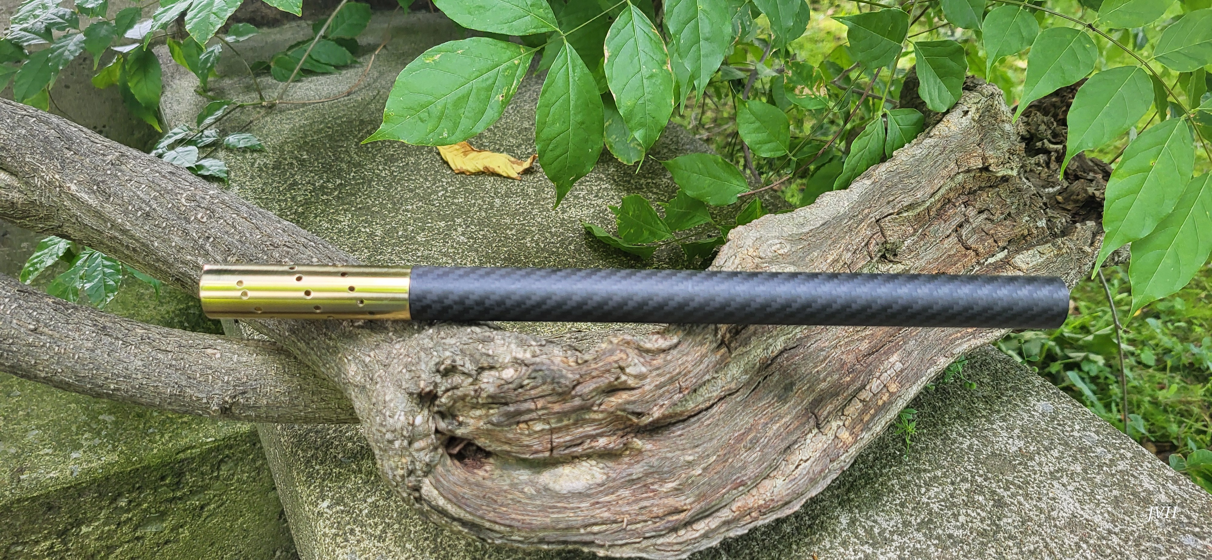

    I was asked if I thought I could build something like the CF barrel I made for one of my brass builds (now owned by Grendel ), and after some cogitation, figured I just might be able to come up with something that could work.
    Blazers having such a thin "thread" section where the barrel is retained in the breech meant the 21mm OD tube I used on my original build wouldn't work, so I needed an alternative solution. I found some 20mm OD thinwall CF tube that seems like it'll do the trick - it's a tiny bit smaller in diameter than a Blazer barrel by about 0.008" (0.787 vs 0.795) but I think the clamp should still work. Might need to shim with a bit of tape - I don't have a Blazer to test-fit, unfortunately.
    The insert isn't flush with the end either - Blazer bolts enter the barrel by roughly 1/4", and users report any inserts smaller than .687 tend to jam the bolt up, so I have a short section (~3/8") of barrel tube that inserts into the barrel to retain the insert and allow space for the bolt. The retainer is loosely friction fit into the barrel and will be retained by the breech step.
    Click image for larger version  Name:	20240615_110433.jpg Views:	0 Size:	787.3 KB ID:	555862
    I've got a couple ideas for porting, and possibly a beauty ring a la BOA Snake bite - we'll see. Loosely assembled to test fitment and function before anything else, we've got this:
    Click image for larger version  Name:	20240615_110415.jpg Views:	0 Size:	1.47 MB ID:	555863

    Well damn I like that too!
    I happen to have a Pyre that could benefit from a barrel like that. I can send you up my Pyre for test fitting if you would like I'm done playing paintball for a few months anyway while the doctors stuff my guts back in through my hernia and sew things up.
    If I might make a suggestion, extend the brass section a little further into the barrel and put Wedgits where the ball will sit. On my Pyre and the Blazers I've had I fell in love with Wedgits. 0.687 barrels with Wedgits will shoot pretty much any paint we get now without breaking the paint.
      Jordan commented
      This barrel takes Freak XL inserts, like the one on yours, just with the extra "step" for bolt clearance. I don't know if there would be a point to wedgits in this case, but it's something I might explore on another version... I have some .685 barrel stock somewhere.

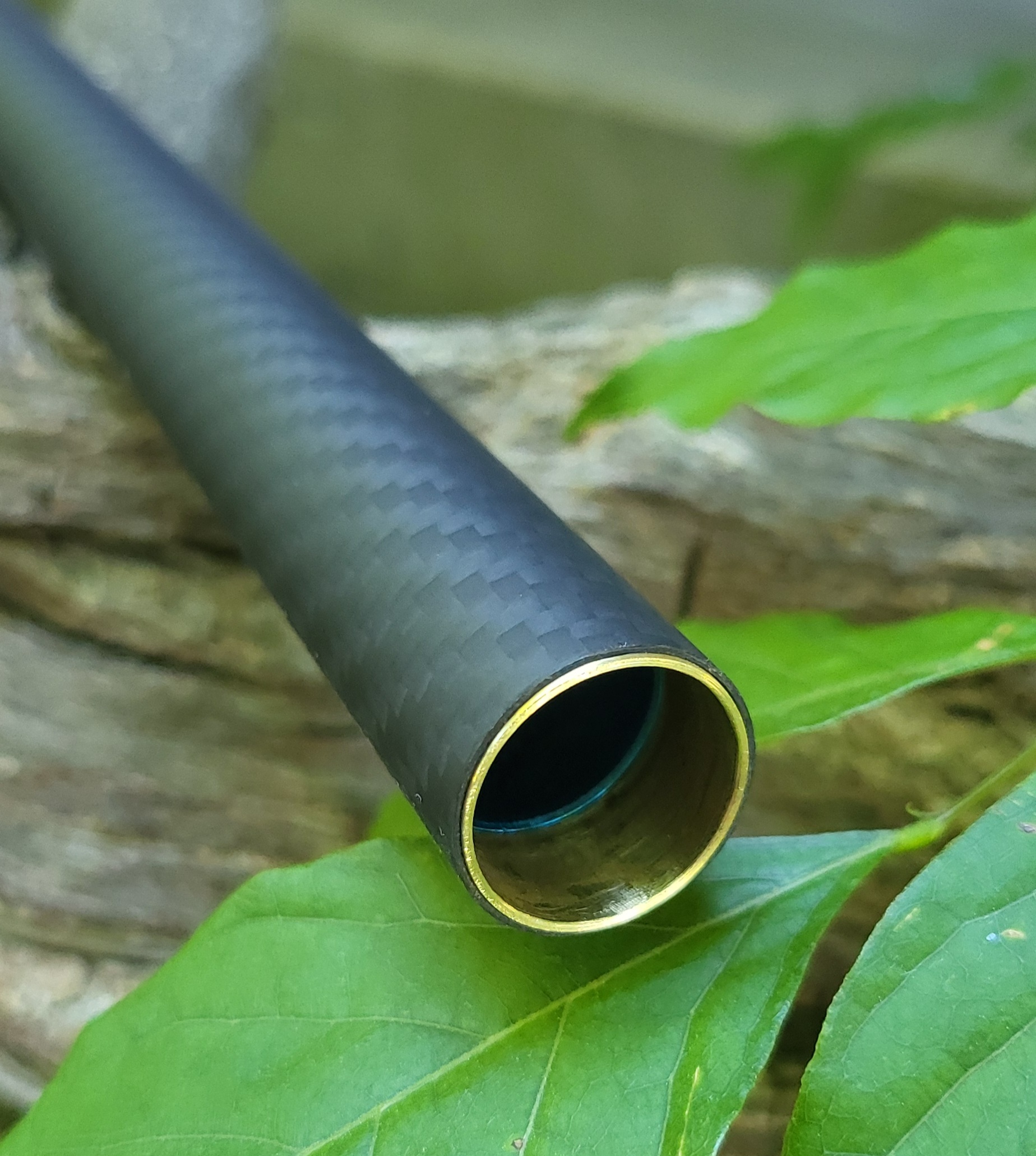

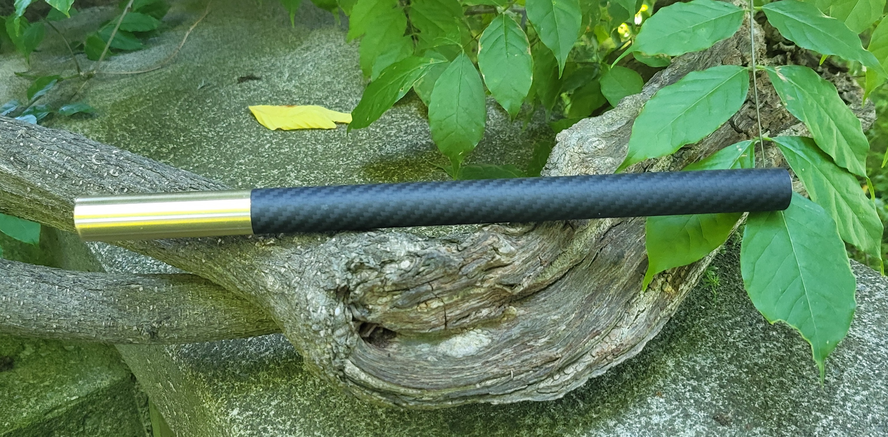

    Ported and polished and epoxied in place.
    Fun build, it's interesting working with CF.

    that looks awesome. where did you get the cf tube?
      Jordan commented
      Amazon - 20mm OD, .5mm wall thickness (19mm ID, fits Freak inserts perfectly).

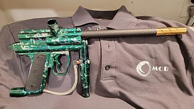

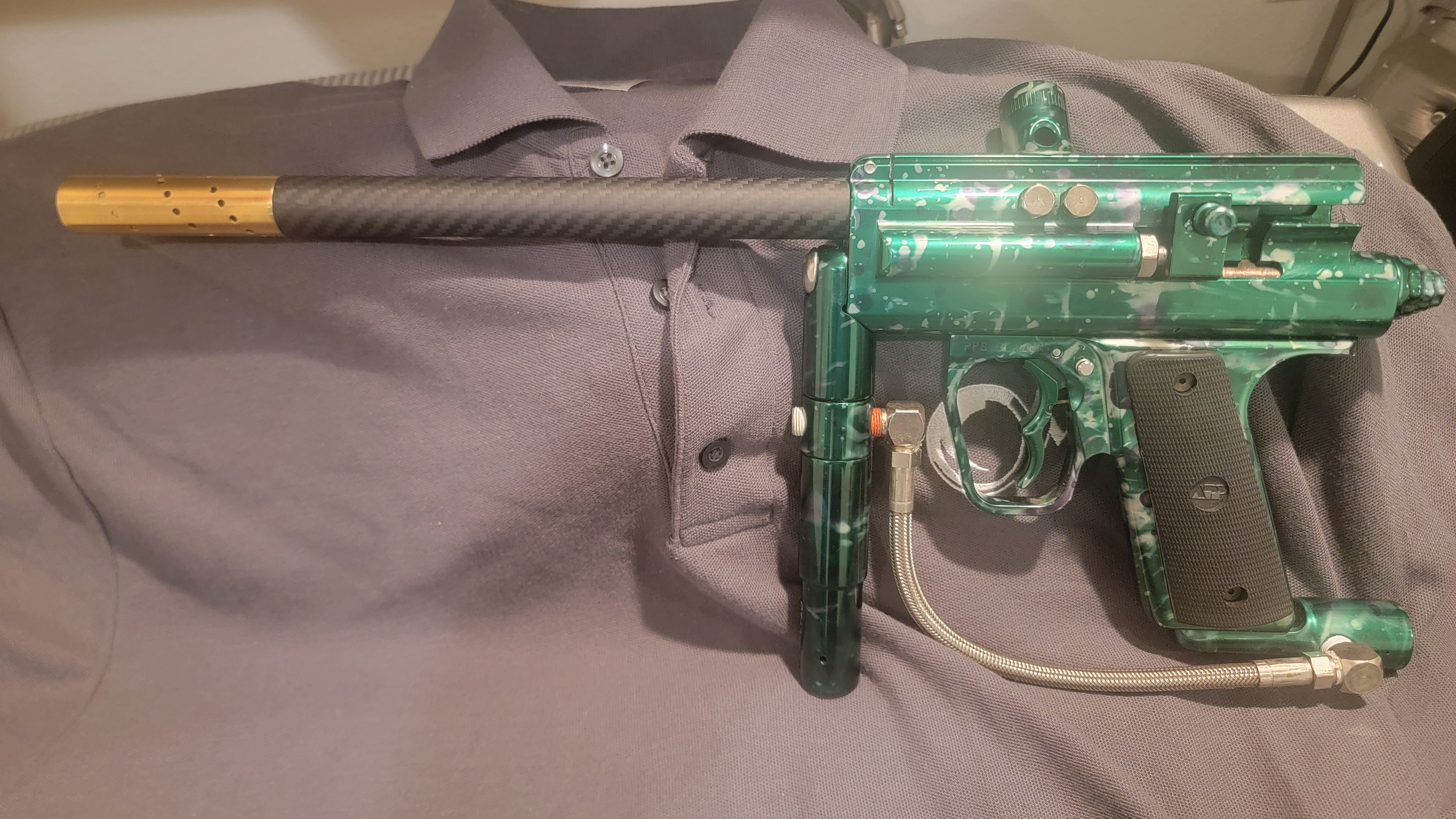

        Got my Blazer barrel from Jordan a week ago and just hadn't have time to post but here it is.
        Fit and finish are great. Hopefully will get a chance to use it next weekend.

          Jordan commented
          Looks good! How's the balance on it? I made the tip short to avoid it being front heavy.
        • El Gringo
          El Gringo commented
          Balance is nice. So used to a brass barrel and the weight of it, this feels super light. I think the slight weight of the brass on the front will be awesome shooting her.
