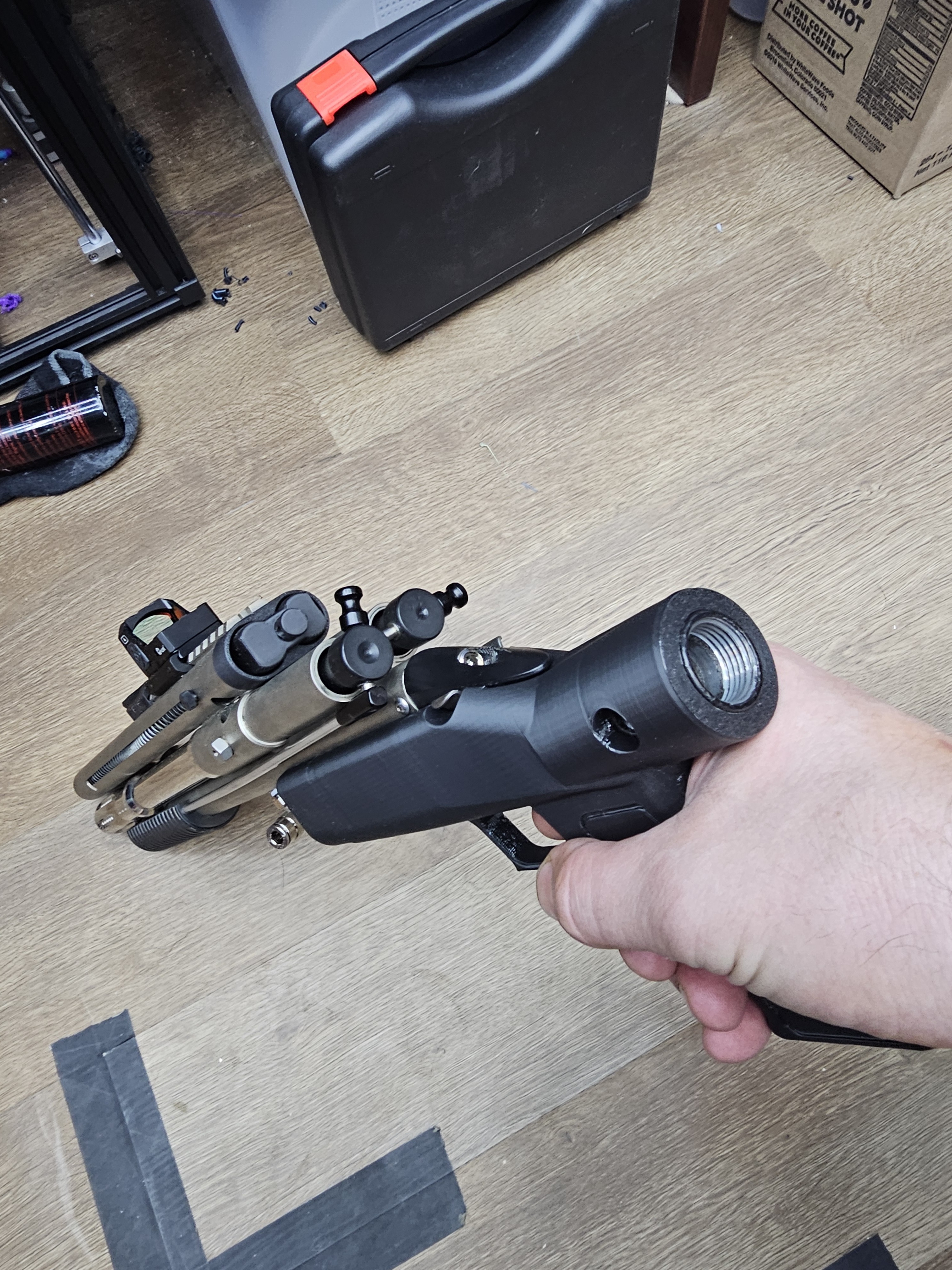

              I was curious if anyone had tried to fabricate a 12 gram assembly that pierces 2 at a time.
              I've got a few ideas kicking around on how to Pierce 2 and I think check valves on each piercer would be a good integration.

                McMurray did a dual pierce 12gram in KPs. They punctured both and pressurized the lower tube. I have one of these assemblies but never really used it on a gun.
                Bacci did a video: https://www.youtube.com/watch?v=lHRuZjcvibw

                iirc k1's came with dual 12vie setups, hence the bleed valves in front of the trigger guard... though many were converted to bulk fill

                I've been toying around with it and I'm not quite finished bit here's my current.
                  Jordan commented
                  Pretty cool! I thought of doing something similar with one of my Hurricanes.
