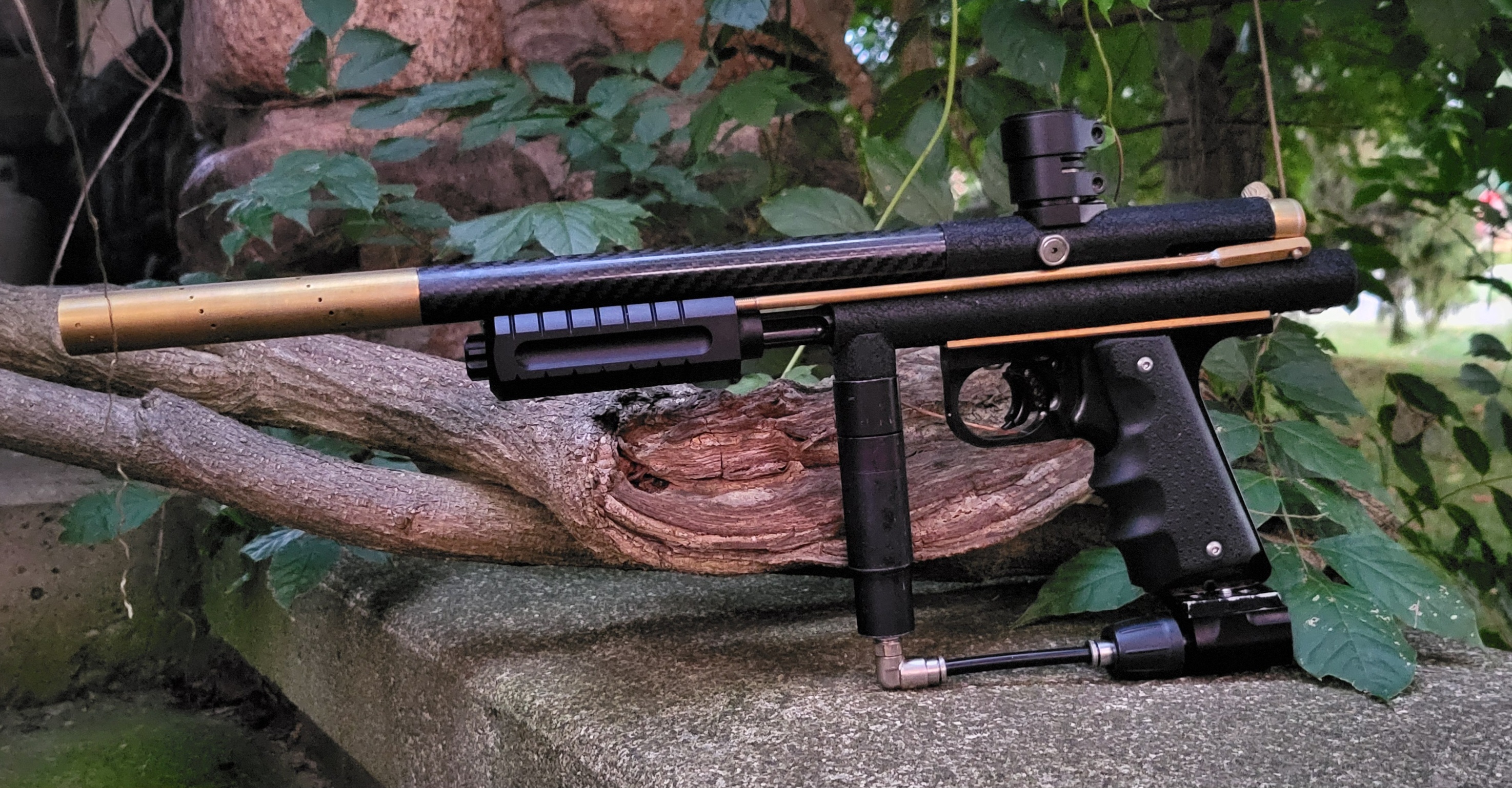

    [Deep breath] Brass chassis, 11/16" PPS LT valve, halfblock hammer with PPS Typhoon bolt, ANS Nelson spring dialer, slip fit barrel retained by a thumbscrew on the right side. Cocker derent, CCI-Empire feedneck adapter (can also bolt on a modified CCI feedblock for SC) with ID feedneck, modified Meteor pumpkit, slide frame, female Stab. [Phew]
    270fps@300psi.
    Pretty pleased with how it turned out... it may get a Laz valve but I really like how it shoots etc at the moment so it might just stay as is. My Laz valved Trilly build is giving me troubles occasionally and I prefer to keep a pump reliable, regardless of how homebrew it is.
    The final look may change - I'm still waiting for some parts in the mail so I stole the frame and detent off my Trilly, a bolt from my Hurc, and the feedneck off my Ion to roadtest this thing - but not by much.

    Very well build as always, the portings on the barrel tip look perfect!

    kind of shocking that you need such high operating pressure given the length of that lower tube... either way, looks great!

      Yeah, most of it is taken up with pump kit. 🙂 The Meteor pump guide is pretty long but it solved a few problems with my build.

        Very cool build. Did you sleeve the air passage to increase its diameter or is that just drilled through the solder joint like a stock Sheridan?
          Jordan commented
          I was going to sleeve it but couldn't find any 5/16" ID brass tube with a thin enough wall, so I drilled through the solder joint. It's not super noticeable but the solder is built up around the transfer port.

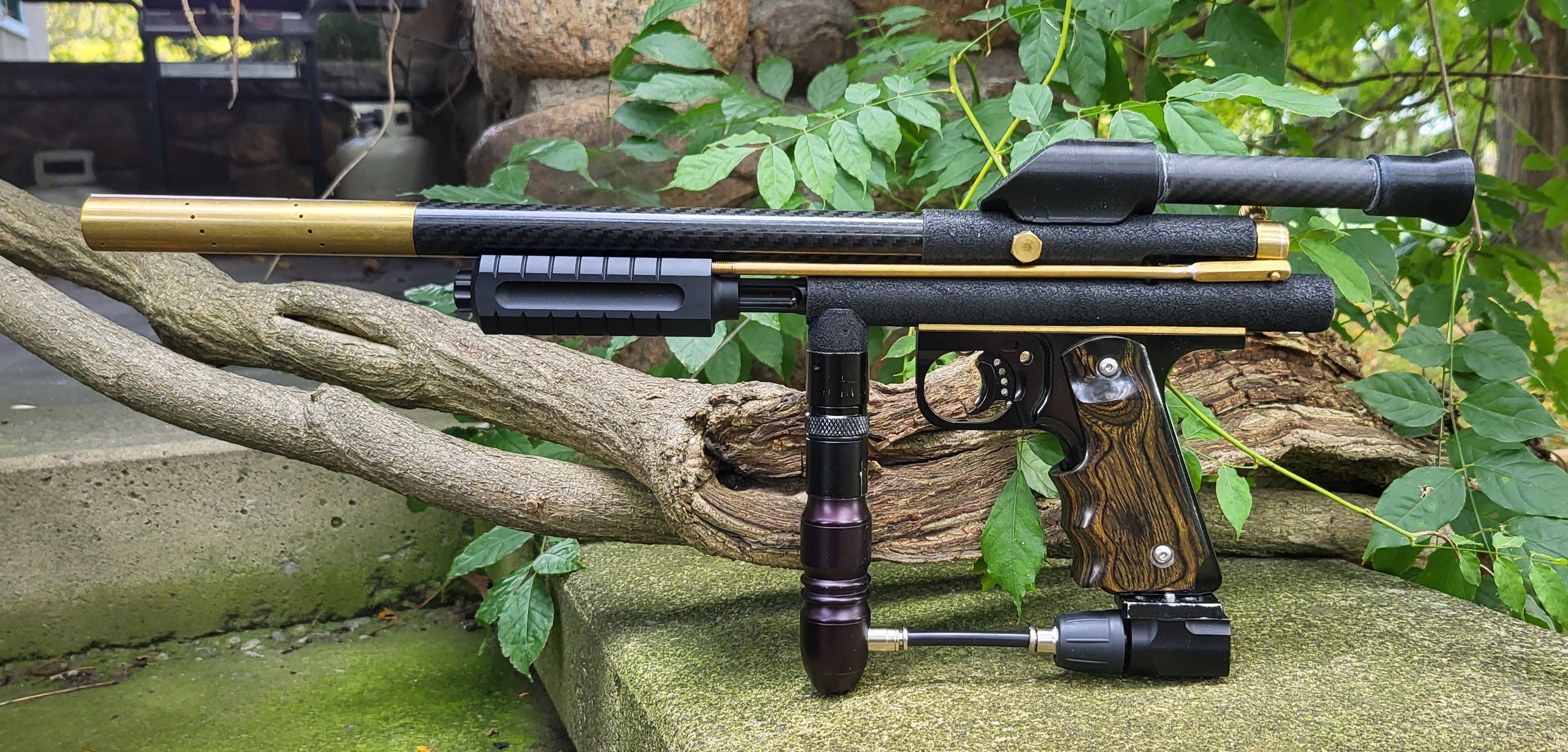

        As an update - the final configuration.
        I used it this past weekend and it shot great... OP ended up around the 250psi mark, two turns in on the dialer IVG. On Monday I swapped out the Stabilizer that was on there for a WGP preset reg that I freshened up with a service and reseal, I'll try it and see how it is.
        I changed out the brass panels I had on there for an old beat up pair of Hogues, too - might use them on something else or give 'em away at Walzmas - and I replaced the ID feedneck with an old SR neck I had lying around, my Ion wanted it's feedneck back. 🙂
        I also built a bolt for it out of an old PPS bolt (that had been cut up at some point) and some brass bits, probably the reason for the OP drop - the inlet hole is giant on this thing.
        Super happy with it - it's deadly accurate and it just feels great.

        Wow...it's like an ultra-modern PPS Houndstooth.
          Jordan commented
          Thanks! I really like what Craig came up with when he designed the Lance and tried to do something similar... this is again something I would have happily ordered from PPS if they were still taking orders.

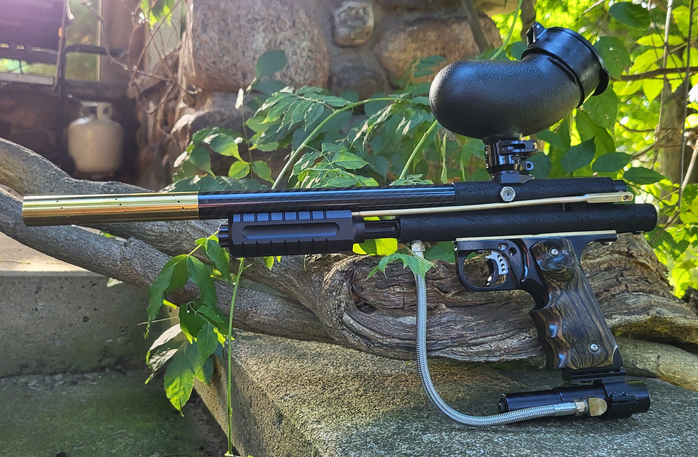

          Made a couple changes this weekend... swapped in a Lazarus valve and made up a SC feed out of some 3d printed bits and a piece of CF tube. I rebuilt one of my Hyper2s and tossed it on there with a spacer to line the macro up with the ASA as well... I needed a more easily adjustable reg for setting velocity.
          It's shooting 280FPS at a hair under 200psi.
