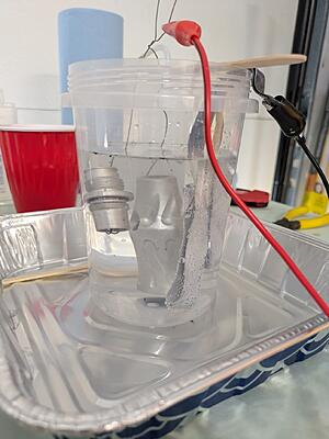

    • ano'd @ 2amps for 1.5 hours before dipping in dye (lead strip anode, ~10-15% sulfuric acid dilution)

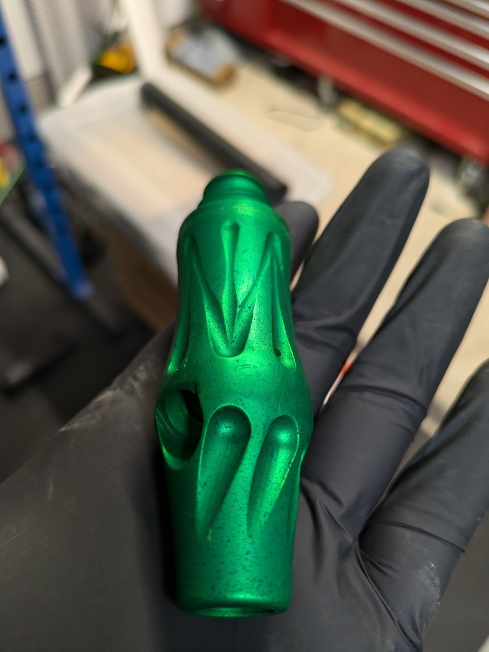

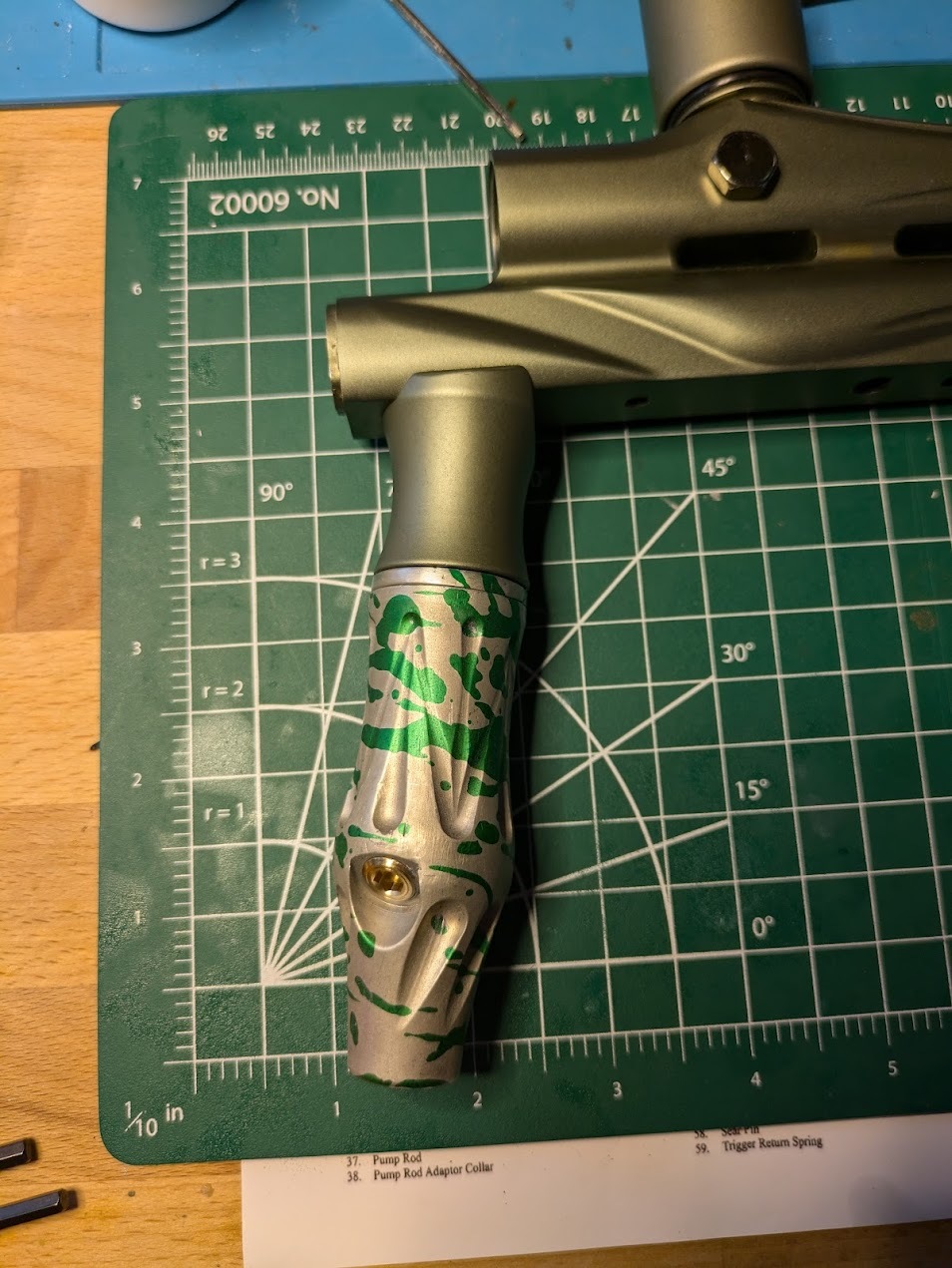

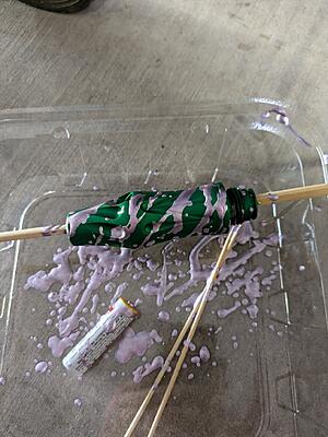

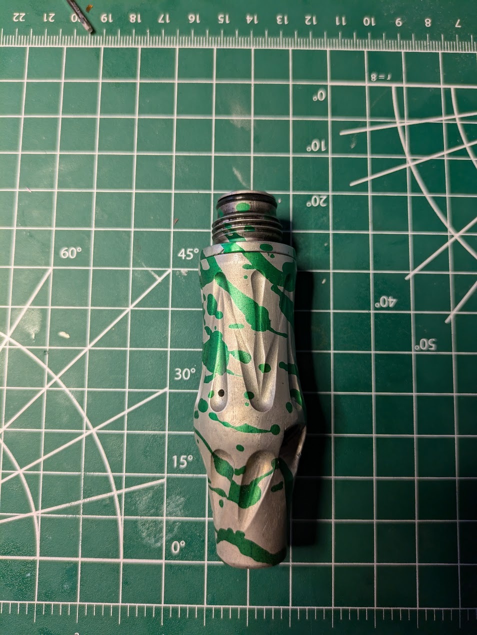

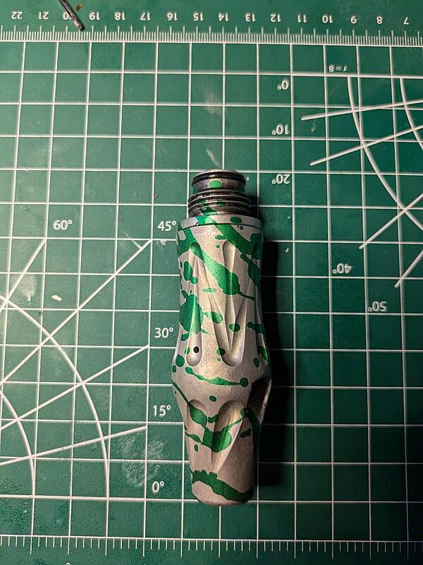

    Here are the results, any tips are appreciated. I originally wanted to do black with green splash but I could not get the black dye to adhere. I'm guessing I either dipped into the green a little too hot (thermometer was around 140-150F when I dipped) or the Clorox bleach-based bathroom cleaner I used to strip the green (my pure bleach was old and inert when I opened it so I had to improvise) contaminated the ano layer with a surfactant or other chemical which preventing the black dye from adhering. I did try to rinse in degreaser and distilled water again but no joy.
    In all, I'm about 90% satisfied; the gouges are gone and the green splash on raw aluminum looks pretty good but won't really match the sage & black scheme of the prostock. If I do it again I would definitely 1) get new bleach ,2) order some specialty ano dye or at least a sage color green Rit dye to more closely color match, 3) spend a little more time on the surface finish (maybe buy a bench buffer/wire wheel), 4) remember to take better before pics so I can feel better about the finished product . Thank for passing through and any tricks&tips are appreciated.

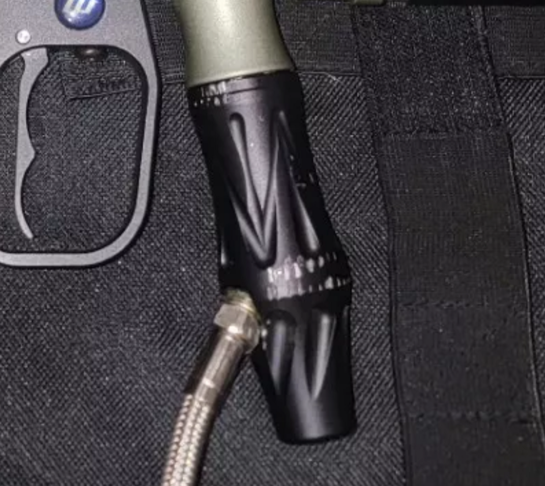

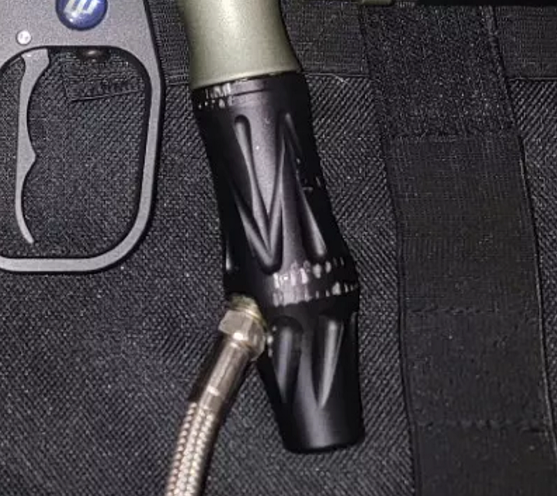

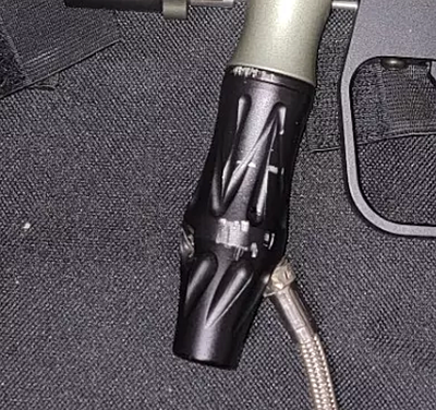

    Before:
    ​ Click image for larger version  Name:	Screenshot_20241012-163740.png Views:	0 Size:	1.10 MB ID:	604127​ Click image for larger version  Name:	Screenshot_20241012-163749.png Views:	28 Size:	1.09 MB ID:	604130

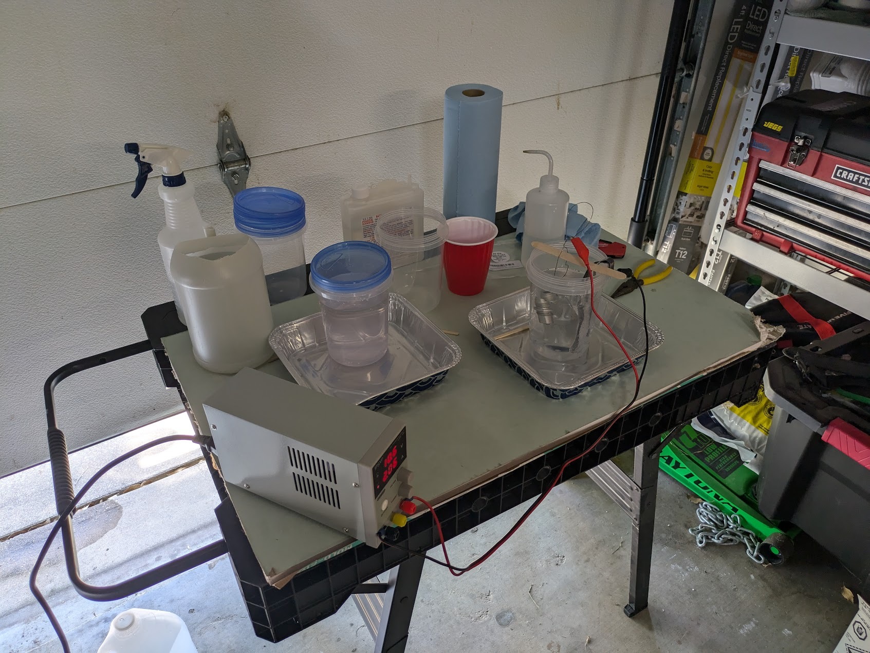

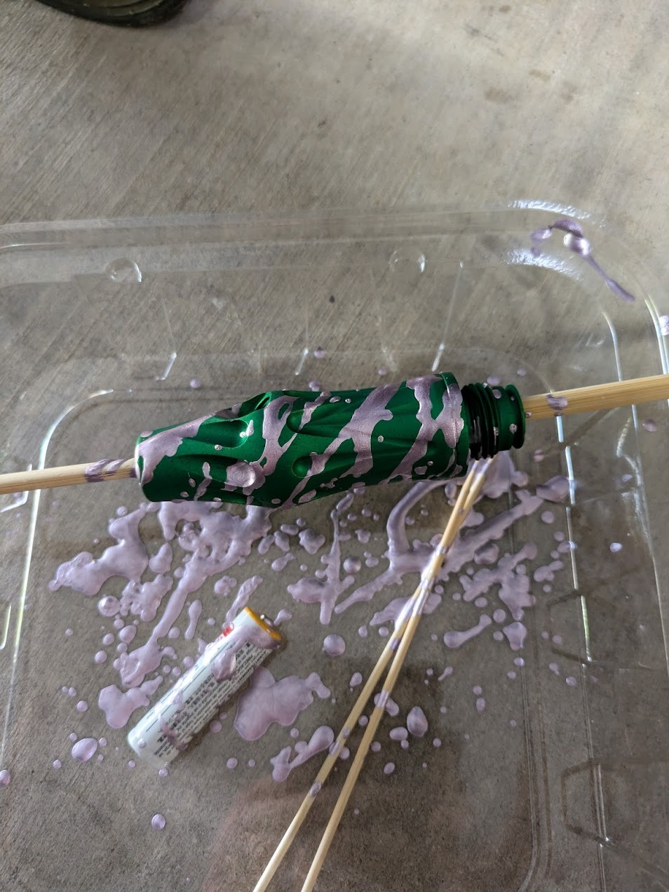

    Intermediate Steps:
    ​ Click image for larger version  Name:	PXL_20241012_210752557.jpg Views:	0 Size:	148.4 KB ID:	604184​ Click image for larger version  Name:	PXL_20241012_194035804.jpg Views:	0 Size:	581.6 KB ID:	604185
    ​ Click image for larger version  Name:	PXL_20241012_211845120.jpg Views:	0 Size:	267.8 KB ID:	604187 ​​ Click image for larger version

    After:
    ​ ​​ Click image for larger version  Name:	PXL_20241013_213256367.jpg Views:	0 Size:	322.1 KB ID:	604128​ Click image for larger version  Name:	PXL_20241013_213330156.jpg Views:	0 Size:	292.1 KB ID:	604129

    Looks great! How long did you keep the part in the black dye? I find black dye takes way longer to absorb than other colors most dyes I do for about 10 mins or less black takes 1 to 2 hours even when heated
    • gogi19
      gogi19 commented
      I tried for about 45 minutes. If you look closely, the top cap was taking on some of the black dye but the reg body was barely tinted.
      That's good to know though, maybe I should have just upped the concentration of the dye and let it sit longer. The dye dilution I used was about 35 ml for 1 quart of distilled water for the first run, then I added an additional 35ml of dye for the second try ( so about 1/4 bottle of dye for 1 quart of water).
      I was just discouraged because, like you said, the green looked super vibrant after about 10 minutes with the same mix ratio (added a picture up top).
