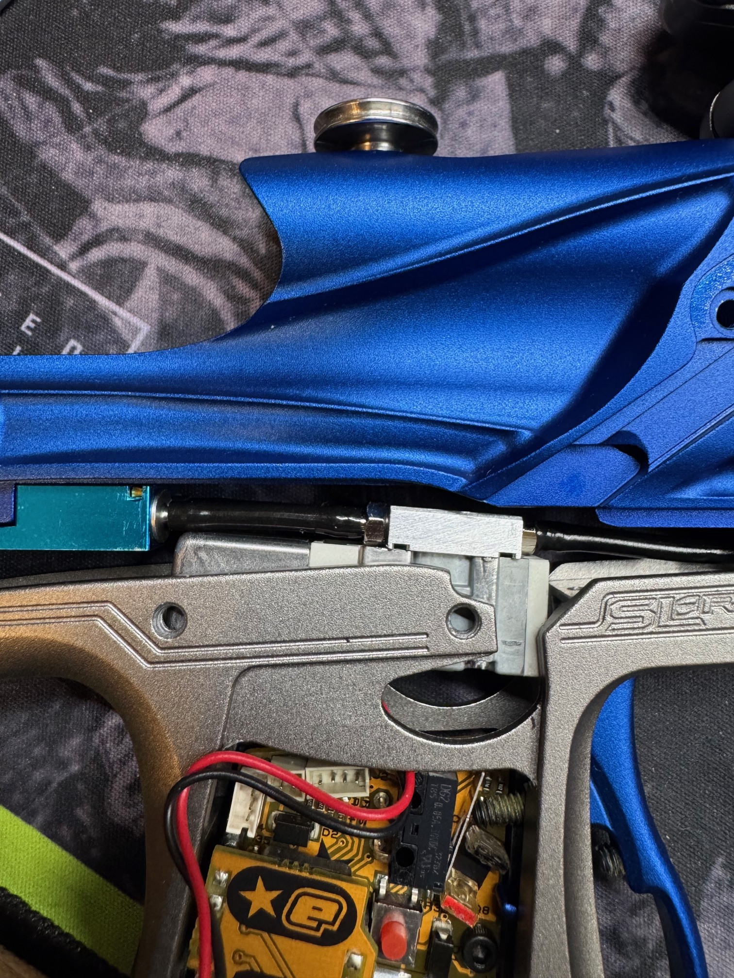

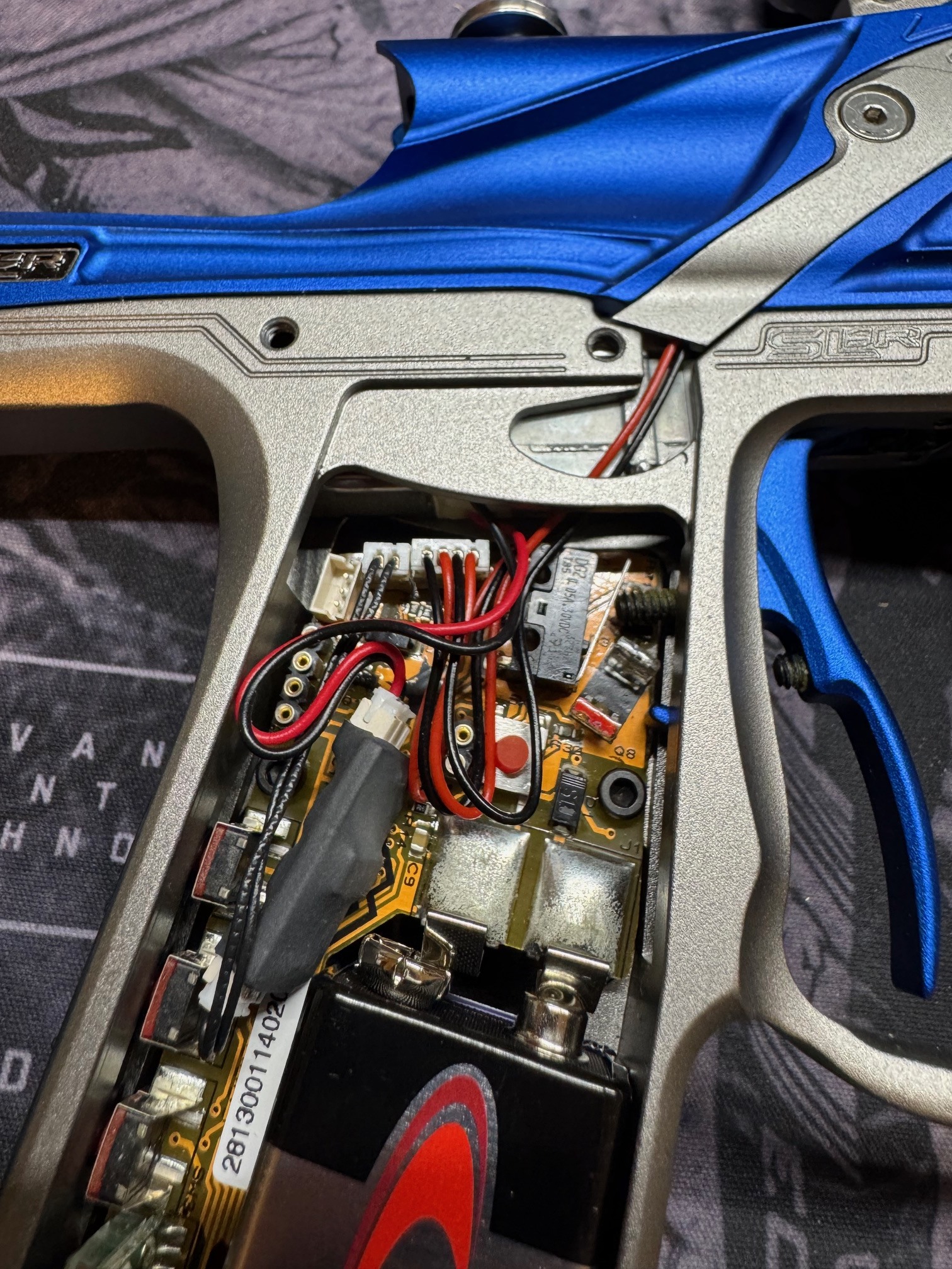

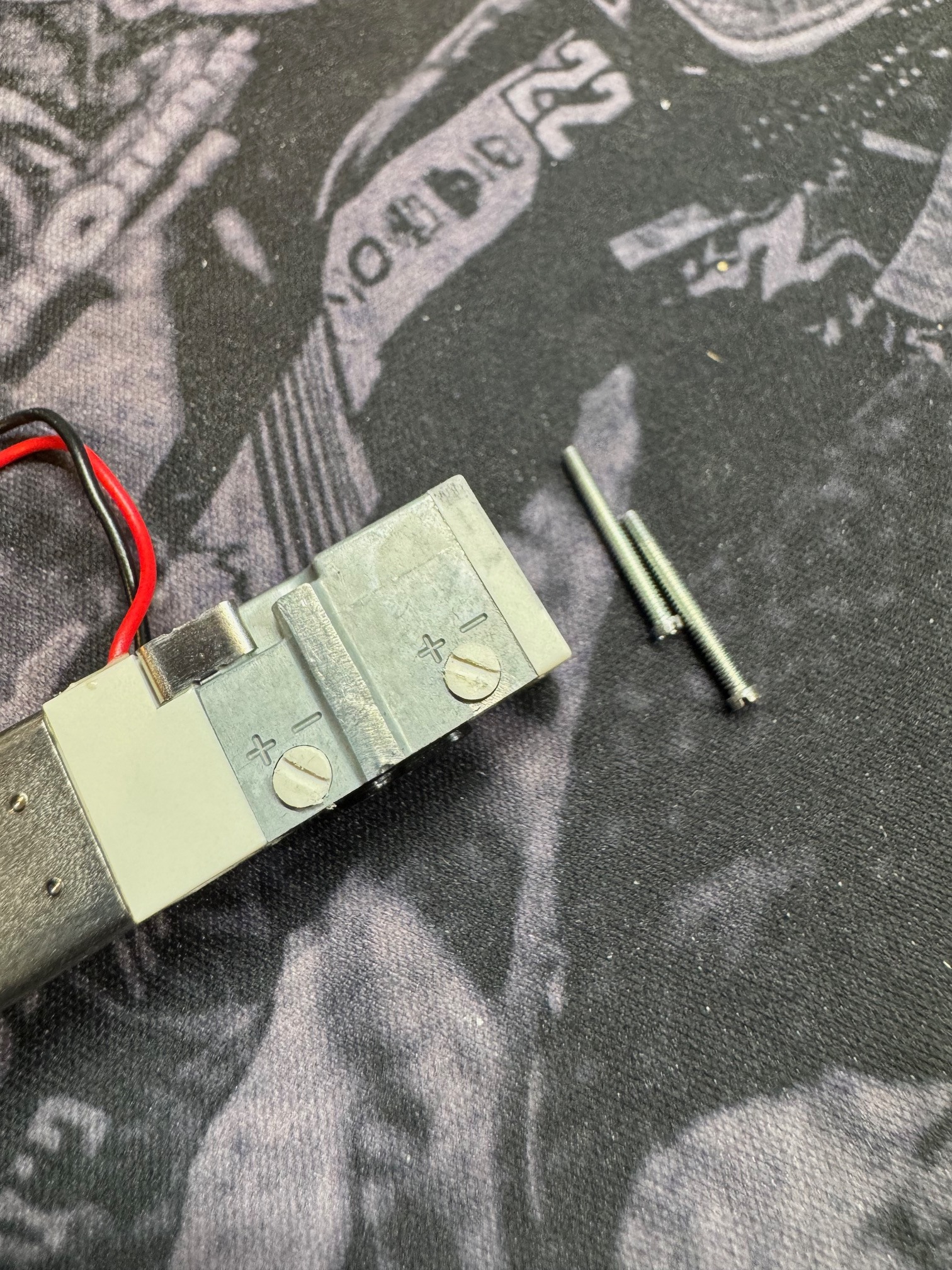

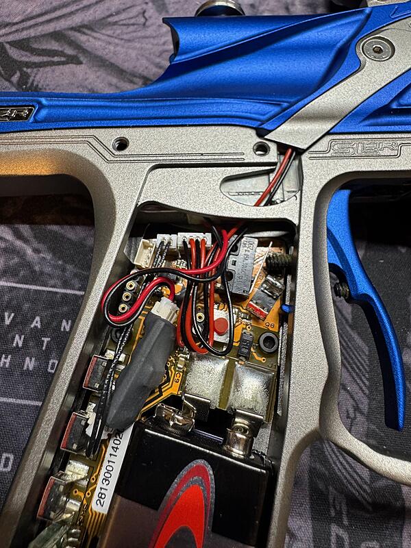

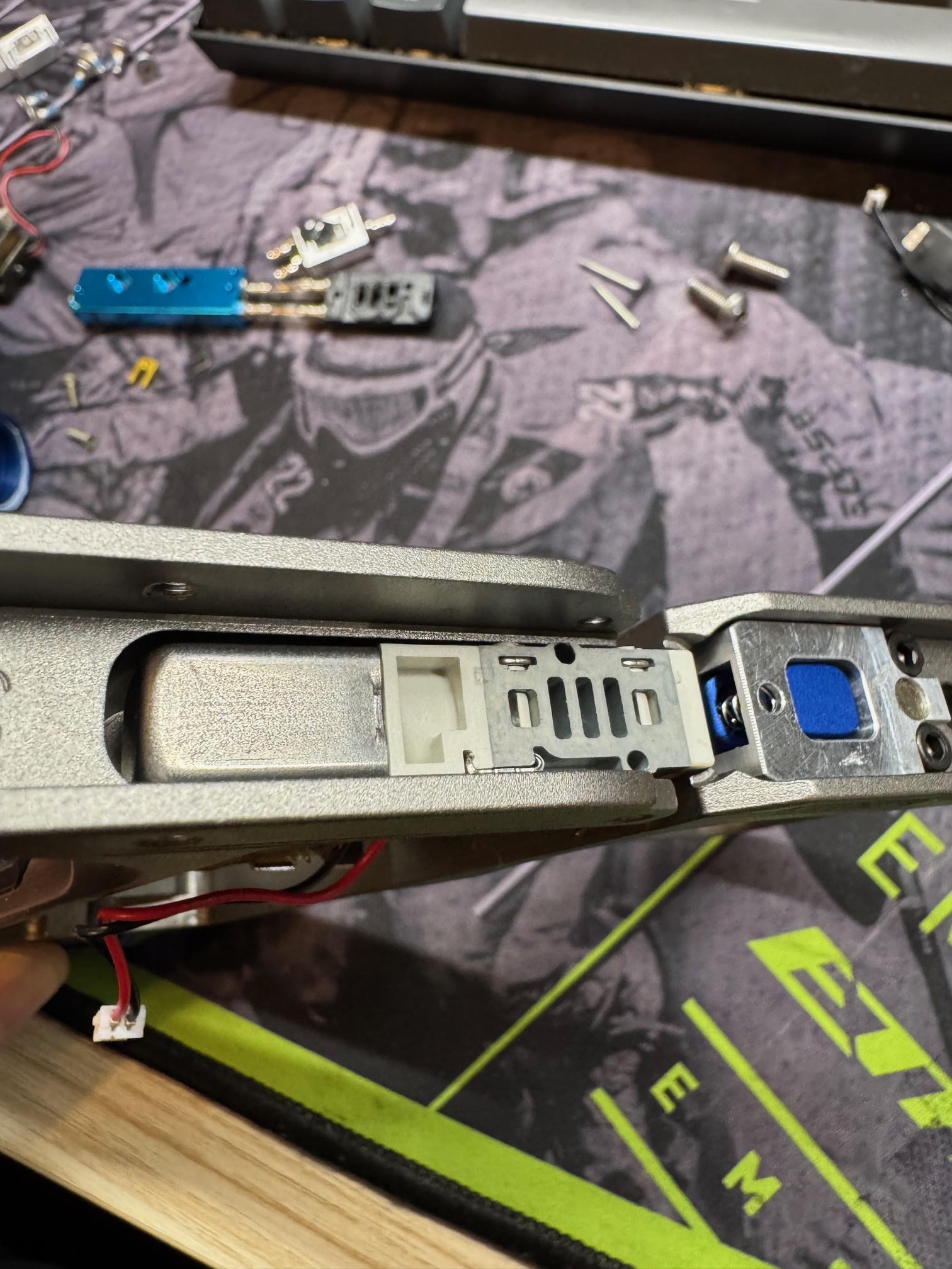

              A small update. I redesigned and rerouted the air channels on the manifold because it bothered me on how the air hoses were ran in the SL74. The old design wouldn't have worked in an Ego8/SL8R with it's QEV block. It's a tight fit for my SL8R with the LV2 solenoid, but it fits and it works. Also, I had to remove the expansion board to fit the voltage regulator.
              Not sure if I mentioned this before, to fit these solenoids, the screw channels and screw heads had to be sanded down.
              Shooting video of the SL8R coming tomorrow. Enjoy the pictures for now.
