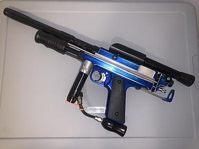

    For years now I have wanted a Pro Team Stock Class Sniper or at least build a stock class sniper. I had a pre2k vert feed I found on CL. It had the top milled and drilled to accept a CCI feed. And it had a bucket changer. I had trouble with efficiency with 12ies and couldn’t get it to shoot more than 14 shots. I posted it up for sale as a whole then as parted and no bites. So I ended up putting a regulator and an on off asa and on compressed air it shot so well. I ended up trading it to my best friend. I have been enticing him to get it back but he said it shot too damn good. I agree it shot darts. It was ugly but it shot beautifully.

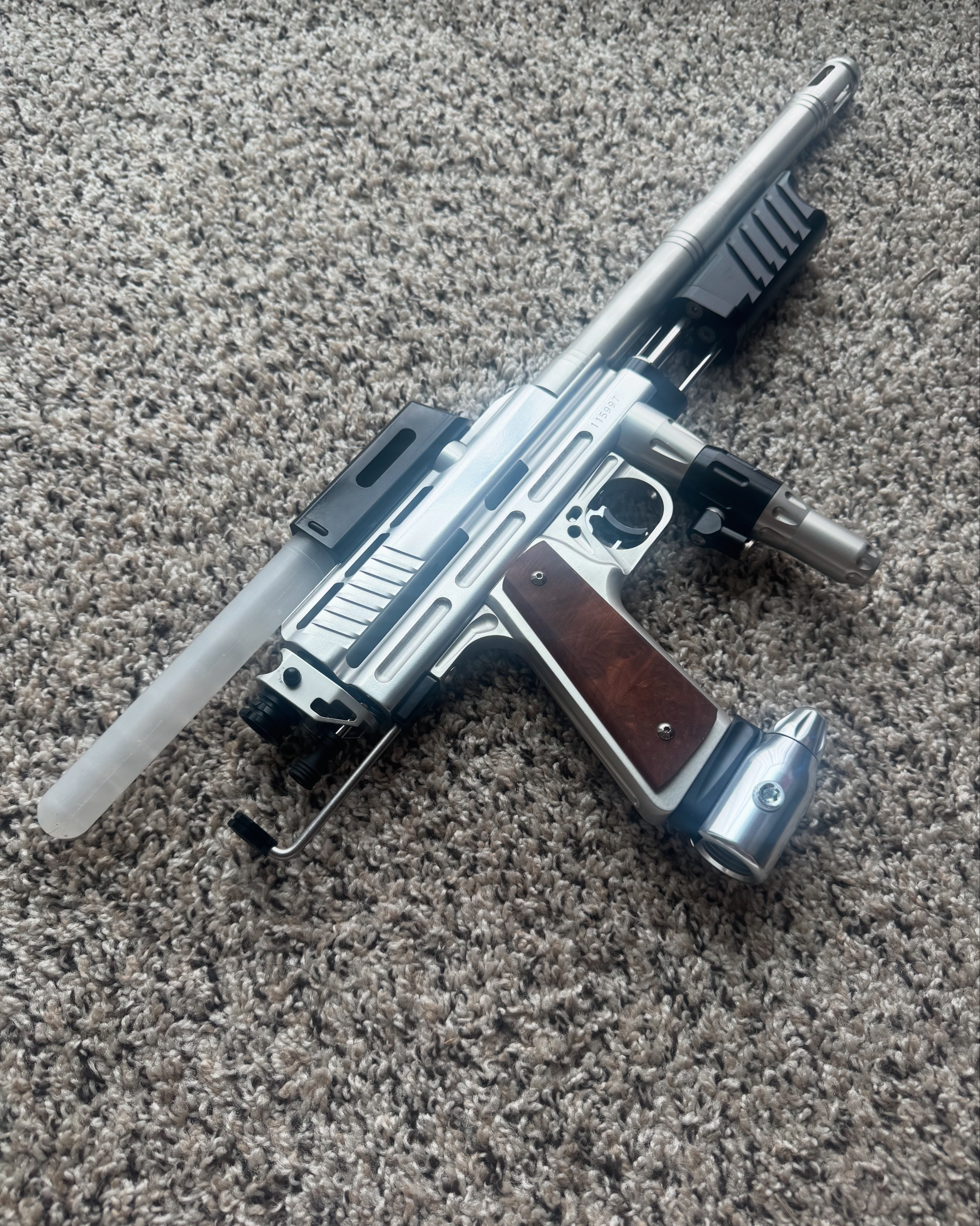

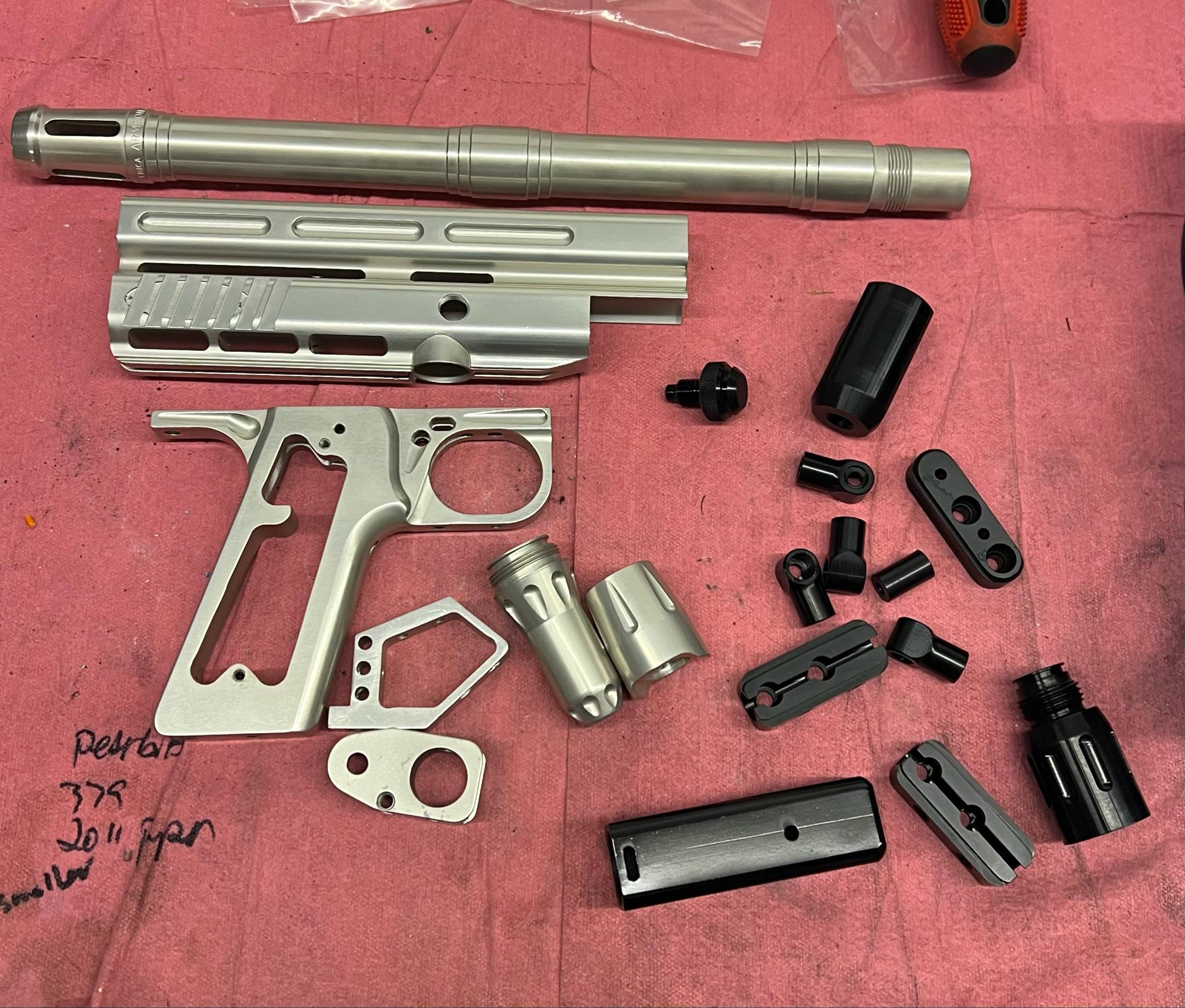

    Unfortunate day, I was so happy to finally be able to complete this project. Unfortunately the anodizing cooked the frame mount threads. I guess helicoil will do. Welp the only way to salvage the body is to bore it for 11/16th valve. Get a ATTKTX gold chamber. Another $200.
    Cant thank EstiloPaintball enough. He saved the body and helicoiled the threads.
    I can say this is complete. On to the next one.

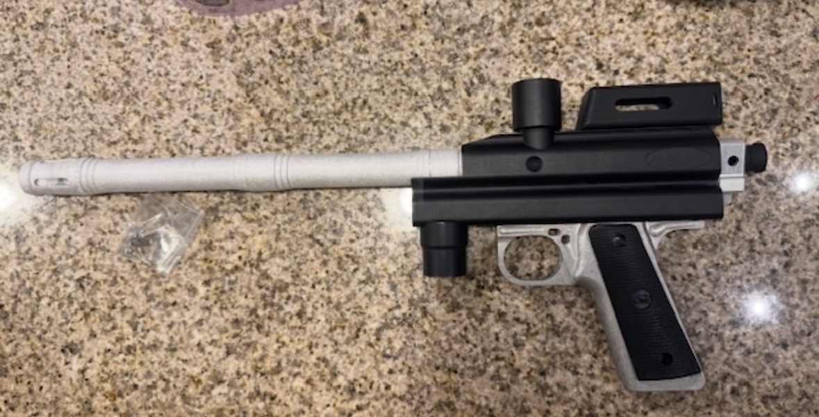

    My old Stock Class Sniper that I traded to my friend. So ugly but it shot straight. Point shoot kill.

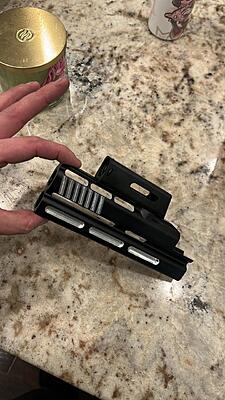

      Quick little mock up before milling.

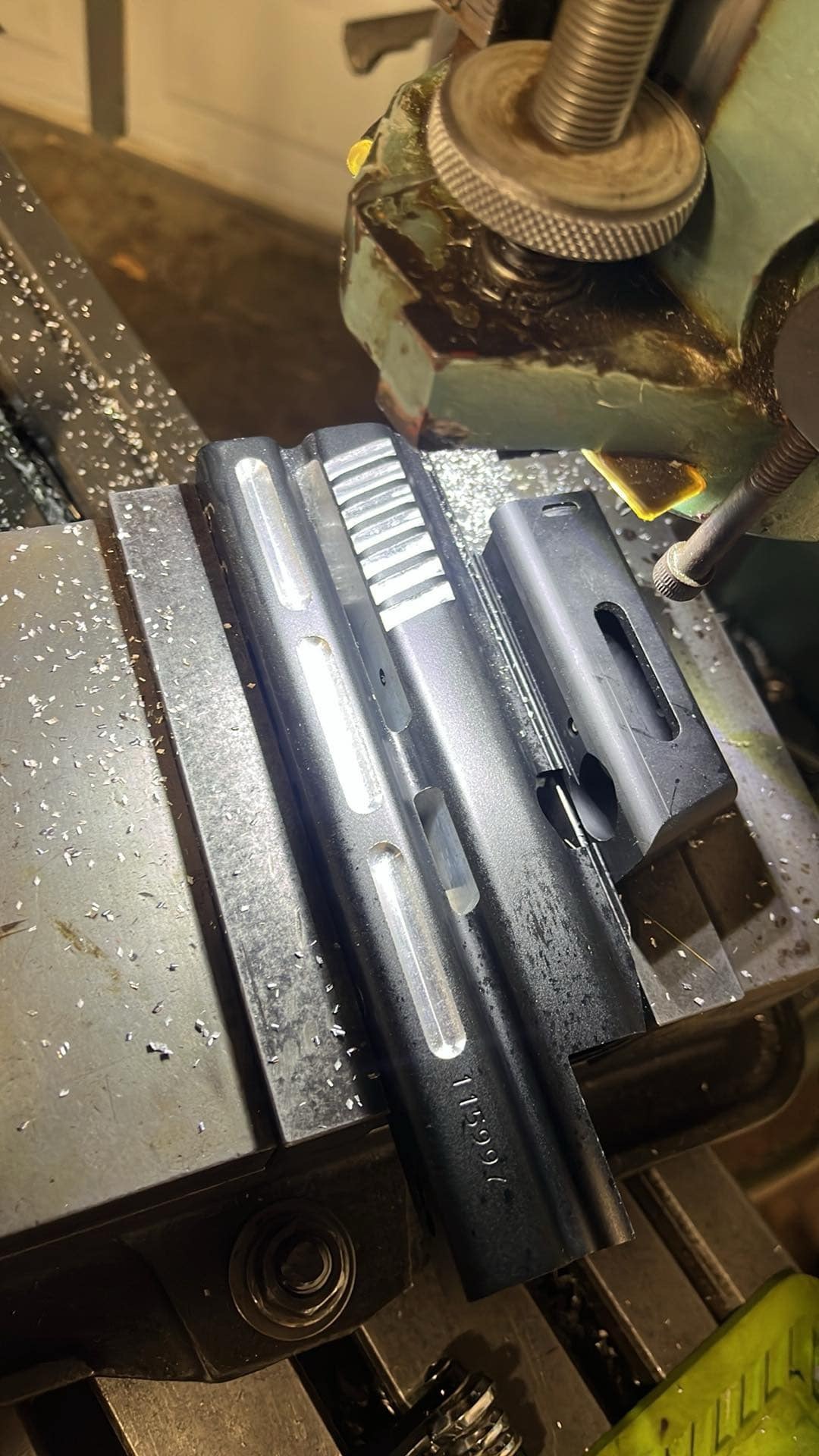

          Estilo finishing up milling

              correct the PTSC SC feed is held in place by a single allen key behind the feed hole, the PTSC bodies were CCM threaded for the feedneck itself as well
            • Pogi Si David
              Pogi Si David commented
              Yep it has a set screw behind the feed hole.
              No idea about the dimensions.
              Thanks! Estilo Paintball from SoCal did the milling. His style is Carter inspired. So its now a ptp/carter inspired build.

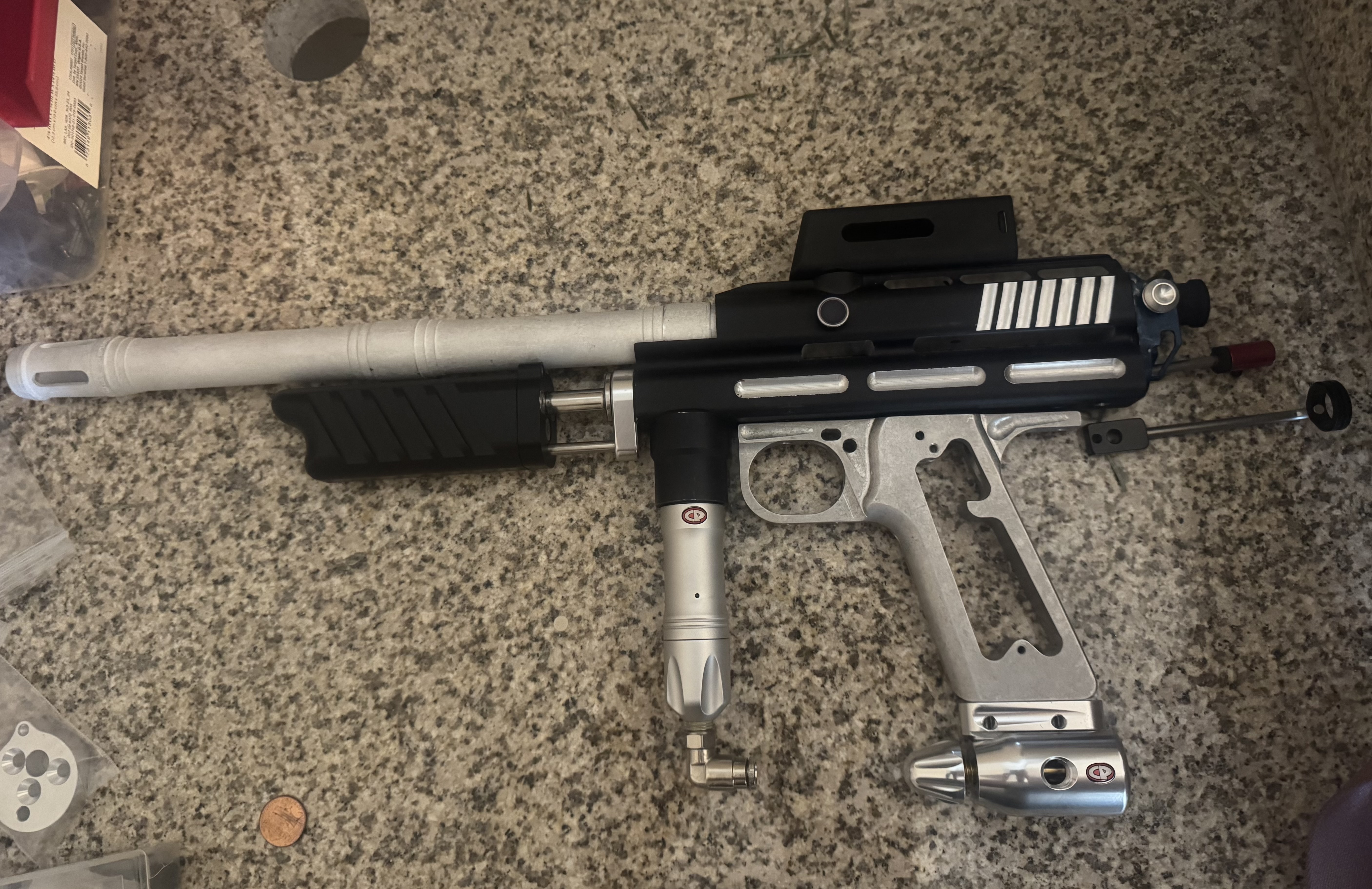

                Body back from milling. Quick little mock up before ano. Still missing small bits here and there.

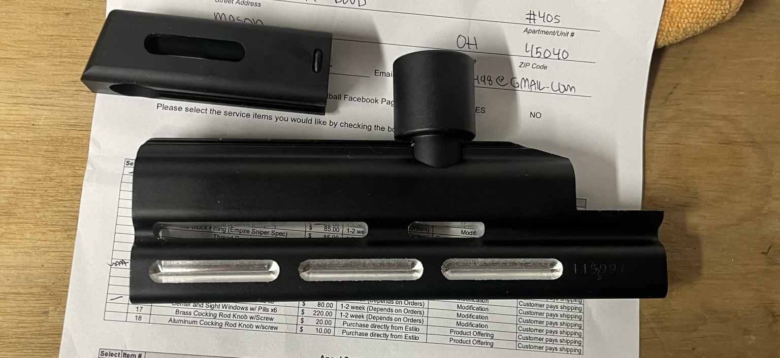

                      Testing pressure and seals
                      • Pogi Si David
                        6th man
                        • 883
                        • Cincy
                        Fresh from ano
