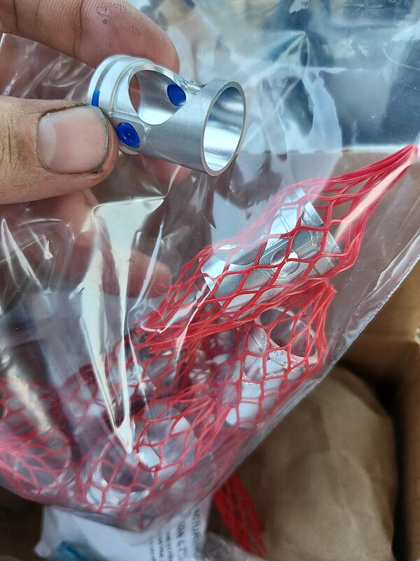

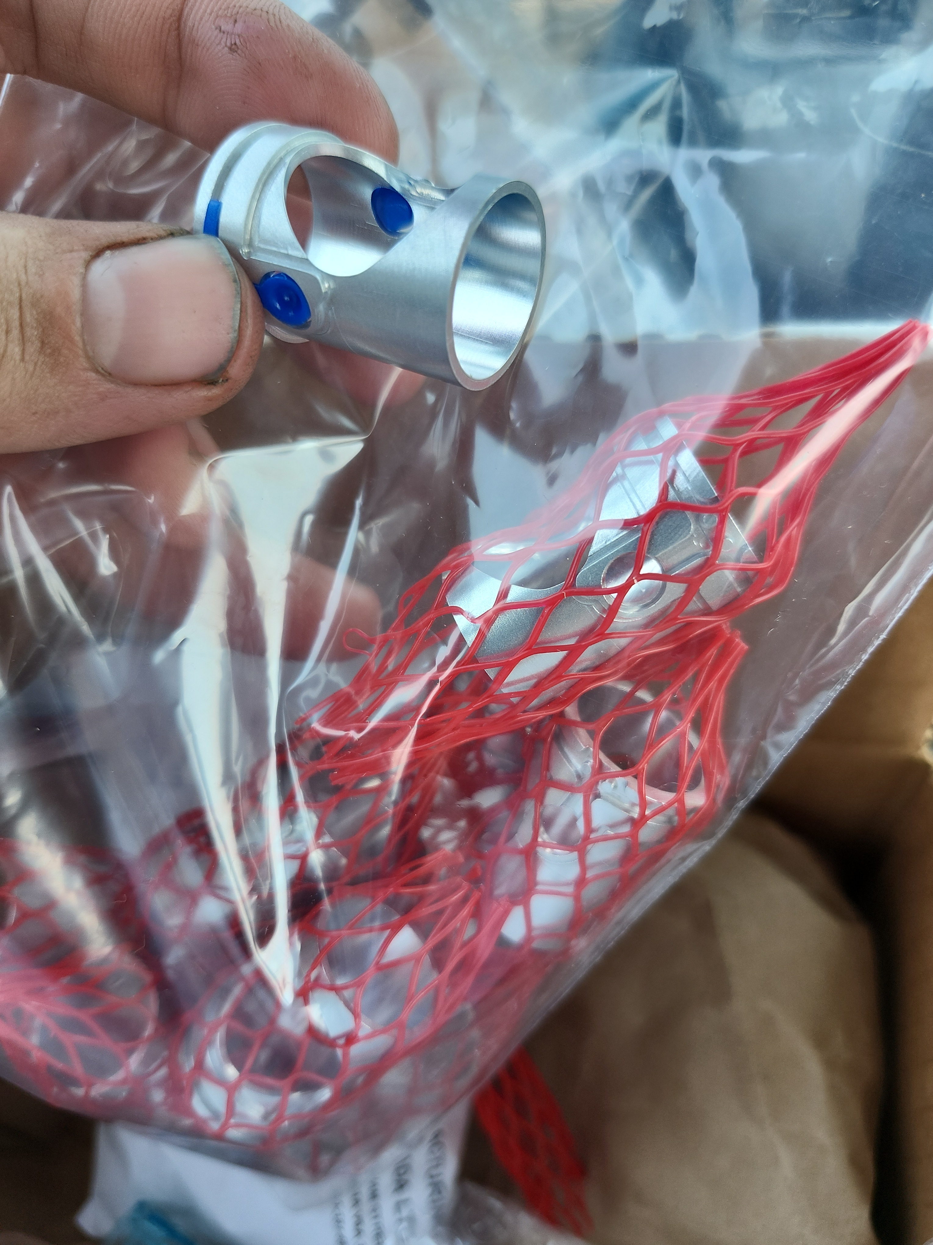

    EDIT: Just got these in from the machine shop. They look dead-on when I measure them against the stock eye pipe. I just need to drill some eye holes and get them anodized. I will test them this weekend.
    Howdy folks. I've been thinking about picking up a Dye marker but the main thing that has kept me away is the plastic eye pipe that will break if you tighten your barrel too much. I have read online that you can prevent this by putting an o-ring on your barrel to help space it out. But even so I'd rather have a metal piece than a plastic one. When I saw the metal eye pipe on the new MXR I thought "Oh good, surely they made it backwards compatible with the rest of their products" but my research tells me this is not the case.
    So my question is: how hard would it be to take a piece of aluminum tubing with an OD of 0.9" and make a functional eye pipe that fits in a DSR? I have done some ghetto-fabulous mods with a dremel and JB weld but I would want this to be a lot cleaner and more precise. Or, which of the airsmiths on here would you recommend for this sort of thing?

                          • drewkroeker
                            drewkroeker commented
                            I am pleased to announce an update for this idea. If you check the first post, I have a picture of my aluminum eye pipes.
                            My OCD wouldn't let this go so I went to a machine shop and had them make me some. The more I buy the cheaper the unit cost. One pipe would have cost $1500 CAD. I decided to get ten and they cost $270 CAD each after shipping. Which is cheaper than me buying a mill and trying to make them myself lmao 🤣
                            I think I will keep three or four of them. I am not looking to make a business out of this, also I am not looking to get in a legal scrap with Dye's lawyers. I would be willing to sell the remaining six for cheap. If I don't sell them they will just sit in a box in my room. I would love to get them out to some Dye shooters who will make use of them. Message me and we can figure something out.
                            Some things to keep in mind: they are unanodized aluminum currently. Also they do not have eye holes drilled except for one that I have tested. I figured it was less expensive to do this myself, plus they don't need eye holes in a mech DSR. The blue plastic detents need to be shaved on the outside with a utility knife in order to slide down into the breech. If you break a ball in the breech
                            it will require extensive disassembly to get everything clean. That being said, they are dead-on accurate when I compared them to the stock eye pipe with my dial calipers. I have shot probably half a case through one of them and they work just fine.
                            So yeah, if you want one message me and I can hook you up. 😀
