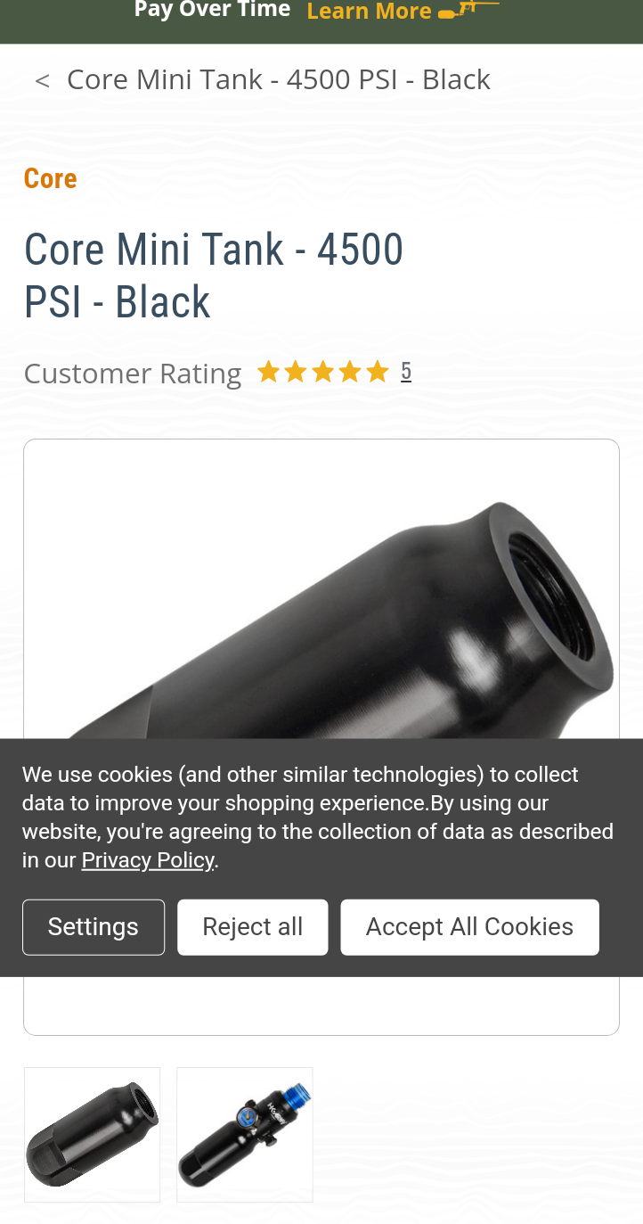

      Have you seen this waste of brain cells...lol
        Someone actually brought one to the field when I was reffing to show it to us right around the same time I was working on making the Delta .68 functional. Can you believe it? Lol.
        Two drawbacks I noticed immediately - it fits a standard regulator and the interior volume is a straight tapped hole and also the reg is as long as the tank.
        I managed to keep my overall length about the same for the reg I'm designing but I may have lost just a bit of internal volume. Might increase the diameters by .1". I also need to drill very thin holes relatively deep. I'm gonna start by giving it a generous counterbore and then drilling into that but if anyone knows any specialty #70ish size drill bits that would be super helpful.
        • 6381
        #19
        Why not use the tank but ditch the reg then? If you are looking to make something that will replace a 12g, that tank is already engineered, certified solution that will cost 100s less than designing your own. Since you were already going to use a separate reg you can still do that and keep the internal volume in the tank instead. You just need to change the threading on your valve
        And then you know, design an entire marker around that

          #20
          Mostly because that tank's internal volume is less than a cubic inch. I vaguely recall reading that it's good for like ten shots if that.
          In engineering school they always taught us to do all the math upfront so when you're modeling it's basically just plug and chug, and that works when you're designing something who's layout is clear like a combustion engine or something. What makes this project especially difficult is that I'm still trying to "find the machine" while being limited to piston sizes that correspond with oring sizes. I did have to spec a custom spring but at least it's an existable spring.
          This isn't really about the cost, it's moreso about finding ways to bring about the technology I need in order to distill my feelings on what the sport of paintball is capable of being and present that in a format that is fun and safe so it can be shared with others.
            • 6381
            #21
            Originally posted by PickupPaint
            Mostly because that tank's internal volume is less than a cubic inch. I vaguely recall reading that it's good for like ten shots if that..
            Man, too bad nobody mentioned the wall thickness might be an issue earlier. Oh well
            If we use that 2.5 cubic inch 3k tank I theoretically designed above, common paintball math gives it a shot capacity of 25 shots on a full size marker. On a pistol, I think 20 would be a best case scenario and since the tank itself was also a best case scenario I'd bet real world it would end up closer to 15. So, why? A 12g will get more shots, close to double, be at least half the size and a quarter of the weight at most.
            Why as me the player, Should I want to go away from a 12g? And, I would not need just your tank but the whole marker and multiple tanks in order to just use it.
            "Just to be different" is a reason but it's a pretty hard sell
            And just for reference, with the exception of MAYBE the sydarm, I don't think anyone has ever made a "good" semi auto pistol, definitely nothing currently made i would consider good
            Ok but what technology? What niche is this filling or advantage is this giving? It feels like you are trying to start fires with Flint rocks when matches already exist simply because everyone uses matches.
            Everything so far just based around the tank is saying it will be larger, heavier, give less shots and in all likelihood be waaaaay more expensive if it ever went to market than, well really any pistol ever made.
            If you are going for a rifle, the 9 and 12 ci tanks are being integrated into the stocks of a lot of the FS capable mag feed stuff these days and with those you can typically shoot as many magazines as you want to carry. Why would I want to carry more equipment just to shoot the same amount?
