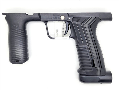

        PE is currently out of stock on Emek trigger frames/lowers. Anyone have one to sell or a boogered up one for testing? I don't plan on cutting into my Etha 3M lower or buying a full new marker to convert to pump.

            Originally posted by RPP
            Inception seems to have some in stock.
            Thanks, but that's a full/loaded lower with regulator, ASA, etc. PE had some of the empty frames for <$30, but they're currently out of stock.

              #21
              Ahh yes that makes WAY more sense.

                #22
                Check out MWR paintball. Its not a 1/1 but his emf frame was the only way I could get an emf lower.
