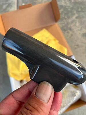

    Did you see the results Brian got from aluminum 3D printing. Might make it a bit easier / quicker prototyping. I’m eagerly awaiting the testing results.
    I don’t know many members by their names. What’s the screen name? What project? Got a link?
    The metal printer I have access to isn’t running yet.
      Sorry BLachance75 had some stock class feeds printed polished and anodized. I’m pretty impressed with the capabilities of aluminum 3d printing.

    I had this printed out of aluminum through PCBWay.
    Red One
    • Rainmaker
      Rainmaker commented
      That is slick!
