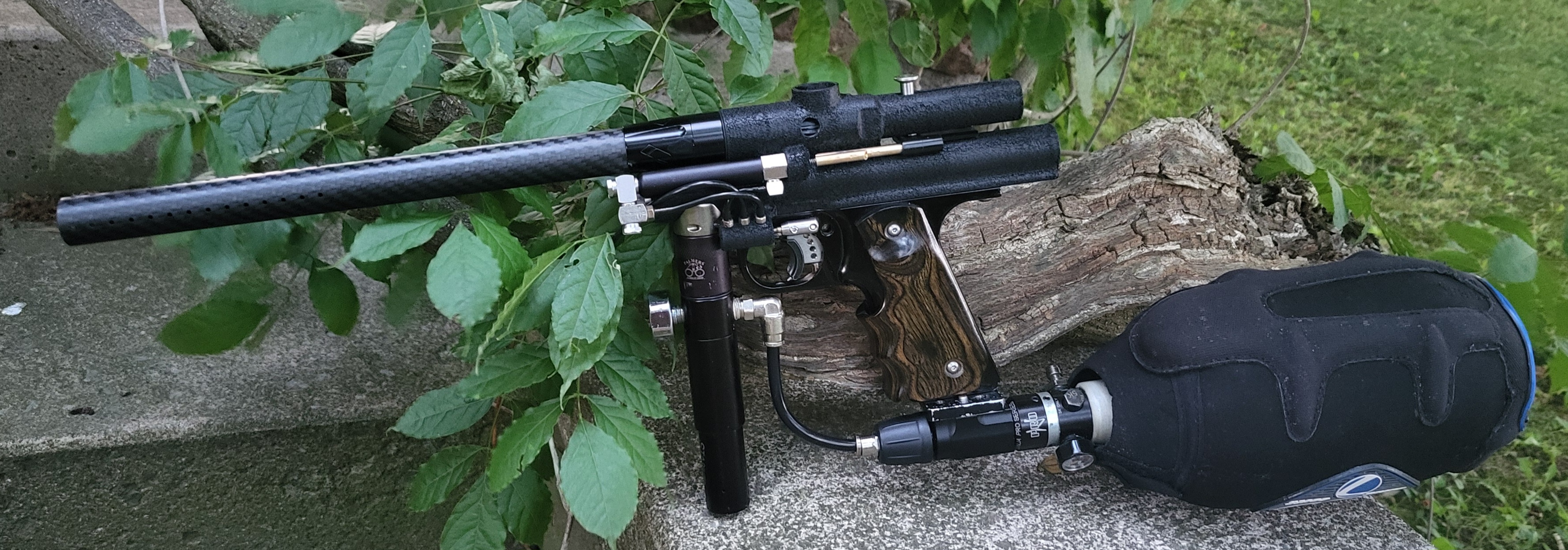

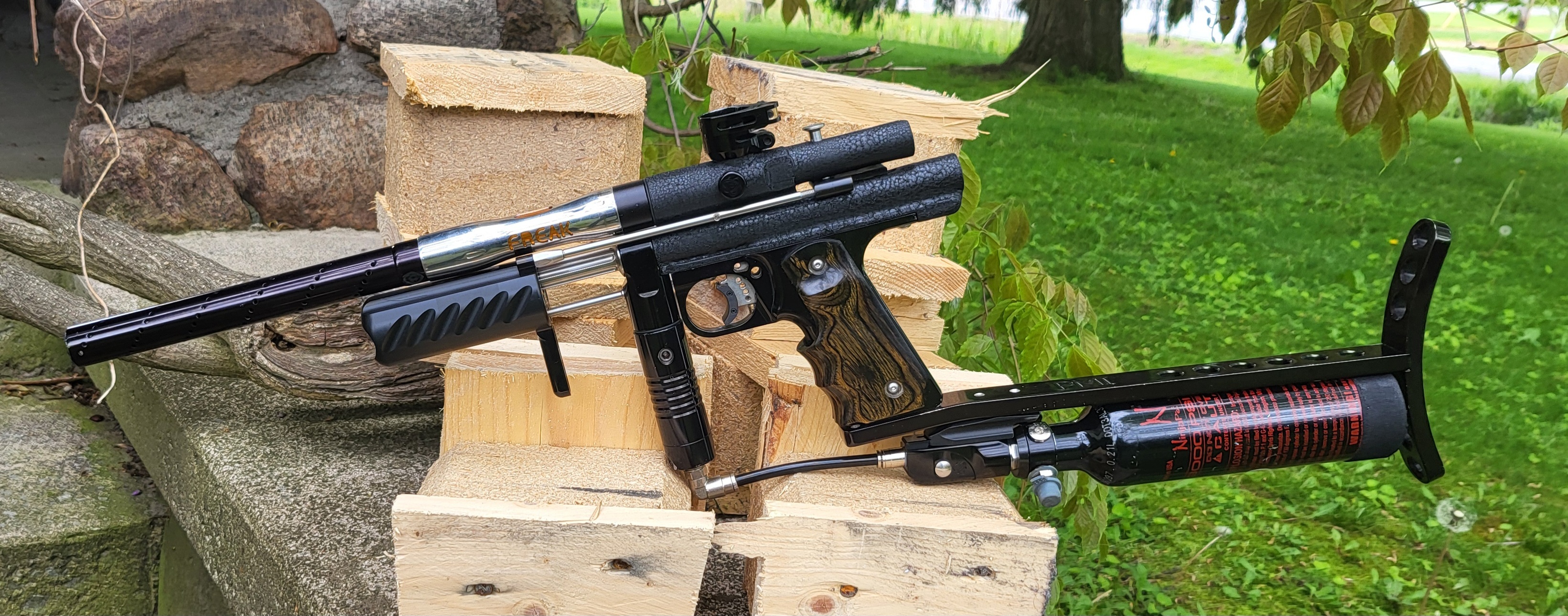

    So, I built a pump earlier this year:
    It's got all the bells and whistles - I took what I like the most from my various pumps I've built and cccccccombo-ed it all together (ID Drift pump kit, bolt, sled, Palmers LT valve, ATTKTX Gold Chamber modified into Mini format, slide frame, etc). It points well, feels great, and I'm super happy with how it turned out.

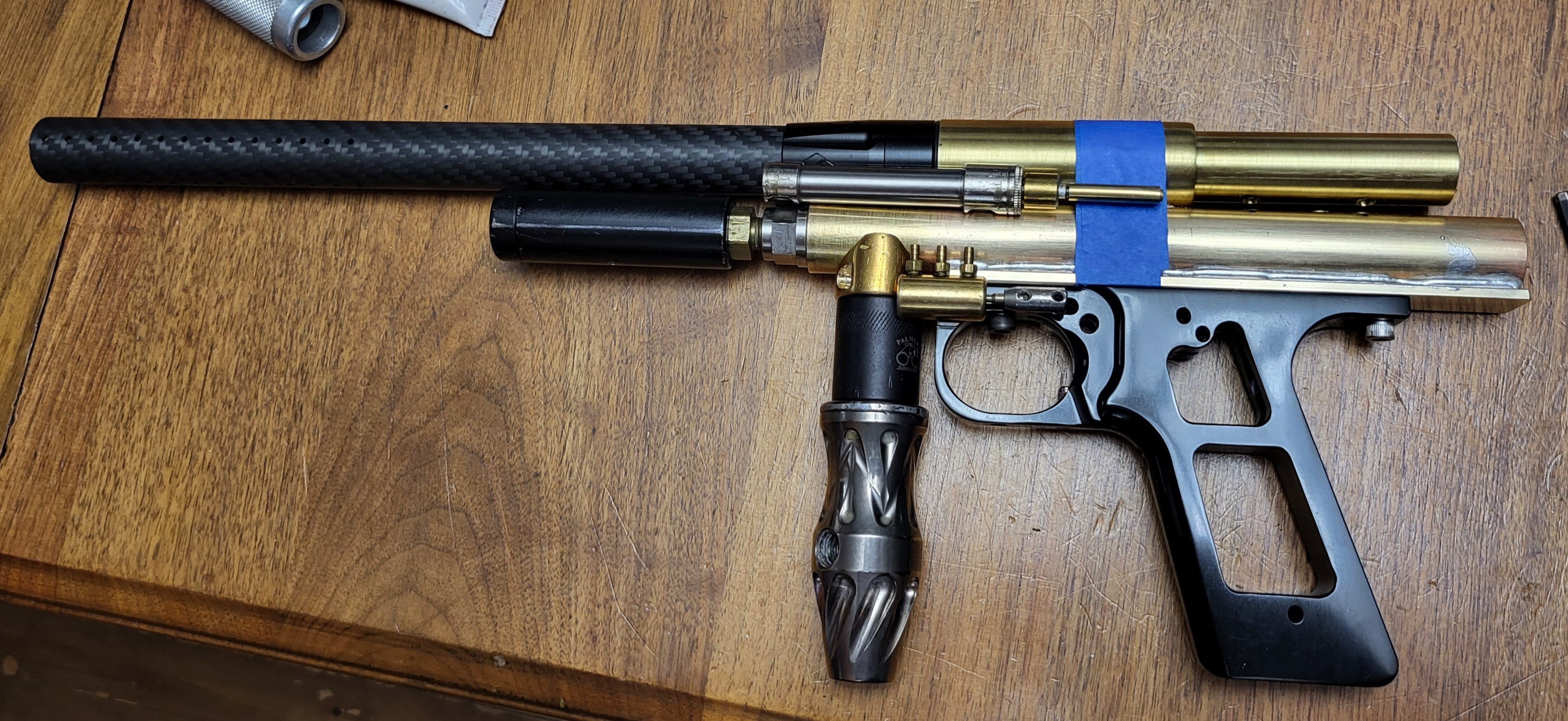

          Got the top tube soldered on along with the ram mount and 3way... probably all I'll do for a bit, it's gonna be a scorcher this week.

                Timing rod and pump arm done, feedneck soldered on... only thing left is a detent and then final assembly/testing.
                Bought a bunch of parts to help with finishing it off, hopefully see them in a few weeks.
                I think it's turning out ok so far.

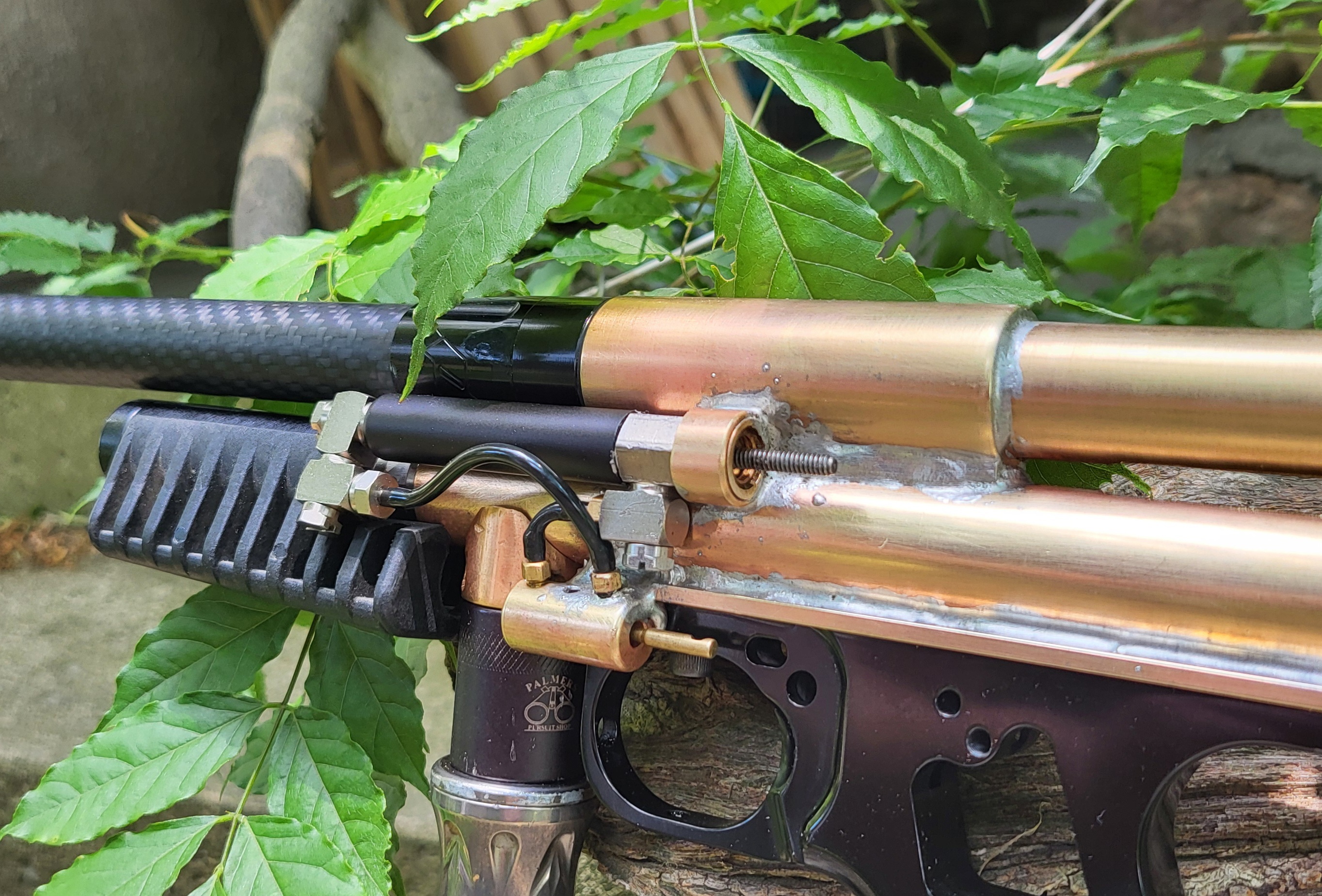

                      I'm waiting for my ID order to arrive still - detent and bolt - and my ACP order, but enough of my other bits and bobs have arrived that I was able to install the internals the other night.
                      Simon's valves do not fit without modification, as a heads up to anyone building something similar. I had to sand the valve's OD down slightly and polish it in order for it to slide into my lower tube easily.
                      But... after waiting the requisite period of time for the Loctite to cure, I aired it up this morning and shot a couple rounds through it. No leaks!
                      I've ordered a couple of elbows to finalize the pneumatics install, and then I can time it and tweak everything else once the rest of my parts arrive.

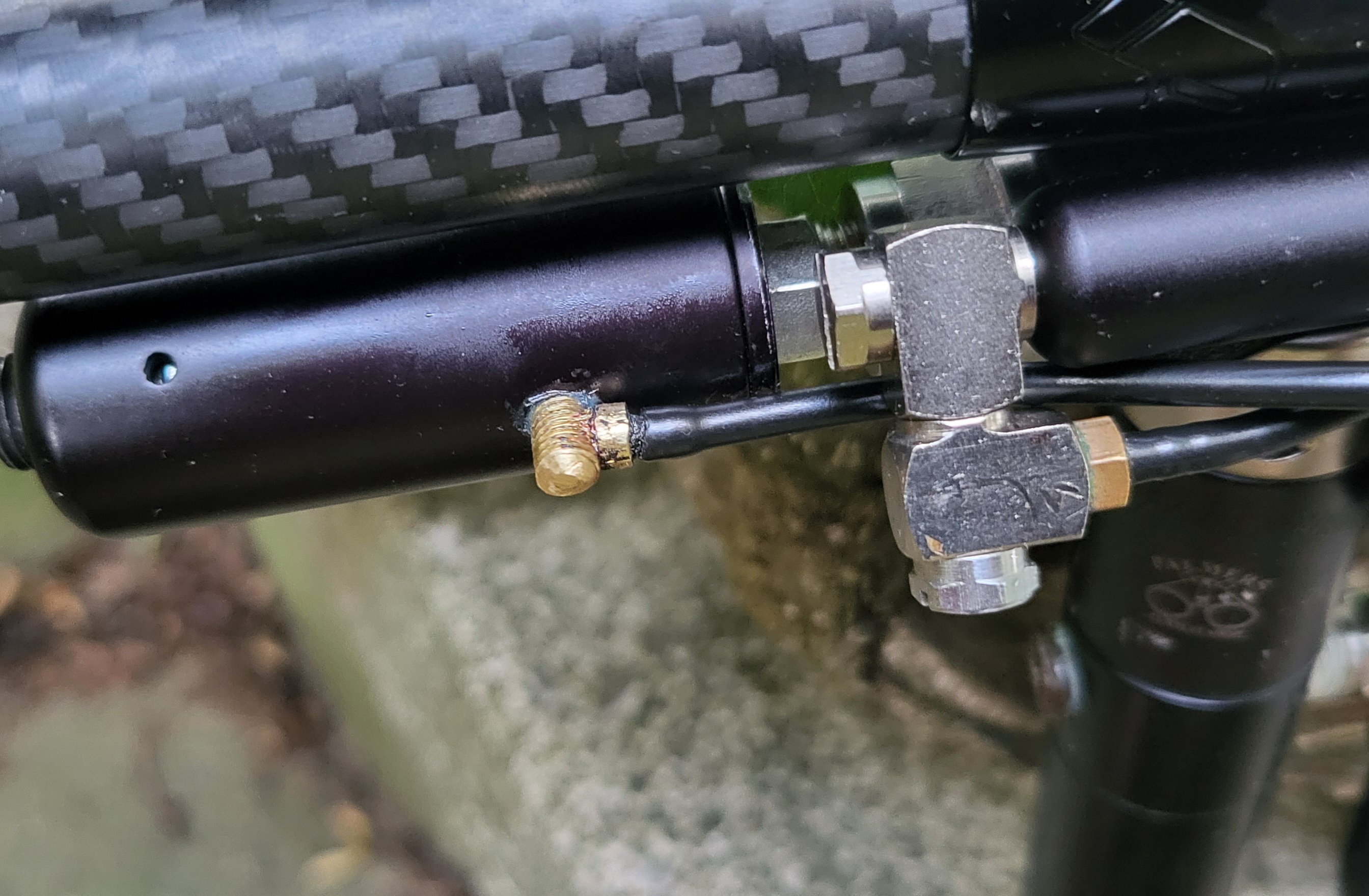

                        I'm impatient and had about 10 minutes this morning so I made a quick and dirty elbow to go in the LPR.
                        The loctite should good by tonight and I'll have a go at timing it.
                        For anyone thinking they can't do stuff like this, I have a Dremel with a broken speed dial and a janky drill press. You don't need any fancy tools to start.
