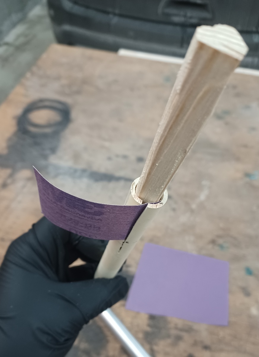

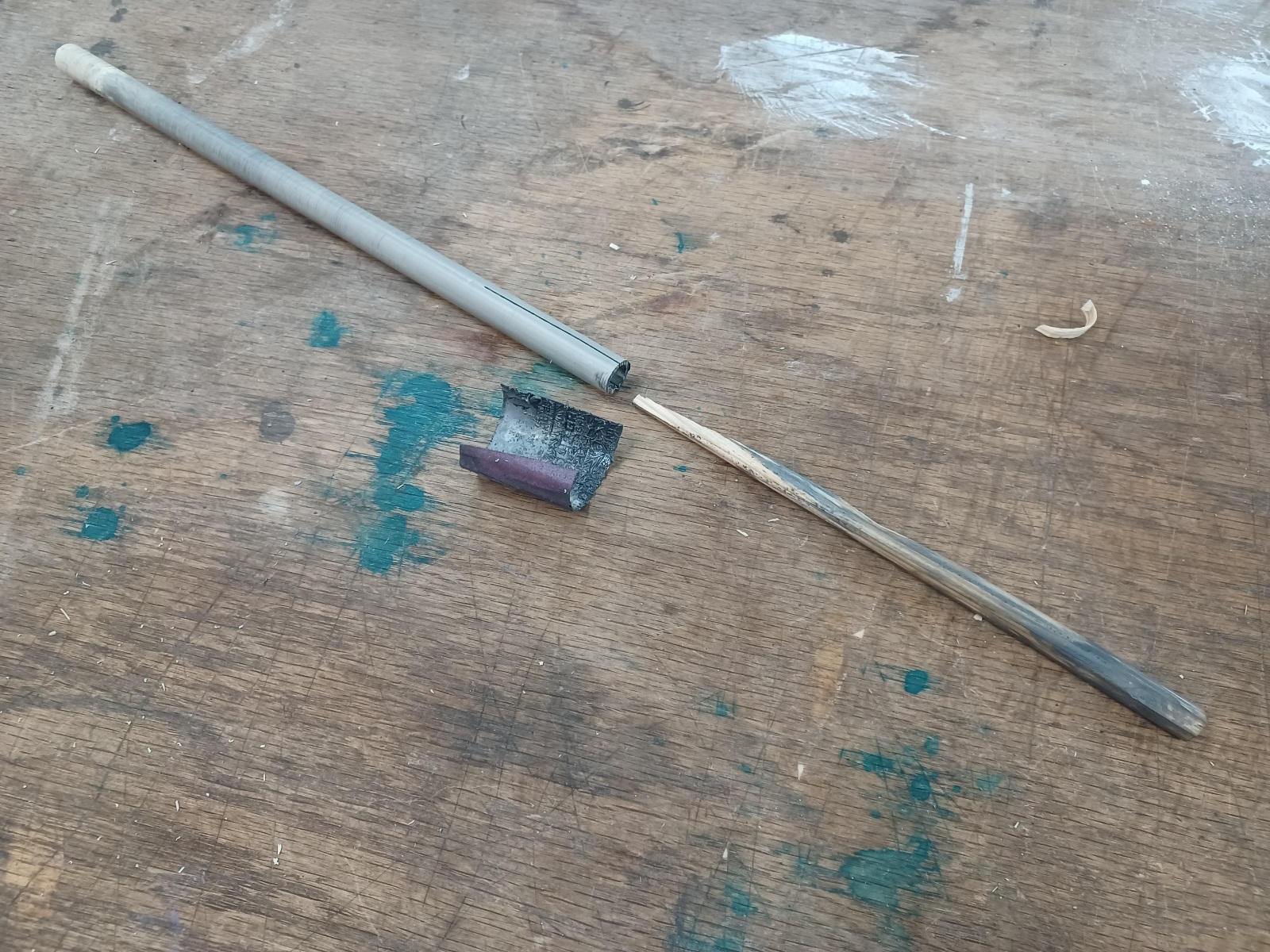

    flyweightnate i tried a flex hone. Makes it shiny without changing the dimesnions much. I made this super cheap "lapping tool" which does a much better job of removing high points
    1/2" cpvc that i hacksawed a split into. Sandpaper. Tapered stick to adjust the size

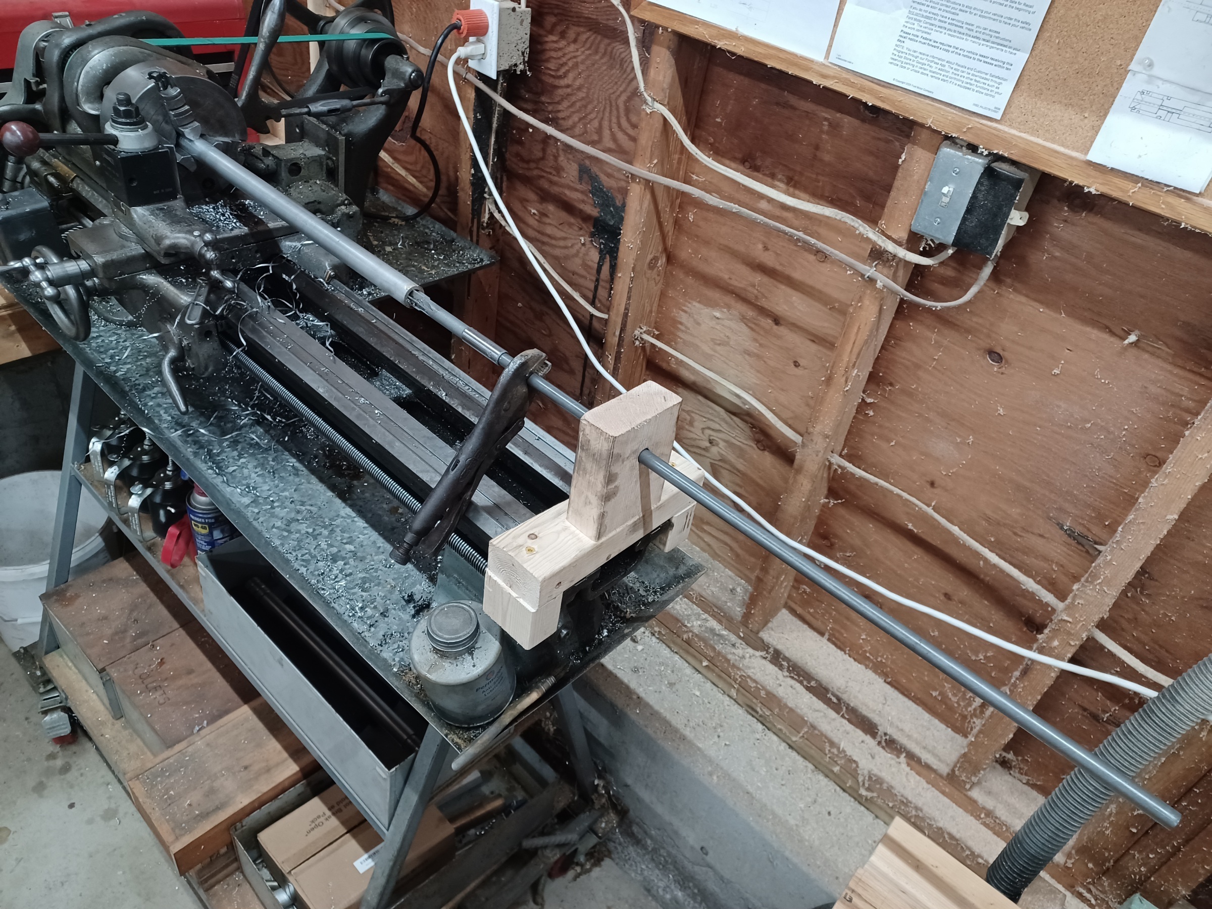

        So i got a batch that had a wayyy smaller ID. Like 0.660. So bought a couple reamers and attached them to long rods. Used a chunk of wood to keep things centered-ish. Seems to be working
