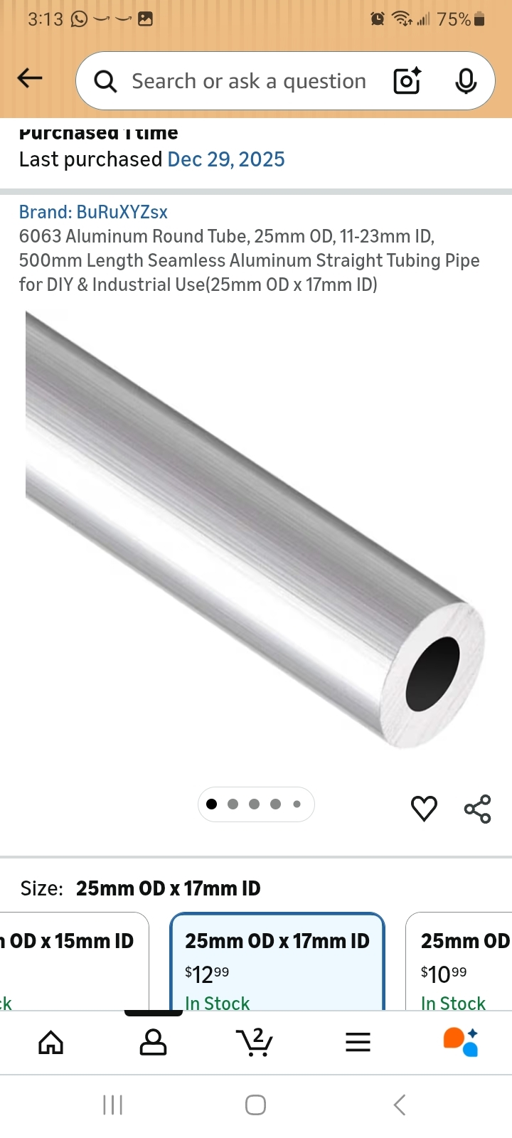

    .673 barrel blanks on amazon

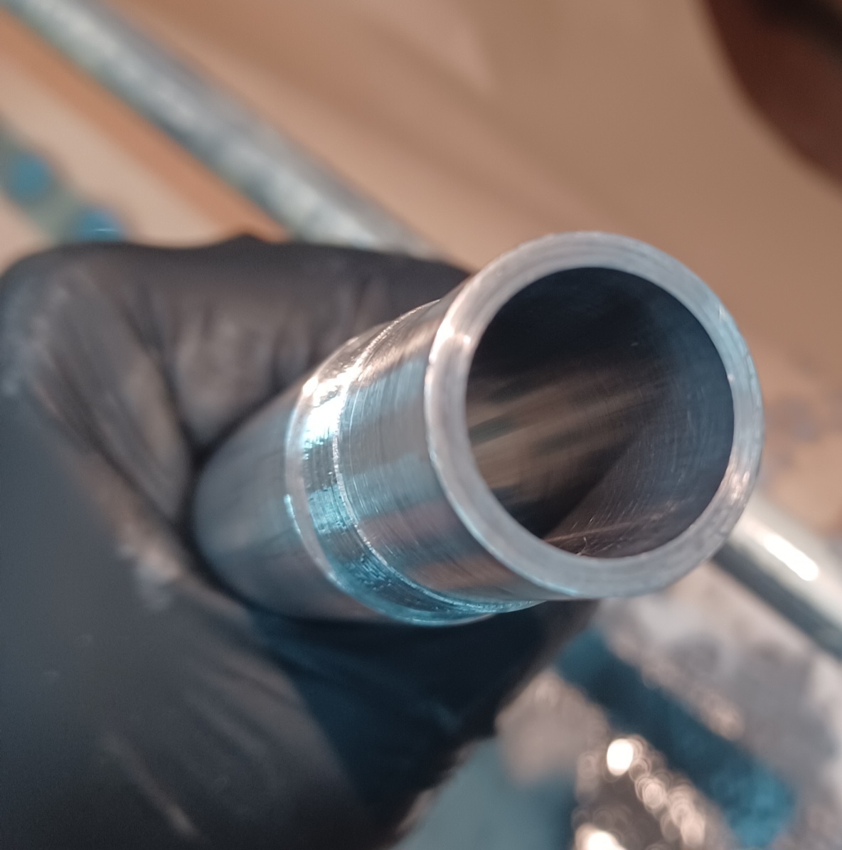

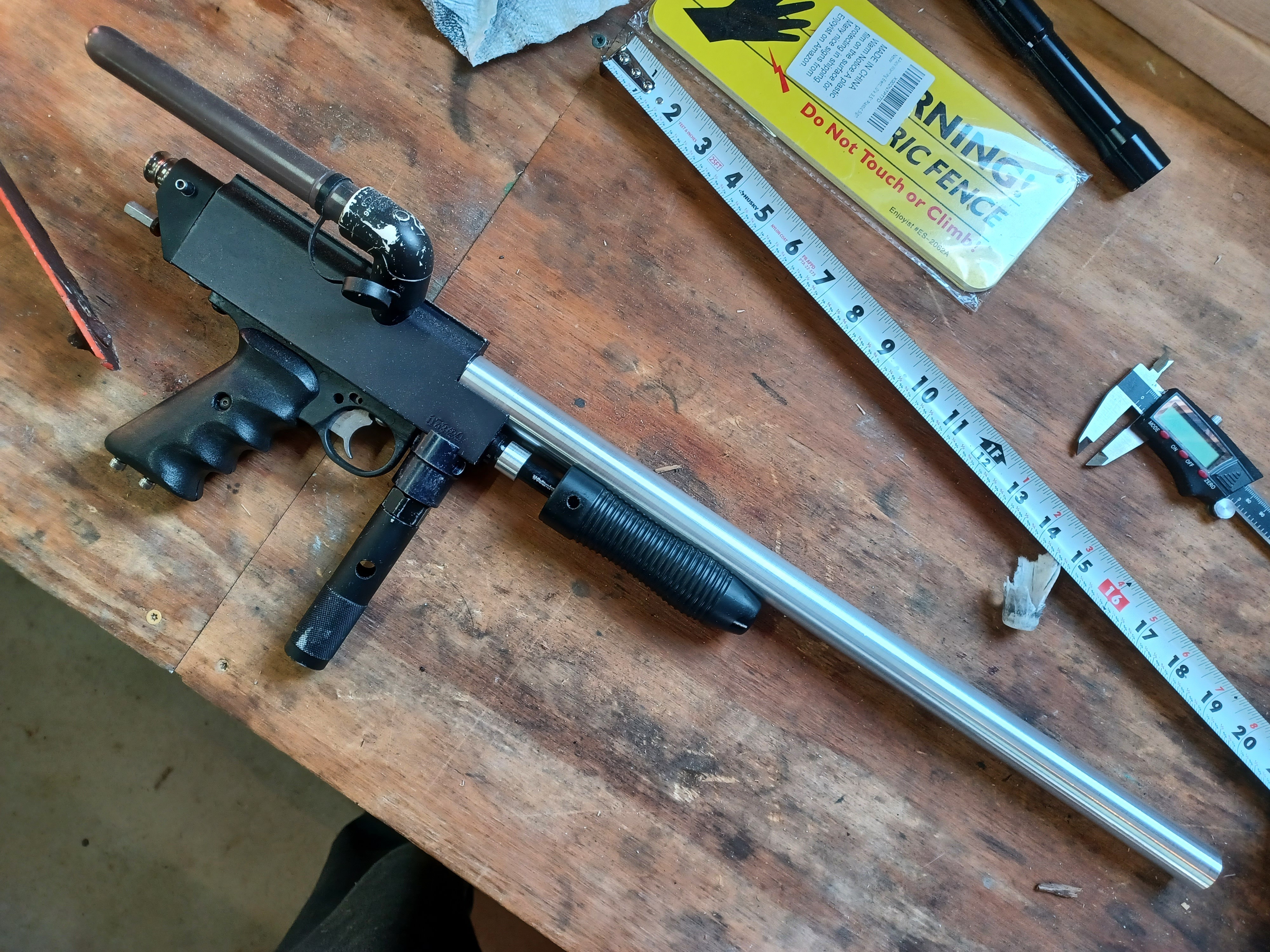

    Picked up some 17mm tube from amazon to see if it would work. It did. Didnt bother honing or anything. Wanted to see how well it shot with minimal work. I didnt do a whole heap of testing by clamping it to a bench or anything but i would say the accuracy is "normal"

                  ASIN is B0F4RLN4HB for anyone else looking for one.

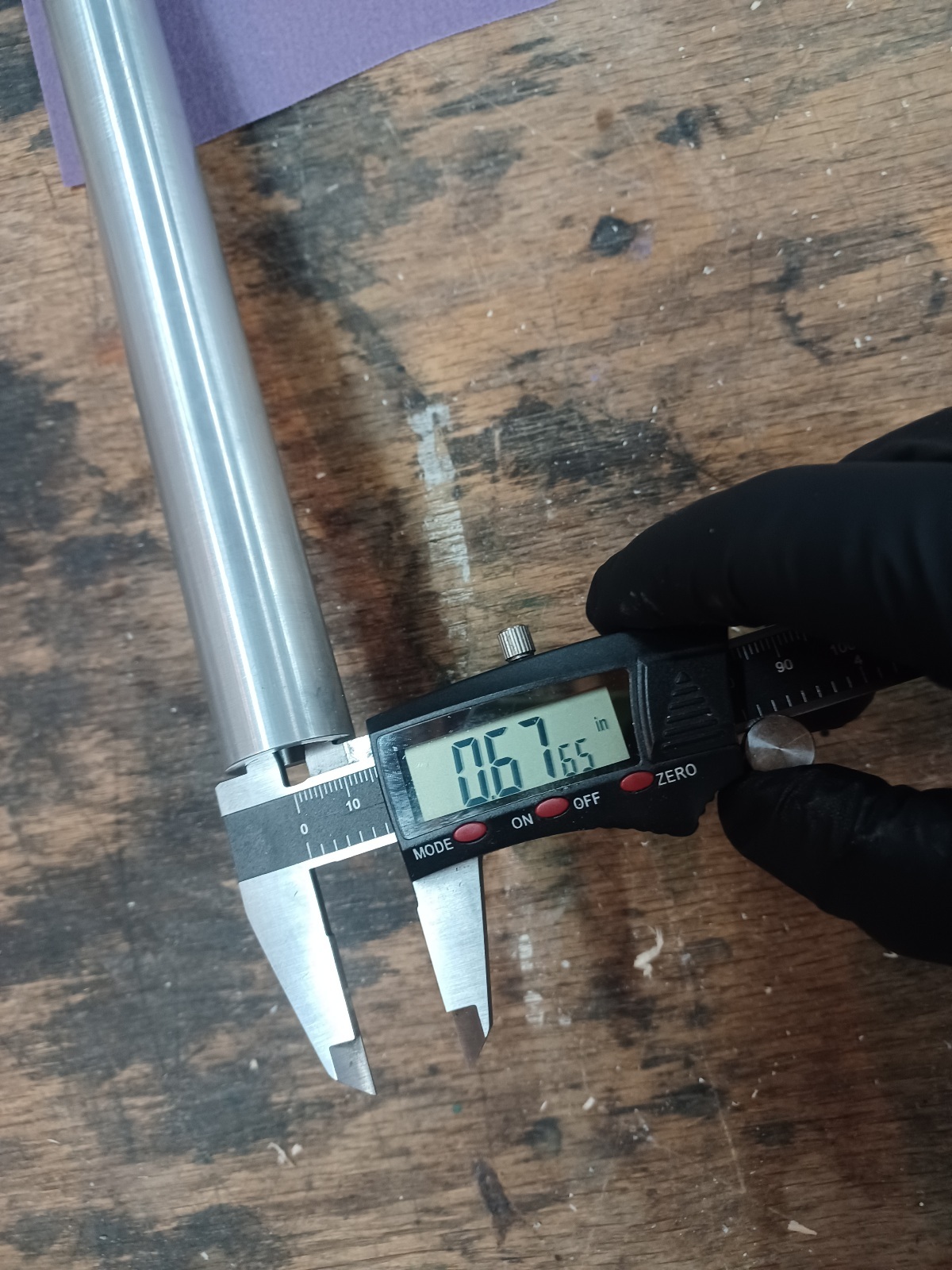

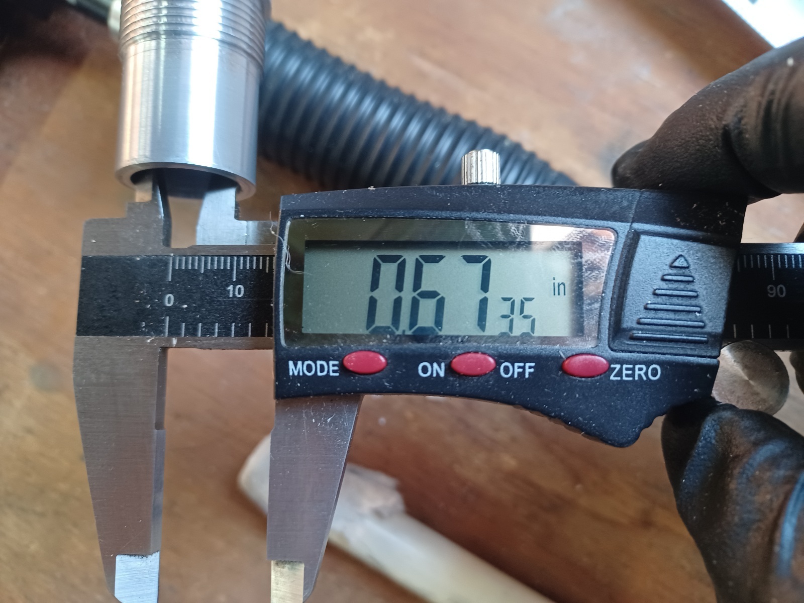

                    If it’s measuring .6735 direct with calipers, it’s probably actually a couple thou larger than that.
                    calipers measure round IDs poorly. you’d want to try some bore mics, telescoping bore gauges, or even just using a pair of pin gauges

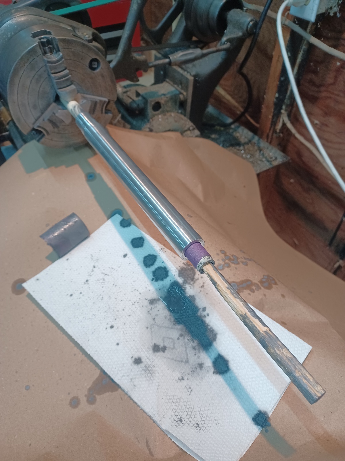

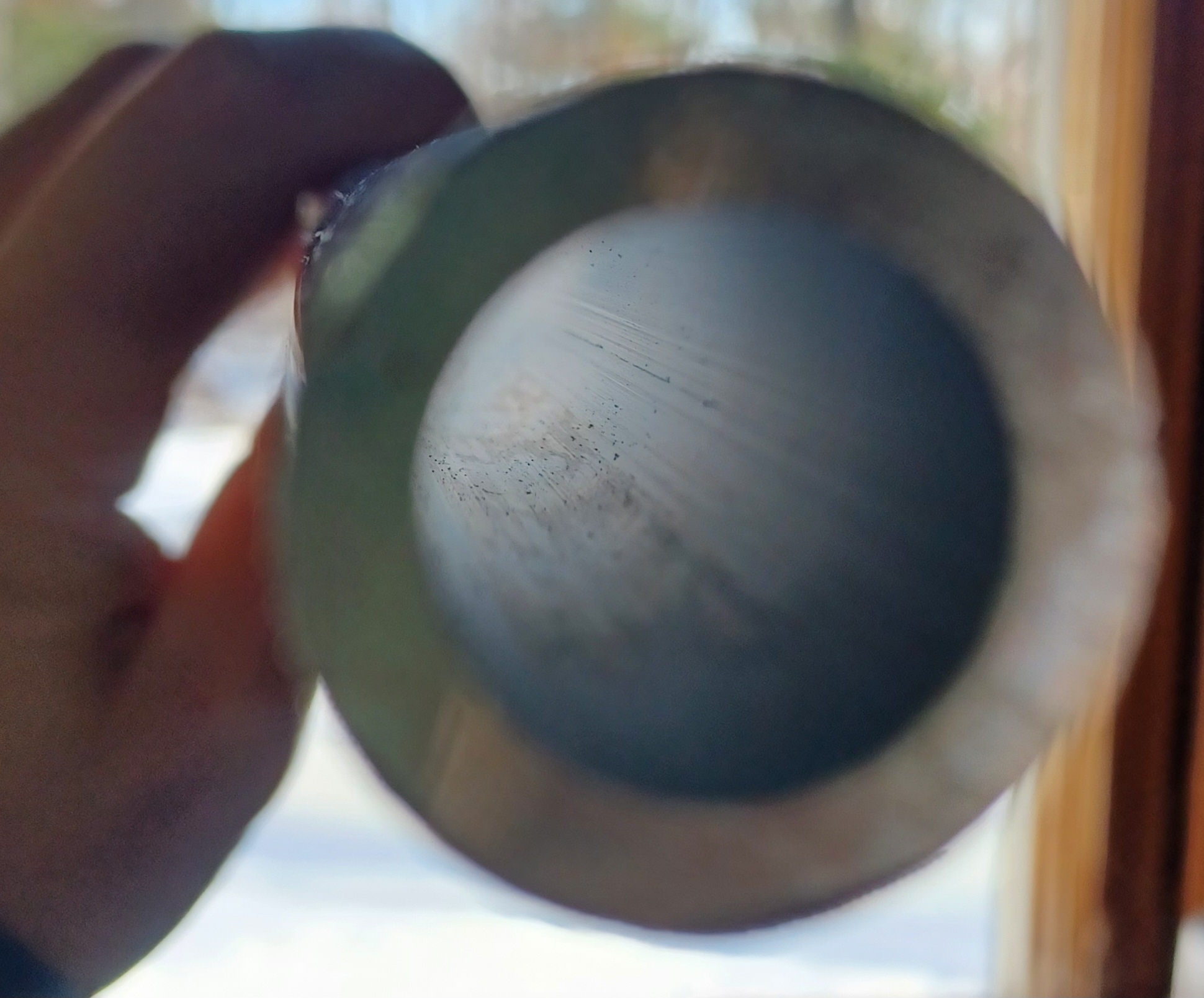

                      Made a cheap lapping tool. A few passes with 220 grit to get rid of the lumps and then straight to 1500 to to give it a slight polish. Bores out to around .677 now
                      no need for a lathe. You could do this with a power drill

                        I'm planning to run an old flex hone down mine when it comes. Only 2 more weeks on the boat until I can try it out...
