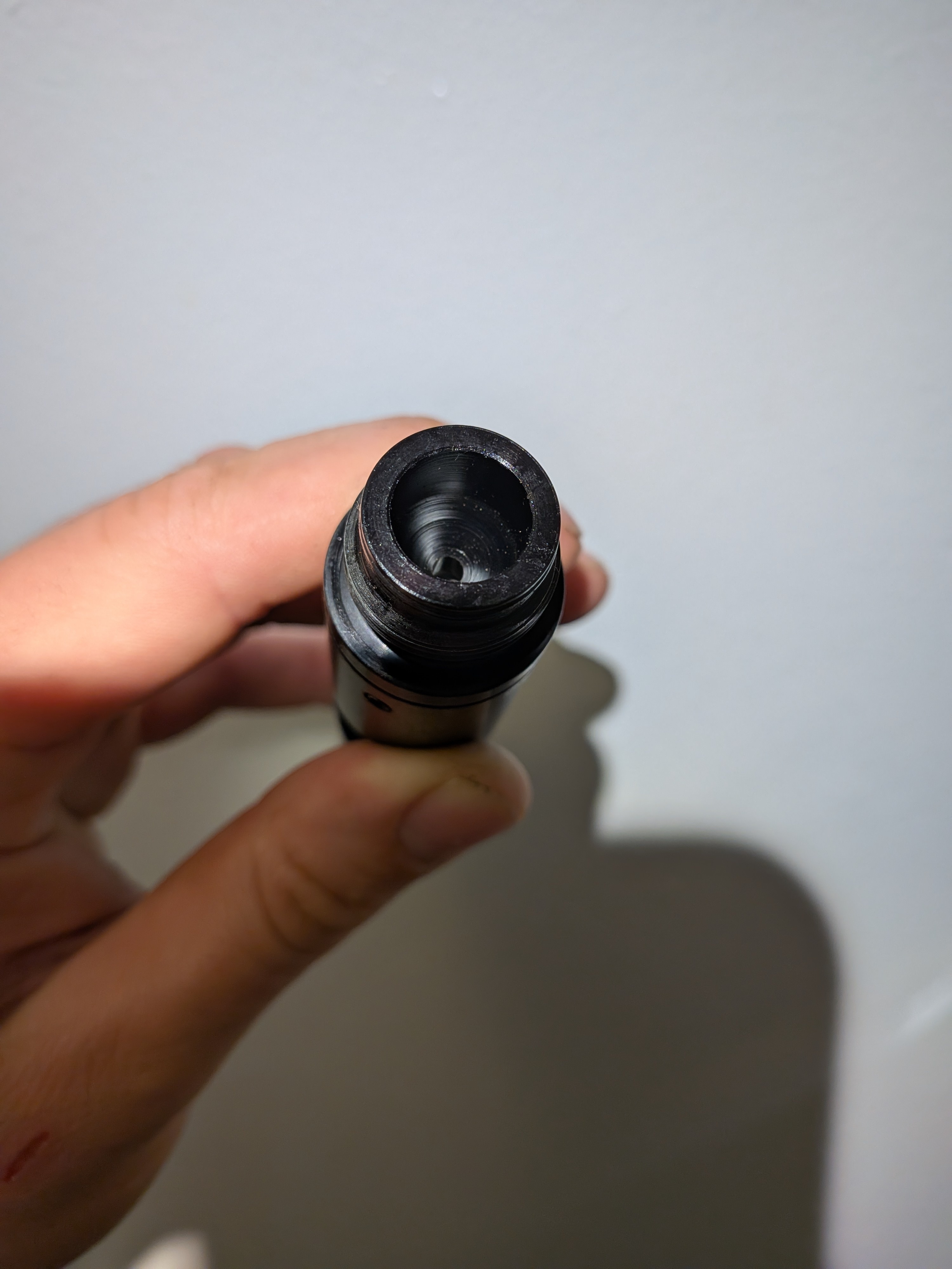

    I'm building an automag classic pistol that runs off of 12 grams and I'm looking for advice. If I used an ICD lever changer in a vertical asa, how could I keep pressure in most of the line during changes to increase efficiency? I was thinking of building a hardline with a check valve but it looks like I'd need to use 1/4" tubing with swagelok fittings and space is limited. The ICD lever changer has a conical recess in the asa portion (pictured poorly) that could seat a ball bearing but I'd worry about the "seat" feeding aluminum bits into the valve and also not sealing. Thanks for any help

          I'll try the Teflon ball route. The disk won't fit in the cone shape seat of the changer. If that doesn't work I'll get a cci bucket changer

                I bet a self centering cone shaped pin that matches the ID of that hole in the ICD. Make it hold like a Phantom Cup seal for the sealing surface and hold a spring on the back side.
                Drop it in screw it in against the ASA should do it. Might even get away with a bunna oring as a sealing surface if you can keep in centered with a good design. Not sure how well Printed products hold up to the CO2 pressure/ abuse,

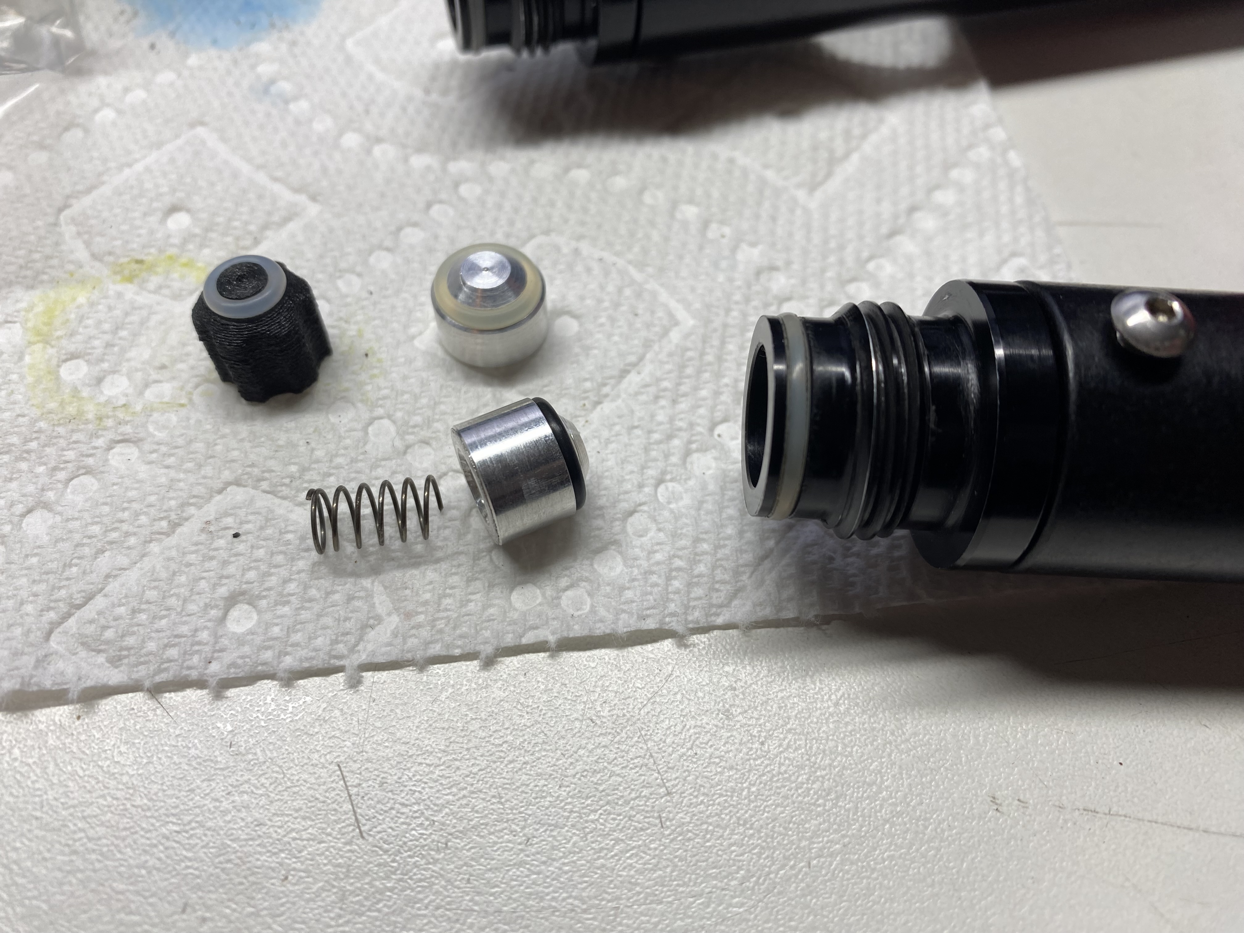

                  Could you just double up o-rings? The outer diameter o-ring centering the smaller, thicker inner o-ring as the BB sealing ring.
                  I just used a 005 o-ring, a 0.177 bb, and a spring to seal a CCI 12 gram changer from the hyperlink above. I didn’t have a tapered surface to deal with though.
