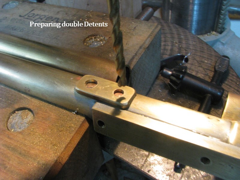

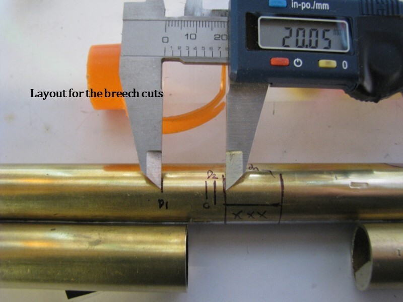

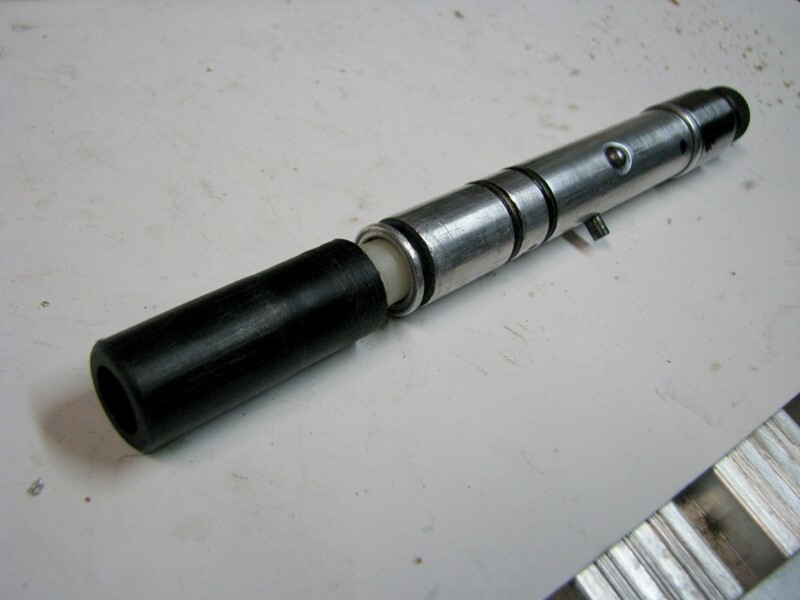

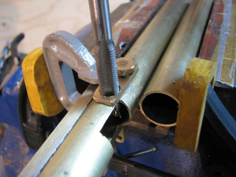

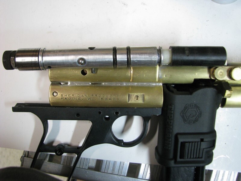

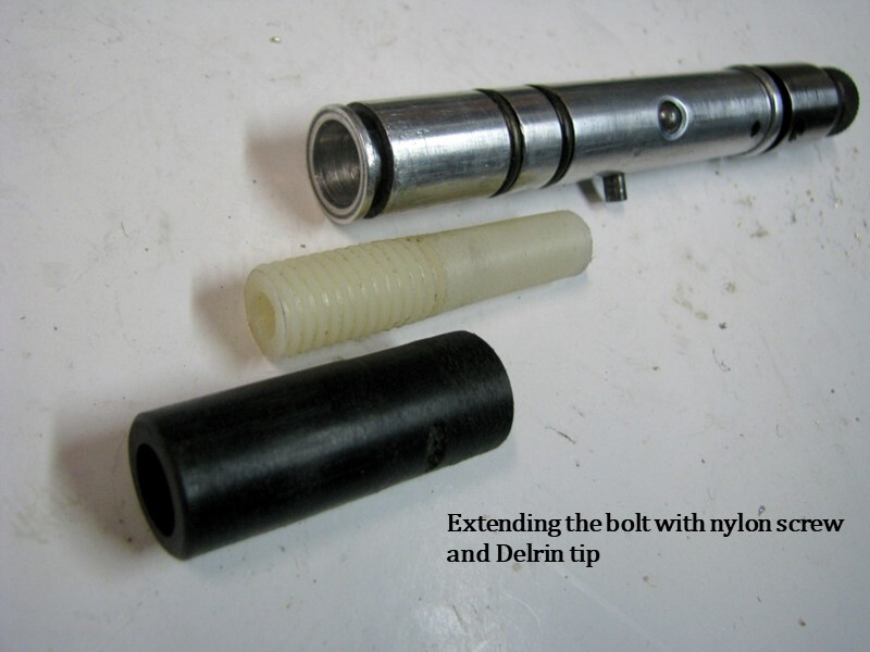

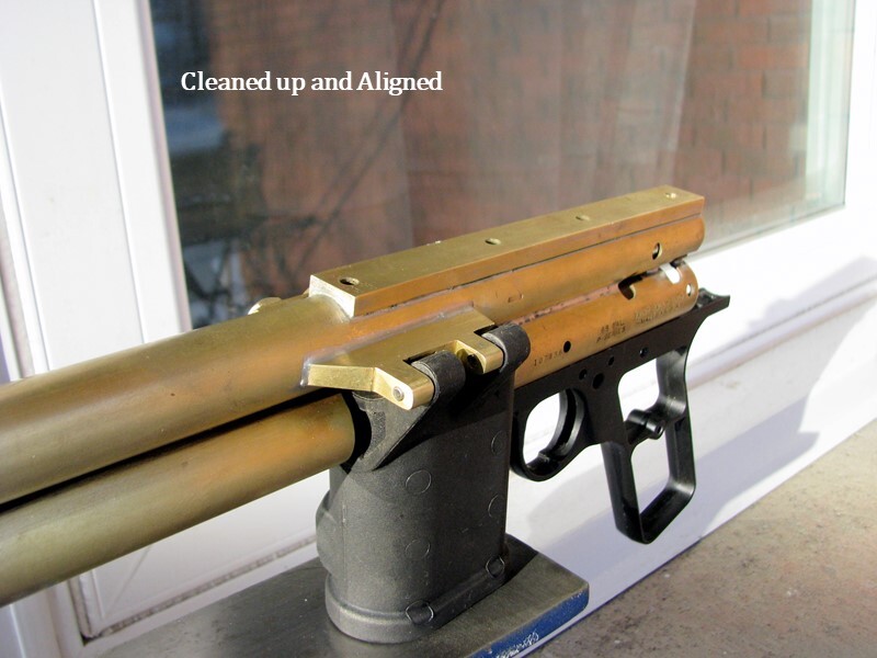

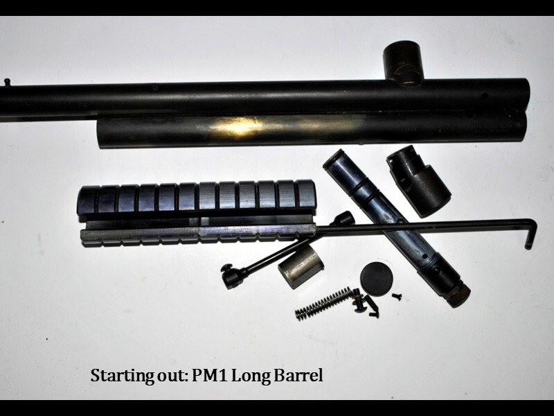

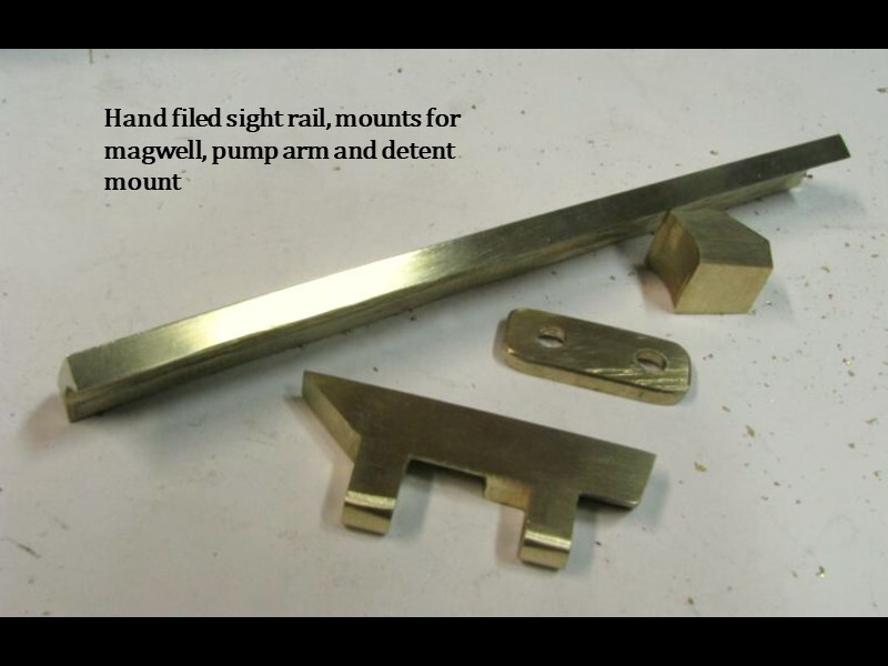

    So this project had been collecting dust on my bench for the past 6 years. I wasn't able to get it wrapped up for one of these build-offs. With this COVID lockdown I finally took the time to finish this off. I'm also motivated by the fact that my son will be old enough to play this summer. This should garner some respect with his peers
    Here's some shots I took over the build. I'll ad a video later.
  • badger
    • 79

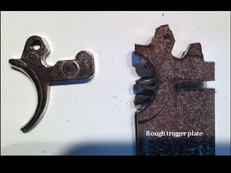

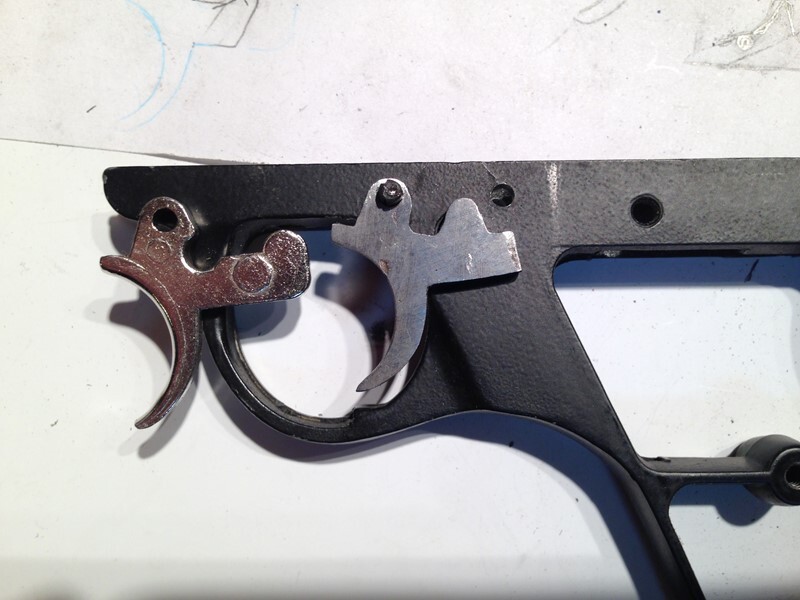

    Build
    Click image for larger version  Name:	Slide7.JPG Views:	0 Size:	76.2 KB ID:	82055 Click image for larger version  Name:	Slide6.JPG Views:	0 Size:	69.1 KB ID:	82054
    Click image for larger version  Name:	Slide8.JPG Views:	0 Size:	54.2 KB ID:	82056 Click image for larger version  Name:	Slide9.JPG Views:	0 Size:	58.1 KB ID:	82057

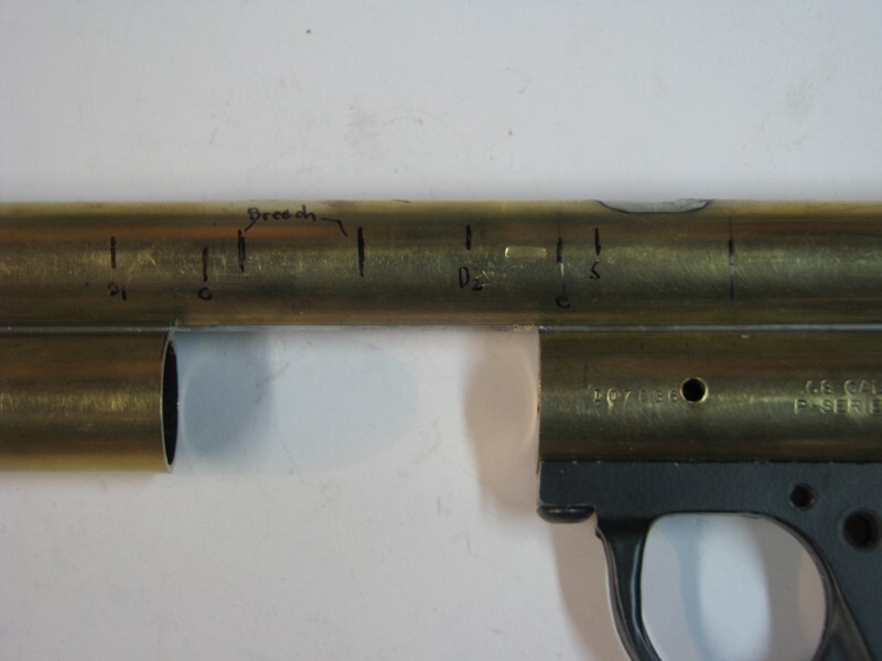

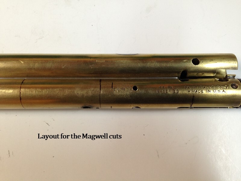

    • badger
      • 79
ID:	82063 Click image for larger version
ID:	82064 Click image for larger version
ID:	82065 Click image for larger version

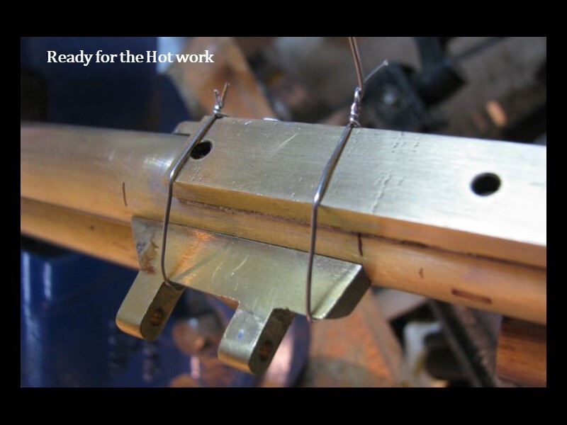

      • badger
        • 79

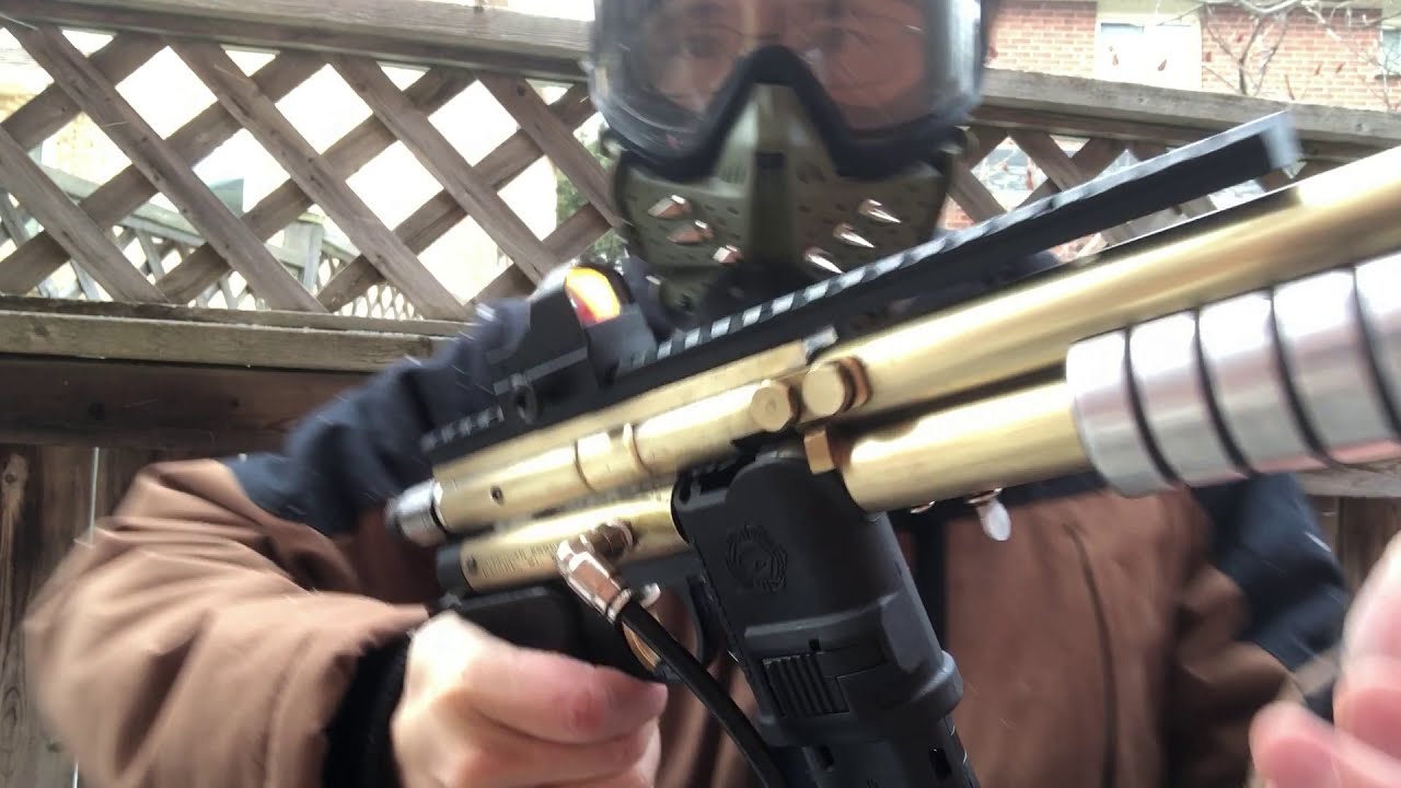

                  Awesome build! In your test video, the first mag of FSR appears to have the rounds not loaded correctly. That may have been the cause of the misfeed. I'm glad it seems to have good velocity! Most (not all) Sheridans I've worked with struggle to shoot above 260, and extending the bolt would make it worse.
                  New Feedback
                  • badger
                    • 79
                    Thanks. Didn't even notice. It's the first time trying FSRs.
                    The RVA is not far in so the velocity can go up.
                    I also did quite a bit of work on the valve and opened all transfer holes.

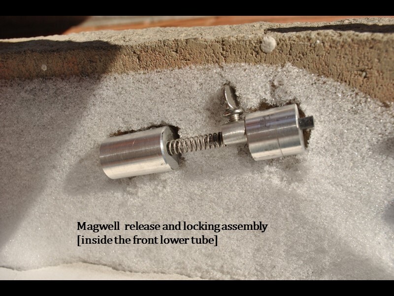

                      How secure is the frame? Seems like it might be a bit sketchy, but I'm guessing you have another screw inside the frame where the RVA normally goes?

                        Yes there is a SS screw inside the frame. Solid.

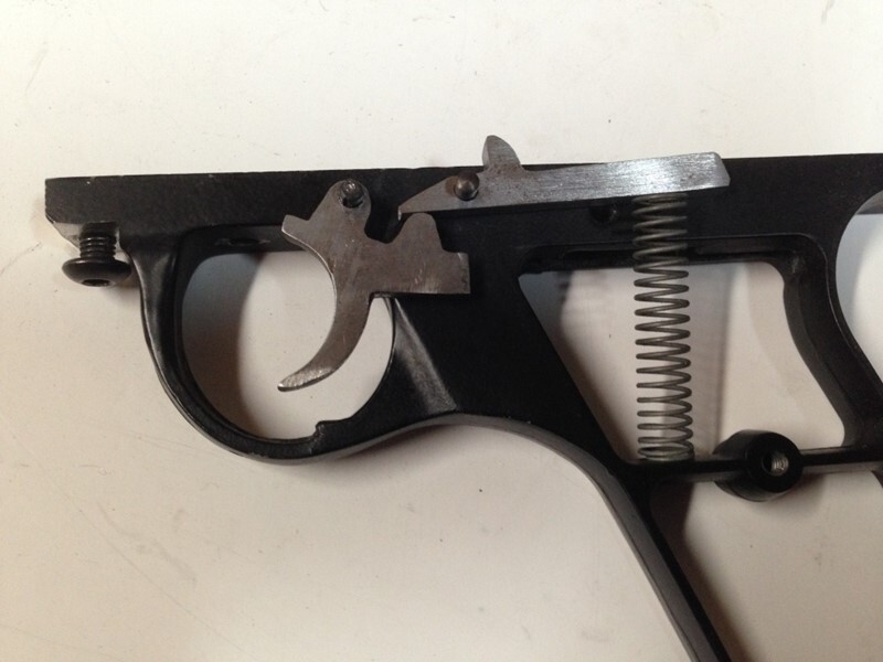

                        I haven't hardened the trigger plates yet. Do you think it's necessary?
                            Hardening the sear might be a good idea, if only because Sheridan hammers are rock hard... might wear the sear out with some serious use.
