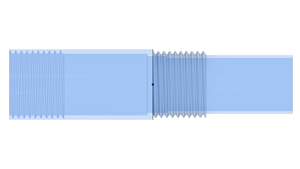

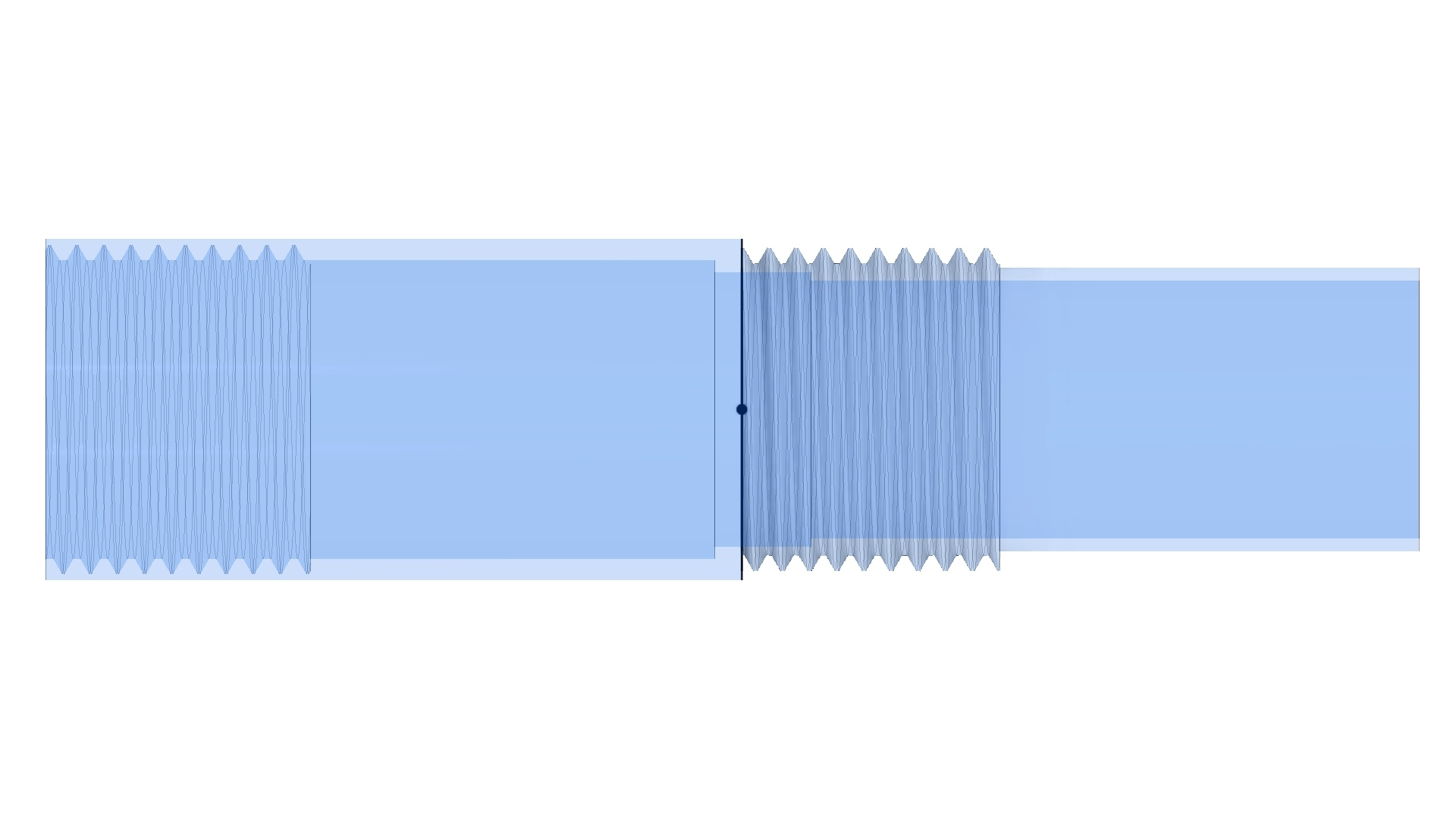

      Alrighty then. After a quick massage 'chat' with flyweightnate we've figured it's not really feasible to make an old Angel thread (M24x2mm BTW) iFit back. There's simply not enough material to make it work because of the OD of both the insert and the barrel. Here's a quick mock-up I did in Fusion360:
      If I push the Angel barrel right down to the iFit insert then it would cut into the threads, which I'd extended all the way up in the hope that it'd add strength where it got a bit thin. This made me think of adding a spacer between the insert and the barrel but it's still a bit too thin. This leaves only one viable 'answer' so to speak. That's the 'Angel to Angel' Freak back, a freak back with M24x2mm for both external and internal threads. I was initially against adding too much length to my barrel setup but funnily, after measuring my Angel Freak back with my Hammerhead aligned to match the AA Freak Front, I'd only be adding an extra 1.5" to the Freak barrel setup I was using. Seeing that, I'm actually not sure why I was so against that idea in the first place. 🤣
