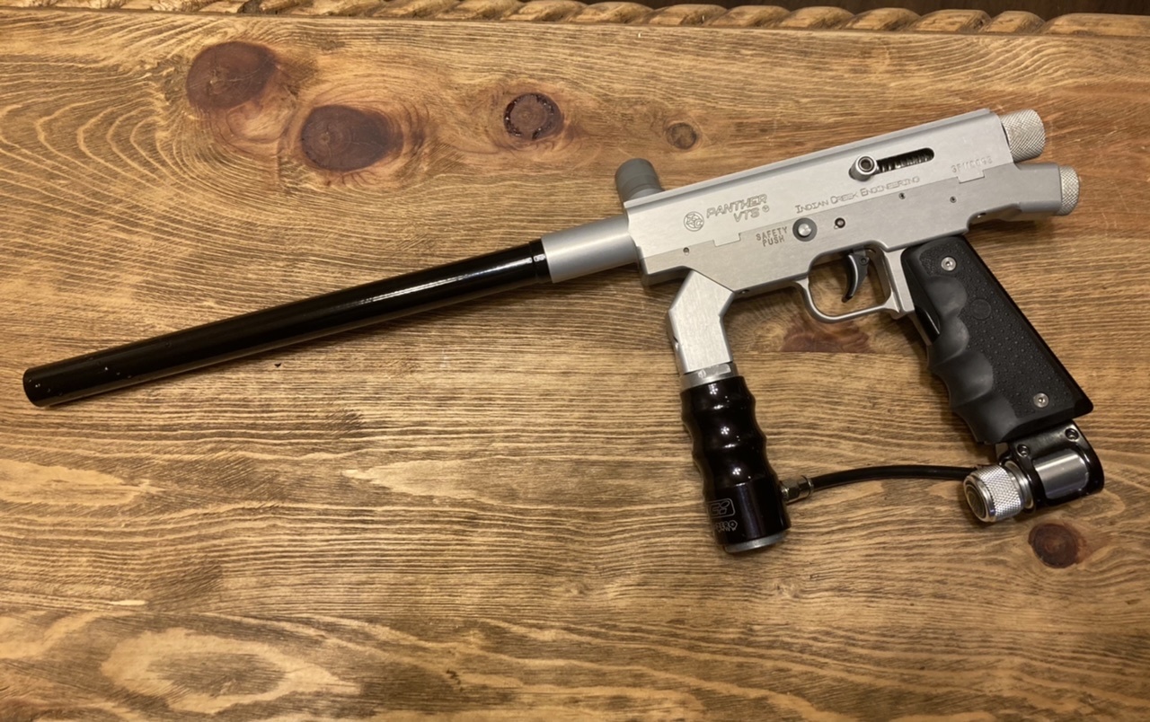

      I think that frame would look great on that gun. Here is my Panther with a phantom grip frame which needed just a slight bit of work to fit right. I really like the way it looks and feels compared to the stock grip.

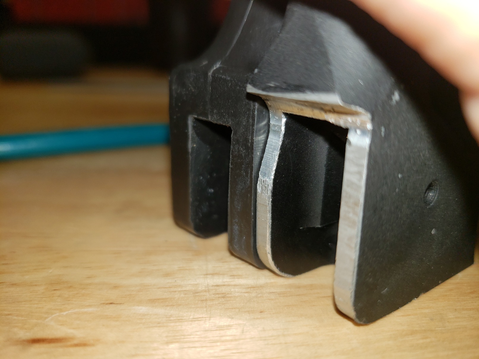

          Well? I took a stab at it. Used the band saw, belt sander, and the manual mill to get it.
          I had to use the mill to do the bottom RAD and I screwed it up on one side. Got into the corner thebn turned the wrong axis the wrong direction, so it has a some ugly undercut.
          Other side looks good. I think itll work all in all, but thatgap will likely piss me off. Powder coat has a few scratches from me flipping it around. On the saw.
          Ill post more pics tonight when I can upload em to wifi.

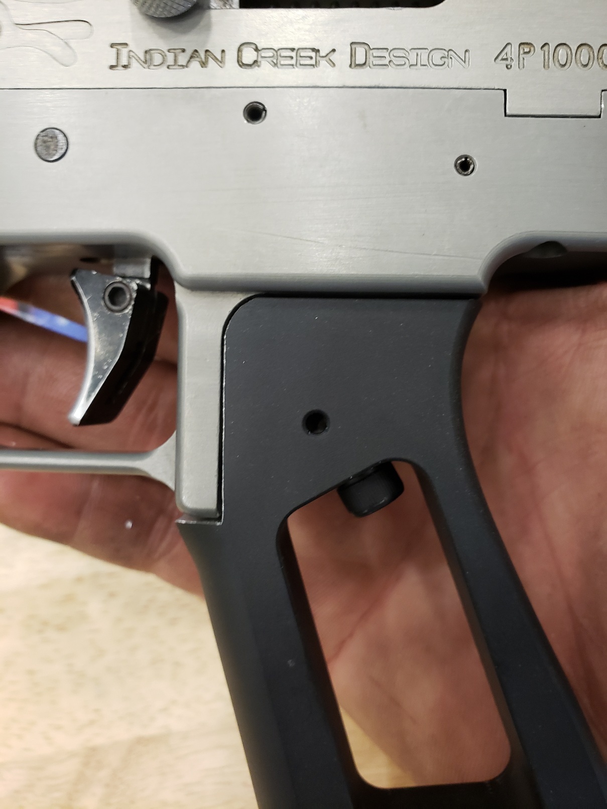

            Update!!!!!
            So I got home last night to notice I had a few measurements off. That being said, I had more material to work with, and my boo boo was fixable!
            So today, I brought my puma with to work, and took measurements again, made up a clamp to hold the frame square, then basically took a 7/32 end mill to depth, and cleaned the while face off.
            After some sanding, filing, and a small relief inside of the frame, it fits!
            I overshot a bit on my measurements leaving a gap. But its solid, and my geometry looks good.
