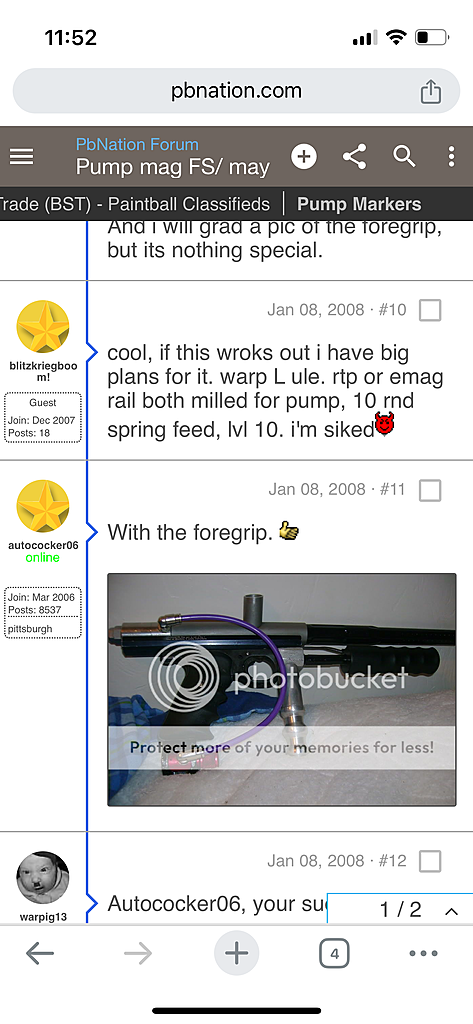

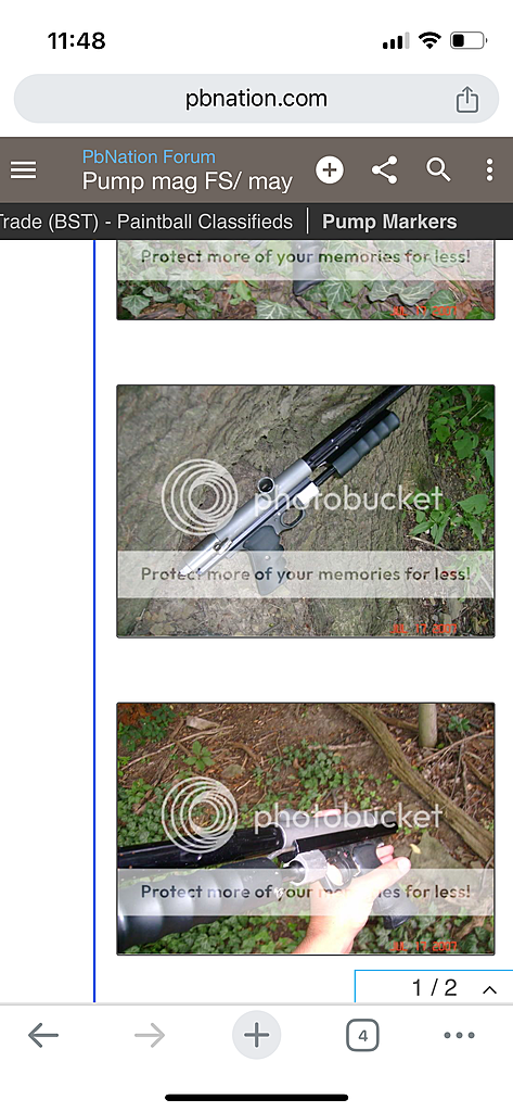

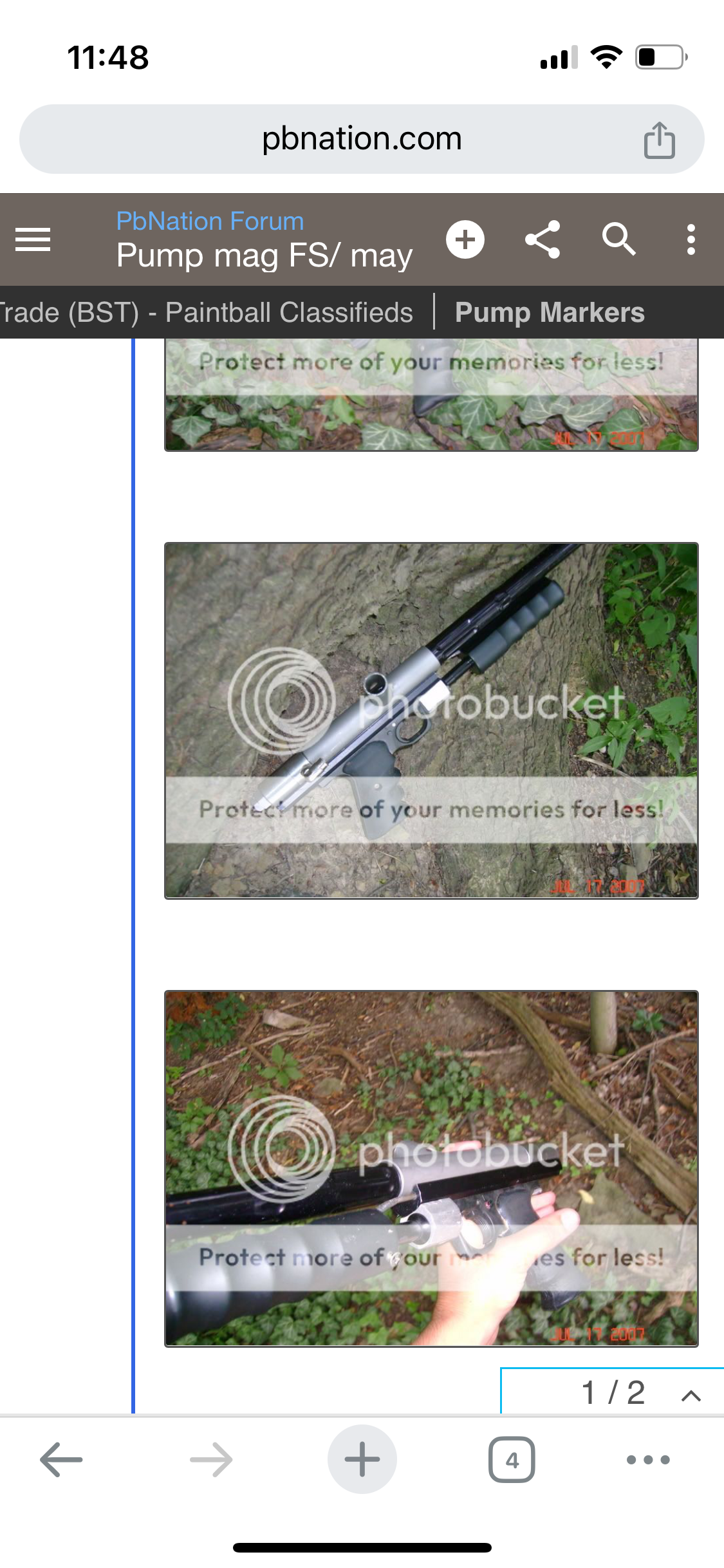

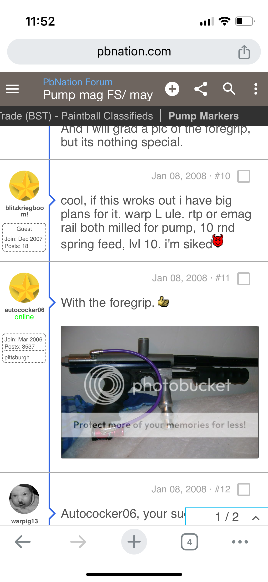

    I dug through PBN for so long looking for this monstrosity I built in high school. Fortunately I wasn’t able to find the shooting video I had at one time, that probably means no one else can either. Easiest route to an open bolt pump, the only thing hard to get was the wave spring. Basically a wgp pump kit with a piece of sanded and bent threaded rod, held to the gun with a chunk of aluminum from metal shop. The body and tail were already pump milled
    Feedback!

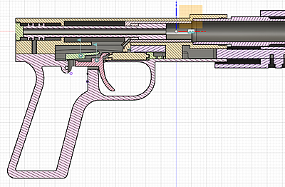

            Sneak peek (I haven't decided on the feedbeck at all)
            The detent is going to be from below like an A5.
            The PRP had a good pump handle.
            And if you're curious, the A/T is currently done with a cylinder cam, after wasting hours with a gearbox... lol

              #24
              Coming along nicely, my friend! Super interested to see the inner workings!
              excellent design. Good planning. Keep up the good work.
              For the feed, i would consider making it adaptable between open/stock class

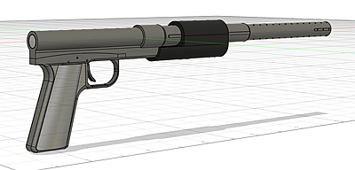

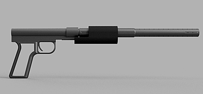

                Progress report, some of the parts ended up quite small/high tolerance. This is my first major project with CAD so wish me luck!

                  #27
                  Good job! I wish i knew how to use cad. Would be so handy for seeing how moving parts interact with each other
                  I can see you still have some work to do. Keep up the good work and keep trying until you have a functioning design
