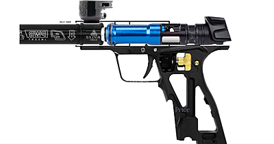

    C.L.U.B. Compact Linear universal breach

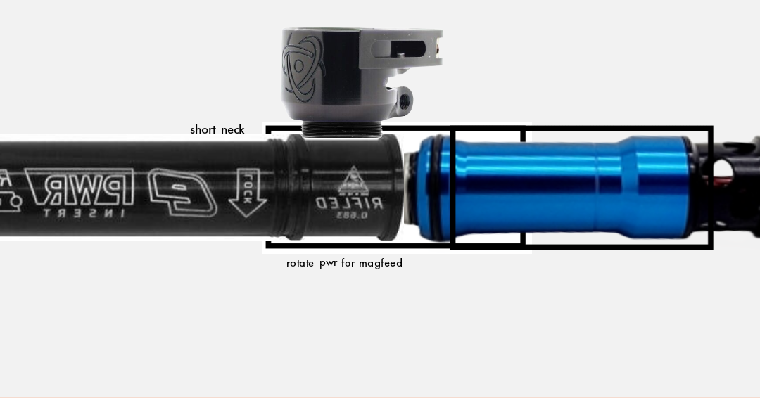

    Compact custom breach design. The pwr and gamma core are tightened together. The pwr insert is slotted and detented.
    advantages:
    -forwarded feedneck position for zeta mags/tenex project
    -Hidden detent
    -dual feed
    -ease of manufacturing

      Automag?
      • Price
        Price commented
        Sure can, might need the help of a sleeve but universal is the goal

      That would shorten the markers length but the issue is you are developing a new barrel system. If you just slotted the PWR then if you do not get the slot in correctly it is now feeding incorrectly. A way to overcome this is to add a tab to the bottom center of the PWR that matches with the marker. The overall issue is you will have 2 sets of PWR barrels 1 for the rest of your markers and 1 that is slotted / tabbed just for this system. If you want something with very little gap between the barrel and the breech then the Angel A1 has a very short thread. Another option would be the older Automag system like Fossilhead mentioned.
      • Price
        Price commented
        Thanks for your input, sure the sleeve can be indexed with a pin or else also the gap from the breach is not a real problem for having it all packed in a simple threaded tube with detents.. works on paper

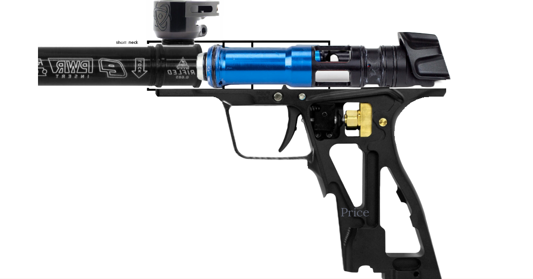

      Not sure how you guys have not caught on to this yet but about every 3 weeks price makes a post like this, basically saying, let's eliminate half of a marker and make it super tiny and compact.
      He makes some Photoshop renderings and then everyone tells him it's not possible for lots of (very legitimate) manufacturing reasons. The one he has above completely eliminated the dump chamber. That's there for a reason, volume. Without it I don't see any way of making velocity. Hell it would be hard enough with a full dump chamber and the like 4" barrel he has there
      3 weeks later he makes another post basically doing the same thing
      If he would go and actually try to make a few of these he would learn a lot more than a dozen posts about theoretical stuff

        Specs needed: 0.000
        -gamma core OD
        -Pwr insert OD
        -xvalve OD
        Lets see if the OD matches, this system reside in a linear tube with no step, threaded for pwr at the front and doweled 3m at the back.
        If you post OD I will make diagrams and tags for future reference

              By all means price, please "create" something. Go make one of these ideas and learn something beyond wishful thinking.
              Start cutting metal, drilling holes and running air lines
              • Fossilhead
                • 320
                • Utah
                Originally posted by Fossilhead
                Automag?
                What I'm saying is... the automag already feeds the ball into a barrel that has a detent.
                If you were to flip it and mag feed it, you've got your gun right there.

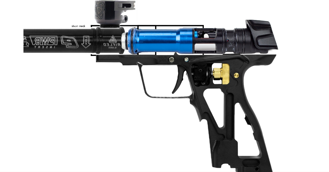

                  added a 180r frame that look to be the best option for custom and fixed the trigger guard a little.
                  and milled
