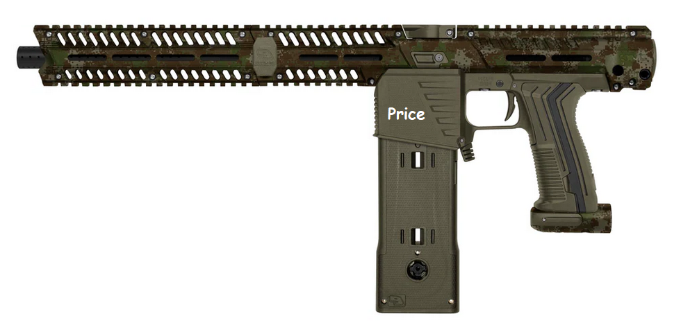

    Still need to sketch in the magazine - and probably some picatinny rail. I took a shot at it. Probably went overborad with the camo though. Just a concept. /s
    For what it's worth, I would absolutely already have one of these if it wasn't for all of the milsim stuff so I support the desire to have a slimmed down version.
      Wow that's some really good rendering! It's amazing that nobody has thought of this idea before. We must be some ignorant dopes!

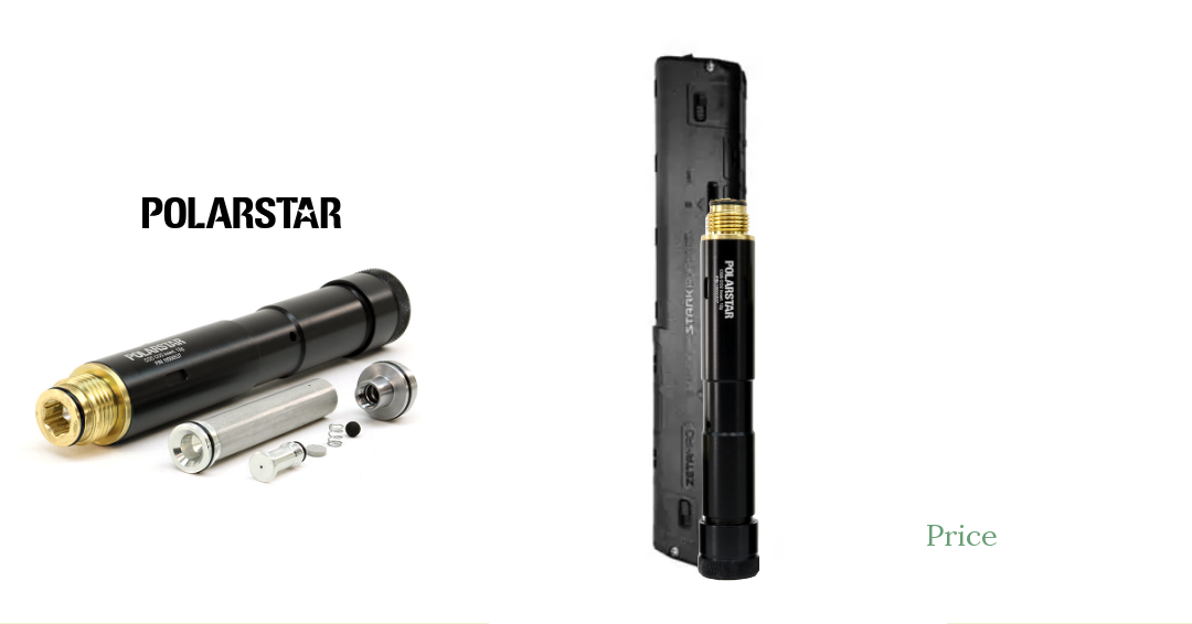

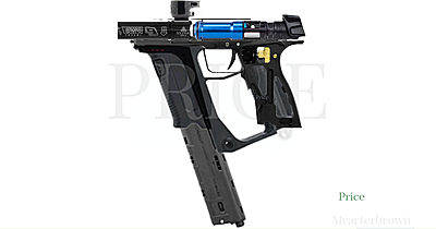

          Superposed on the Tenex. One thing with this configuration is you see the magwell connect to the asa. The Zeta mag being able to store co2 12g could allow air to be also magfilled like an airsoft
          Using a system like this
          from the website
          ....' it is commonly known that you should not use CO2 to power an HPA engine since if liquid CO2 gets down-stream of the regulator it can cause a spike in pressure which is unsafe and can damage the sensitive components of the engine. So how is it that we're making something like this? Our CO2 inserts are specifically designed to allow you to safety run your HPA engine off of CO2. These inserts feature an integral expansion chamber, anti-siphon system, 5 micron filter and check valve to prevent liquid CO2 from entering the regulator regardless of the rifle's or air rig's orientation. As an added benefit, the internal check valve also prevents gases from escaping the expansion chamber ..'

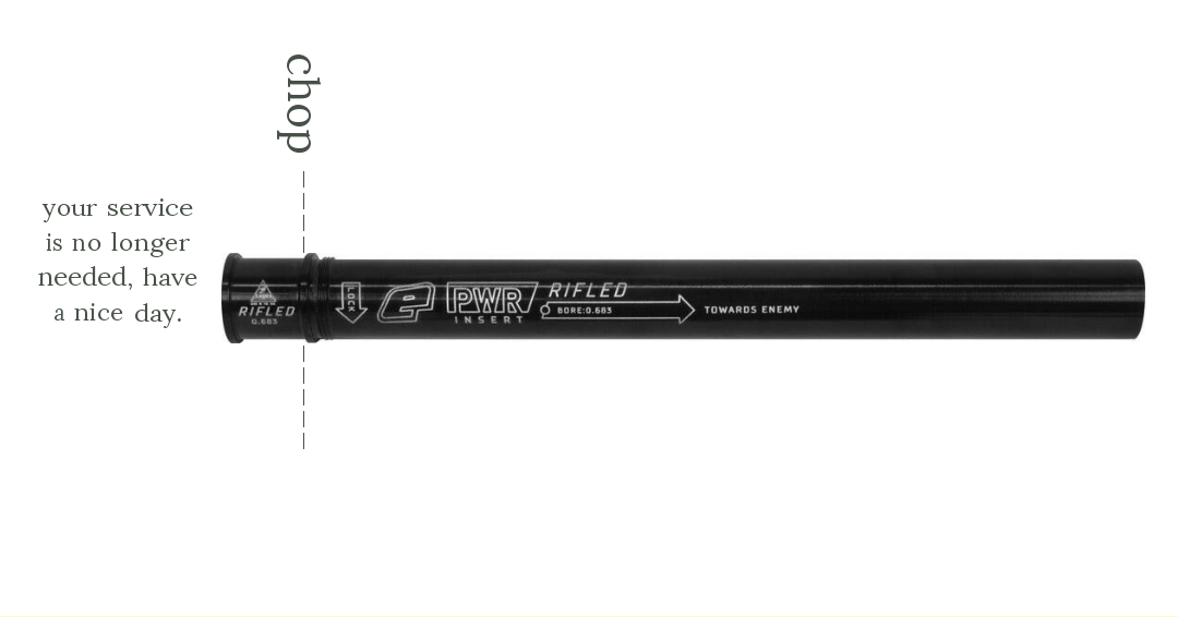

            Price you still haven't answered my question of how this is different than an emek platform or more specifically the emf. You are designing a marker that people can already buy off the shelf.
            So far the only real difference is you basically want to use a barrel kit as the breech, which I'm sorry to tell you, is not going to work out like you probably think it will

                Originally posted by Price
                Sure but not a problem. Fired..
                You missed why I said that barrel kit idea isn't going to work. Yes, you can chop the barrel kit up and screw it into the gamma core(there's a lot of assumptions about that but I'm ignoring those for now) chopping and threading is pretty much child's play around here. But you made 2 new problems that it doesn't look like you have a solution for or didn't realize are problems
                1) changing the breach size with the barrel kit will cause the bolt to have a different amount of friction in the breach. In a worst case scenario, which I think is entirely possible with today's small paint, too much friction and the marker doesn't fire. More likely I think is the change in friction will affect dwell timing and therefore velocity and likely show up as a very inconsistent
                2) paint needs to get into that breach, but since you are screwing the barrel kit into the gamma core I'm assuming you are cutting a hole in the barrel kit to allow passage, you haven't mentioned any way to clock that opening. You could potentially run a set screw through the side but then you are adding the alignment front to back of that hole because you are screwing it on or off the gamma core to make it align rotationally.
                To me, it seems you are actually ignorant of how ignorant you are, which is why you are ignoring everyone who could actually help you. People have raised good points about problems but your only response is word salad motivational poster guy. That's the kind of stuff that got Billy McFarland put in jail for fraud. Ignoring reality when people say there's a problem.
                Again I have to say, please, go try to build, pretty much anything. Put a dye frame on a spyder. Mag feed a 98. The experience will teach you more than any amount of words any of us write
