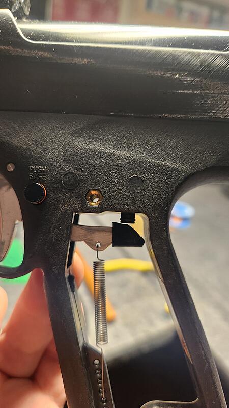

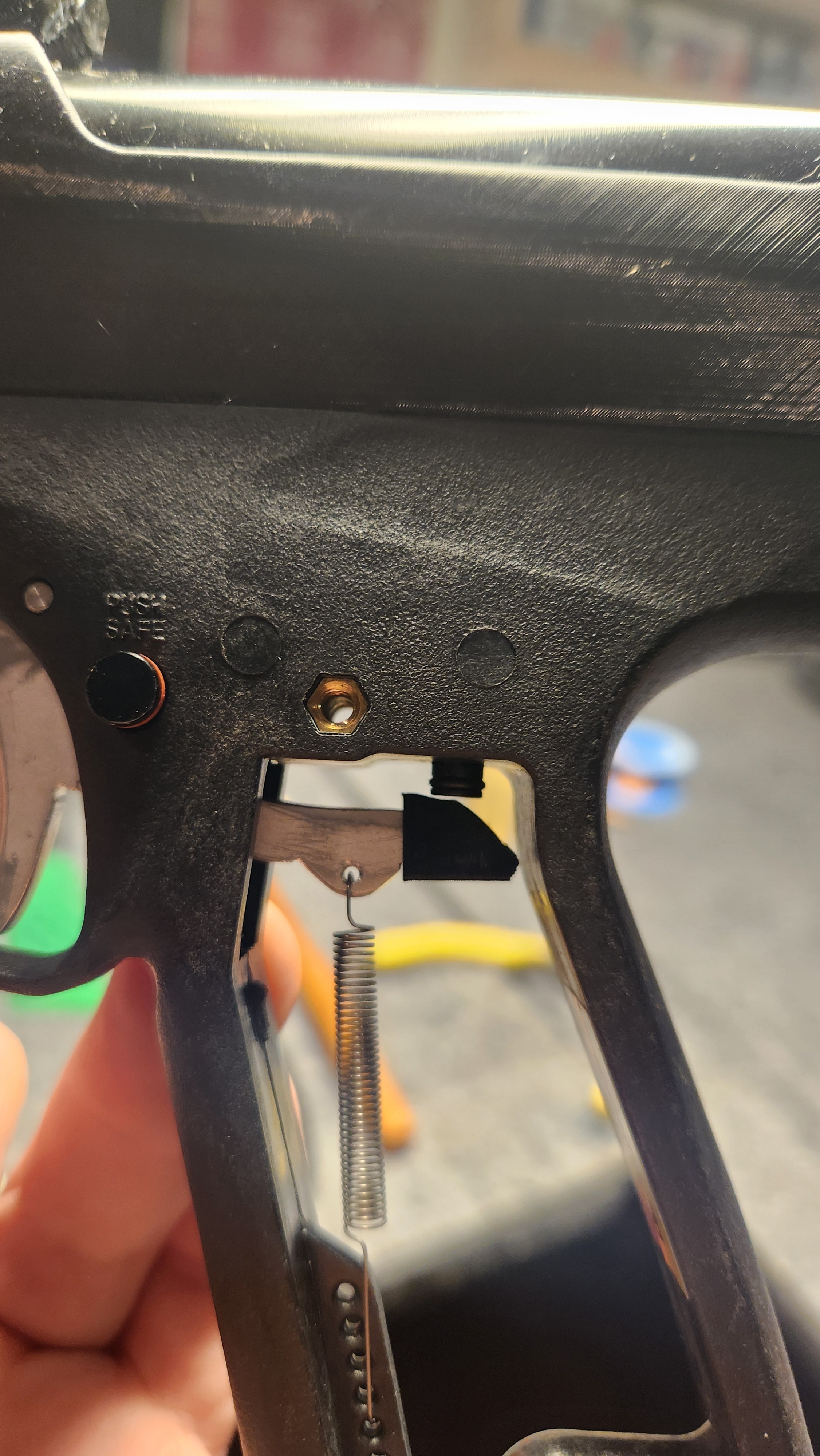

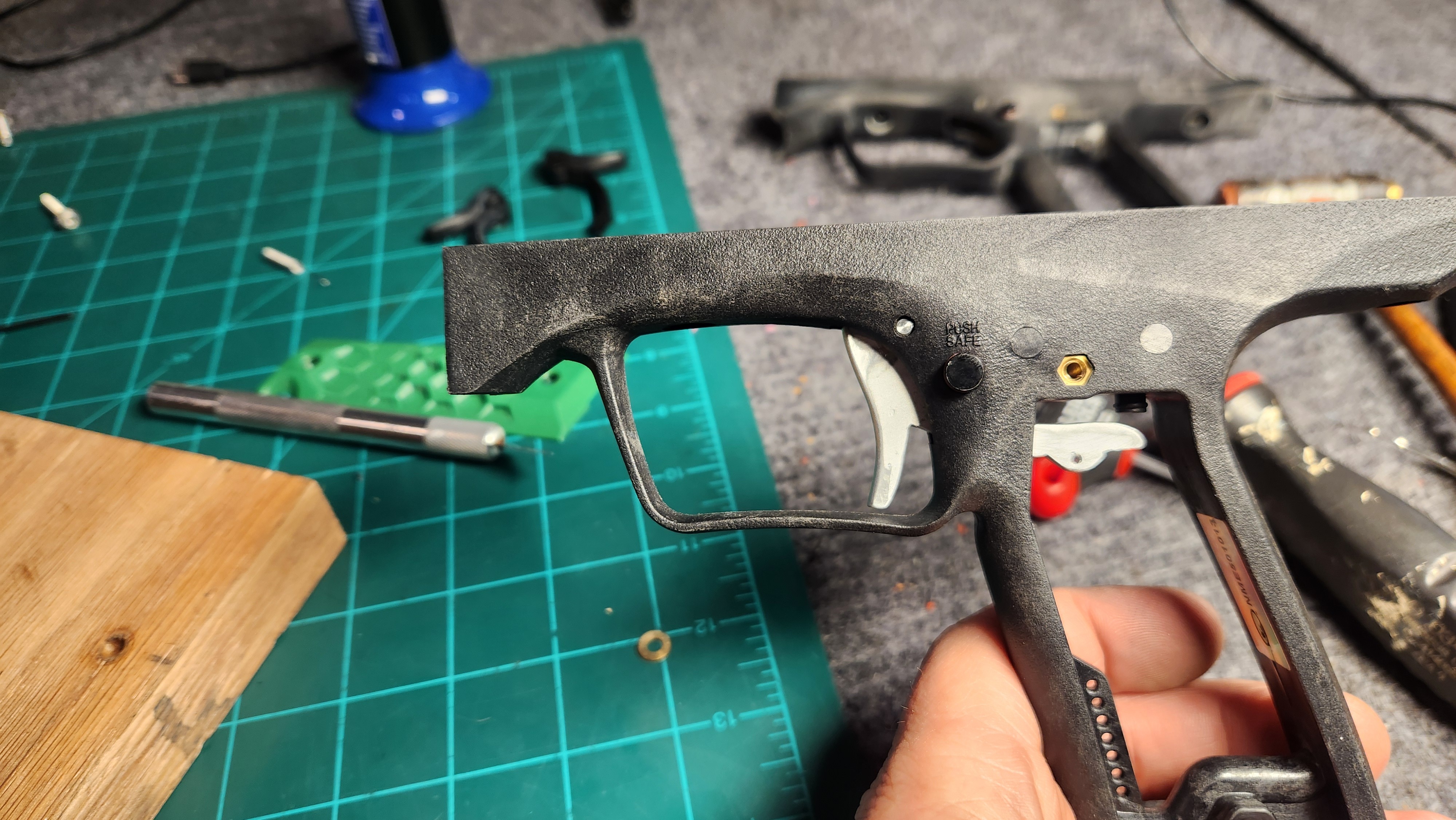

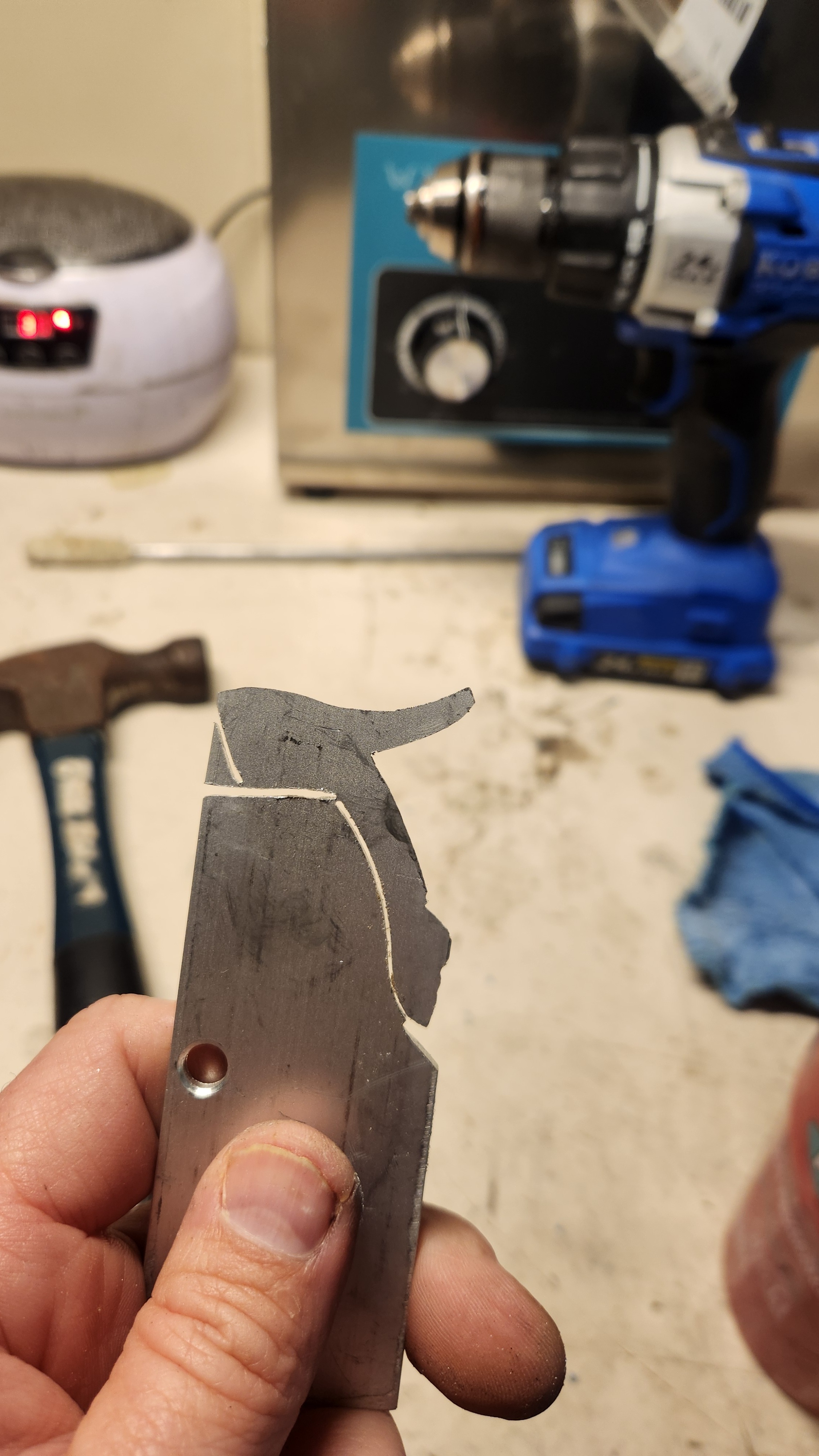

    My ancient bandsaw blade snapped this far from completing the second trigger.
    • Calvin
      Old n' Quick
      • Sep 2025
      • 486
      #32

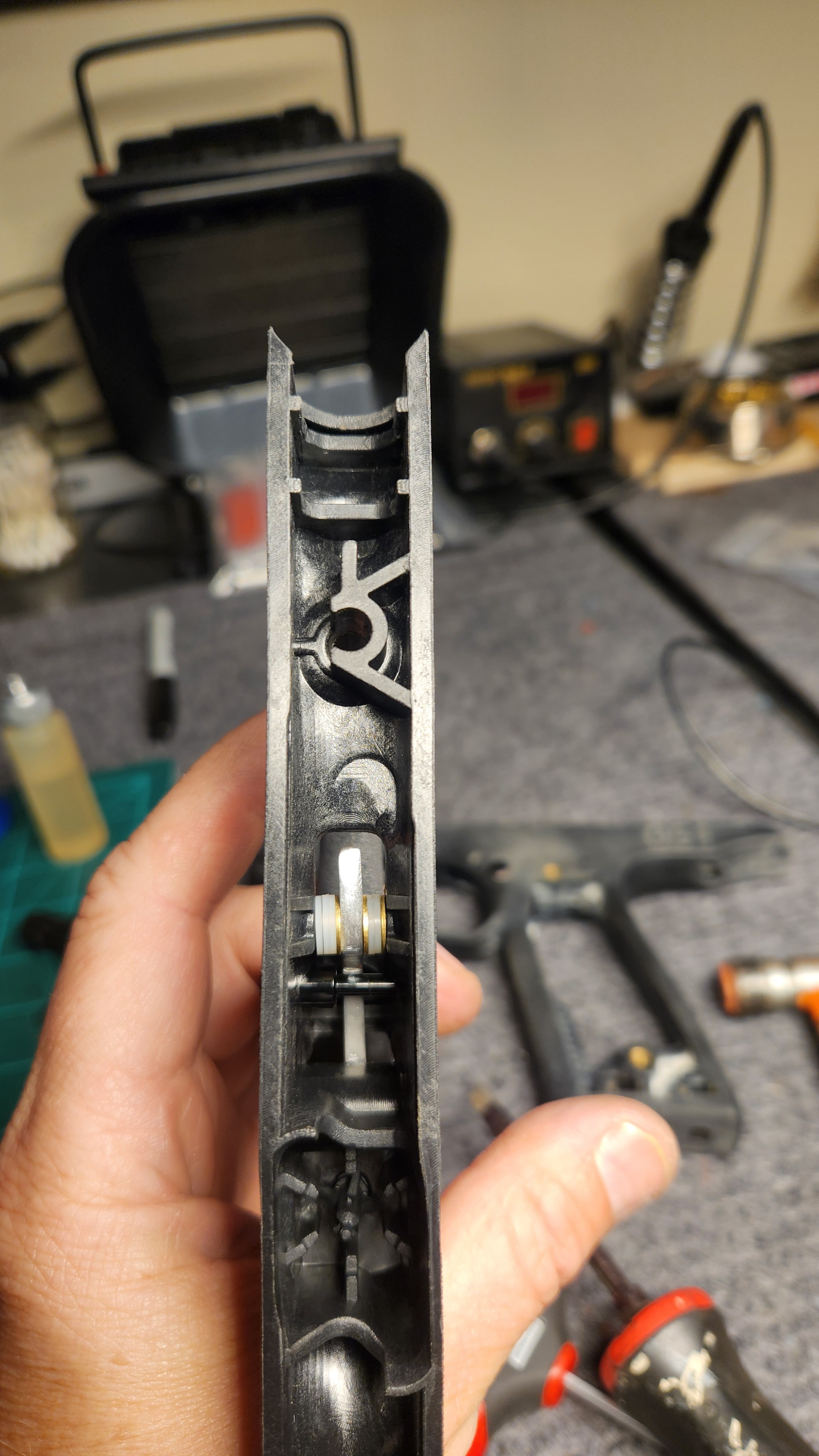

      As usual in these types of endeavours, I had to sand down a washer to get the last one in to center it.
      • Calvin
        Old n' Quick
        • Sep 2025
        • 486
        #33
        The profile of the 2nd one feels better to me.
        • Calvin
          Old n' Quick
          • Sep 2025
          • 486
          #34
          Cap printed and adjusted. Gotta get that sliver of light under the rocket or the Enmey isn't happy.
          This was worth the time. The thing is even more of a paint hose now. The flex of the trigger going in and releasing is gone. Not hearing as much chuffing, which should be attributable to that. Hopefully that results in a little more efficiency.

            Looks great! You beat me to the aluminum trigger. It is good to know that it will make the difference i was thinking it would. I like the idea of the plastic shoe for the rocket. I need to get on it and make one. I repaired my belt sander last night just for that reason.

              No band saw at home so i was going to roughly shape it with the bench top belt sander then go to metal files and a vice to finish the shape.

                Reflex0283 has PMed me with the possibility of him plasma cutting a run of them out of slightly thicker stock. I neednto have a
                .dxf file of the shape for that to happen. I have a nice pencil on white paper tracing of the 2nd one. Do you have any idea how to get that into dxf? I assume the plasma cutter is a 2D process.
              • Reflex0283
                Reflex0283 commented
                Calvin it's a 2D file, I could also just make it myself and then it's not your problem at all lol
