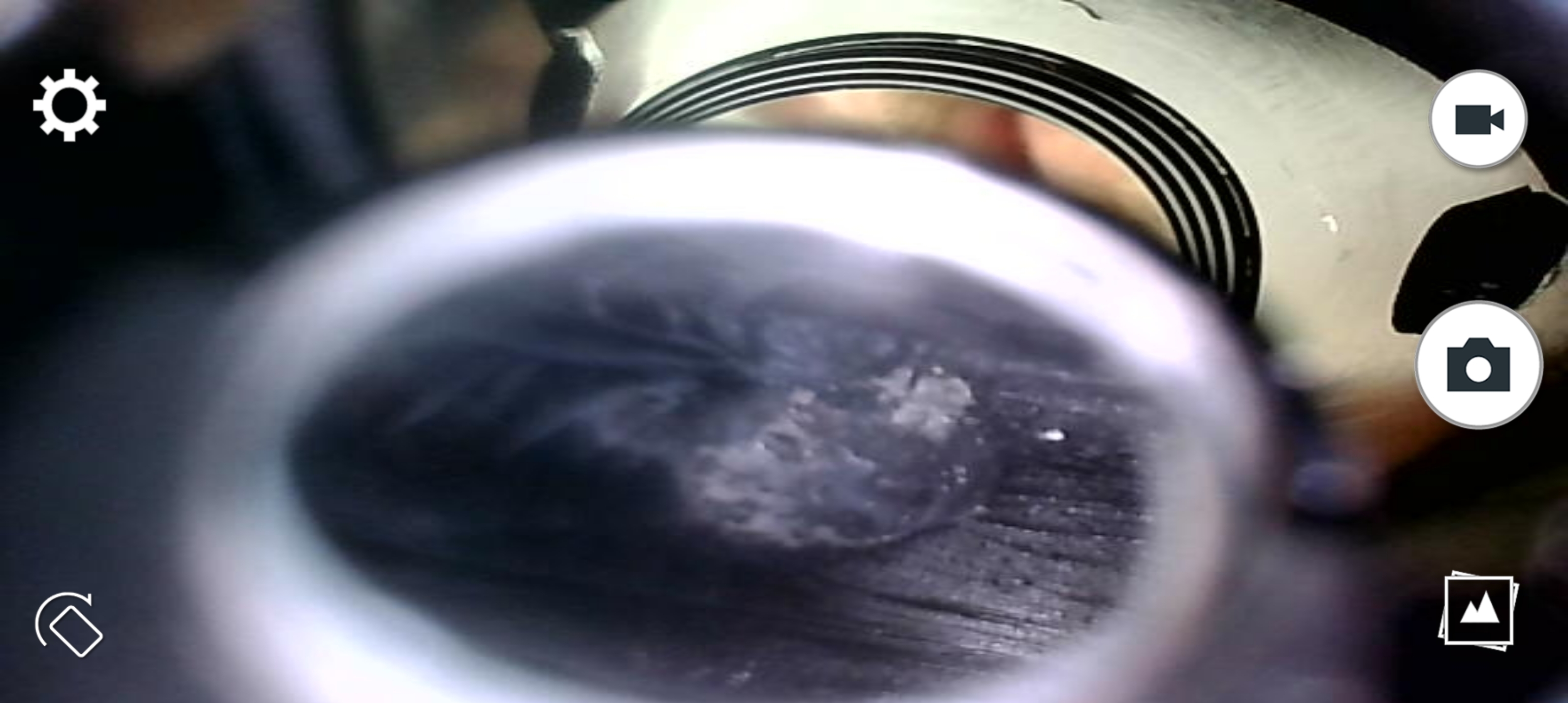

        Put a borescope down the breach and it looks like some of the foil I wrapped the bolt tip in got captured? I'll try and devise a way to lightly sand that area.
        I tried a different bolt tip and lubed it quite liberally and there still needs to be some work there to smooth out that area.

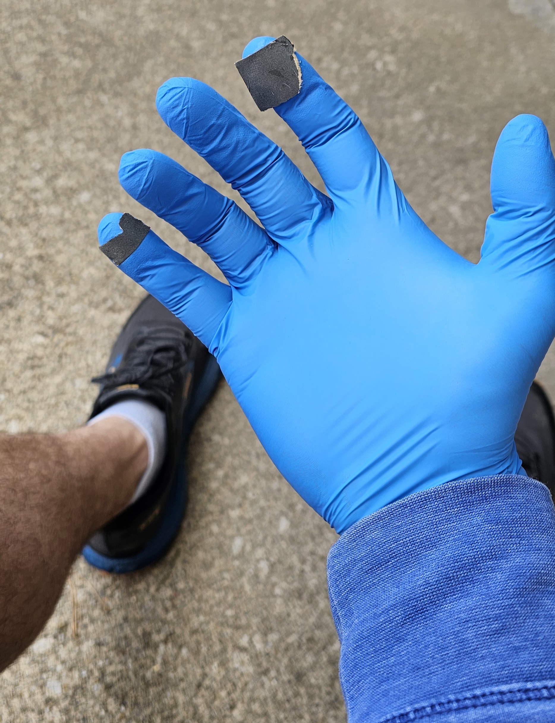

          Current plan is to glue small strips of sandpaper to the tips of the fingers of a disposable glove. I can comfortably fit a finger into the breach and move around enough to do some sanding to that surface. That way I can have more control and feeling of what I'm sanding and the pressure I'm applying as opposed to using something like a sanding disc attached to a dowel or something. I can use the borescope at some intervals to check the progress; unfortunately that's the best image quality I can get inside the breach.
        • StaticShocked
          StaticShocked commented
          Good idea. I bet this fix will work great.

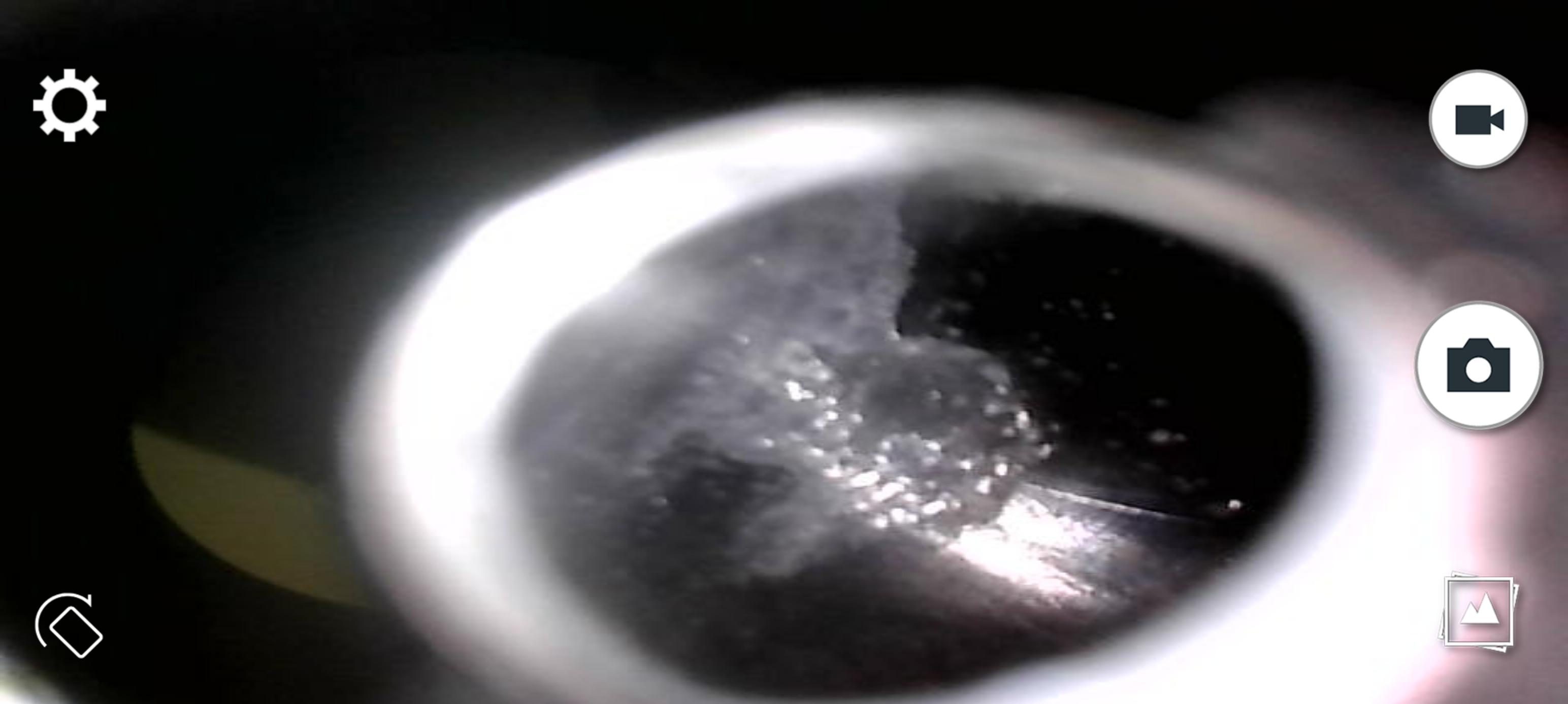

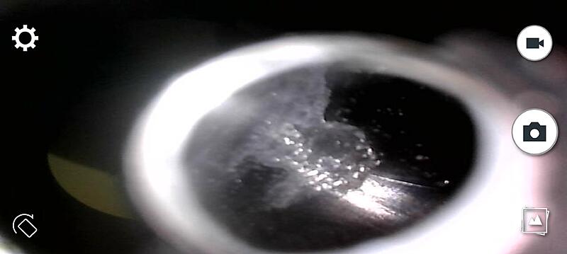

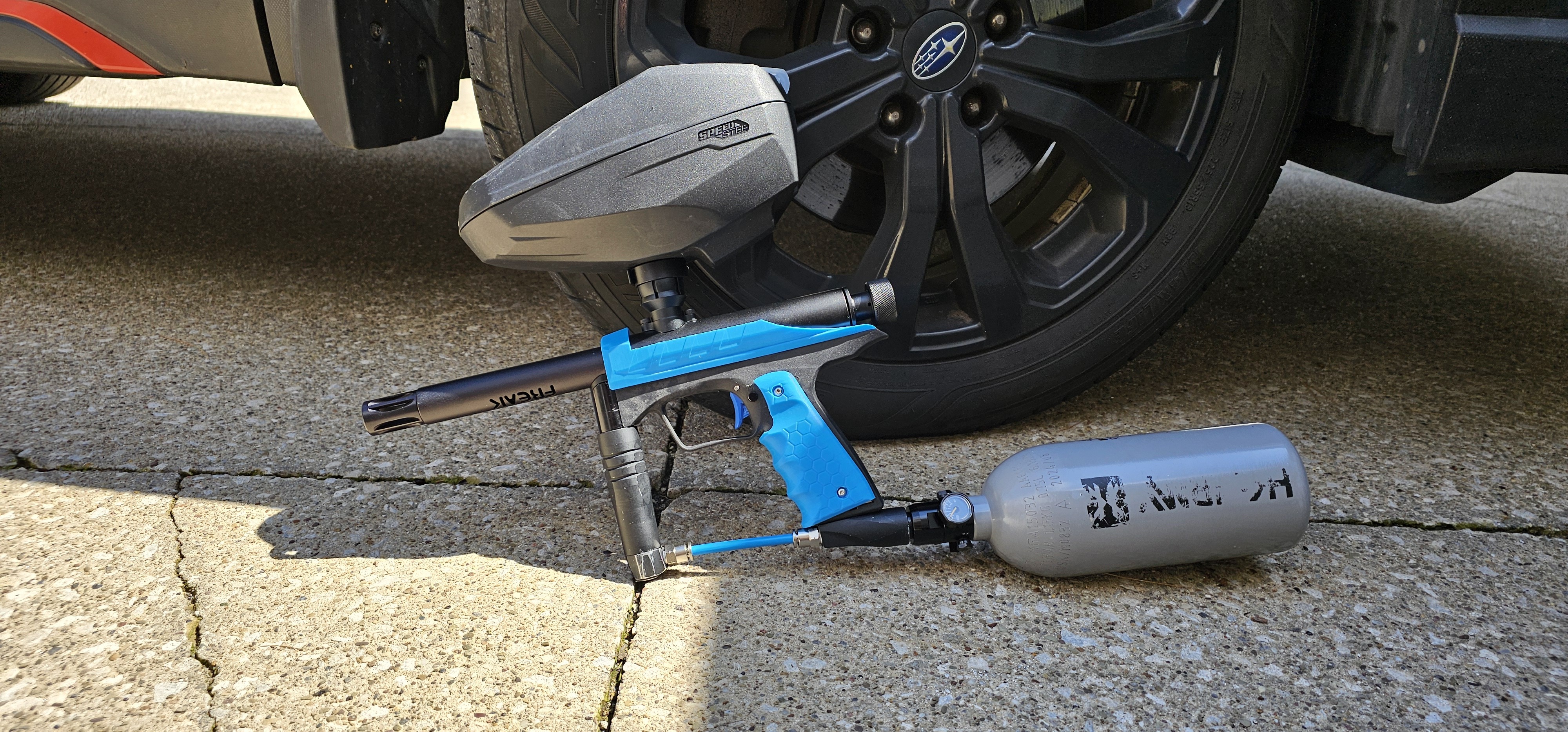

        I come bearing great news! I was able to sand down the surface inside the breach and get a good seal on the bolt tip.
        I superglued 800 grit sandpaper to a disposable glove, the pinky finger did most of the work here. Nothing but the most exquisite of tooling here, folks.
        Once most of the sanding was done, was able to check my work with a borescope. I screwed the bolt back in and aired the gun up and still found it to be leaking a bit still.
        I then used a little bit of my UV resin from my resin printer and dabbed a bit into the area and cured it with a UV light pen. Gave it another light sanding and then checked with the borescope and everything looked and felt smooth. I cleaned the area and reinserted the bolt, but now it was leaking out of the rear body screw, for some reason.
        I then began swapping out bolts since I have three gen 2 bolts and found one of the three wasn't leaking when inserted into the can with the feedneck drilled and tapped. I inspected that bolt for any differences and found the 17mm x 1mm o-ring located at the tip of the rear bolt assembly was missing; it was there on my other two bolts. Went ahead and pulled that o-ring off my main bolt and the leak is also gone completely. That extra 1mm seems to be throwing everything off?
        Anyways, I was able to finally air the marker up without air pouring out of it in one way or another. Screwed on some macro fittings and put blue macro line in which is nearly an exact color match to the TPU that I printed the body and grip in, happy accident.
        I may play around with the wrap-around grip model some more to get it fitting better, but I believe this one may be nearly finished.

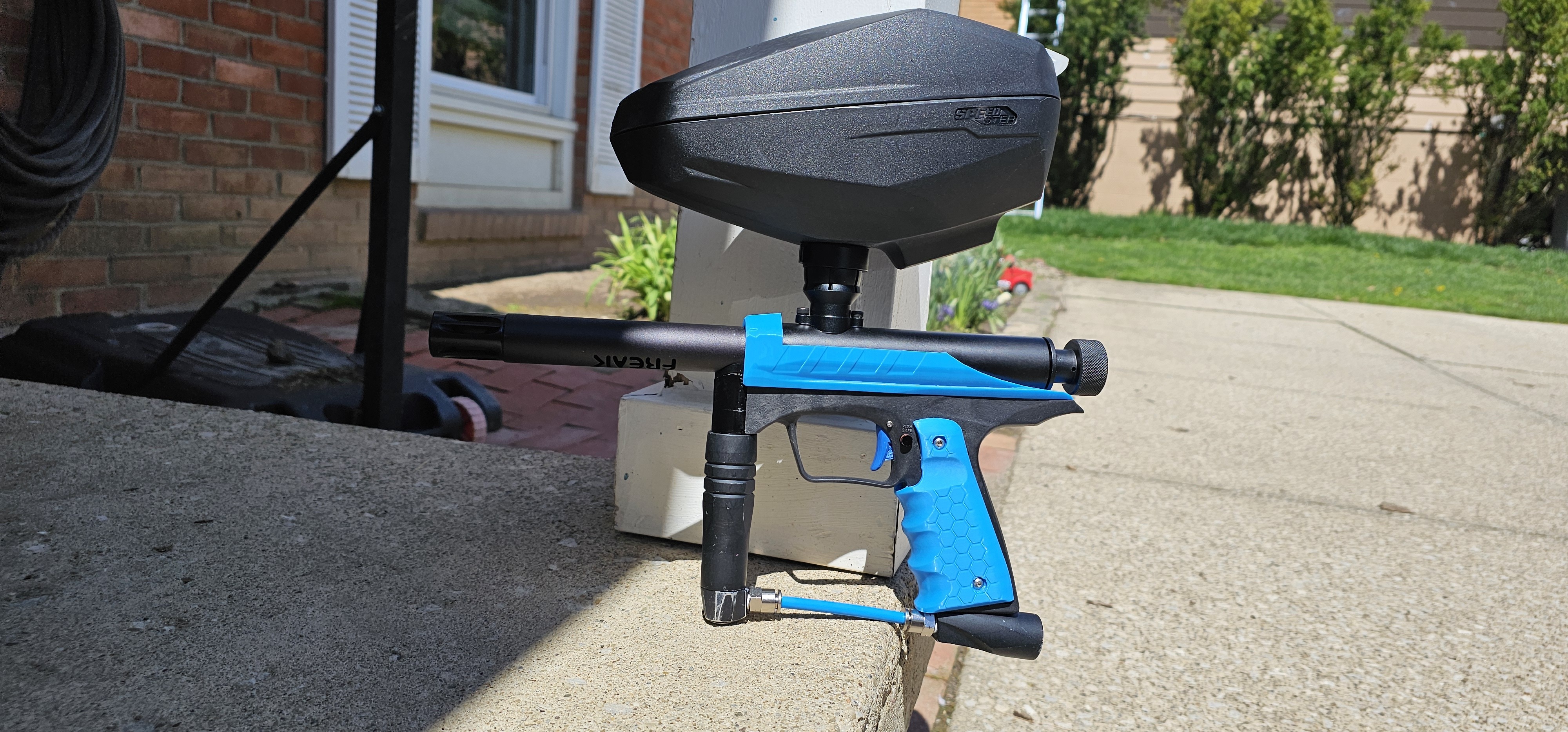

        #39

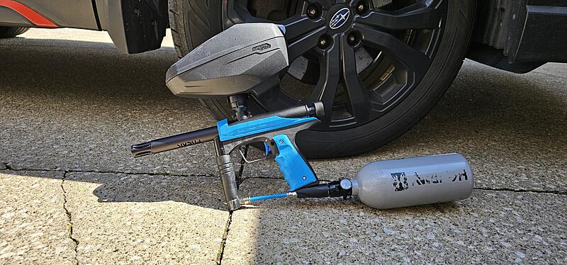

        I won't be able to truly tell until I shoot some actual paint through this, but I'm not too impressed with this marker's performance. The trigger pull is certainly shortened with the 3D printed trigger, but it still feels underwhelming coming from a gas blowback world. I'm waiting to receive my Emek and hoping to have my mind blown by the new space-age markers.
        Anyways, here's a quick video of me shooting some atomic pickles in my garage. Need to order some paint to get the full effect.
        https://youtube.com/shorts/3nzRPhsnN...ITgR4aXzgbJTvZ

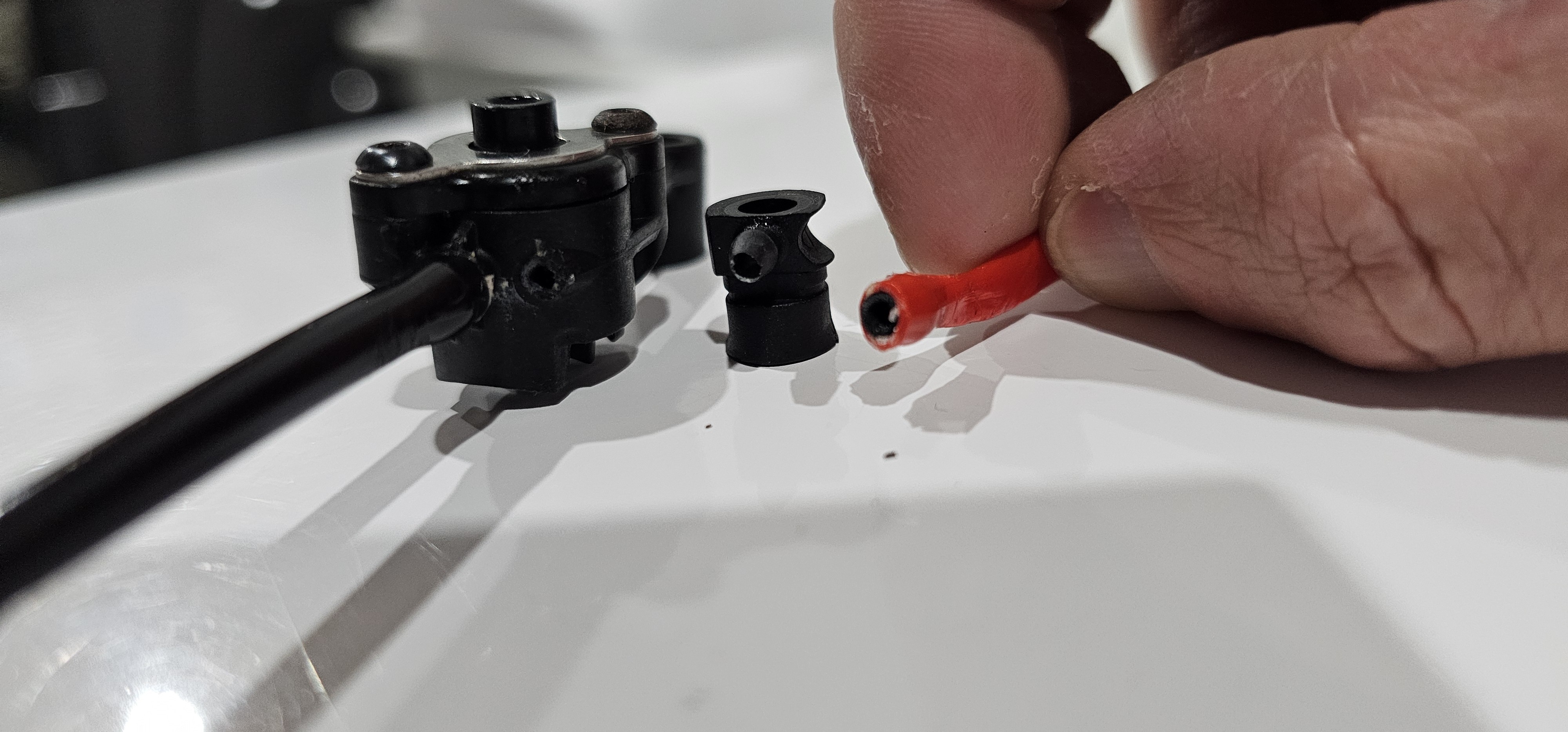

        I'm having a tough time finding appropriate hoses for mine.
        Does anyone know whether the hose from the ASA to the valve is the same size as the one to the middle banjo, and if so, what size these are?
        I assumed they were 5/32 like the larger of the two Ion hoses, but that's too small. Also tried getting some 3mm ID/5mm OD silicone hose, but this stuff is too loose.
        • tyronejk
          tyronejk commented
          zdspb says the small Ion hose is 1/8" (https://www.zdspb.com/media/ion/solenoid_ping2.JPG)
          Maybe the silicone is too soft. Polyurethane hose is a lot stiffer and may hold the barb even at the same ID.
        • gnarlynick
          gnarlynick commented
          According to this old post on pbnation, the ASA to the valve is 3mm ID x 5mm OD. Banjo fitting to valve is 4mm OD x 2.5mm ID.
          I put calipers on the barb from my broken banjo fitting and that measures 3mm at its thinnest, so 2.5mm ID may be correct. Couldn't get the larger hose off the ASA fitting but the OD is 5mm.
          Probably try a stiffer material, like nylon.

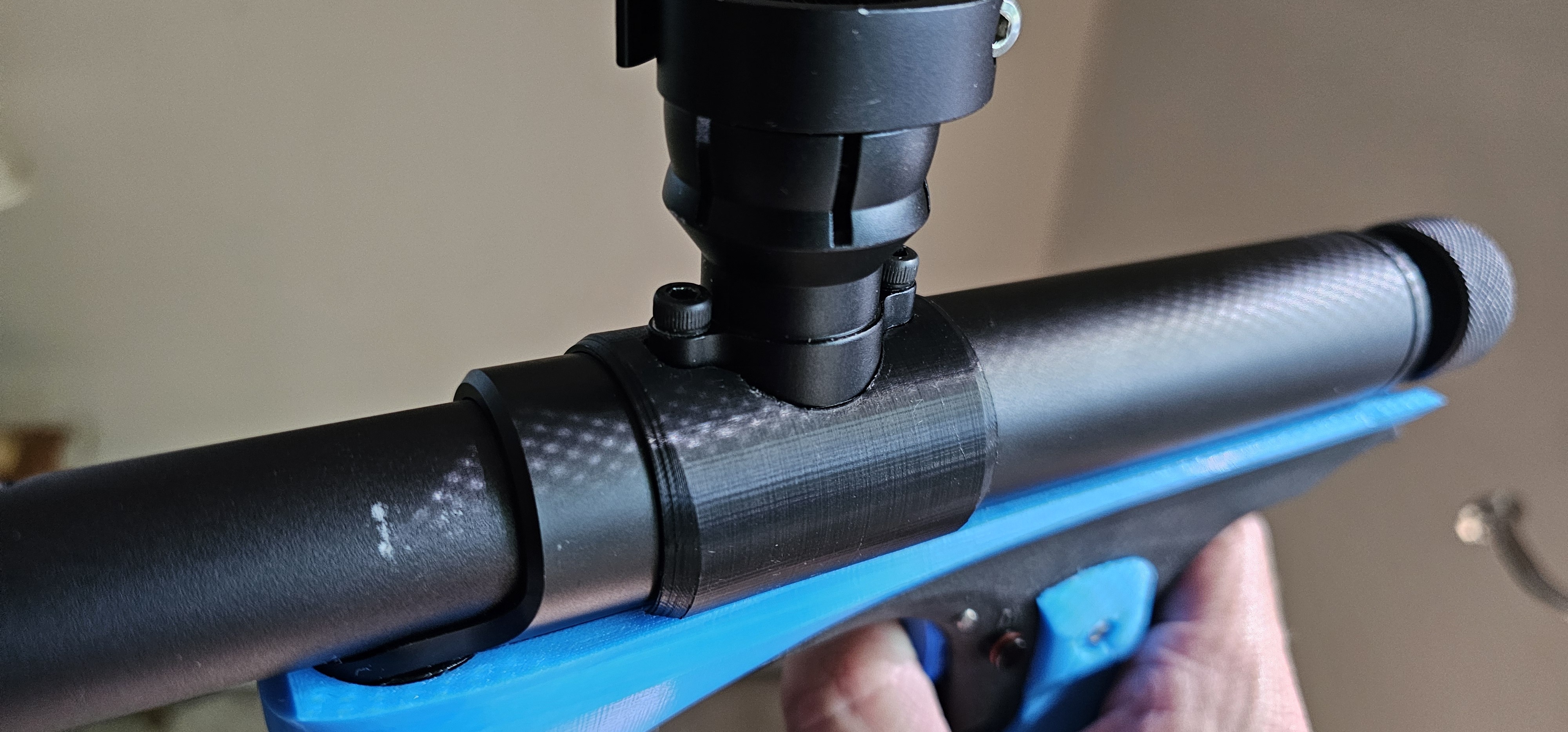

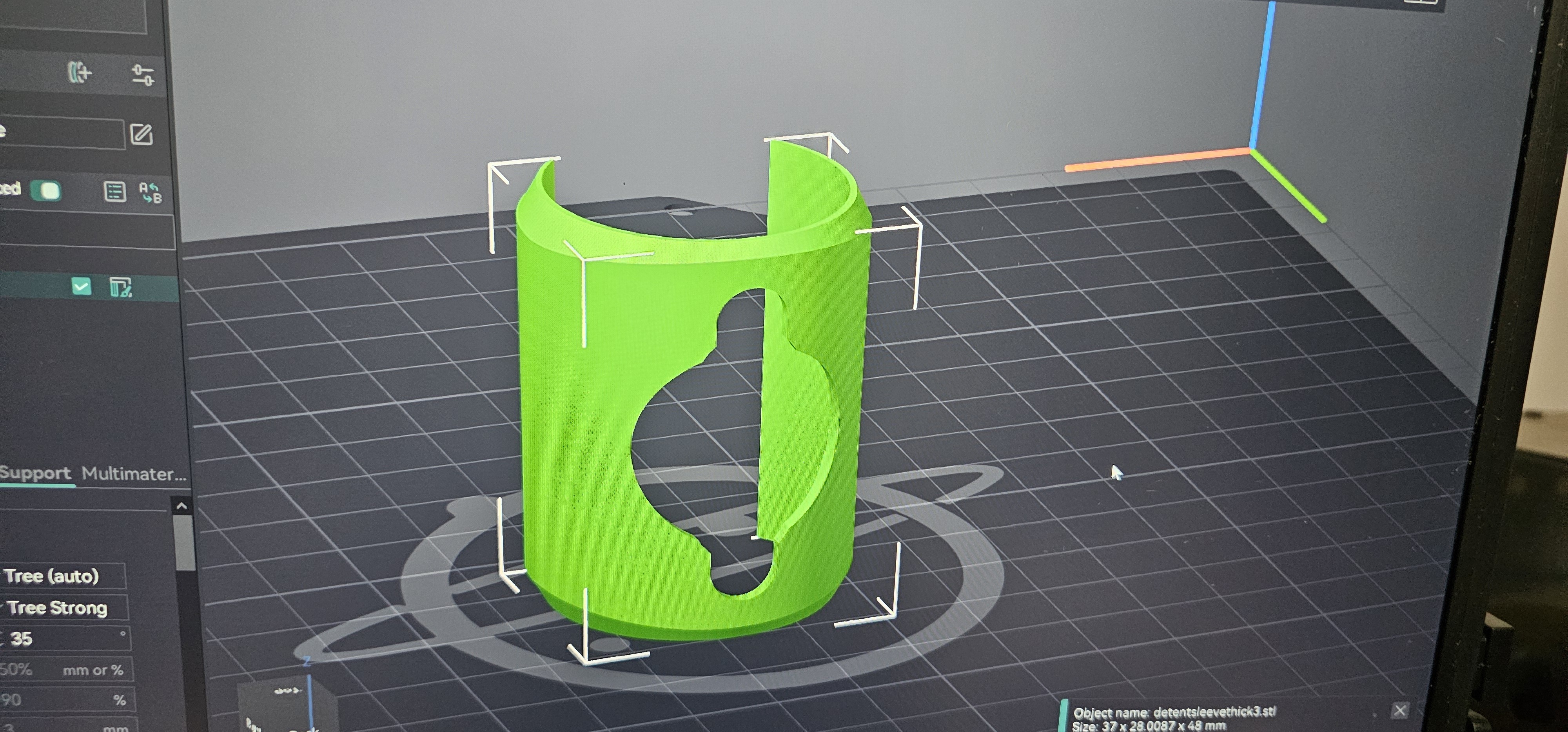

          I modeled a sleeve that secures under the Sconi feedneck to hold the ball detents in since the body I went with doesn't wrap around the can like the OEM design was. A few iterations in and I think I've got a good fit.
          gnarlynick's feedback
          • gnarlynick
            P.S. I have got to learn CAD modeling. I did this all in the slicer using primitive shapes and mesh booleans. Possibly the least efficient way to accomplish this.
          • StaticShocked
            That is a great solution! Clean looking.
          • gnarlynick
            Thanks! Honestly, I prefer your solution in threading the body and machining some set screws but I lack both the skill set and equipment to pull that off. Armed with a caliper and 3D printer, this seemed like the best option available to me.
